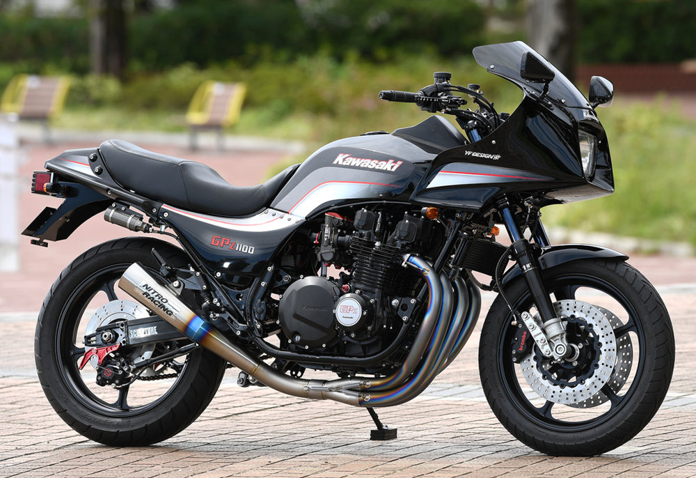

Got the chain lined up
And amazingly the chain slider fits without needing altered

we need to see more of this as it looks like you have already started very interested to see what you are up to

Bandit 1200 swingarm?

Gsxr600 with a zrx1200wheel

stusco wrote:Gsxr600 with a zrx1200wheel
Nice! interested to see how this will turn out mate cause I’m gonna be doing the same thing next spring.
