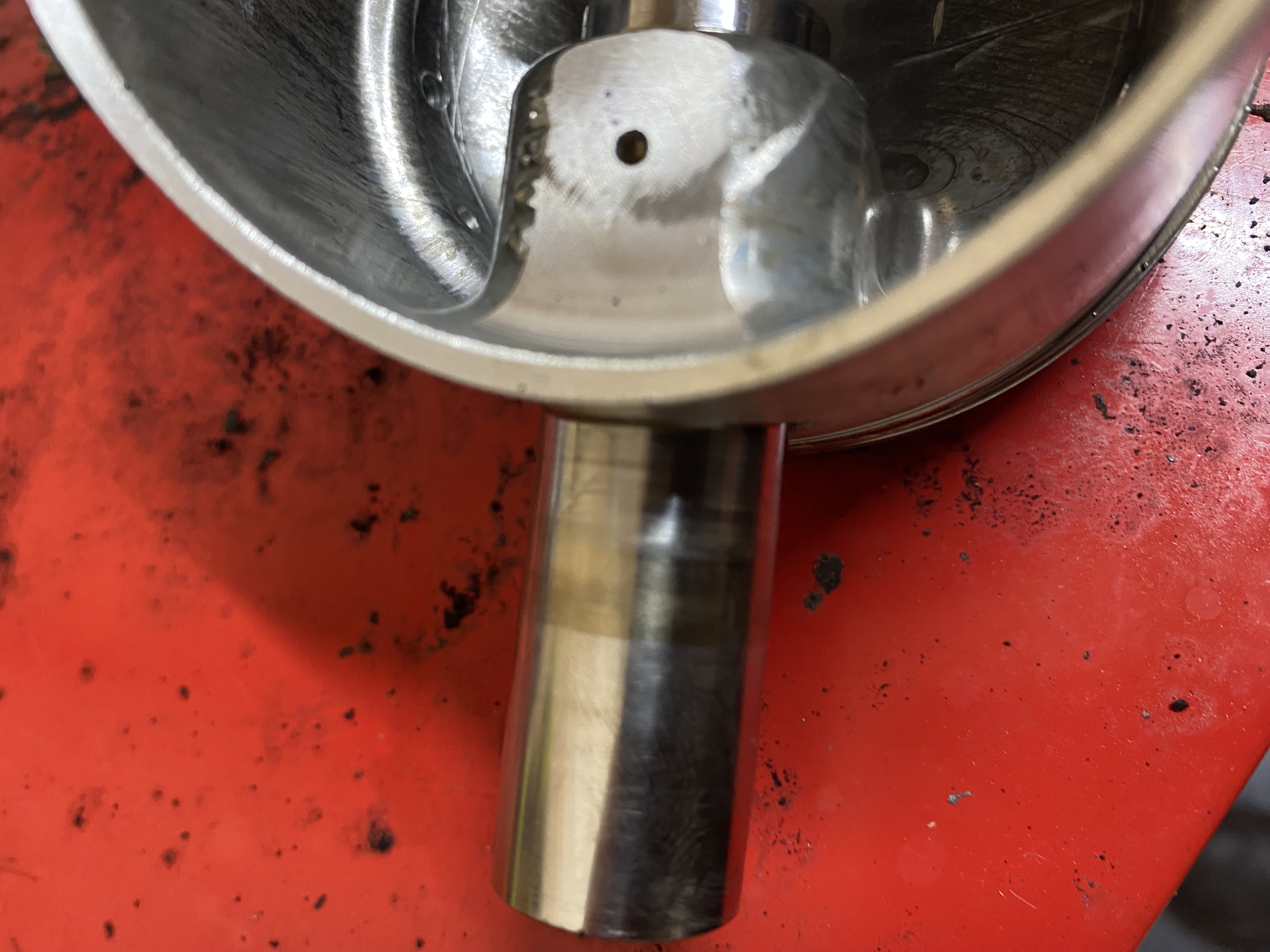

#9 PostAuthor: stusco » Mon Jan 27, 2025 5:42 pm
Here is some pics of the pistons can anyone identify them?

#10 PostAuthor: Robw » Mon Jan 27, 2025 6:30 pm
Look like Wiseco pistons to me.

#11 PostAuthor: stusco » Mon Jan 27, 2025 6:36 pm
High compression piston how could i tell?
It had low compression (115-130psi) and smoked a bit before I stripped it

#12 PostAuthor: Robw » Mon Jan 27, 2025 6:40 pm
Low compression, i have high comp in mine and the dome is much more pronounced

#13 PostAuthor: Robw » Mon Jan 27, 2025 6:46 pm
As you can see these 1170 wiseco pistons have a high dome. I had 1136 on my b1 and they had a dome similar to yours and they were low comp. J

#14 PostAuthor: Skid Mark » Mon Jan 27, 2025 6:59 pm
I agree with Robw. Mine look very similar to yours and are 9.5/1. Mine have two sets of no.s across the crown ( can’t upload from my phone) these appear to be laser etched so perhaps just new then yours.
