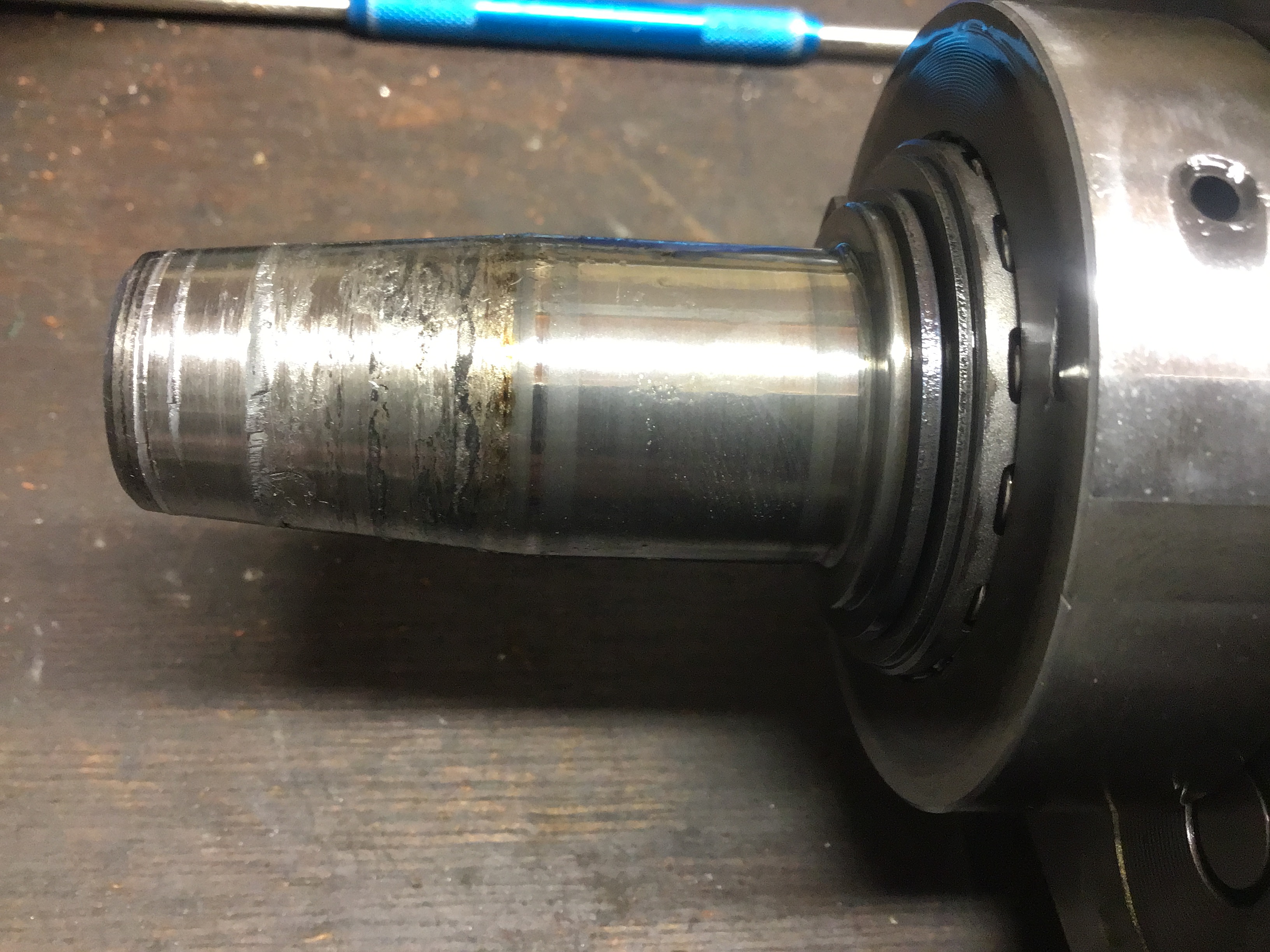

Got the flywheel off I actually think the acetone worked but i did use a borrowed milliwaki impact gun but i did come off easily,thats the good news the bad news is the taper is scrap

I catch your drift
I need to find one mine is beyond lapping in, is there any aftermarket generator kit ? The crank is going to grumpy 1260 for refurb so that should sort that taper

That crank taper looks pretty good really. I wouldnt be surpried if it cleaned up by lapping on another std rotor without any machining.
