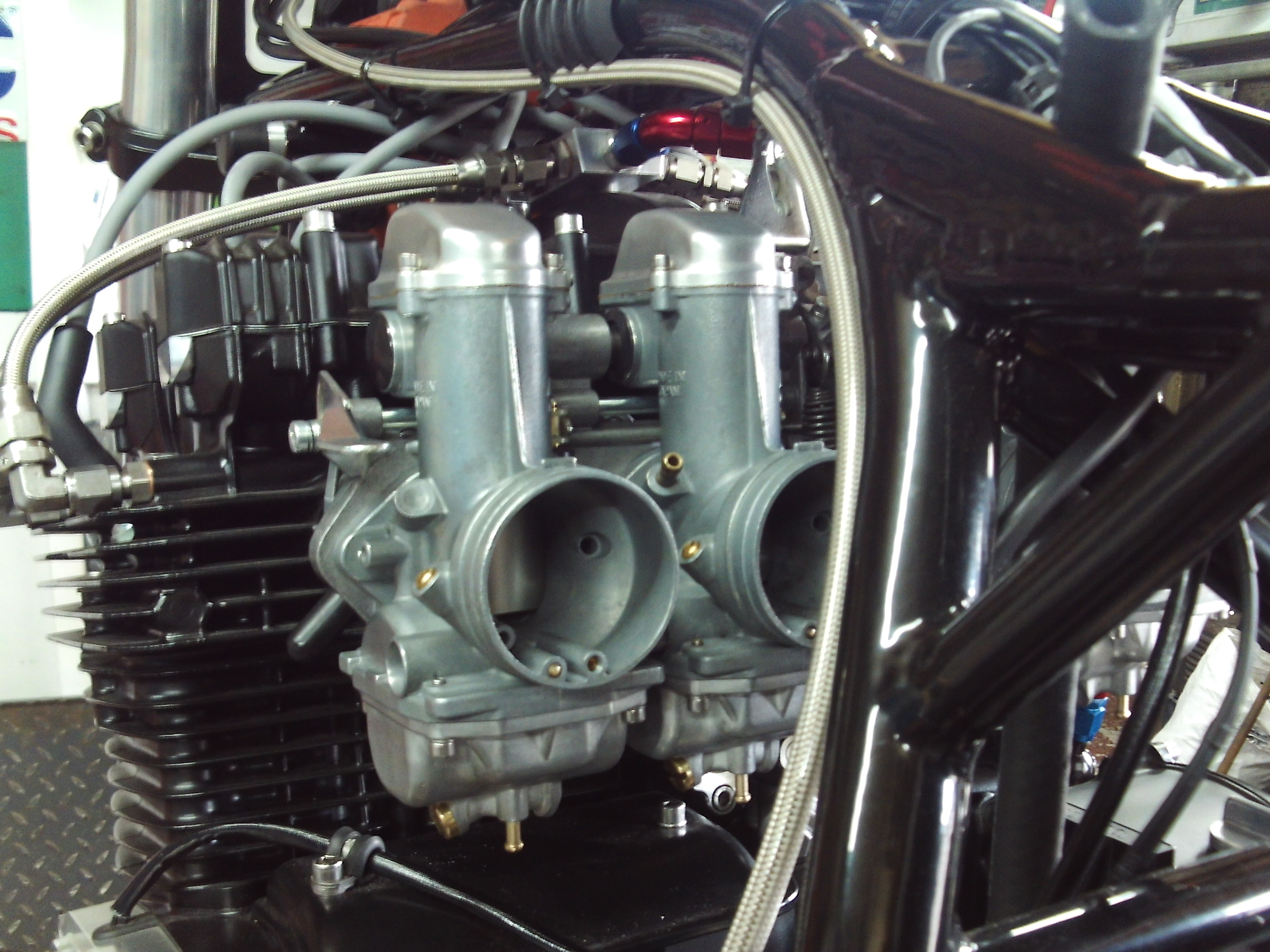

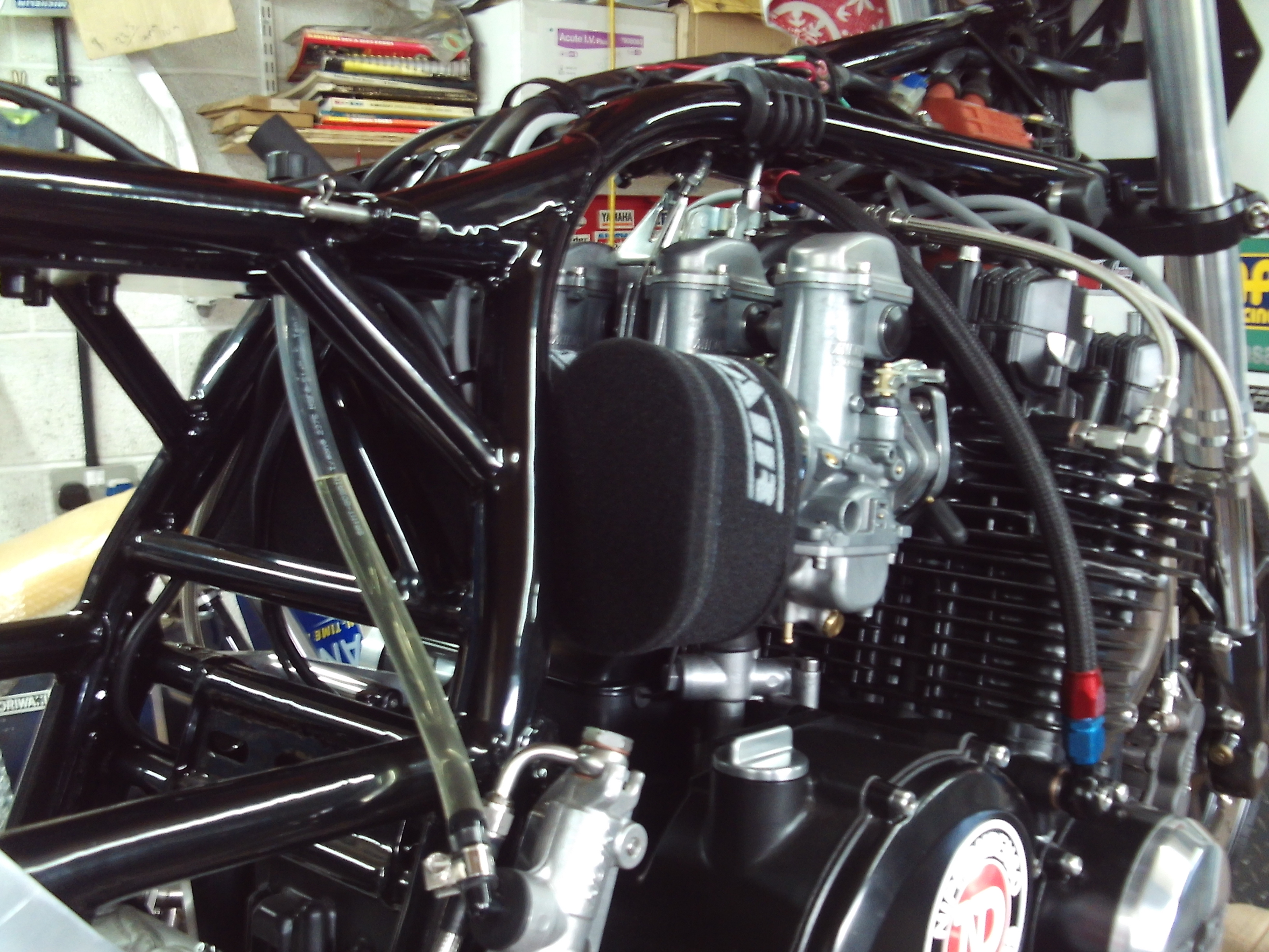

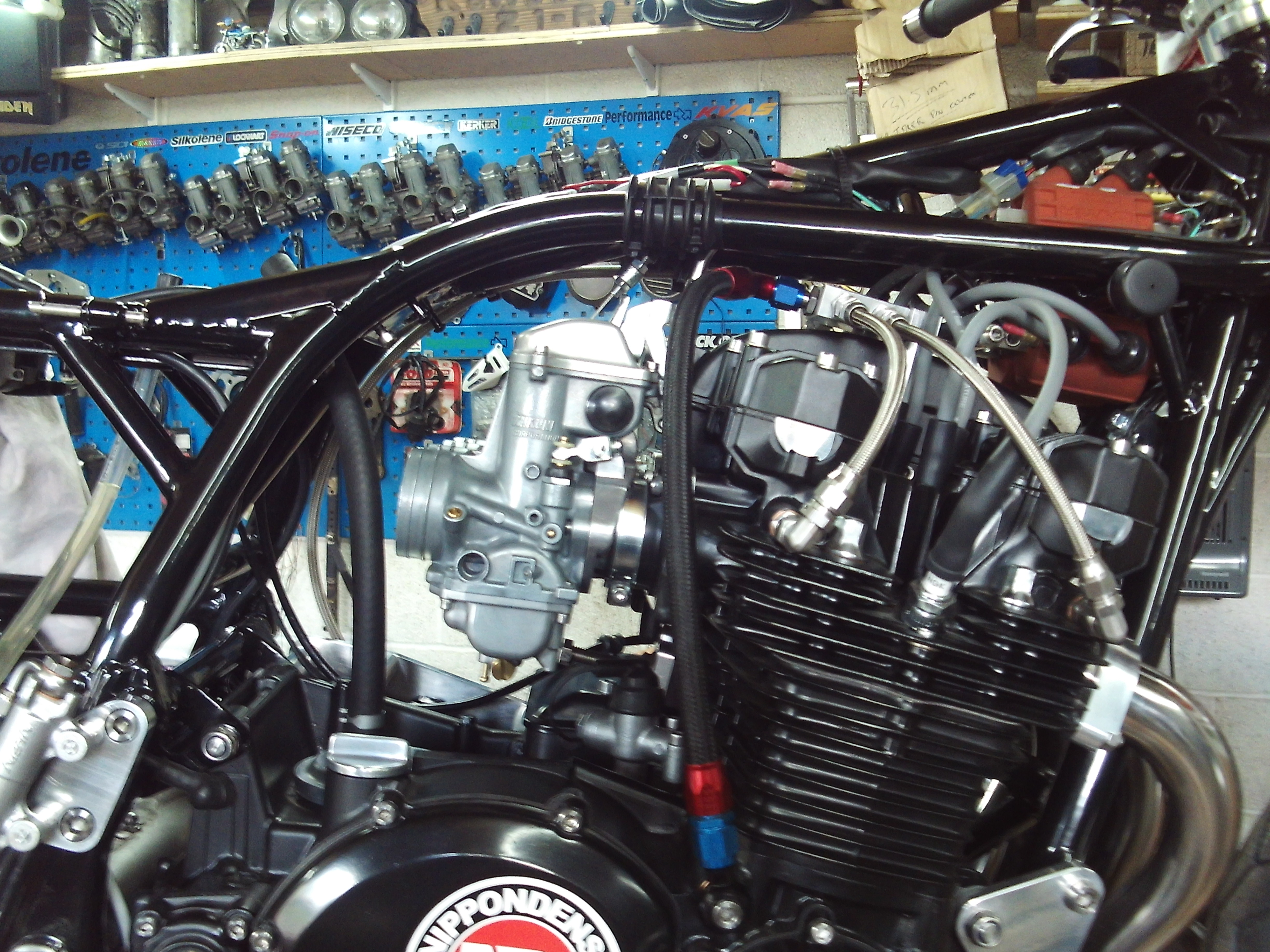

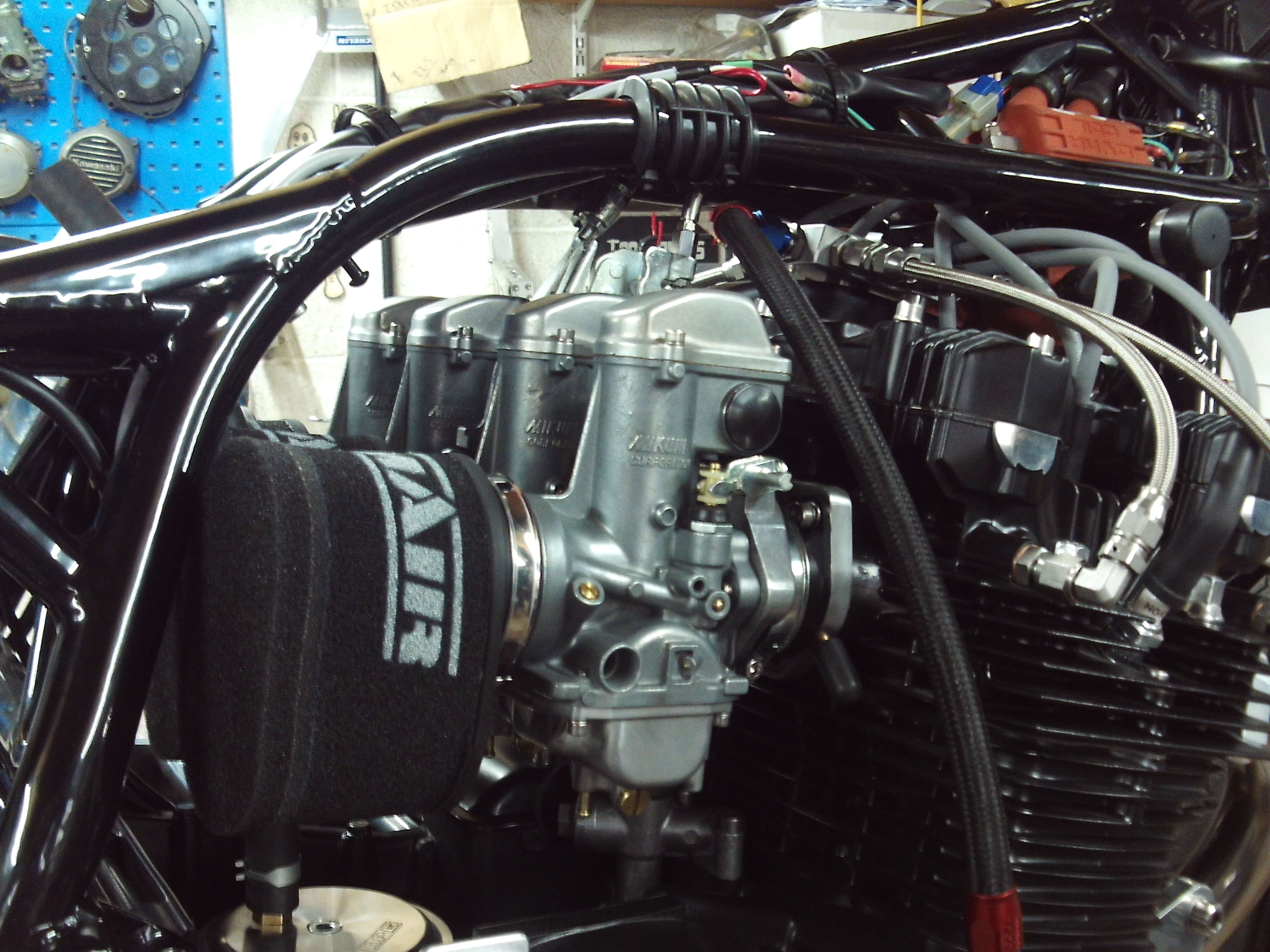

Parts arrived from USA today so finished off building the carbs.

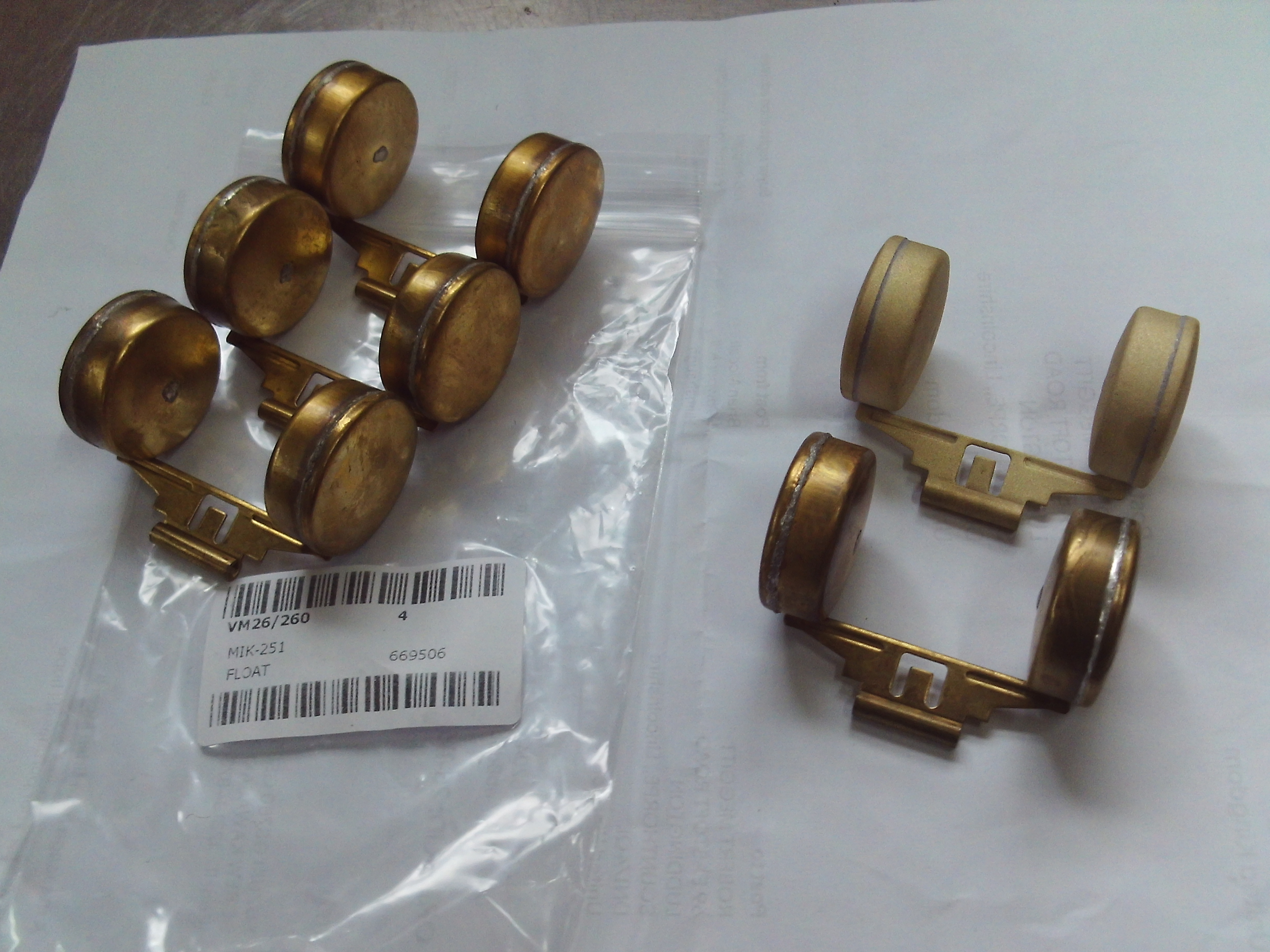

I'd took a bit of a gamble when buying the parts as these VM32 ovalbores are unique to the Suzuki 1000 Katana with only around 1000 sets made and apart from the odd screw and washer almost all the parts are listed as discontinued with most also having no part number to cross reference .
I figured that whilst the backplate and bodies etc are specific there's a good chance that other parts were raided from the parts bin..
The floats were the first result and luckily Niche Cycle has measurements accompanying many of their items.
The ones listed for the 29 and 33 smoothies seemed to match which made sense so took a punt on those and happily they are identical as can be seen when compared to one of my good cleaned up ones on the right.

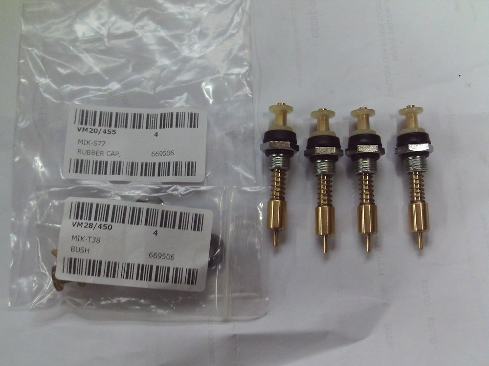

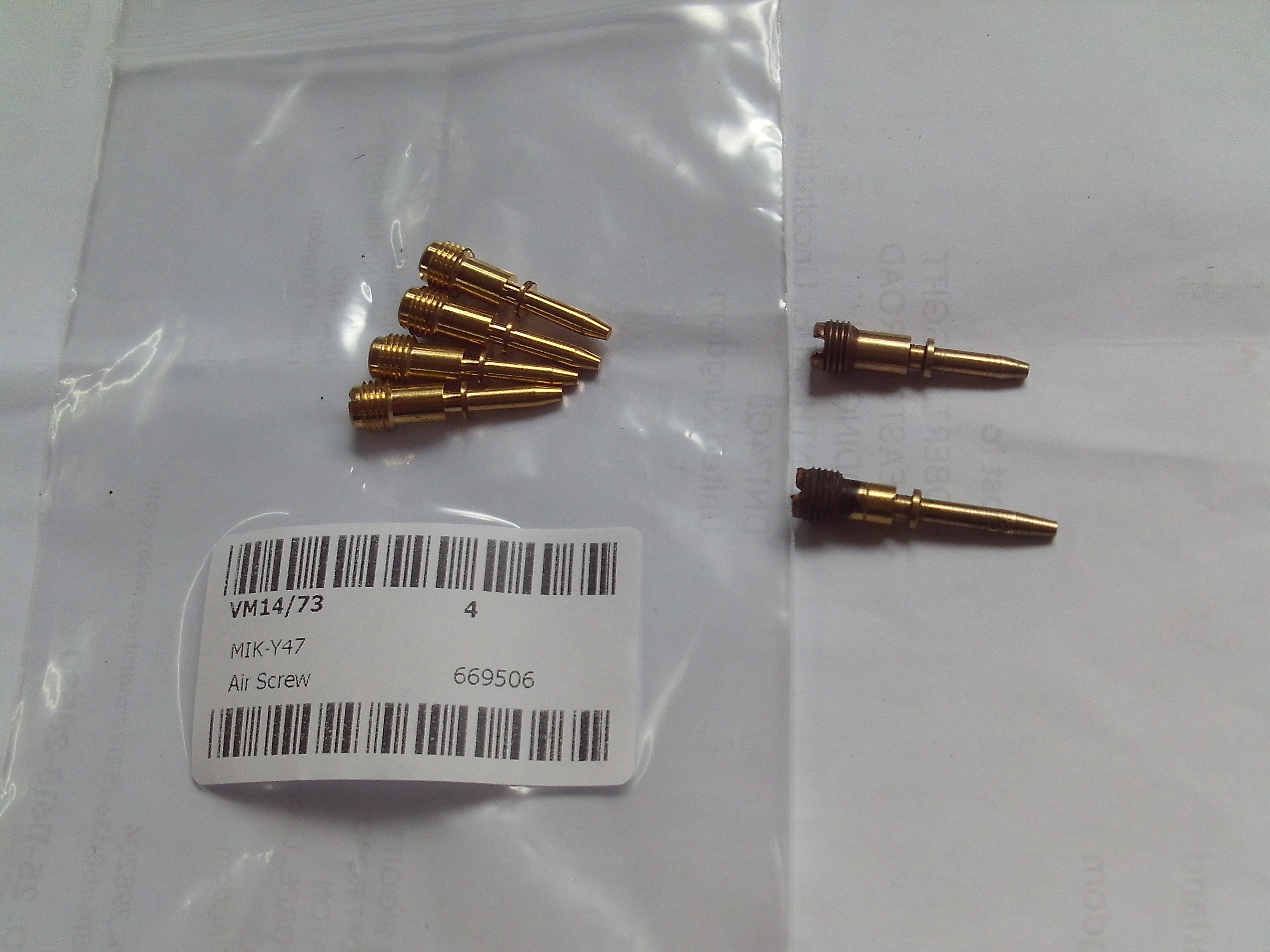

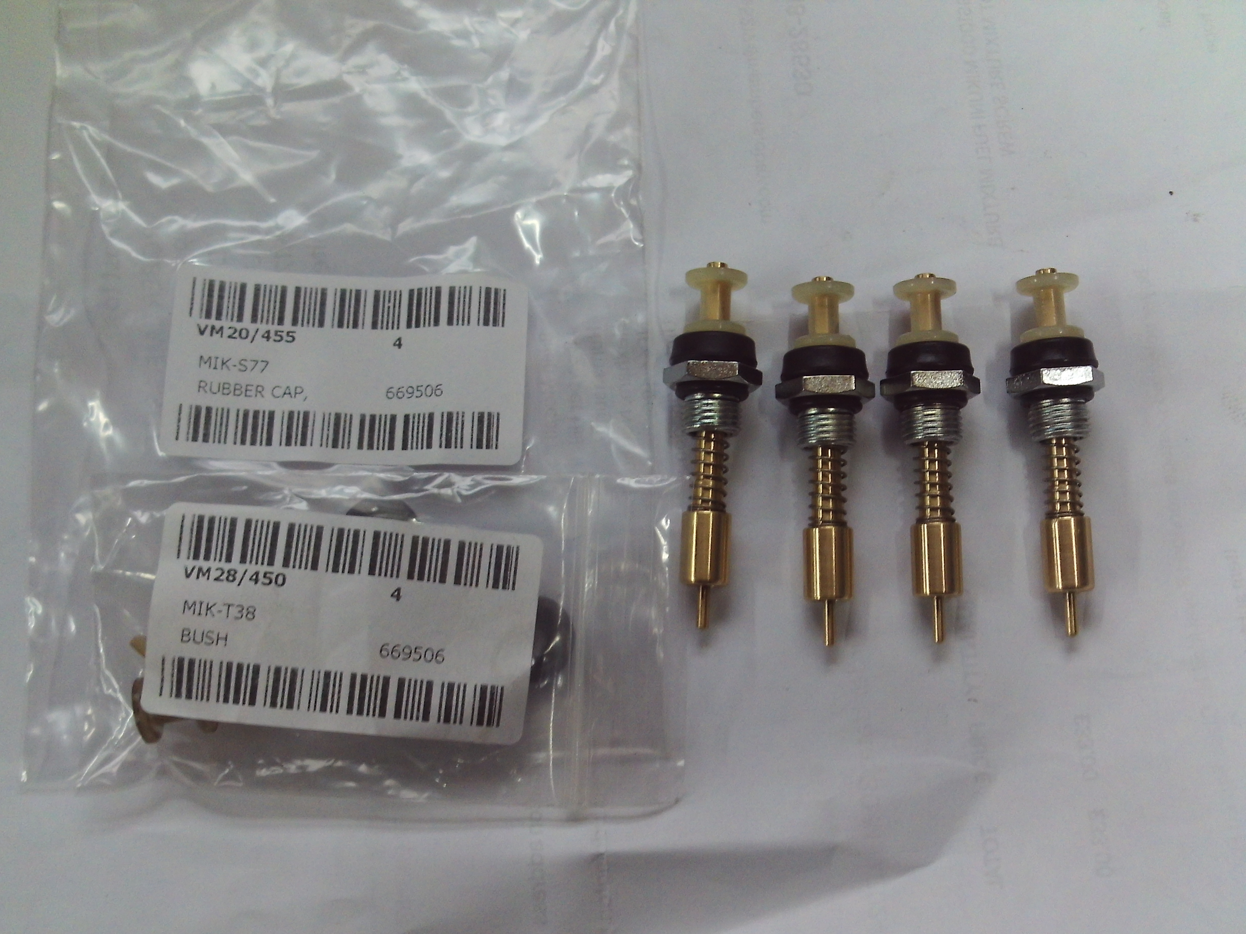

The next gamble was the air screws.
The Katana one (top right) is 10mm shorter than the items as found in the stock Kwak or Suzuki 26 or 28 vm's (bottom right) .
The ones for the 29 smoothies looked the correct proportions but they have a bleed hole on the straight shank and i didn't really want to either have to plug the hole in those or muck about shortening the longer VM ones except as a last resort.
A search of "Mikuni air screw " on Google images came up with the VM14/73 from the range of VM 606 26mm to 30 mm spigot mount carbs which looked close enough so another punt from Niche came up smelling of roses with another four identical screws for the job.
VM606 spigot mount carb that the air screws are commonly used in
And while i was at it i also ordered some new dust caps and nylon bobbins to complete the choke plunger refurbs.

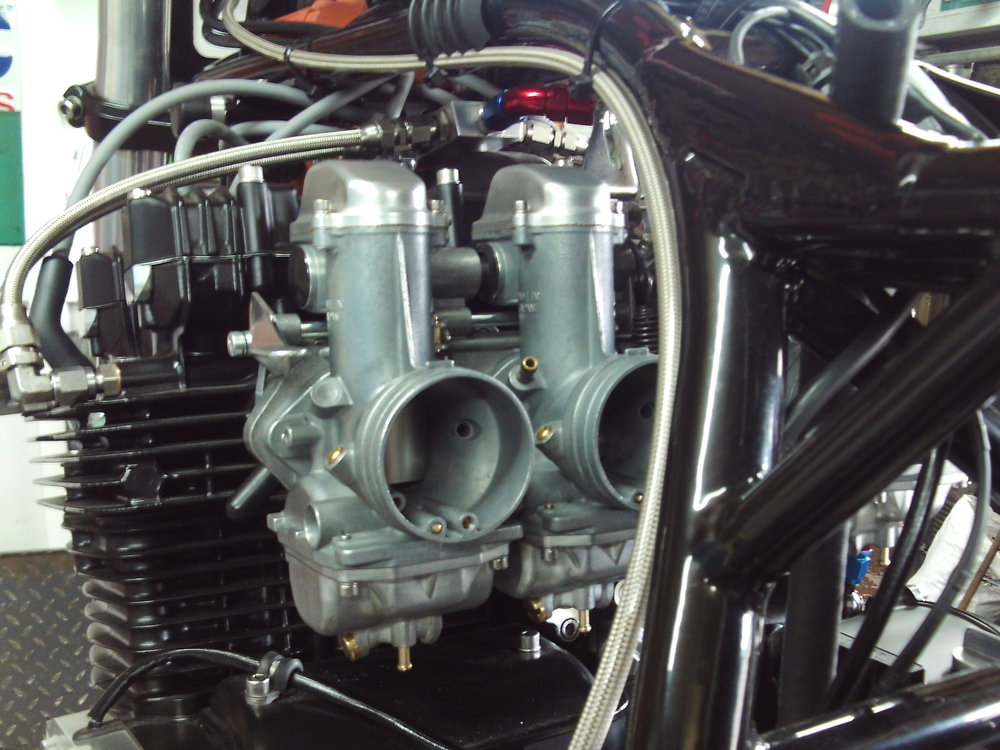

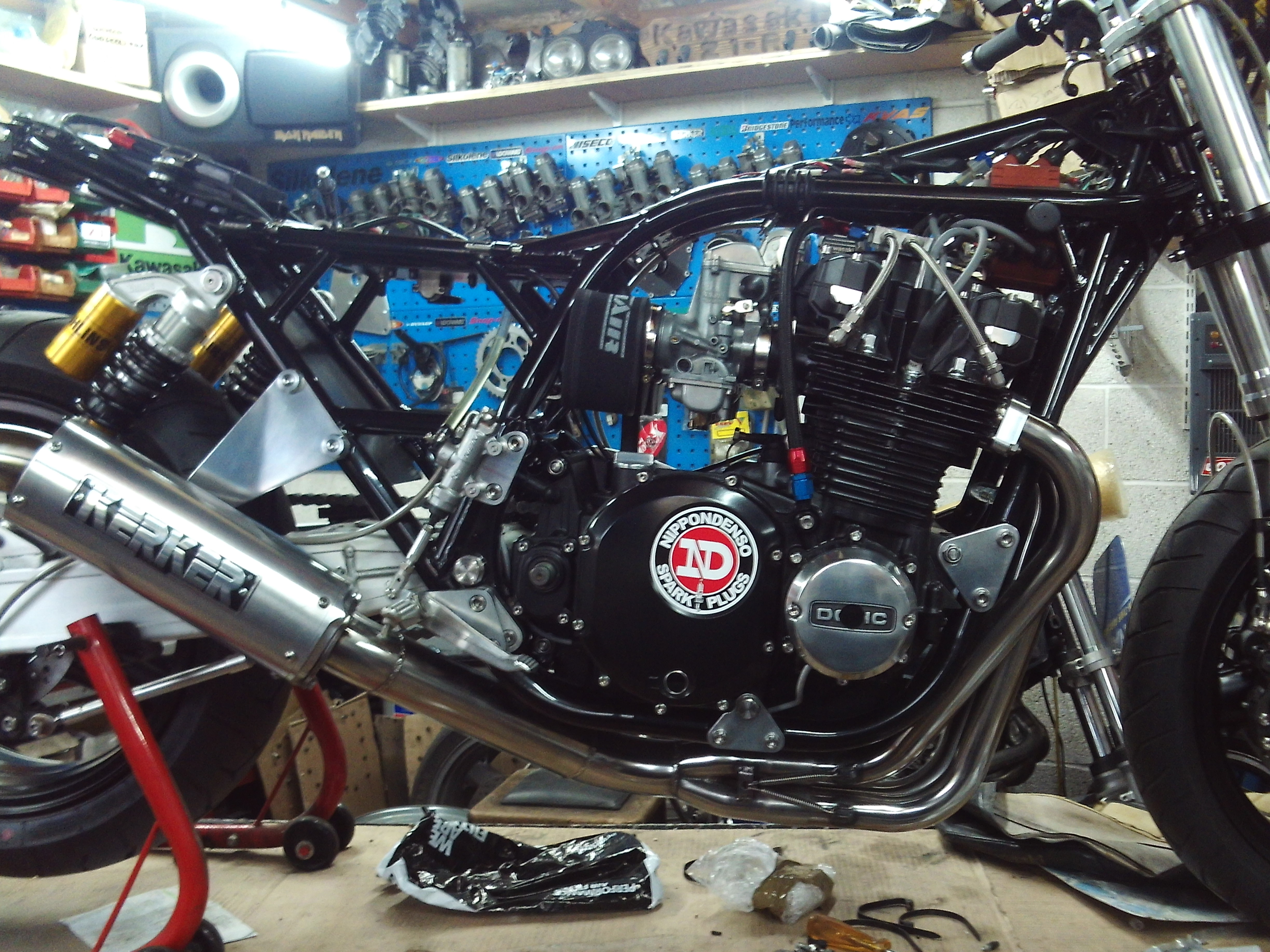

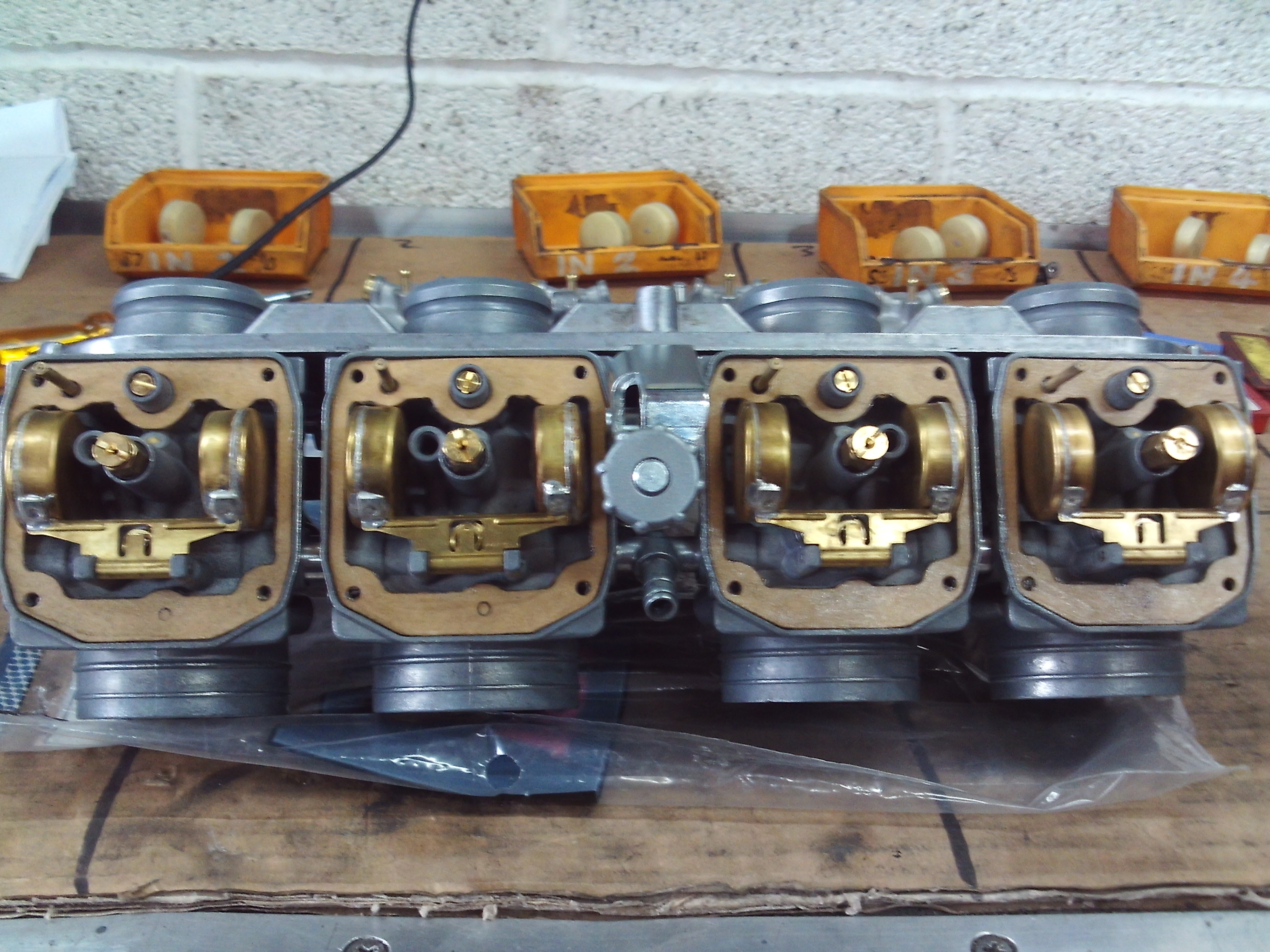

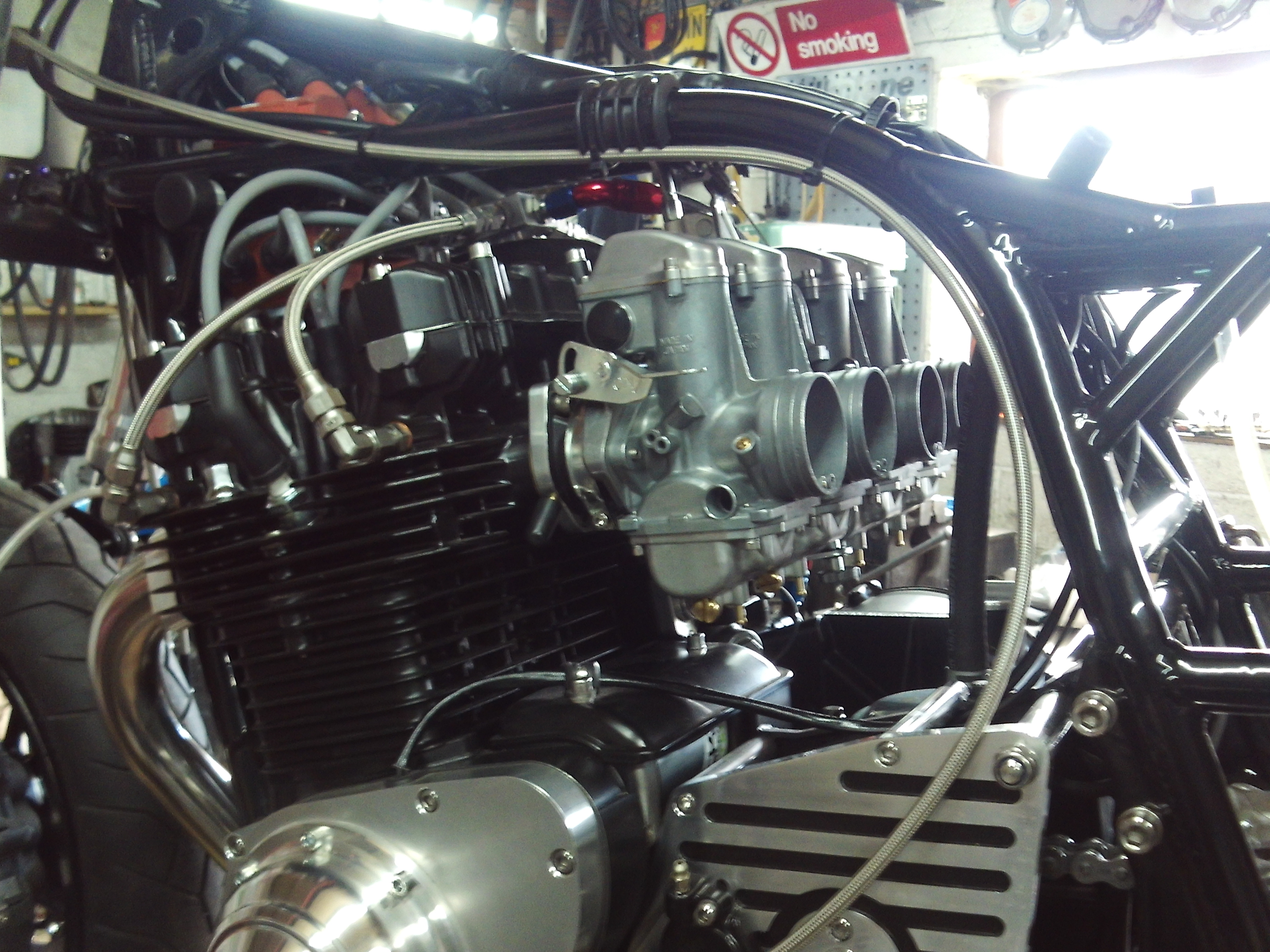

Float heights done, slides bench synced and new gaskets made.
Pretty much everything important is new and happily they took the fuel mixture screws from the stock VM26/28's so they were easy enough to find.
And a couple of hours later they are on with cables hooked up which give a nice quarter turn on the XJR throttle .
Just enough clearance for the Ramair filters
Half a days work once the seat and bodywork arrives and this one should be ready to roll :D

where do you run the crank vent pipe too with that set up Rob?
paid up member
Posts: 4034
Re: Double the troublezz. AMA style Racecrafters Z1000 and Moriwaki Z1R Turbo.
#244 PostAuthor: zed1015 » Wed Jun 05, 2024 7:38 am
rpeters wrote:where do you run the crank vent pipe to with that set up Rob?
At the moment it just runs straight up between the carb filters and vents out under the nose of the seat slightly higher than the cam cover.
I've run the same on the alloy cafe for 10 years with no oil mist escaping so unless this behaves differently i'll leave it as is and if it doesn't i'll run it into a catch tank mounted in that space where the gussets are on the XJR arm in front of the tyre.

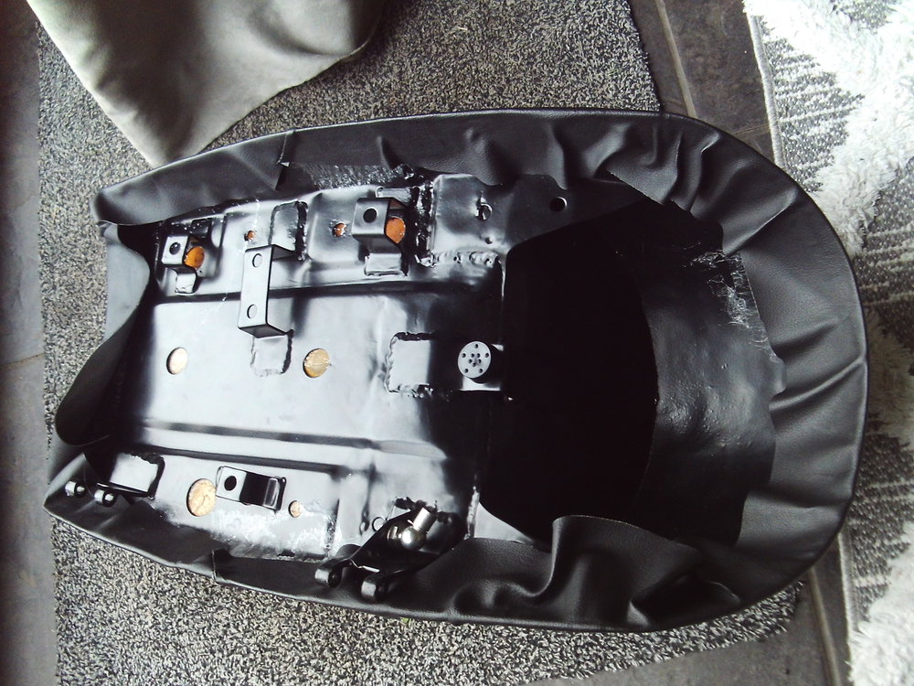

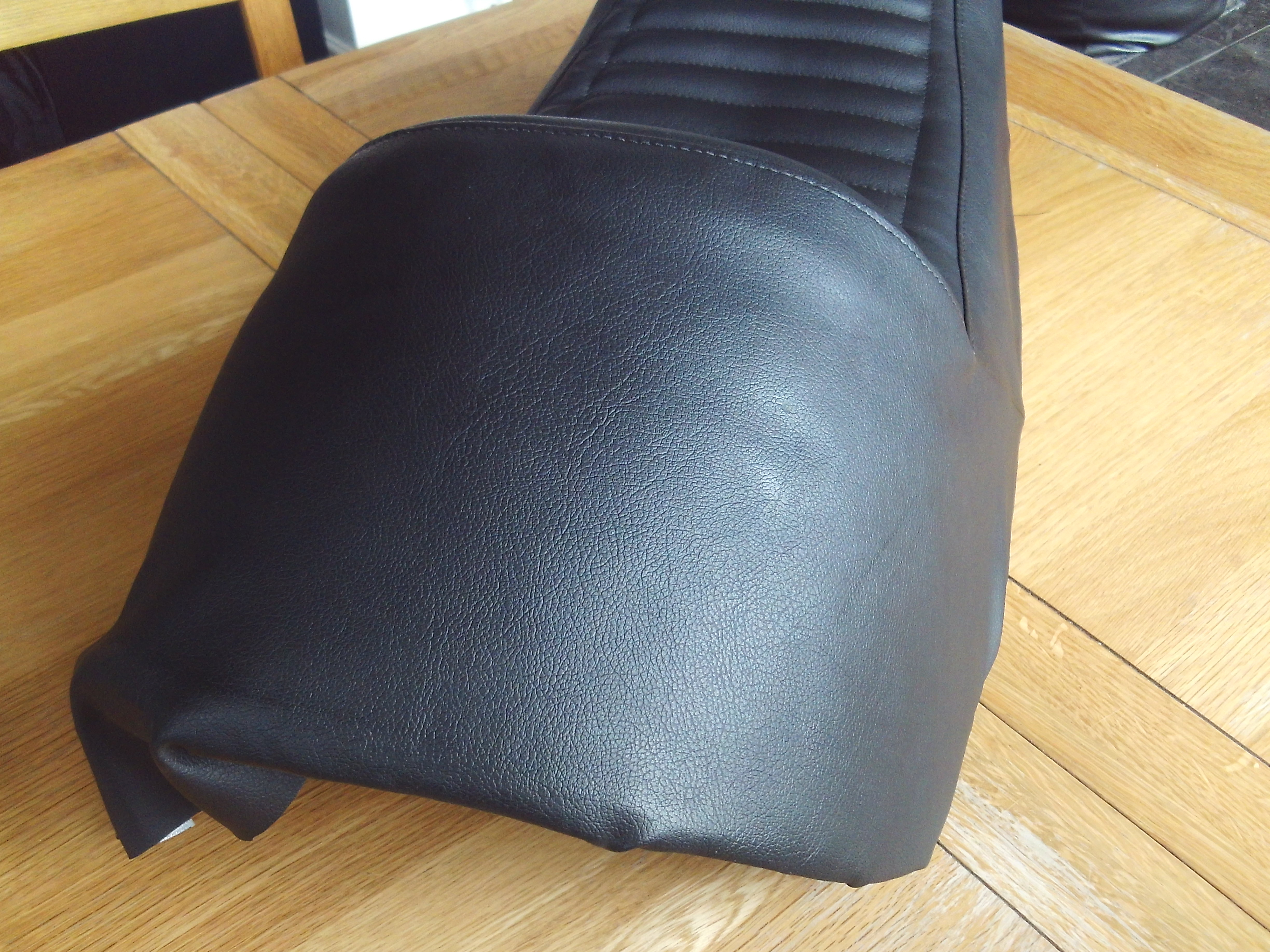

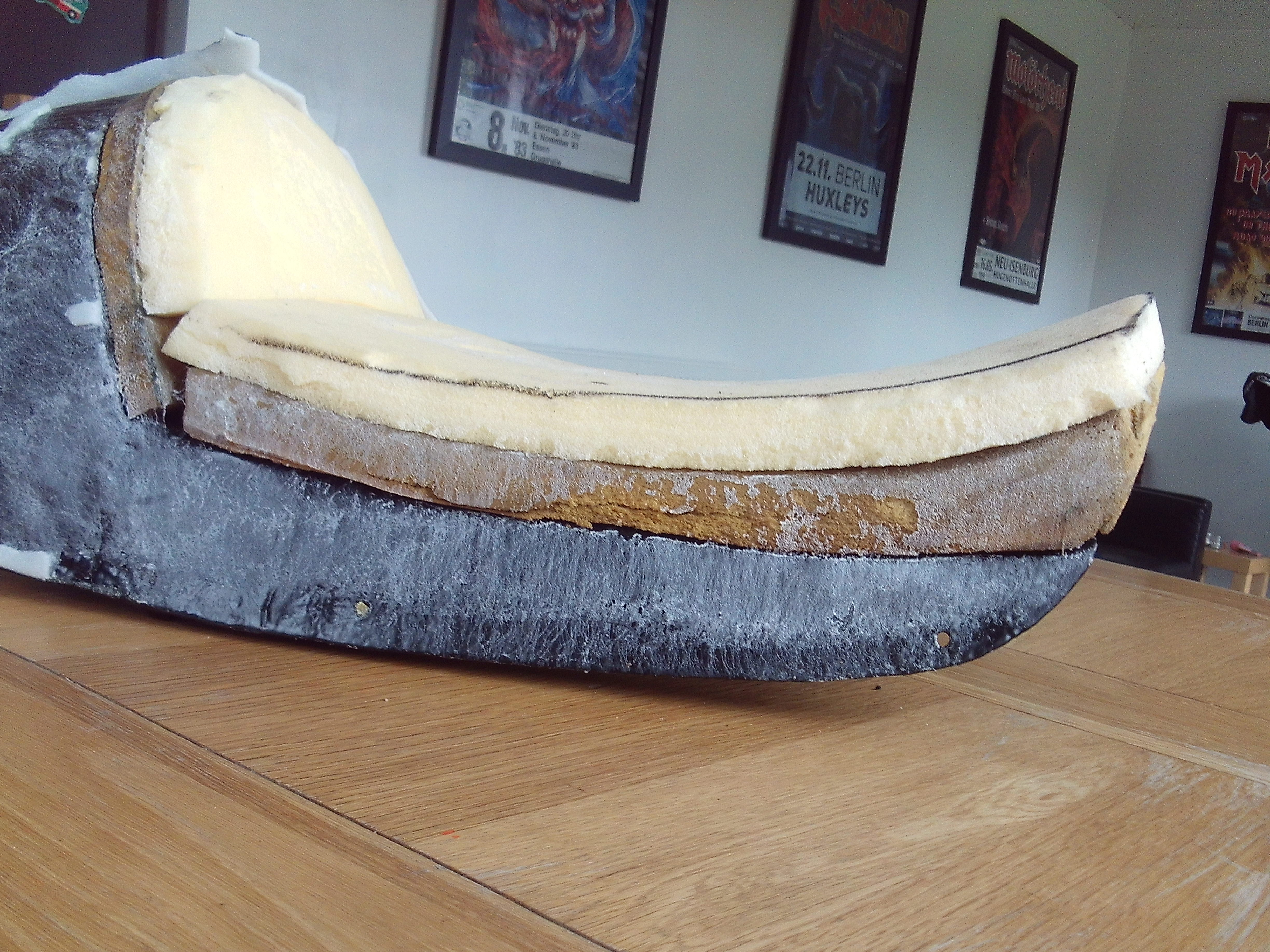

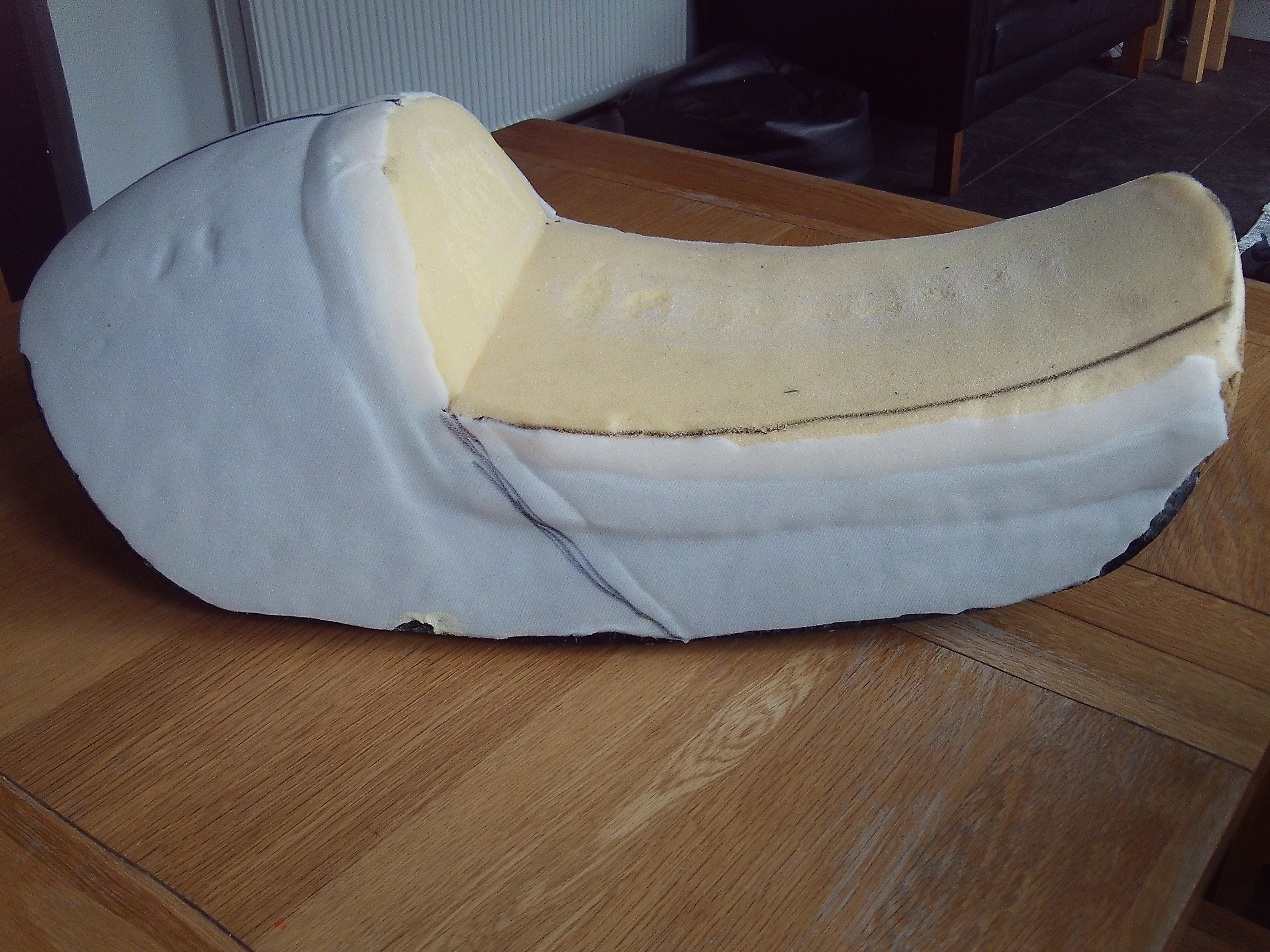

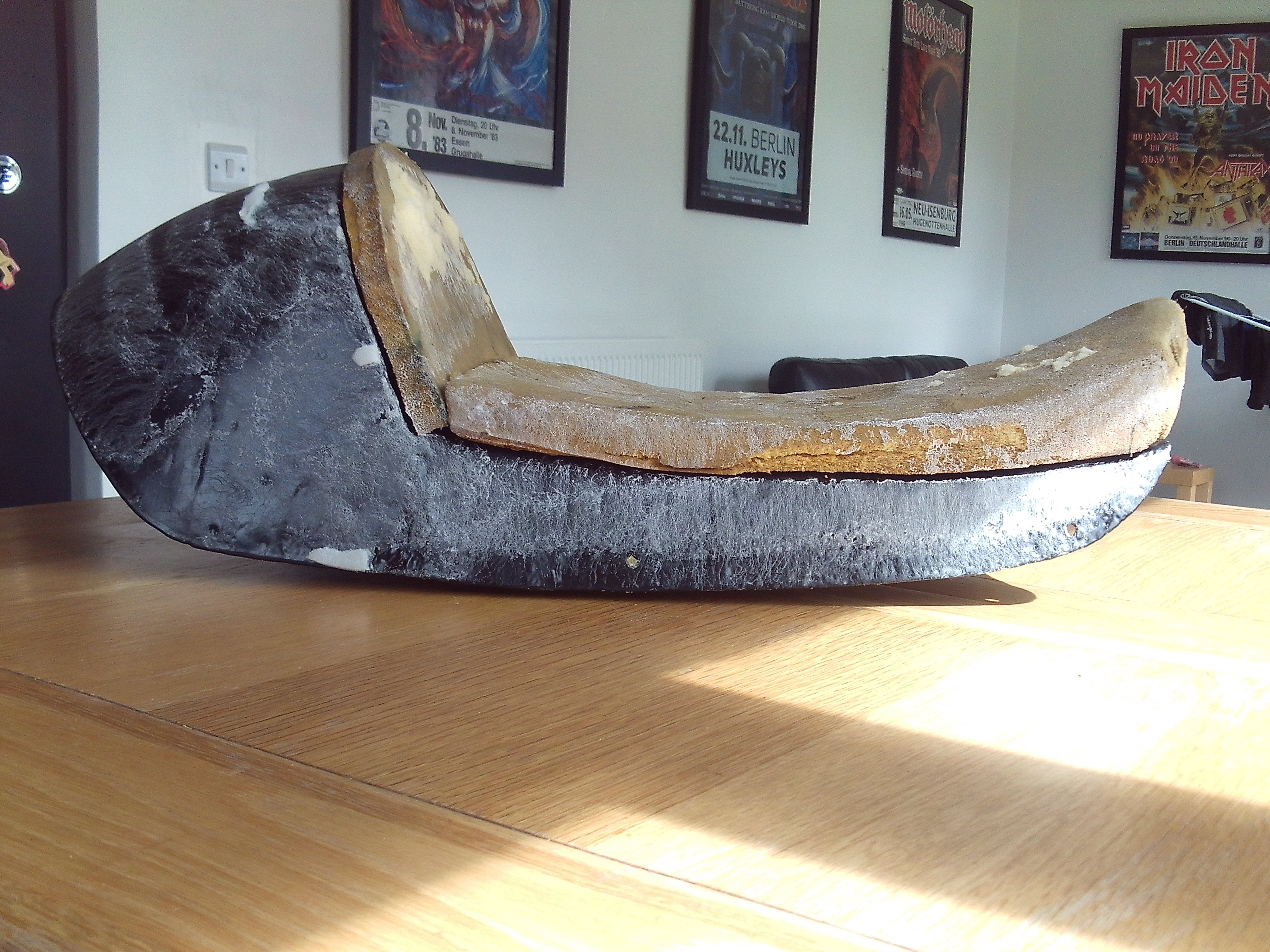

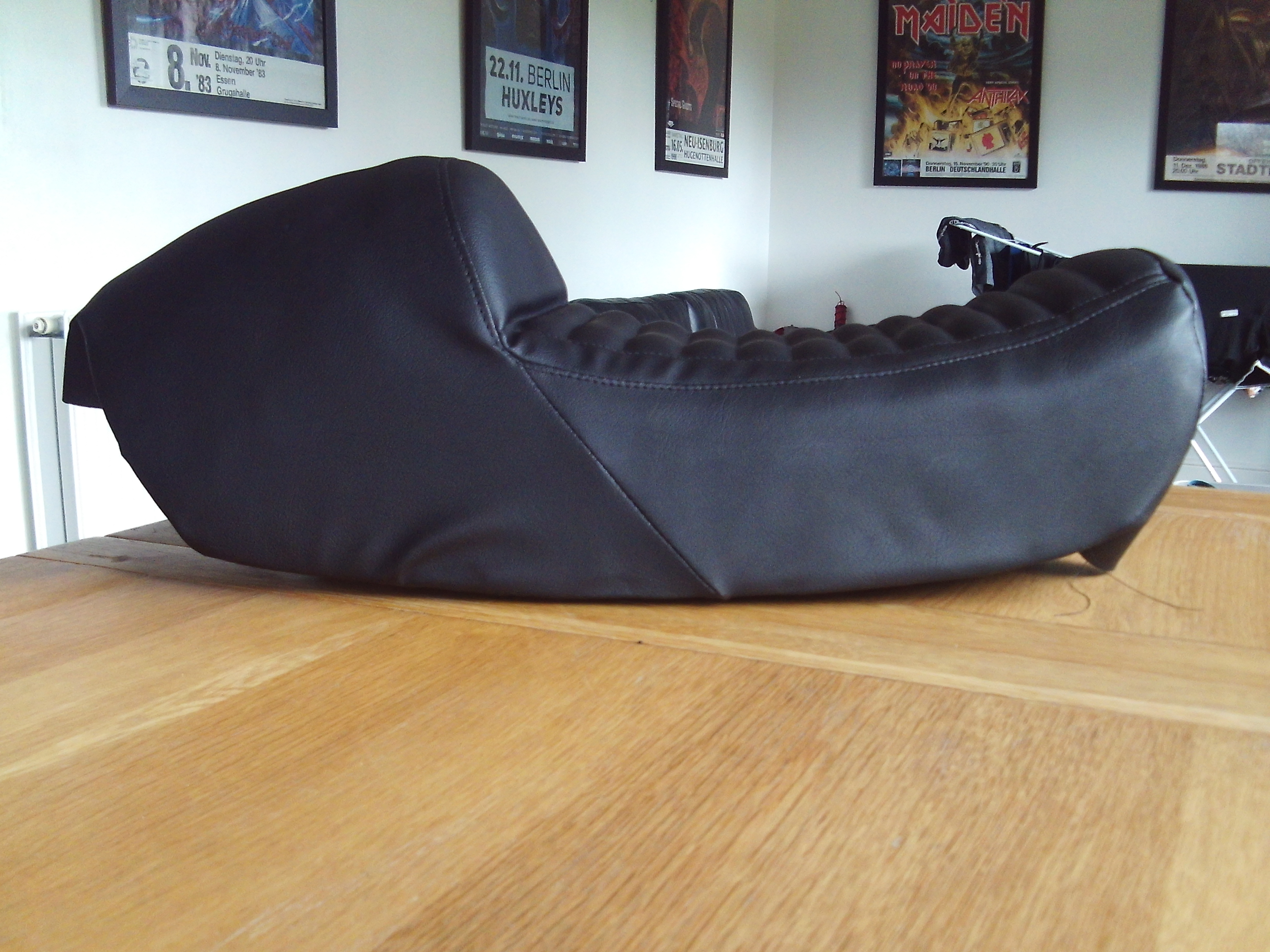

What the hell is wrong with some people ???
Eight weeks ago i took the cut down and freshly powdercoated Giuliari seat and re profiled foam to get re upholstered and re- covered to a local firm - RETRO REFITS - that were highly recommend. ( apparently by idiots with low standards :roll: )
After several meetings accompanied by plenty of detailed pics and measurements of the seat on and off the bike showing gaps etc i left them with strict instructions to replicate the shape of the old cutdown foam in a higher density version which i chose and then recover the seat in the exact style of the original with the same three panel layout on the hump and even supplied an original cover to template from.
The idea being that at first glance the seat would retain something of it's original uncut propotions

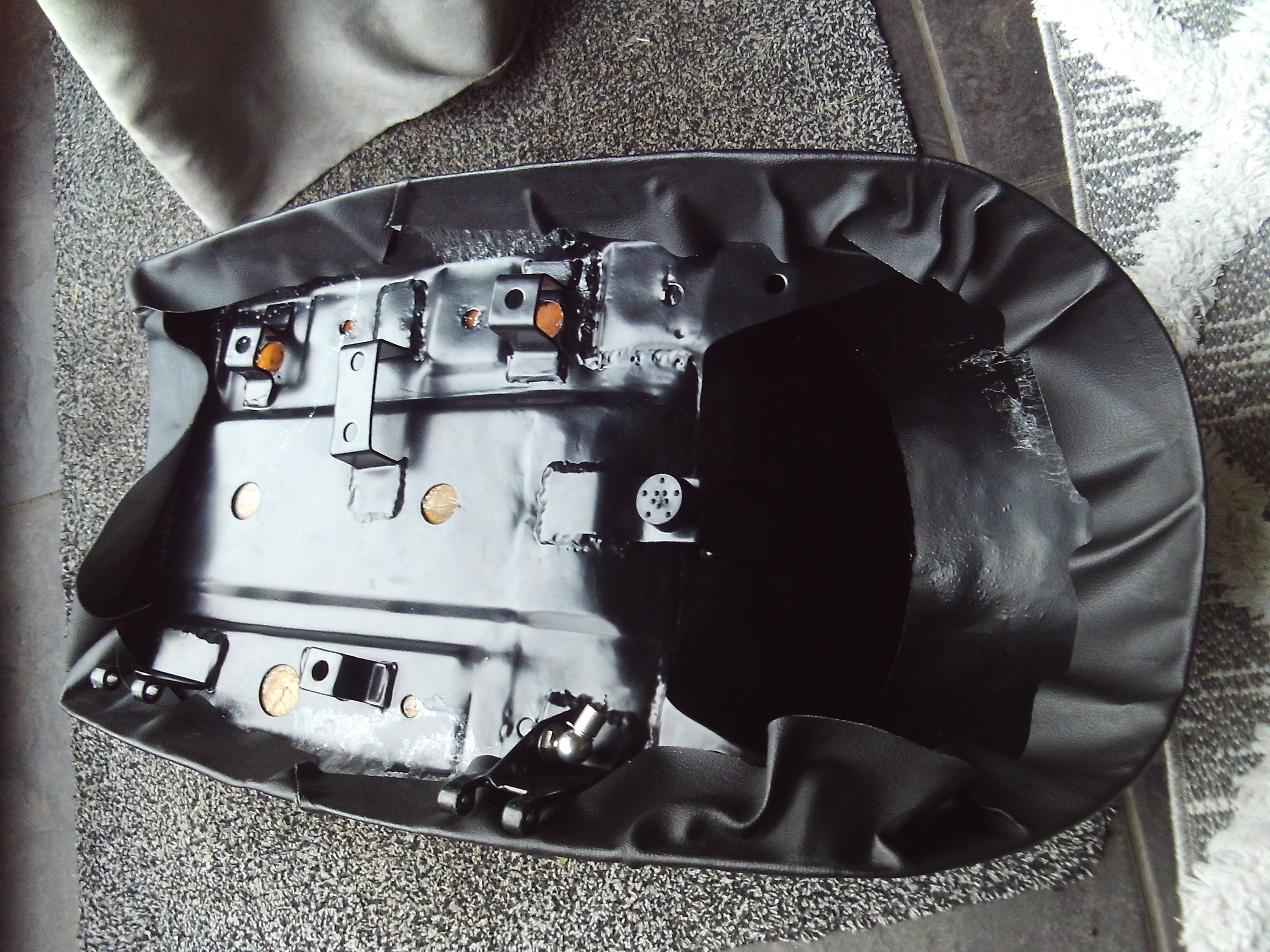

After a couple of "delays" and another visit to their shop i got a call on Monday to say it was done and when i picked it up i was greeted with this abomination which vaugely resembles something between a beanbag and a puffer jacket..
:evil: WTF!
Gobsmacked is an understatement
They have totally ignored everything we discussed and done the exact opposite to the worst quality of work i have ever seen which virtually fell apart in my hands.

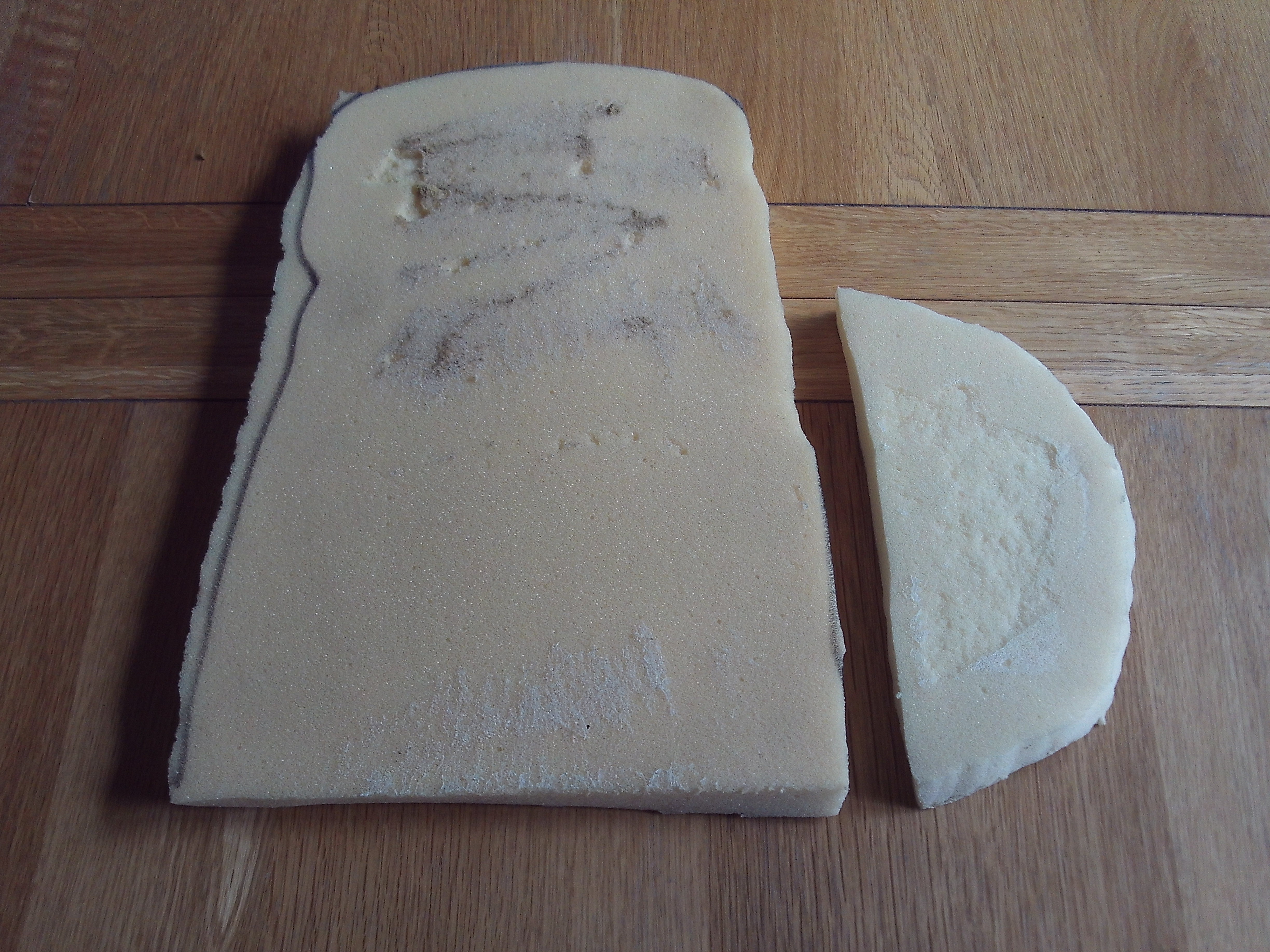

Obviously they didn't get their money and when i asked for my old foam back they said they couldn't find it but by the thickness of the padding and the view through the holes on the underside i had my suspicions.

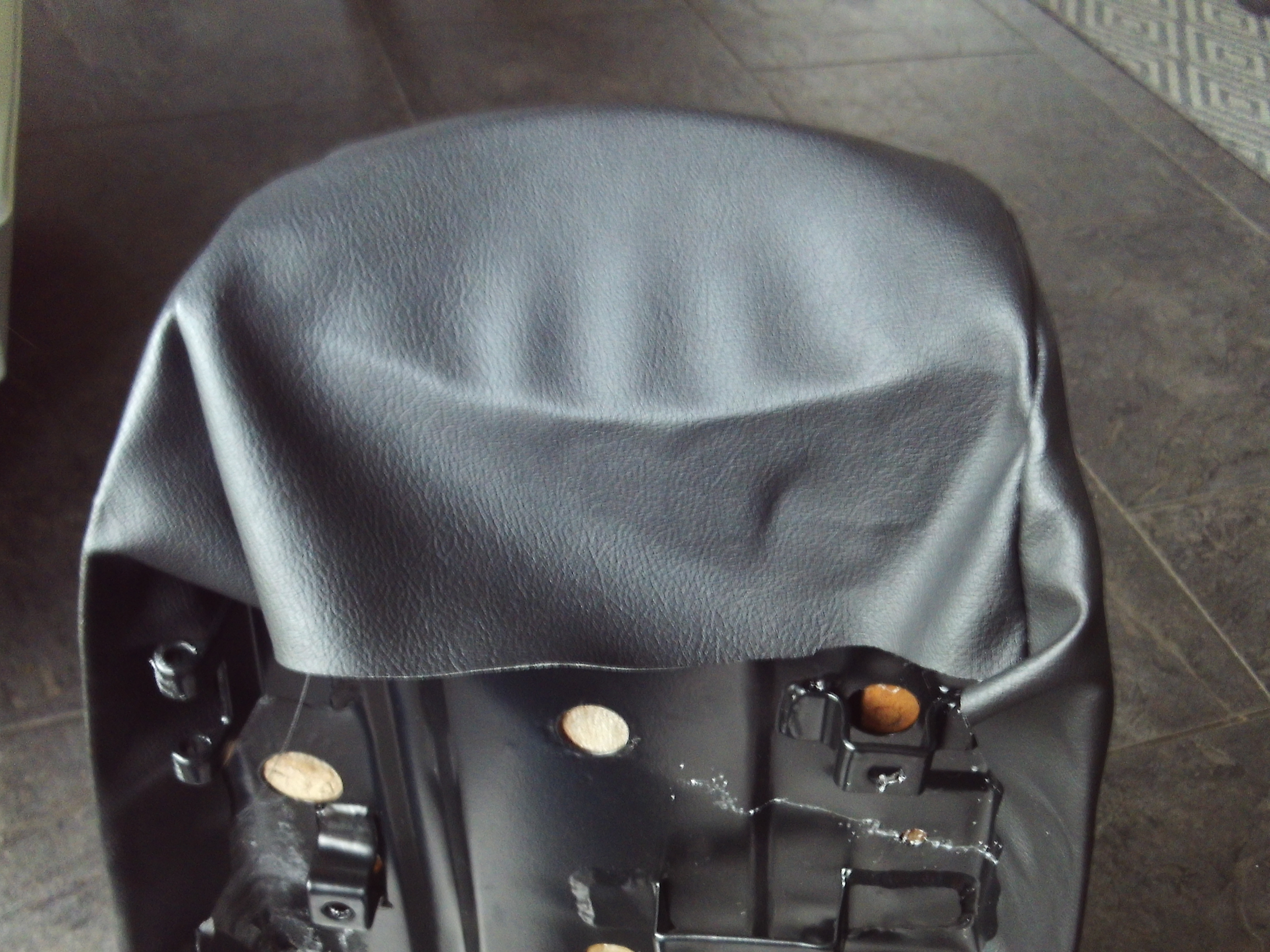

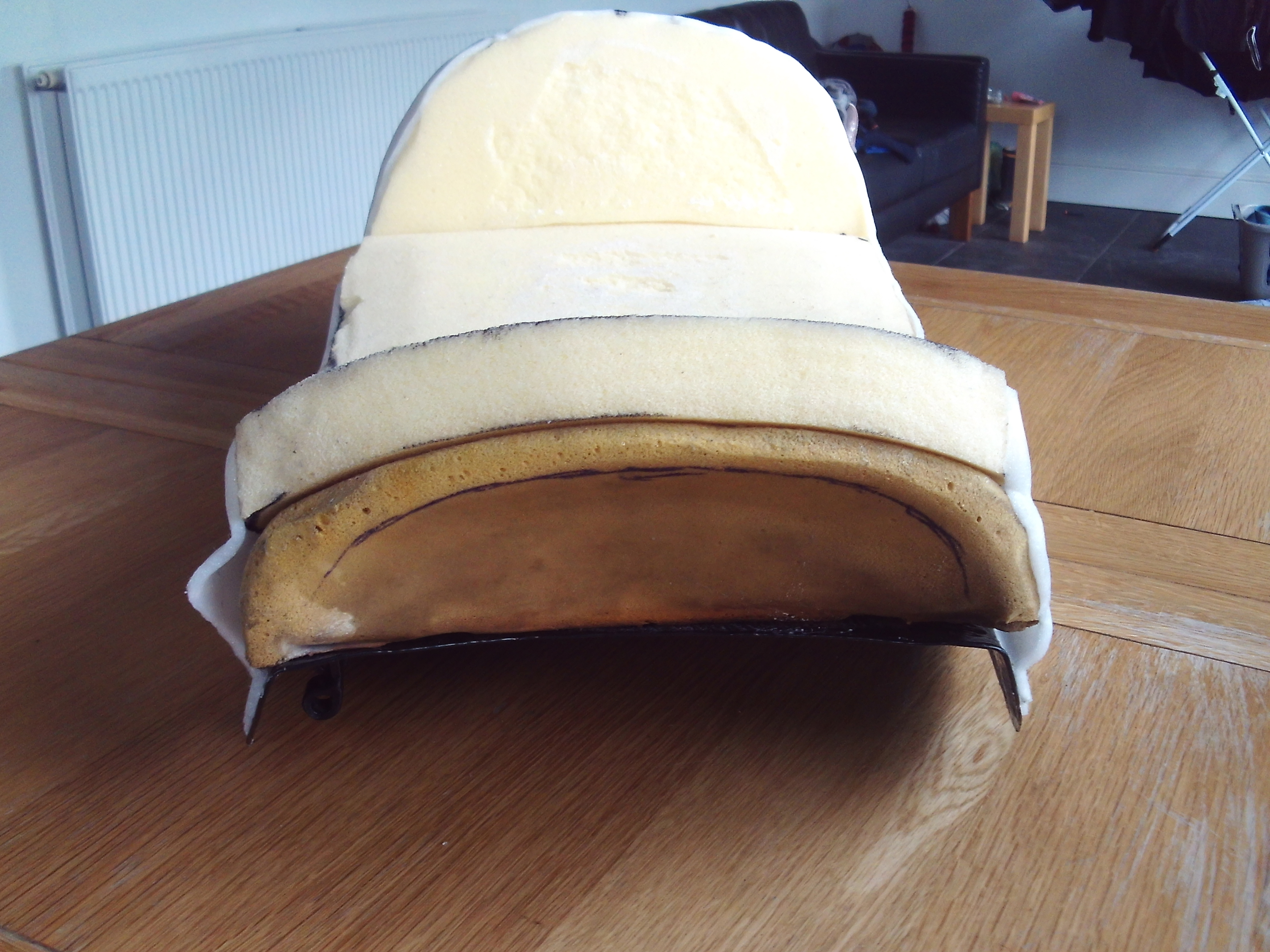

So once i got it back home i pulled the cover off.....
And lo and behold !
There's my old reprofiled foam (which was supposed to be used as a pattern for a copy in high density foam) under another inch or so of padding that looks as if it's been hacked from an old sofa .
I currently have nothing more to say .
