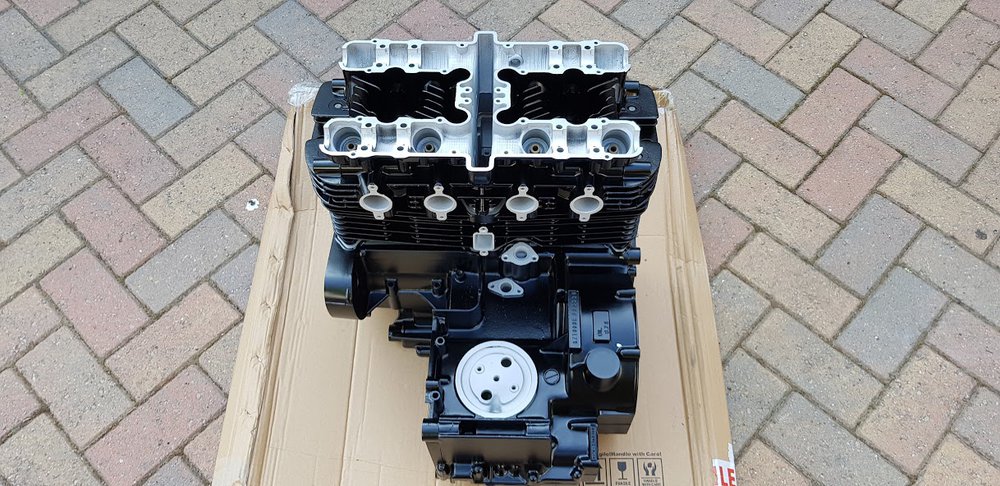

Here are my Z1R cases. I had them blasted and 2 pack painted by R D Cox in Reading. That was 4 years ago and they still look like new 2500 miles later.

#21 PostAuthor: wheelysteve » Wed Jan 17, 2024 7:17 pm
Here's how it looks after 4 years......
