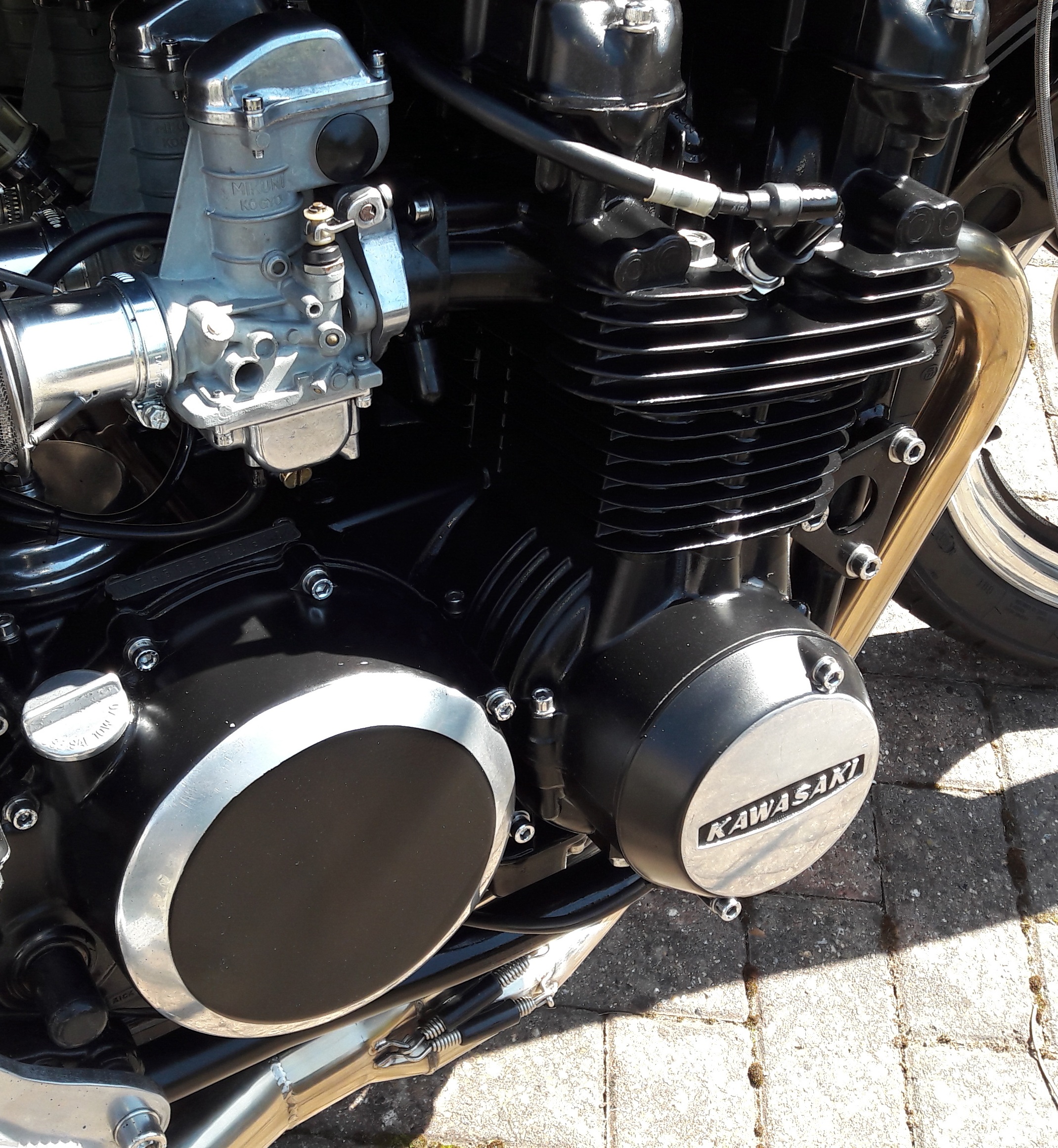

Simonez tough satin after about 5 years and 10k miles.

Nothing other than a good degrease and ensure dust free.
Pre heat the metal with a paint stripper gun and pre heat the paint by standing the tin in a bowl of boiling water. No primer required.
It's touch dry in 10mins so be sure to clear the nozzle immediately or you'll be wasting half of every can.

Here is the barrels and crankcase on build up. I also had the head and cam cover done. Has lasted well on the endurance bike
