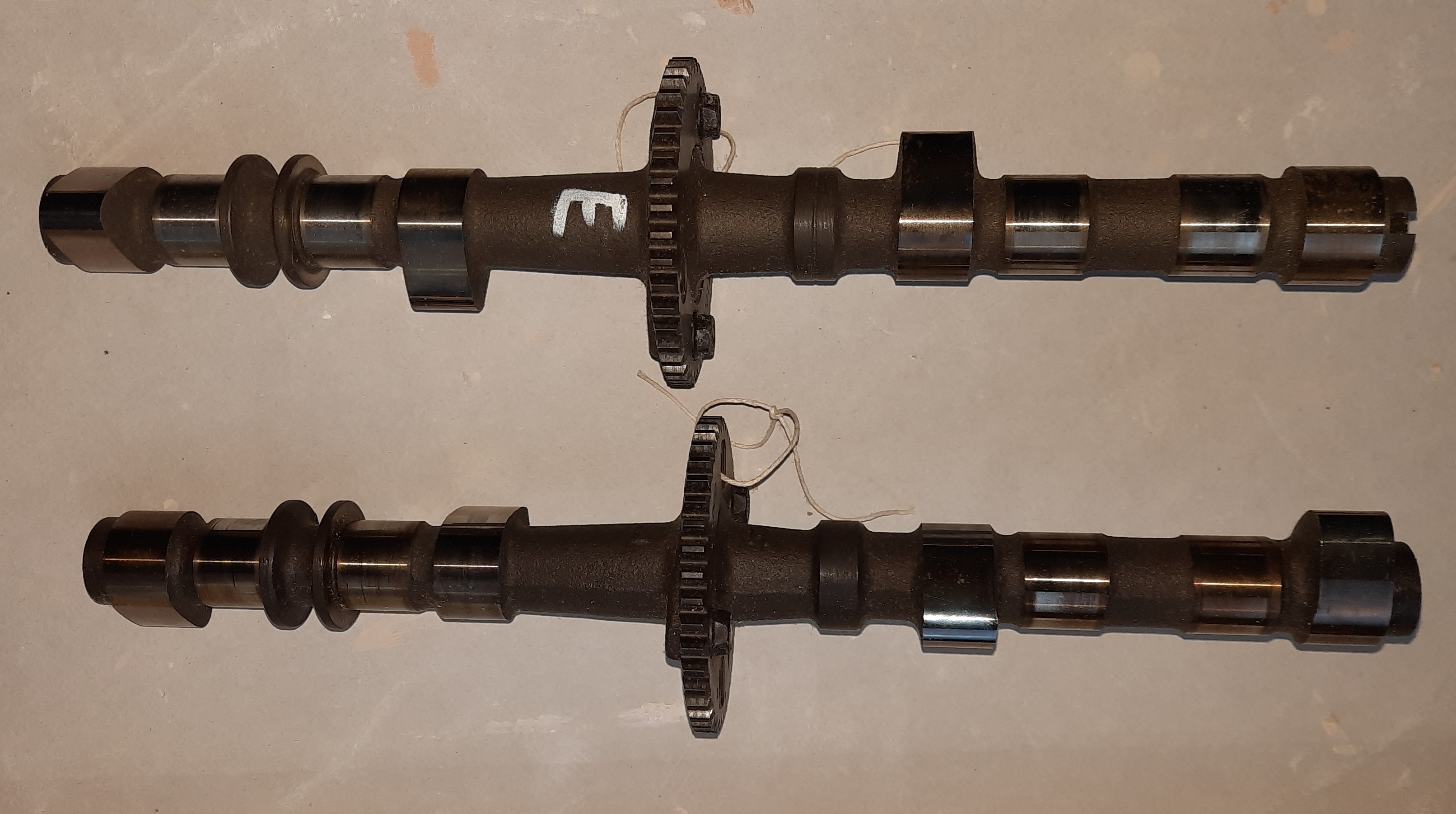

I've always liked the Z1000R2 having owned one from 1987 to 1992 and have fond memories of what a great engine was in that bike. Well I have started this new project with a Z1000 engine circa 1981. The engine arrived on Monday and a quick look at the cams showed it to be a Z1000M. I had anticipated this and had already purchased a set of camshafts for a Z1000J, so will build to J-spec hopefully.

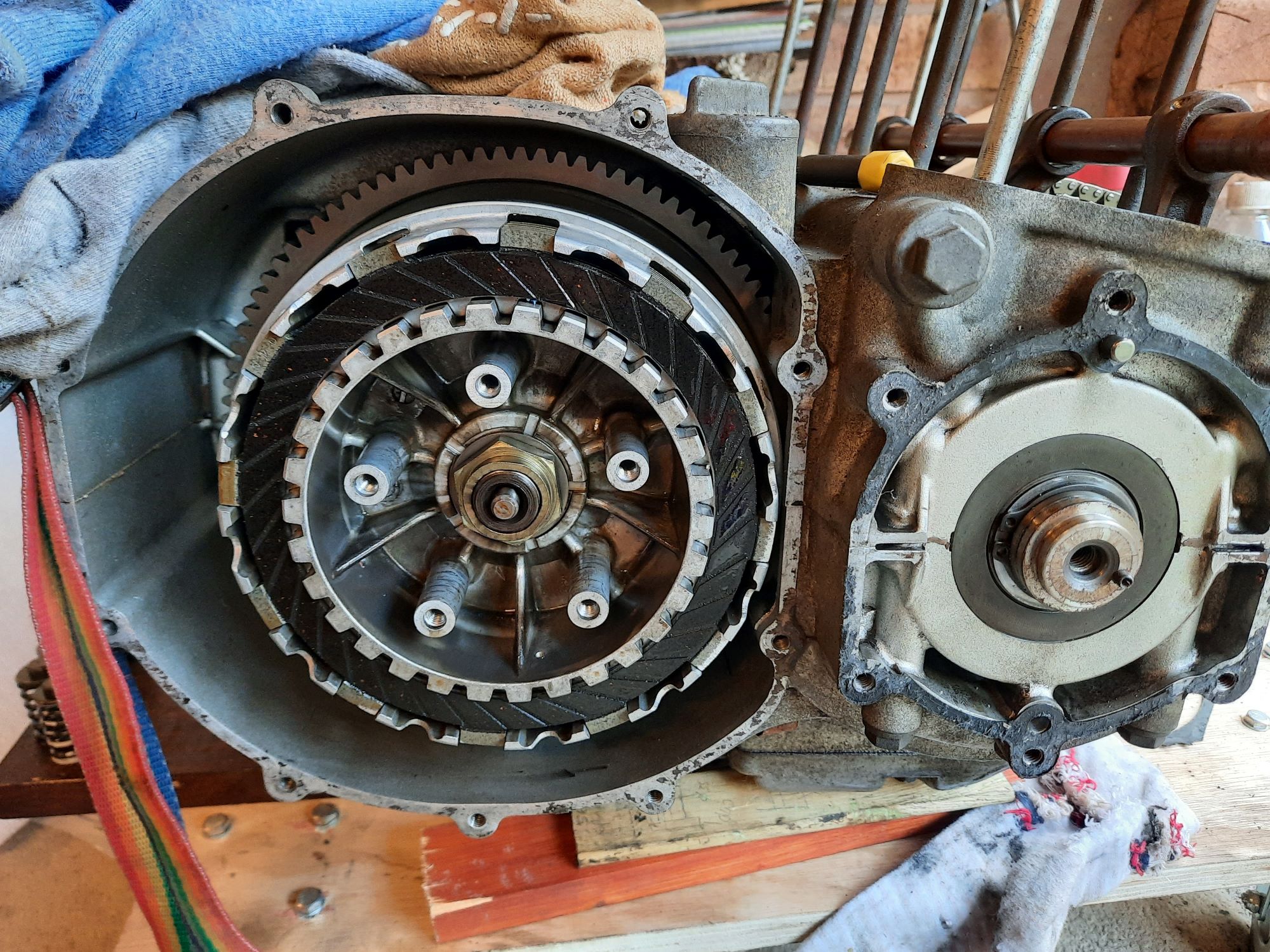

The alternator rotor was covered in hard red sealant / glue. The sump pan was full of the red bits that had dropped off the rotor. I guess this is a replacement magnet that someone has attached to rotor with the red stuff? Anyone come across this before?

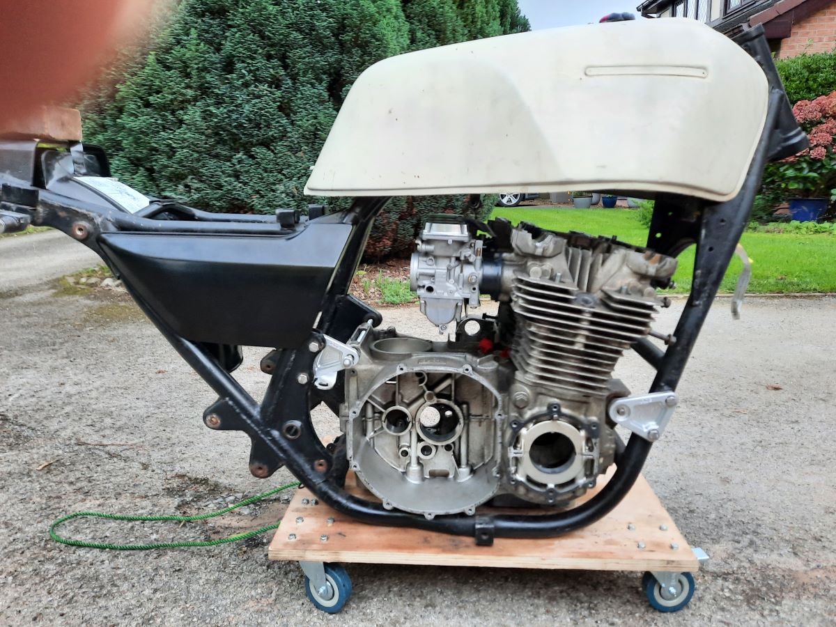

This is the first chance I've had to put the engine in the frame with the engine mounts supplied by Z1OC member. Thankfully the engine fits correctly into the frame without any issues. I also put the carbs on so I could check that the fuel tap can operate without snagging on the top of the carbs since the tank is from a GPZ11-B2, all good also. I have an old seat coming that I plan to convert to ELR, I'm sure that will require some work to get it to fit....Also in the process of cleaning the engine casings.
Split done with clutch basket and alternator still attached, thanks for the help on that one.

The rotor is stock and it's common for the " red stuff " to flake off.
Just make sure the magnets are secure.

Clutch friction plate is in back to front, others also perhaps.

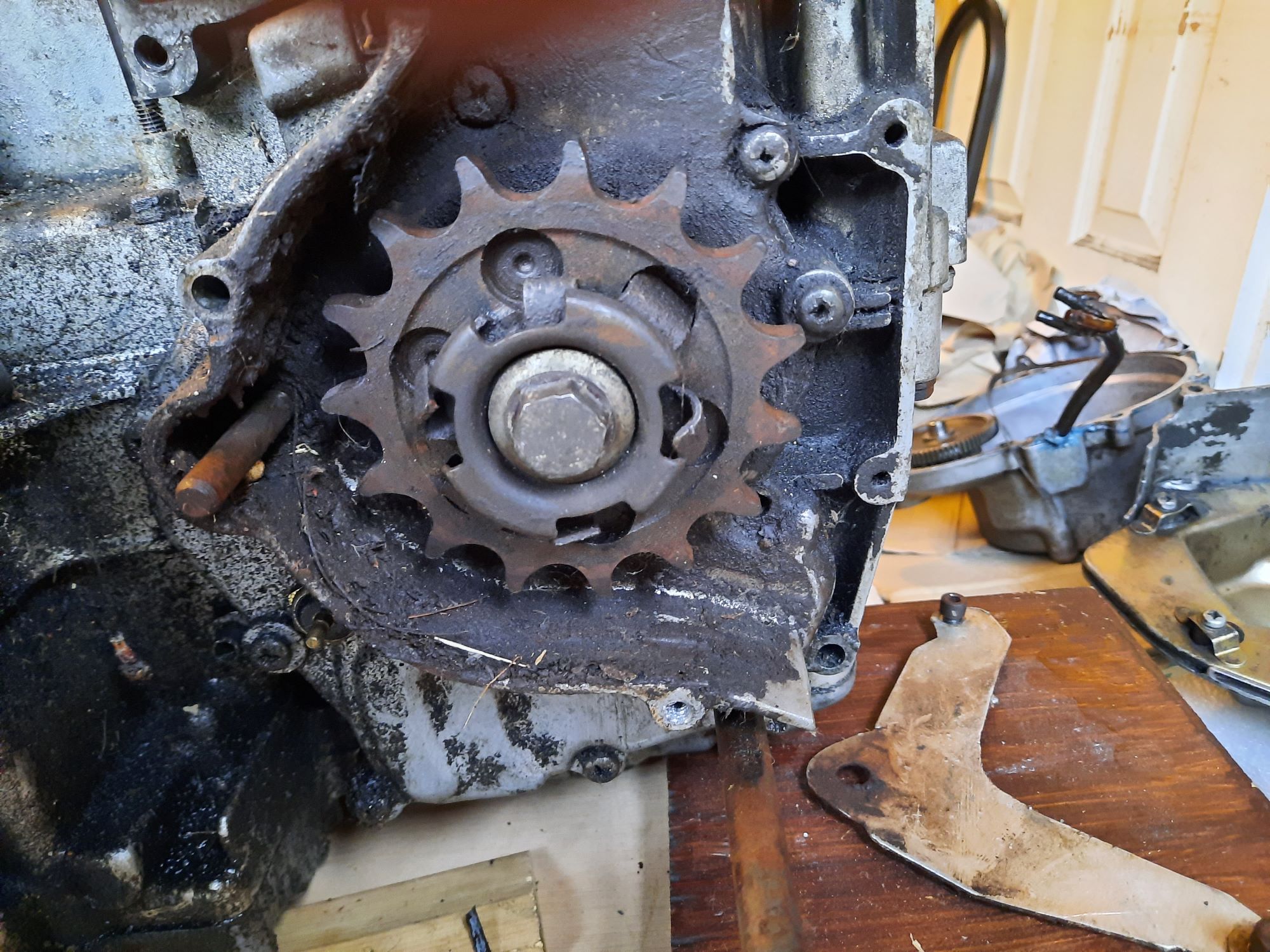

Outer dished part of the sprocket lock mechanism is on back to front. It has a double hex which locks the head of the bolt.
You can masking tape across the front face of the rotor drum after a good clean up and fill the gap with ordinary Araldite. Gravity and three seperate sittings but worth it in my own experience. It goes a long way to keeping the magnets in place if any come loose!
Al, thanks for the info on items you have seen that had been assembled back to front years ago!. Most helpful advice and more than welcome.
