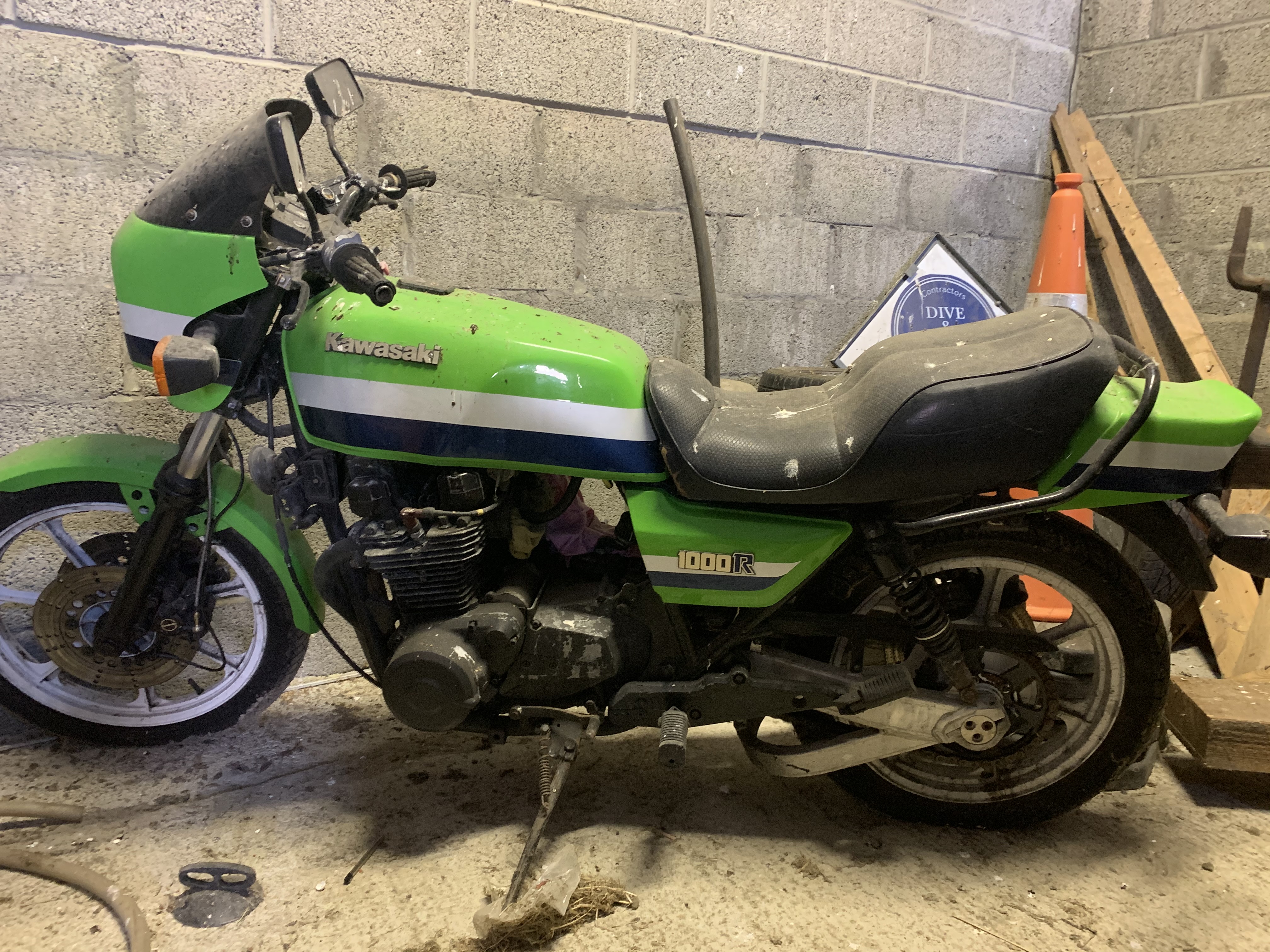

Hi, Just a few pictures of what I've been at over the last 15 months or so. I'm starting to get close!!
I think I nearly crashed the site putting up pictures so I'll try a few small batches.
Sound advice always welcome.
P
This one is before I started BTW, not what I've finished with!!

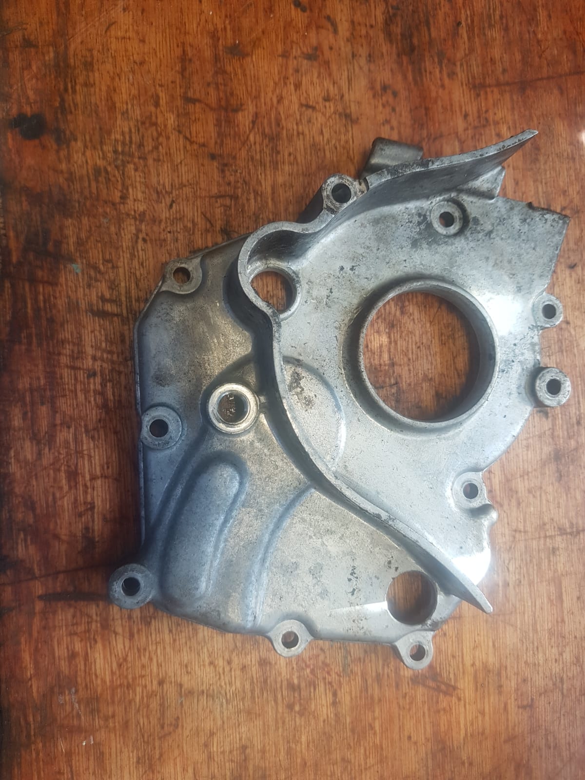

Fin repairs.

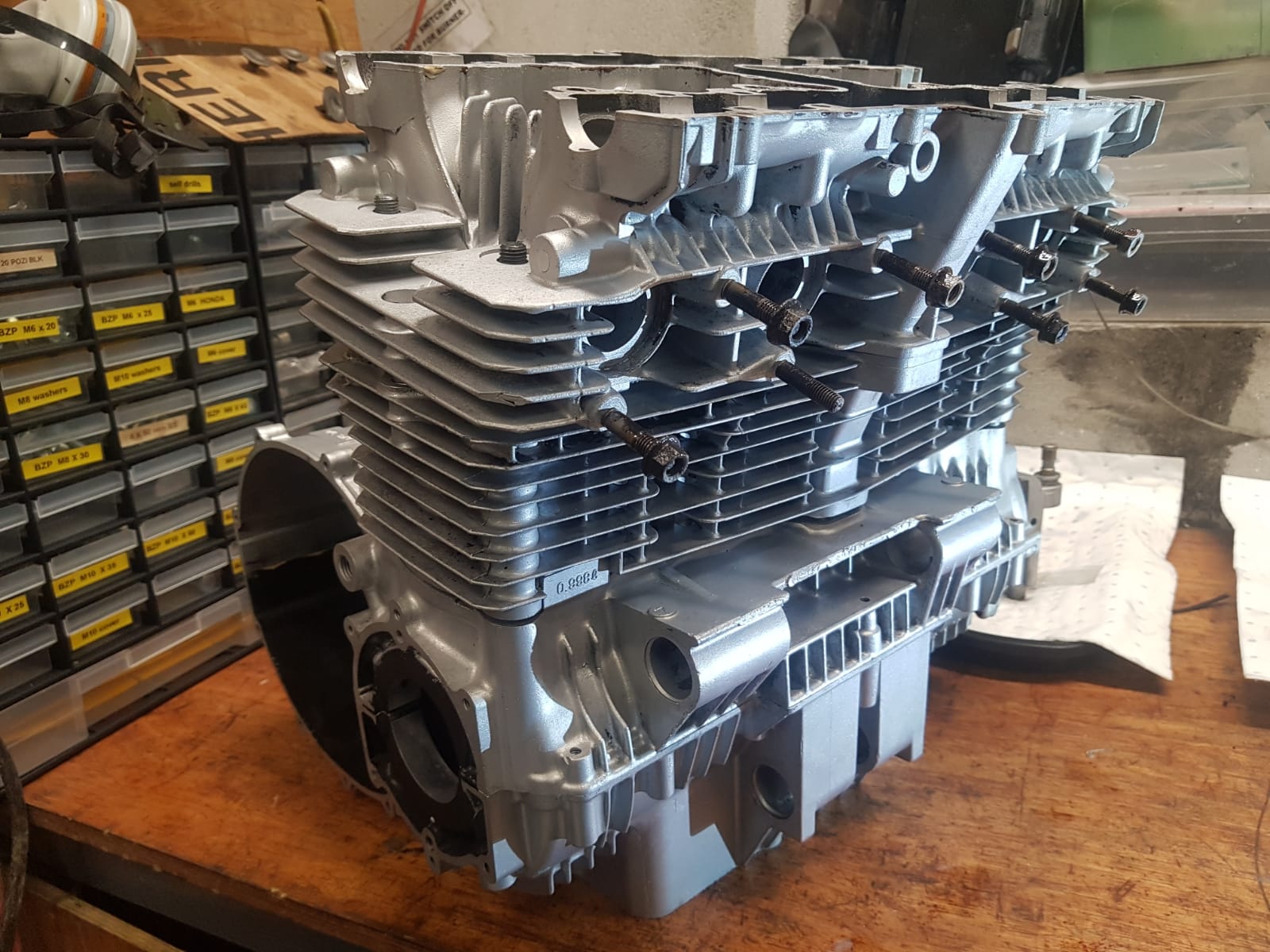

Vapour blasted parts

Skid Mark wrote:Vapour blasted parts
Very impressive, great documentation!
Did all the color came off like that just with vapour blasting?
Cheers, Uli
Skid Mark
Posts: 471
Joined: 23rd Oct 2020
Location: Kilkenny, Ireland
Re: Z1000r refurb
#14 PostAuthor: Skid Mark » Sun Feb 06, 2022 7:56 pm
Hi Uli,
I have photos somewhere of the casings stripped and cleaned. I used industrial stripper, much stronger than the stuff you buy over the counter. For any steel bracketry I used a mapp torch, just a quick flash was enough to blister the paint, it scrapped of easily when still warm or it would brush off with a wire brush once it cooled again. The photos I have here were probably after the inital go with the chemical stripper, most part took two goes, the brakes and the like took up to four goes.
The vapour blasting only took of any corrosion and very small specs so the items all had to be stripped before I sent them off. At least that is what I was told before I sent them off.
