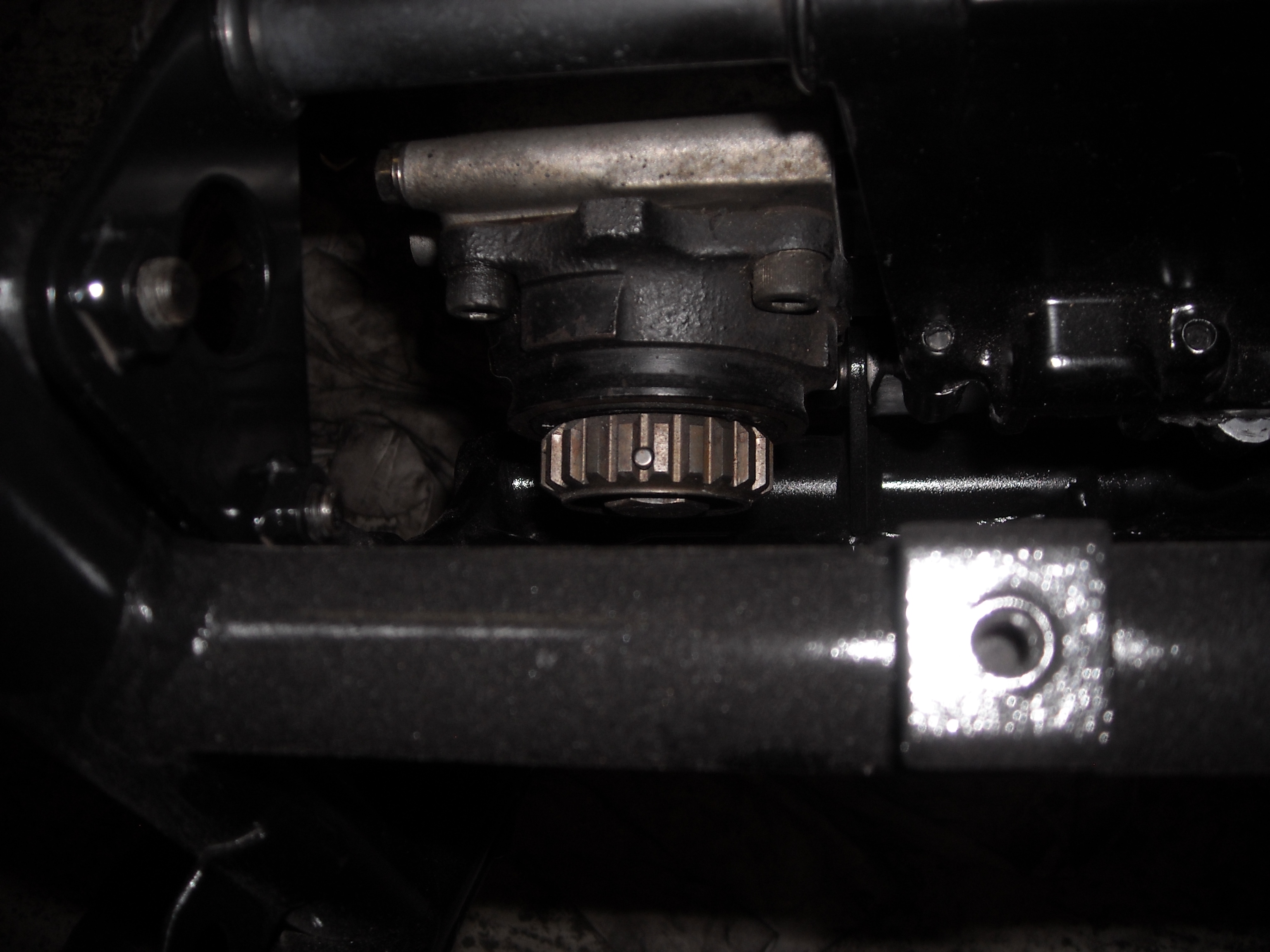

The frame received new conical bearing shells in the headstock and the steering stem was mounted.
After that, the front bevel gearcase was mounted and then it was time to mount the swing arm.
I decided to mount the drive shaft first. The last time I placed the drive shaft in the swing arm and it took me a lot of time to secure the drive shaft so this time I decided to mount the drive shaft first and then the swing arm.
When mounting the drive shaft don't forget to put the tiny pin in the front bevel gear case. This little pin secures the drive shaft and prevents it from coming loose when driving.
Make sure that the holes in the frame, where the shafts are mounted, are clean and lubricate them with bearing grease.
Before mounting the swing arm into the frame make sure that the rubber protective cap and the clamp are mounted on the bearing housing of the front bevel gear case.
Slide the swing arm over the allready mounted drive shaft and twist the swing arm in order to get it at the correct place.
Insert both cleaned and lubricated shafts through the frame and secure the swing arm.

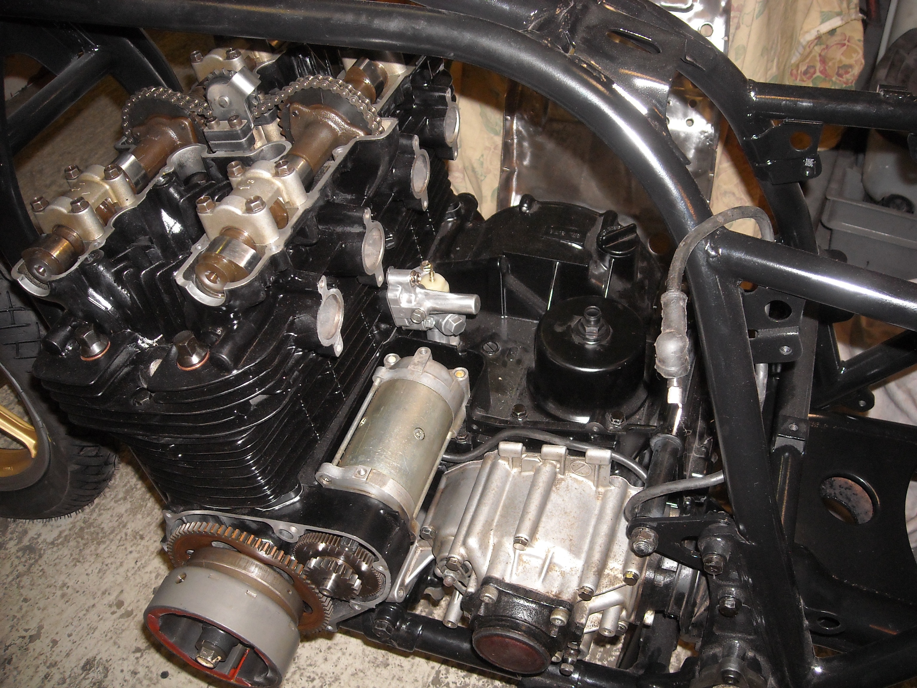

So it was time to do some assembly work on the engine.
The starter engine, the breather body and the oil passage with pressure switch were mounted.
Now it was time to complete the engine.

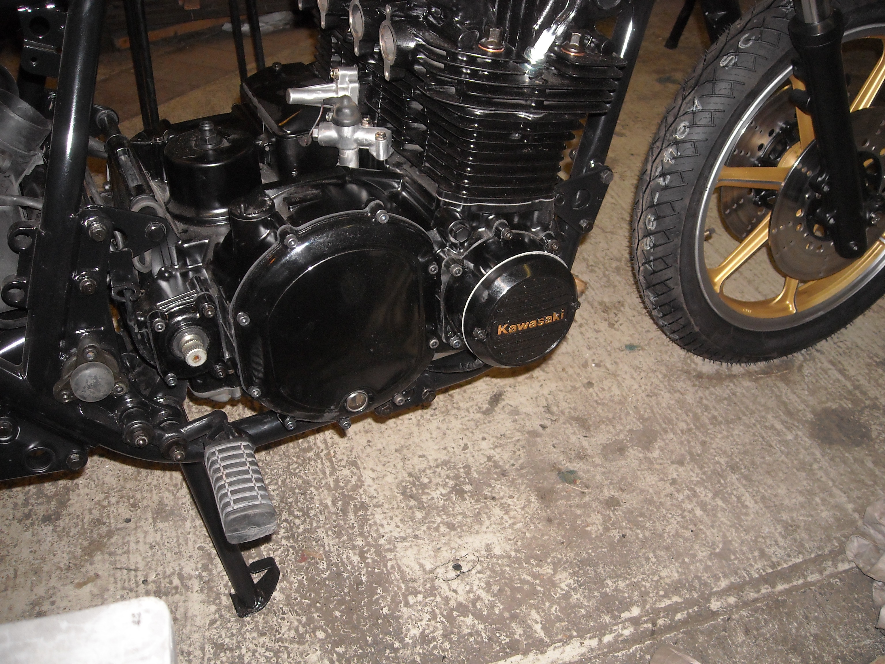

The engine covers were next.
They were painted a few weeks ago, received a glossy clear coat and baked in the oven.
This is how they look like when mounted:
The engine is complete and ready to receive oil!
