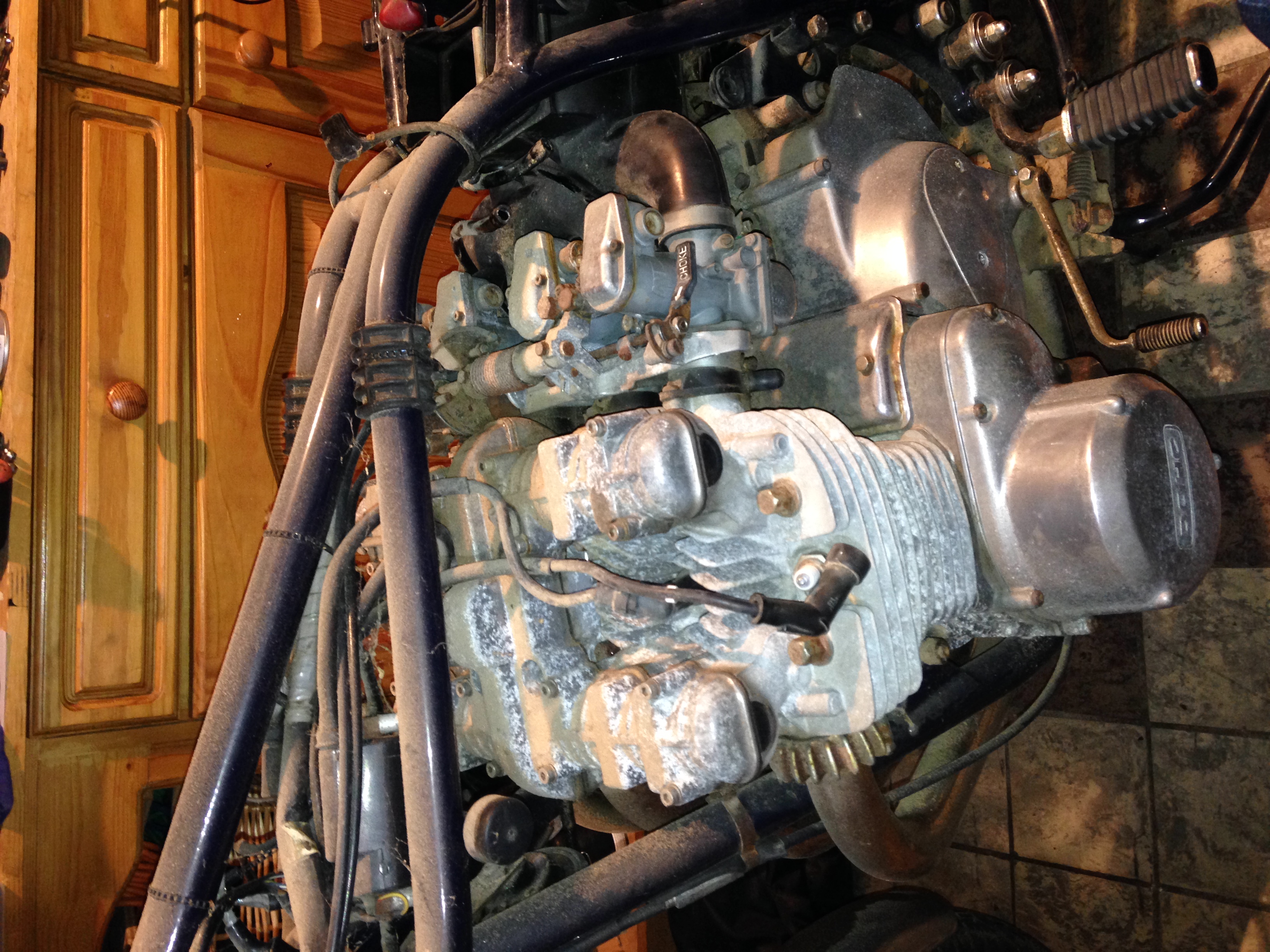

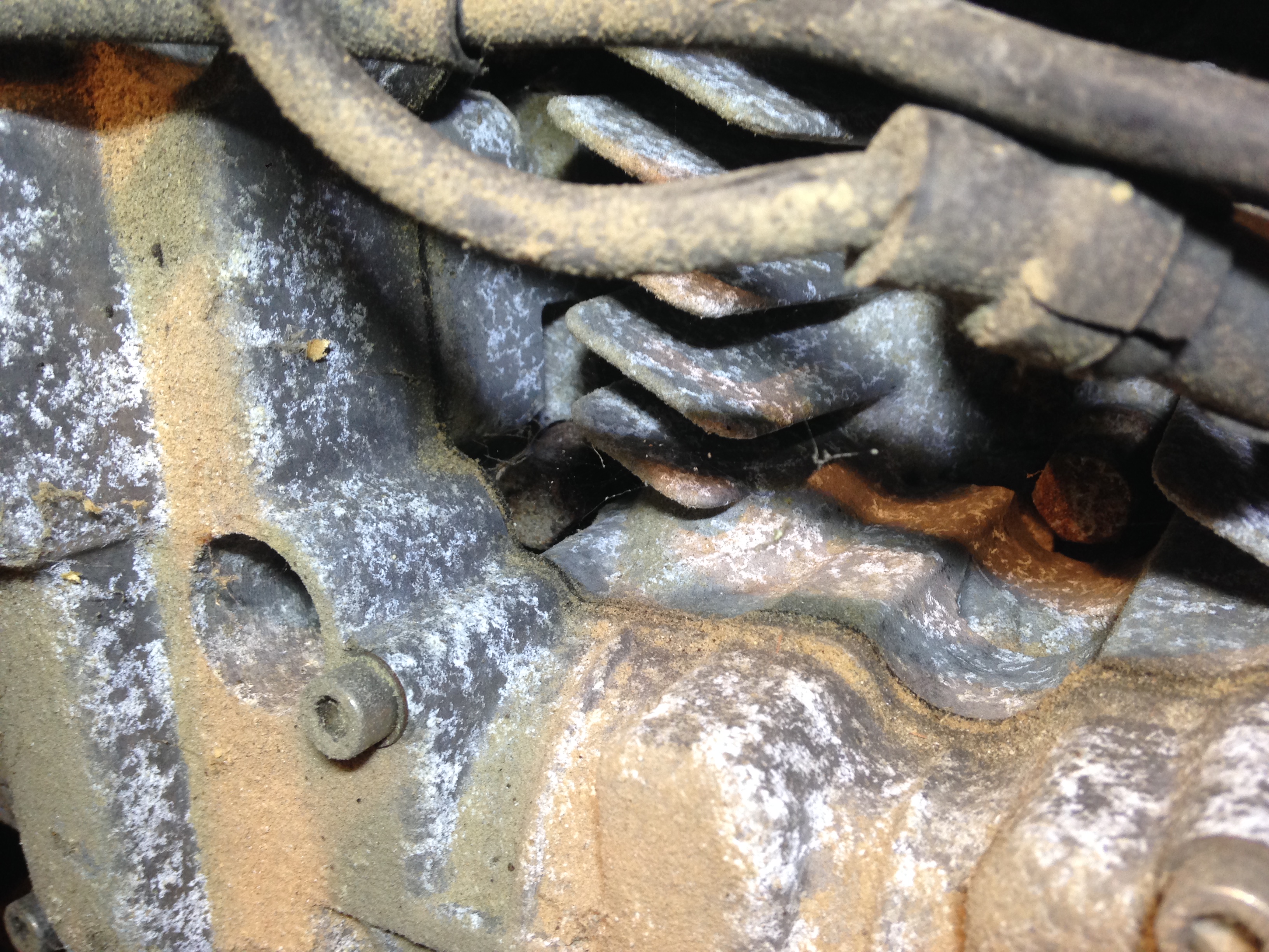

After I bought it, I started taking it apart. I wanted to do a full restoration. I new it's gonna cost me a lot of time and money. But the restoration is the best part!

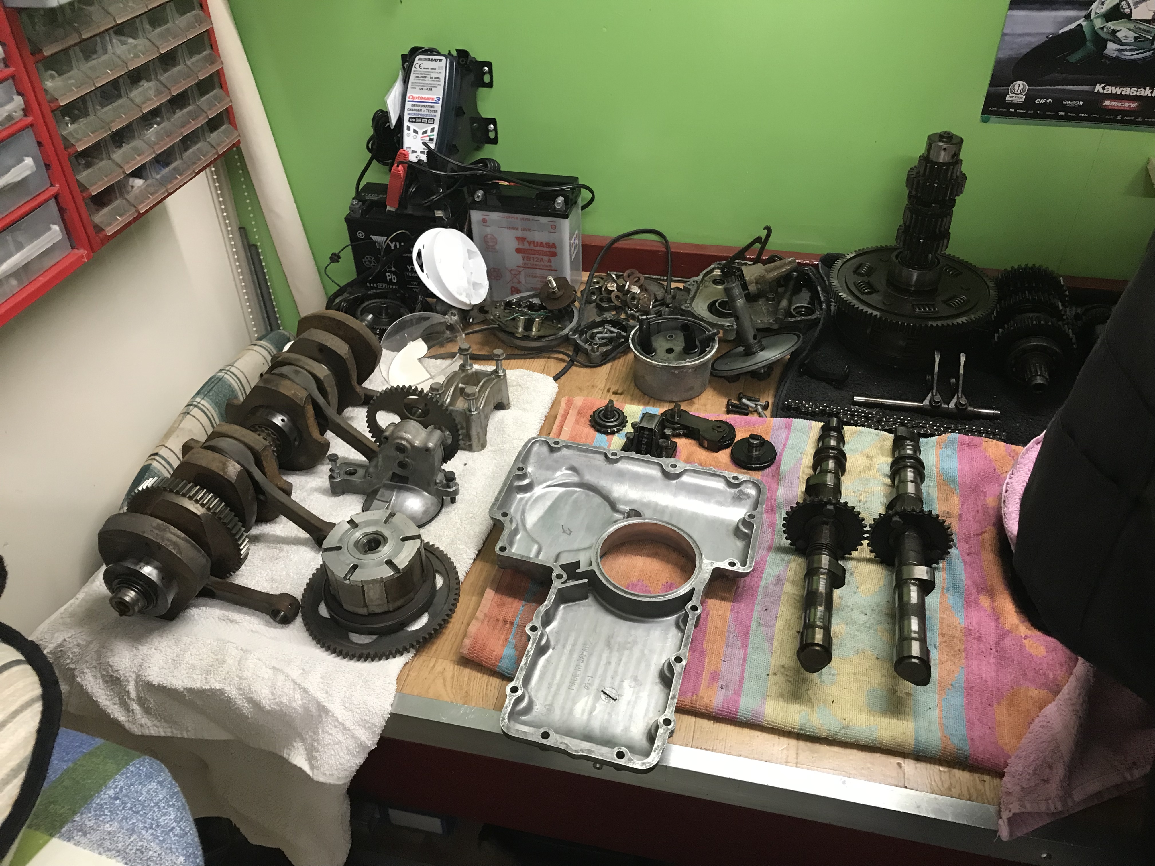

After that it was time to take apart the engine:

When the engine was apart I started vapor blasting all the parts:

great work you're doing! I can see that the pistons are first oversize (0.50). It could be usefull to install new piston rings and to hone the cylinders. If the bike stood so long there might be a little damage to the cylinder walls and the piston rings could be "tired".
Since the engine is completly taken apart change the complete distribution system, you won't regret it in the future.

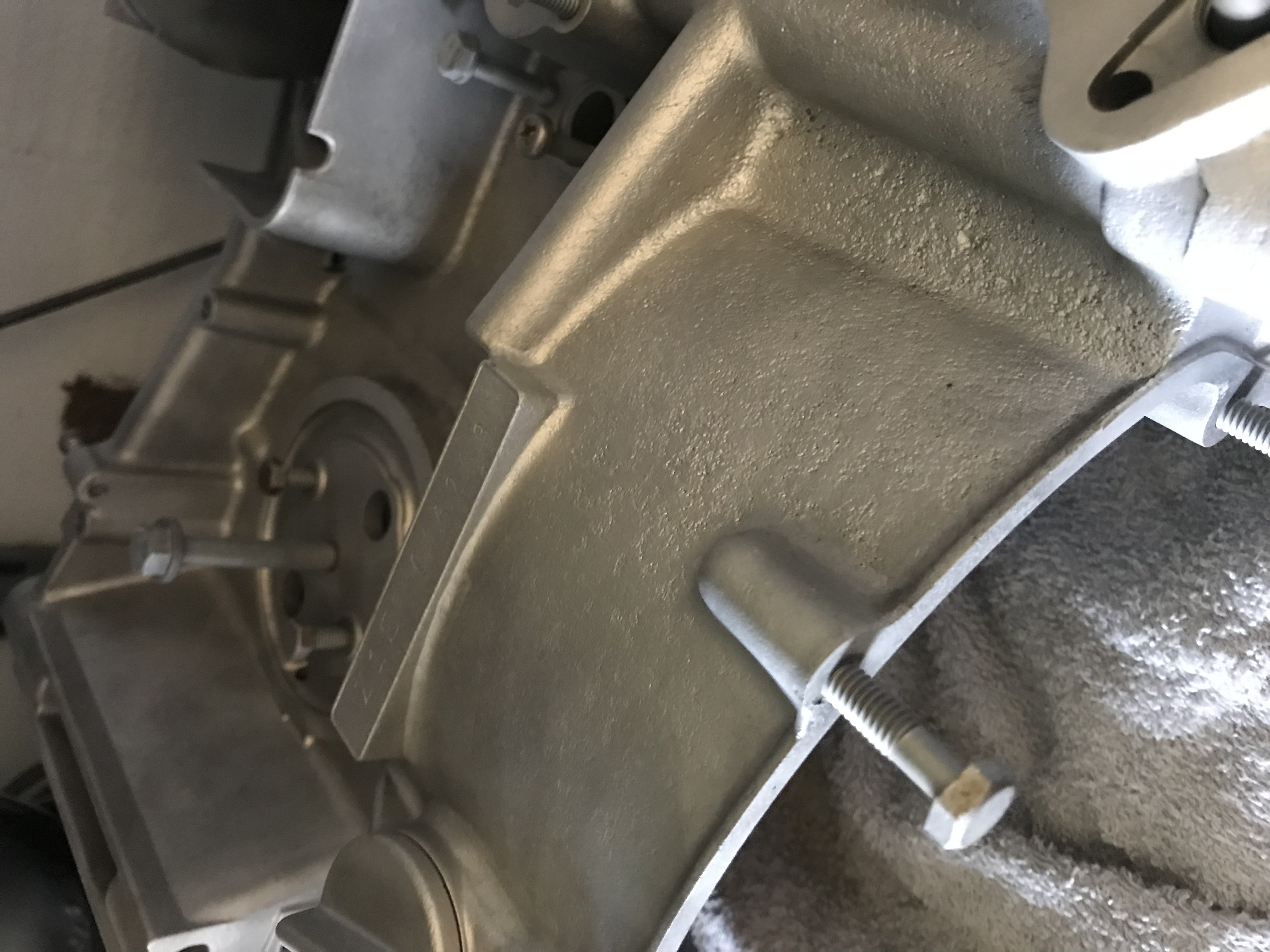

After a lot of hours vapor blasting it was time to build up the engine again. This was the result:

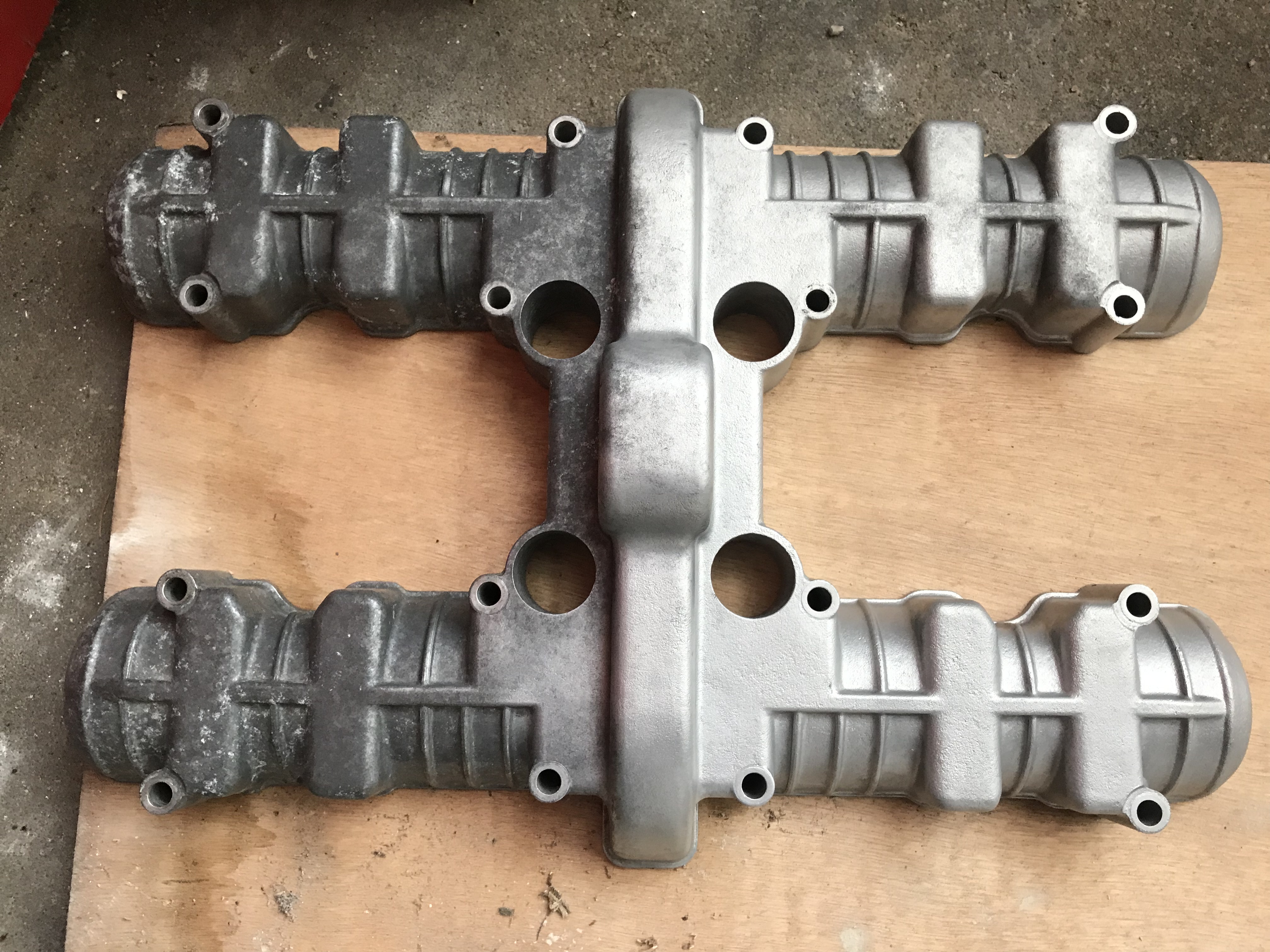

I forgot to take the cam cover to the polish company. But it got done with the other stuff, hub's and front fork tubes.
