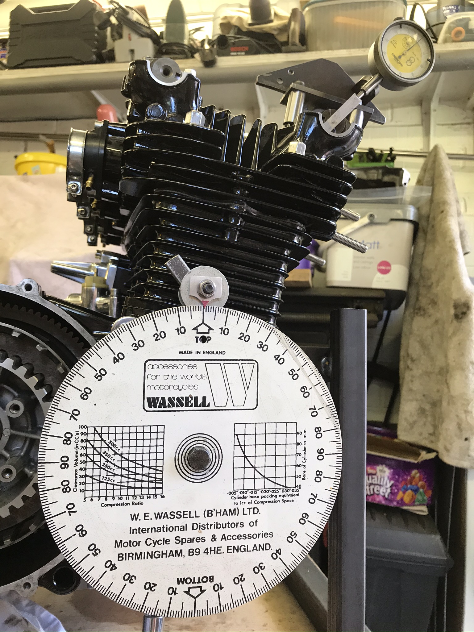

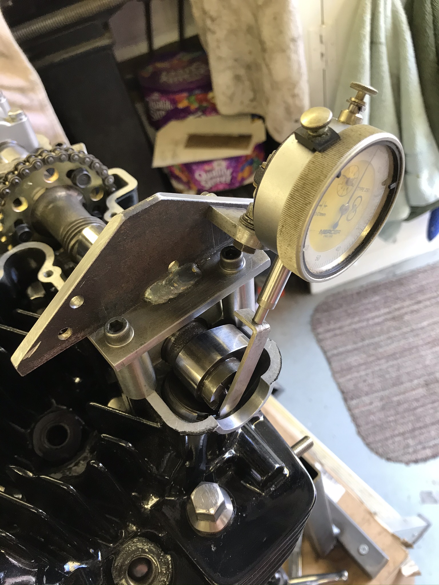

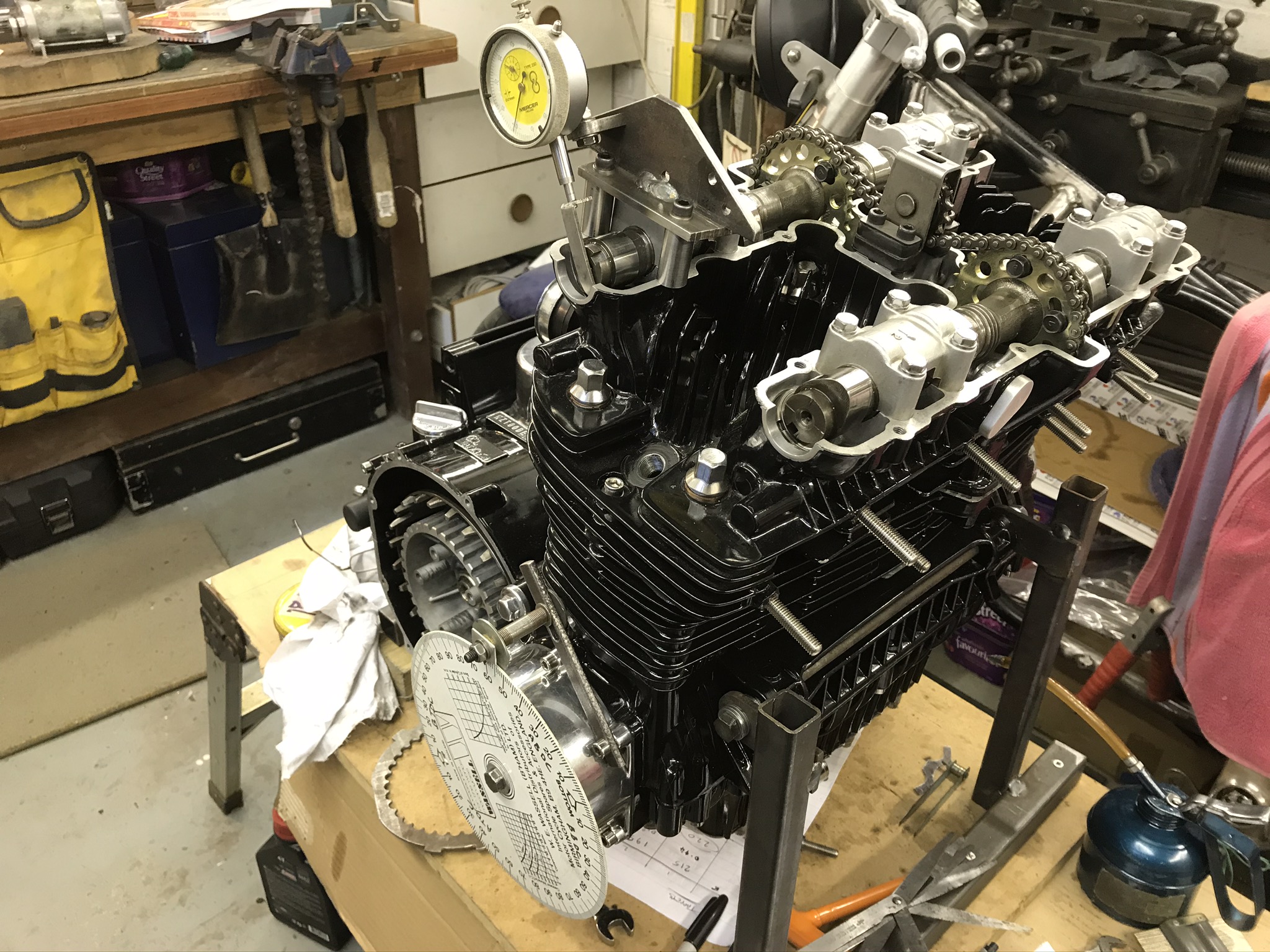

I got slotted cam sprockets, so I had to dial the cams in.
