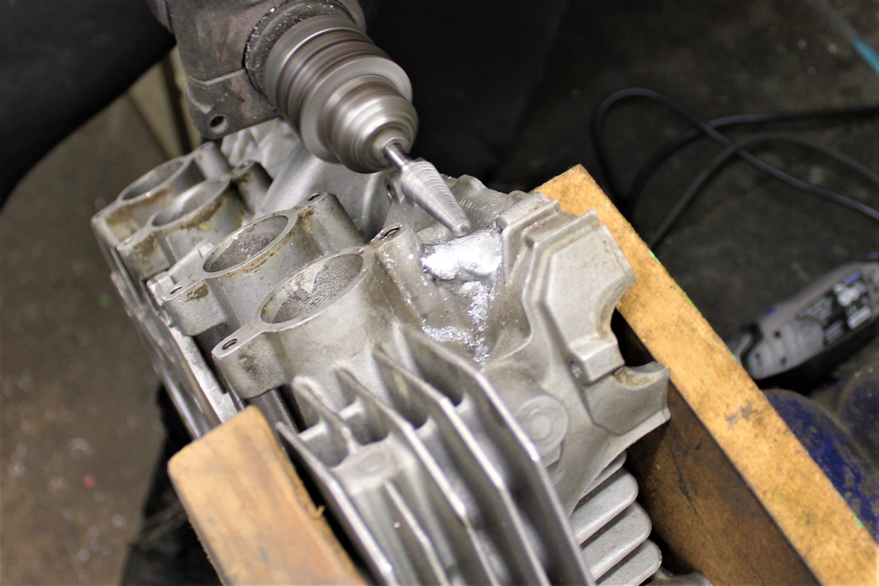

The good news is that the Zed head has returned with new valve guides and reground seats. But before it can go off to be ceramically coated to match the rest of the engine, the welded repairs had to be dressed to make them look a little more presentable. This was done with a hand drill, followed by a Dremel, and finishing off with some fine wet and dry sand paper. That done, I'll be taking the head to Camcoat tomorrow, hopefully I'll get it back before Xmas.
