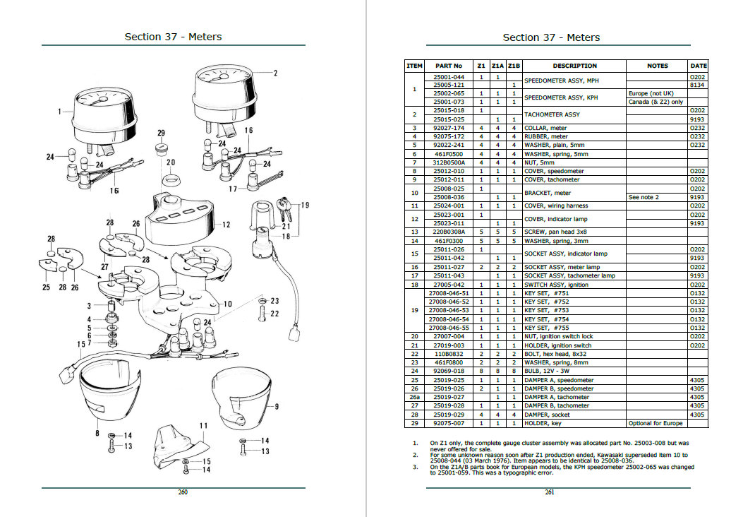

warren3200gt wrote: Where did you get the the 001 part number? Kawasaki.com and z1 parts qoute the 011 number for that part.
I believe there is a book by some bloke called John Brookes that Z-Power are selling. Here are the relevant pages
Posts: 3102
Re: Idiot lights
#17 PostAuthor: warren3200gt » Wed Sep 09, 2020 9:07 pm
Strange that khi's own parts list qoutes the same number when the 2 parts are clearly different.
