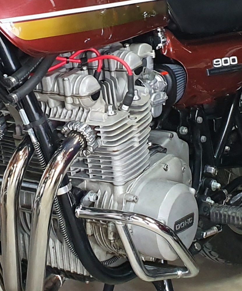

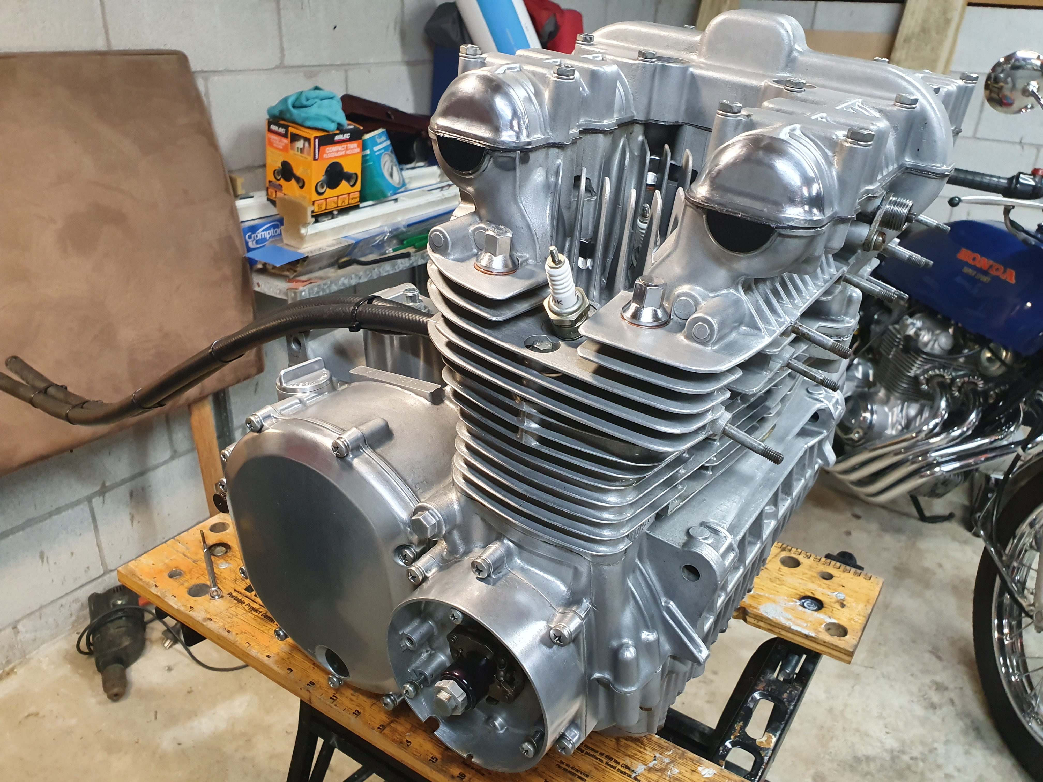

Re: Engine paint removal - Paint stripper no good
I had exactly the same issue although with a very old and hard clear coat, you have to use a aircraft paint stripper it's just called "aircraft stripper" it is designed for removing paint from aluminum without damaging it at all. It is used in the aero industry.
I used it on my z1 engine and it brought it up like new, then I used mag wheel cleaner from G3 in devon...
Came out perfectly
Good luck
P.s the after picture is with no polishing or wire wheels etc, you can do it the hard way if you want. Just YouTube aircraft stripper the results speak for them selfs..
[quote="Chris71"]I had exactly the same issue although with a very old and hard clear coat, you have to use a aircraft paint stripper it's just called "aircraft stripper" it is designed for removing paint from aluminum without damaging it at all. It is used in the aero industry.
Came out perfectly
Good luck
P.s the after picture is with no polishing or wire wheels etc, you can do it the hard way if you want. Just YouTube aircraft stripper the results speak for them selfs..[/quote]
Wow yes engine looks great. Aircraft stripper - I'll have a look at that.
Great tip thank you.
