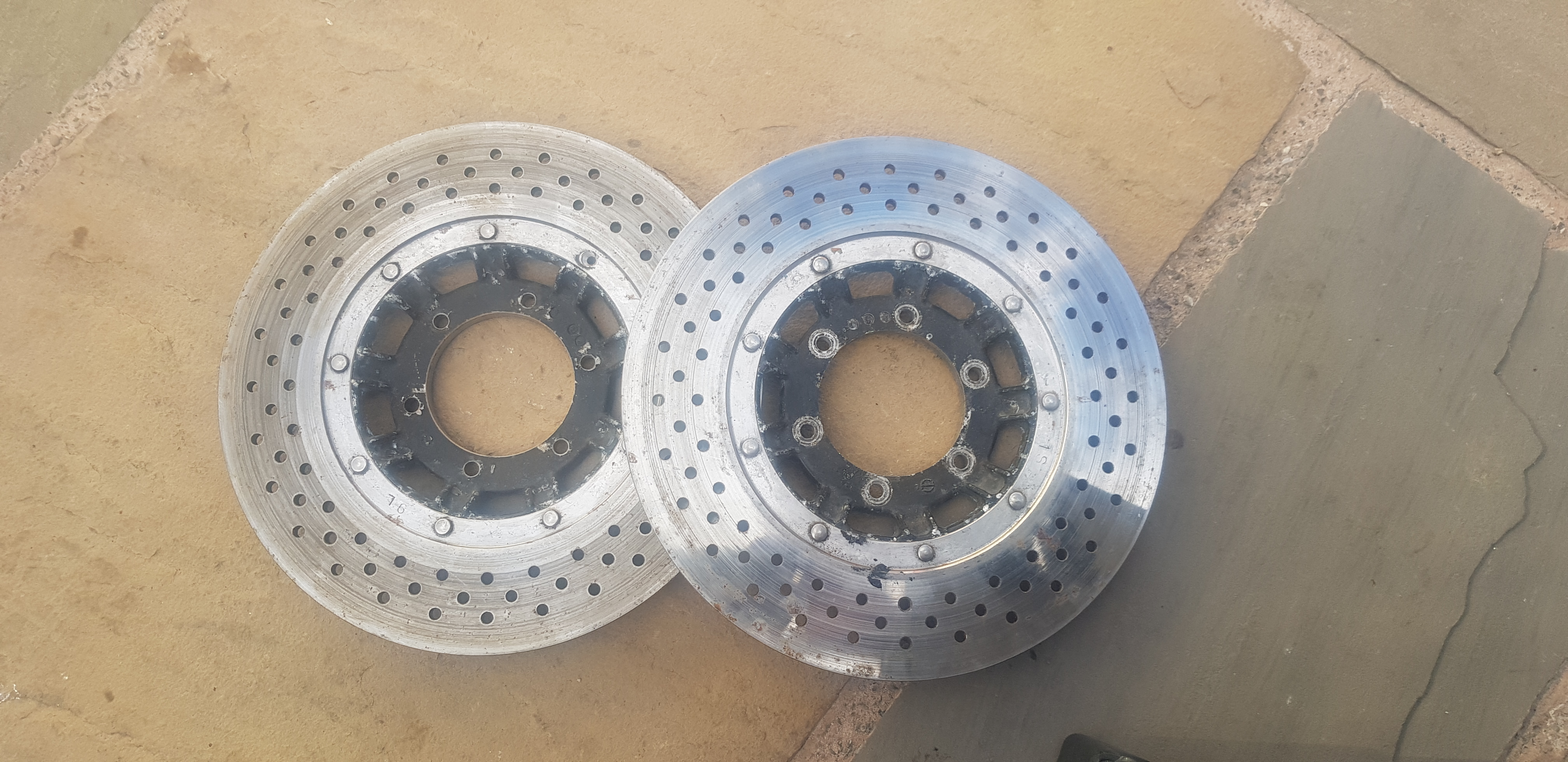

im after putting twin discs on my 73 Z1 so before i buy a full kit from Zpower i wondered if
anybody had a calliper or disc to sell
cheers bill

I've a couple of discs not sure if they are what your after, one has been drilled possibly for a magnet for electronic speedo, other is fine

Thanks Swirl but im after plain ones if poss , and ive just remembered singles are thicker so will need a pair

Hi Bill
the double disc brakes on a Z1 were both thick, not like those of the Z900A4 or Z1000.
As a matter of fact, the twin disc on a Z1, Z1A, Z1B was an option, a single disc was standard. The right hand side disc was the same as the left hand side disc. It had the same dimensions. So any Z1 disc will do the job.
On the Z900A4 the twin disc was standard and those discs where thinner. The KZ900A4 (US version) had a single disc, a thick one.
