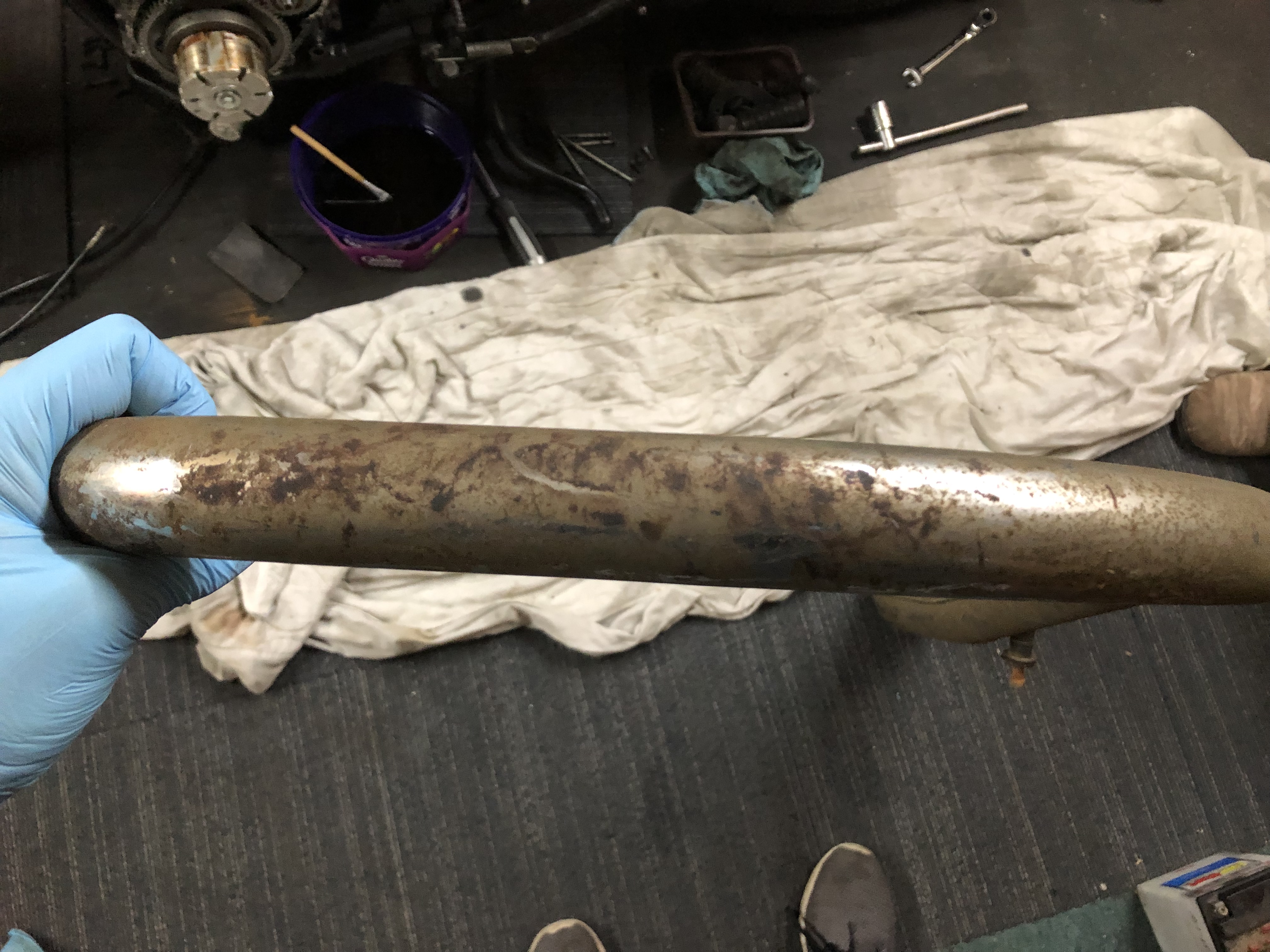

Spent some time cleaning the original exhausts. My go-to polish is now Quick-Glo (supplied by Nigel on the forum). It's superb stuff & leaves a nice wax sealant behind.
Hard surface rust was removed with a brass hand brush (light pressure applied with some WD40 as a lubricant). Given how rough they looked, I'm pleased with the results. I may well invest in a set of unstamped/no-clip pipes in the new year, but for now, these will do & fit the patina of the bike. Just a shame the lower RH pipe has some damage/rash. I imagine finding a correctly stamped, good condition replacement will be nigh-on impossible.
Before pics:
After pics:

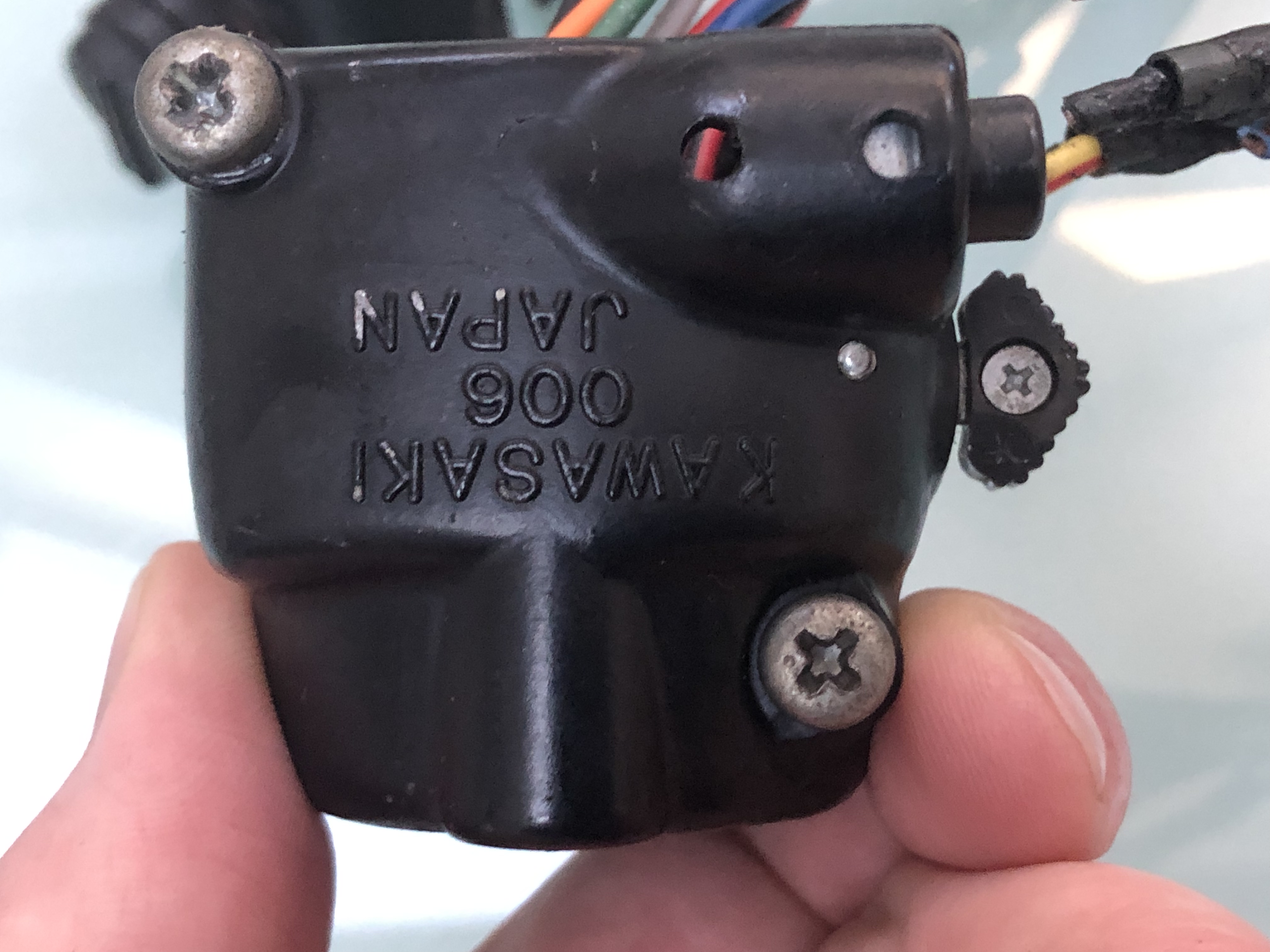

Original electrical panel lightly cleaned & reinstalled:
Refurbished switch gear re-fitted (thanks to Brown Critchlowe for doing these for me). Managed to source a NOS Kawasaki LH rocker switch to replace the broken original:
Before refurb:
After refurb:
Before refurb:
After refurb:

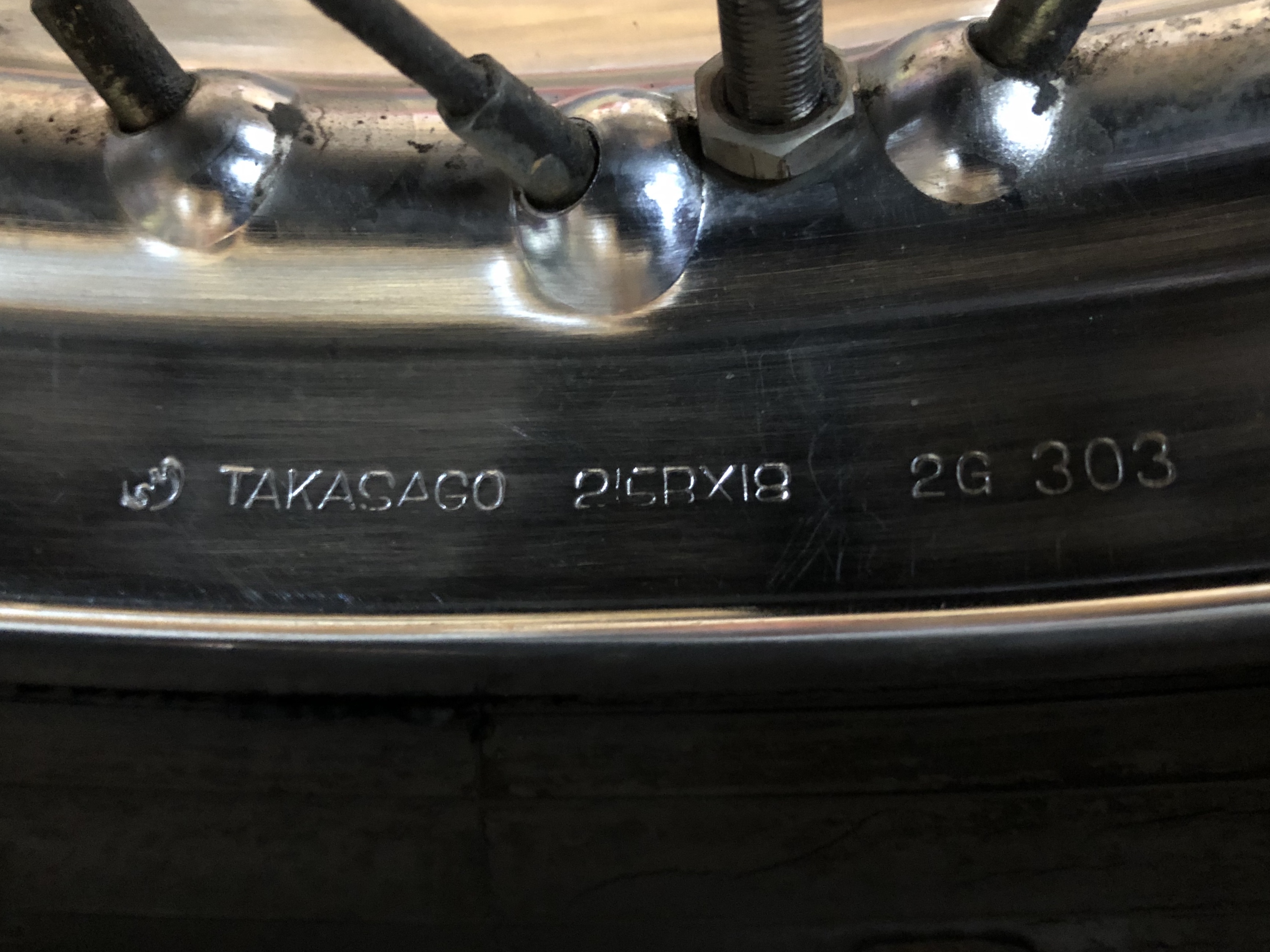

Quickly cleaned the date codes on the rims - seem plausible for a 10/72 date of manufacture for the bike.
Front rim: 2I 303 (September '72)
rear rim: 2G 303 (July '72)
