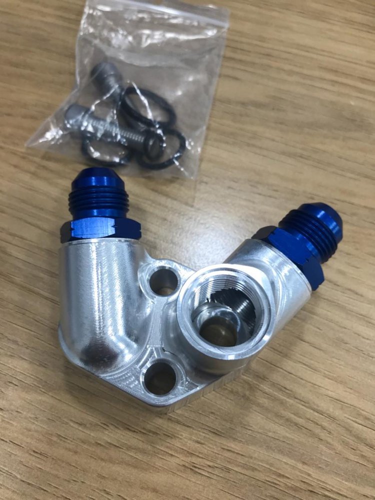

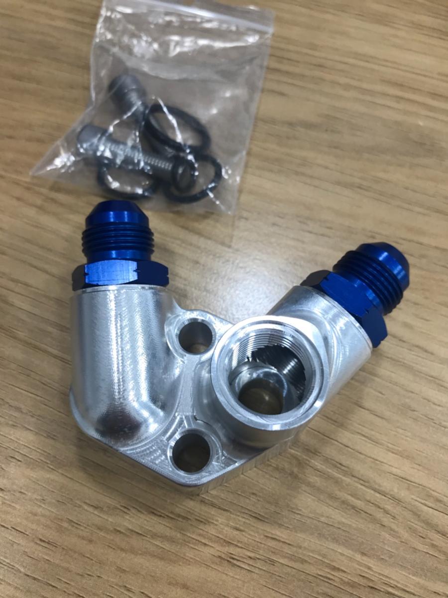

#7 PostAuthor: rickm » Thu Nov 29, 2018 1:44 pm
This is the one that HEL made.

I suspect HEL might freeze over :lol: if I did have these and just gave 'em away !
The standard pressure sensor screws into the top, so that's the same dimensions if you've got one to hand.
The securing bolt size and spacing are standard too.
The outlet / inlet just need to match the hose adapters you want to use.
Don't know whether you can make something from that?

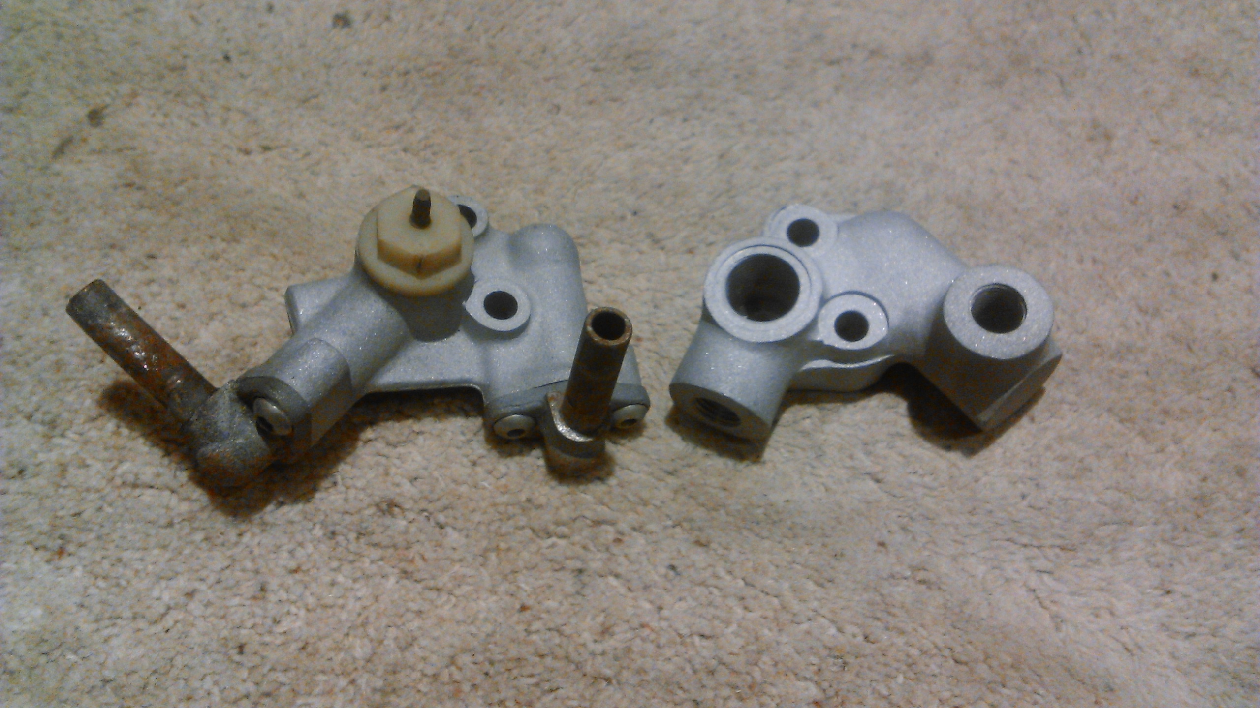

#10 PostAuthor: 8 Valve Mark » Thu Nov 29, 2018 6:07 pm
i have a spare take off (92005b in gus's diagram) from a b1. if drilled n tapped for the ops like (92005a)should work ok. i have the pipe unions too.

#12 PostAuthor: Gus » Thu Nov 29, 2018 6:30 pm
I have these at the moment if you wish to borrow to make some up but will need them back fairly soon ish could let them go for a few weeks.
I believe the one on the left is original
The one on the right is afterkarket and the connection threads allow for fitment of AN type fittings. I think the thread is G1/4.
