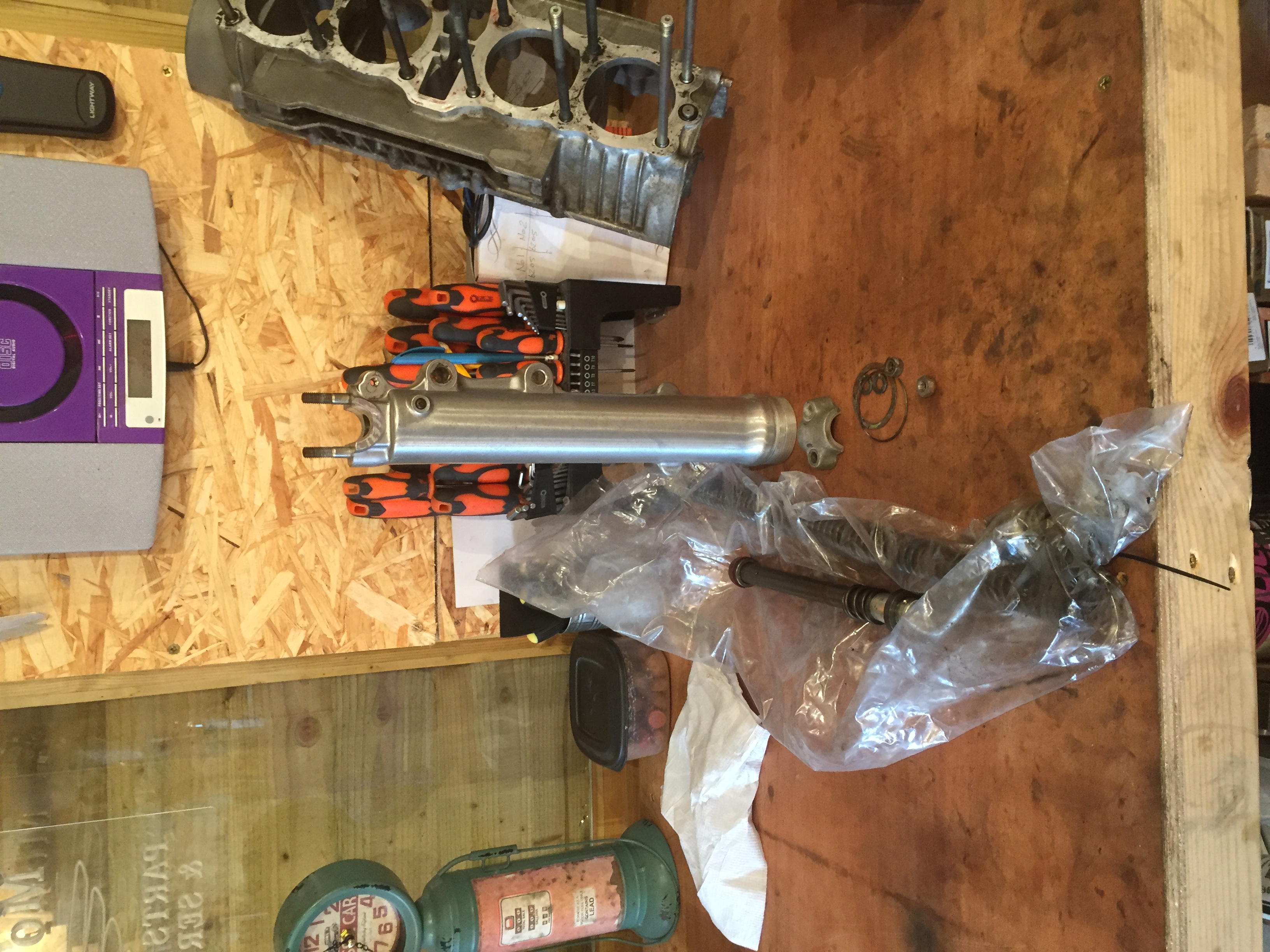

Posts: 1404
Re: Z650c2 restoration
#2 PostAuthor: Bill P » Mon Oct 29, 2018 12:33 pm

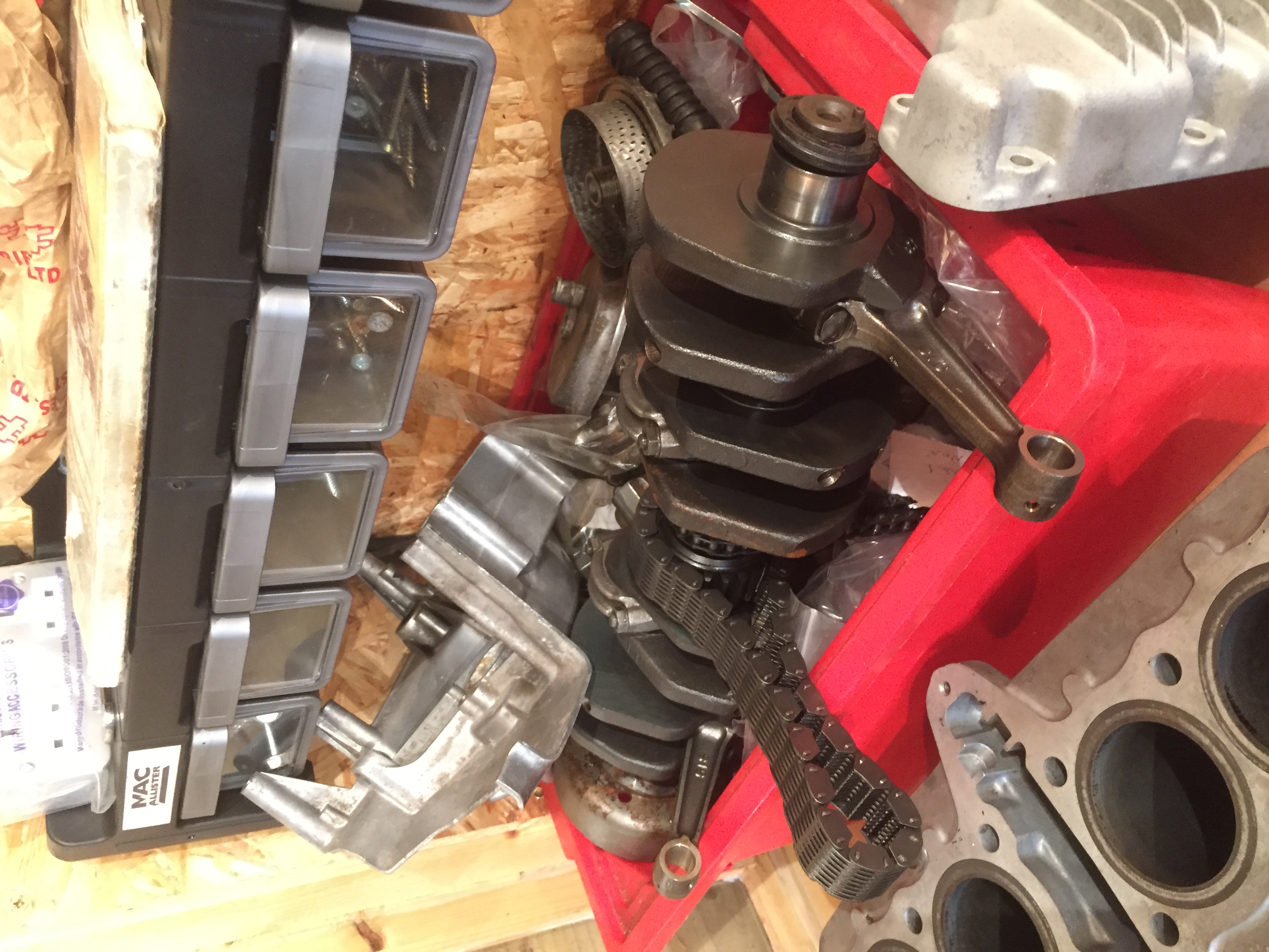

A few of it on arrival

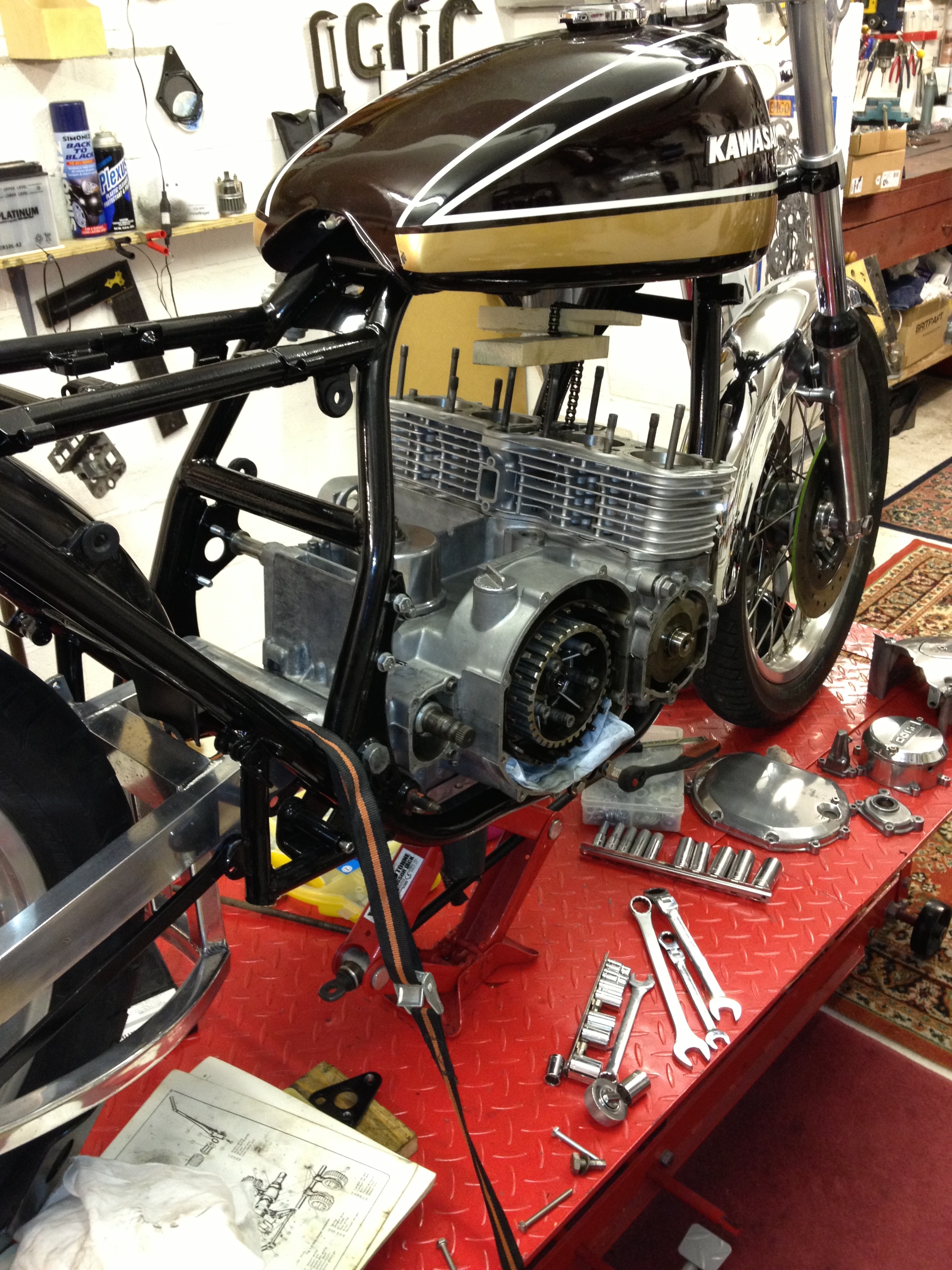

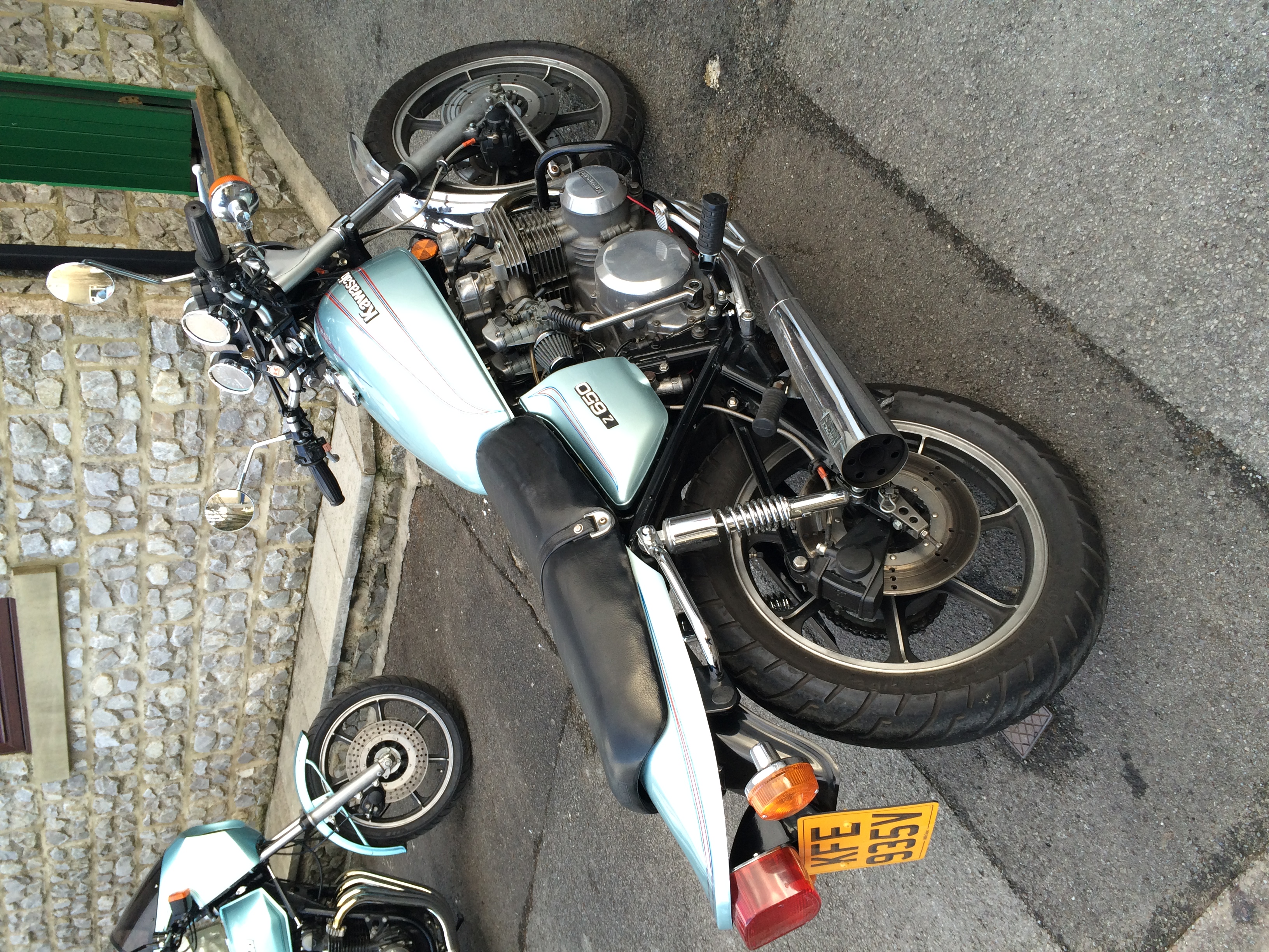

#3 PostAuthor: Bill P » Mon Oct 29, 2018 12:41 pm
A couple of Z1a

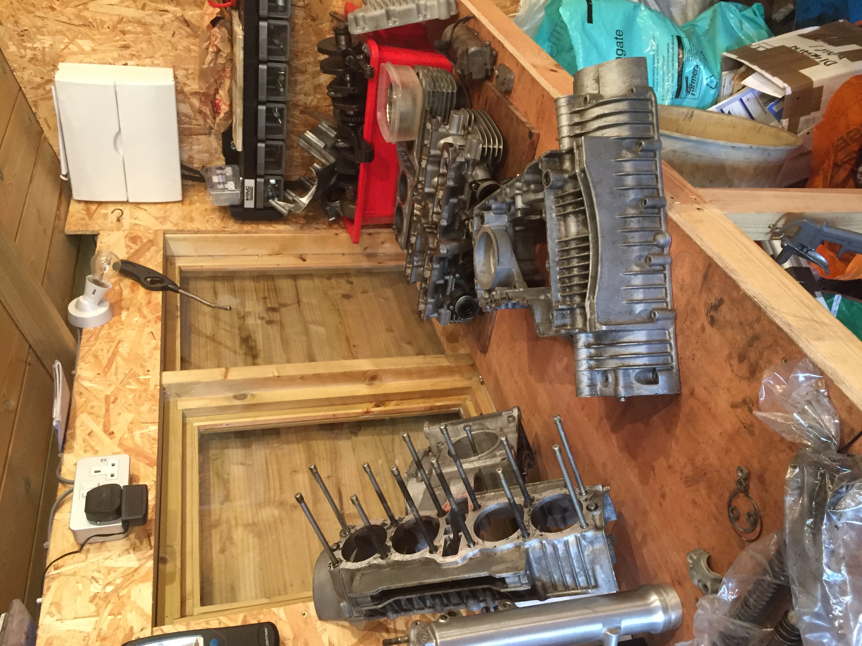

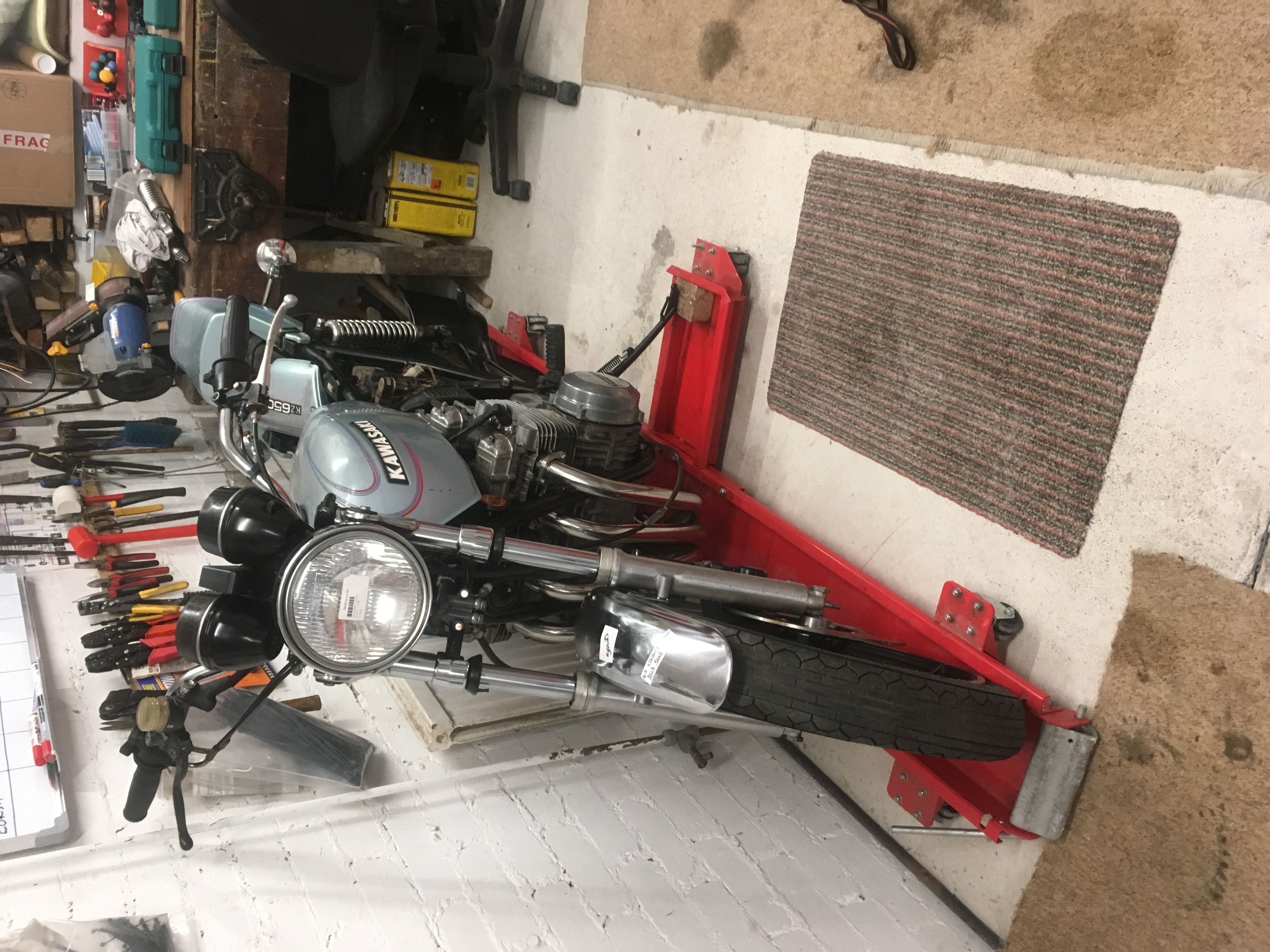

#4 PostAuthor: Bill P » Mon Oct 29, 2018 12:43 pm
couple more hope im not boring you

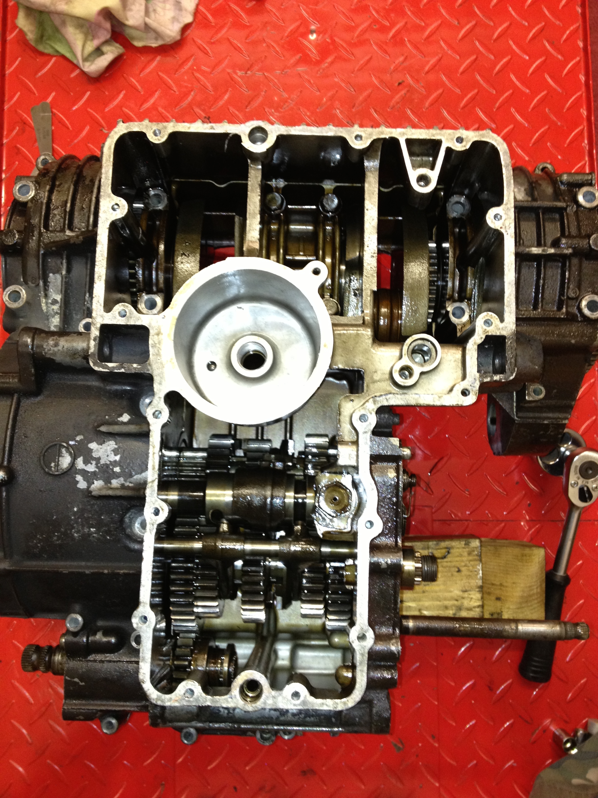

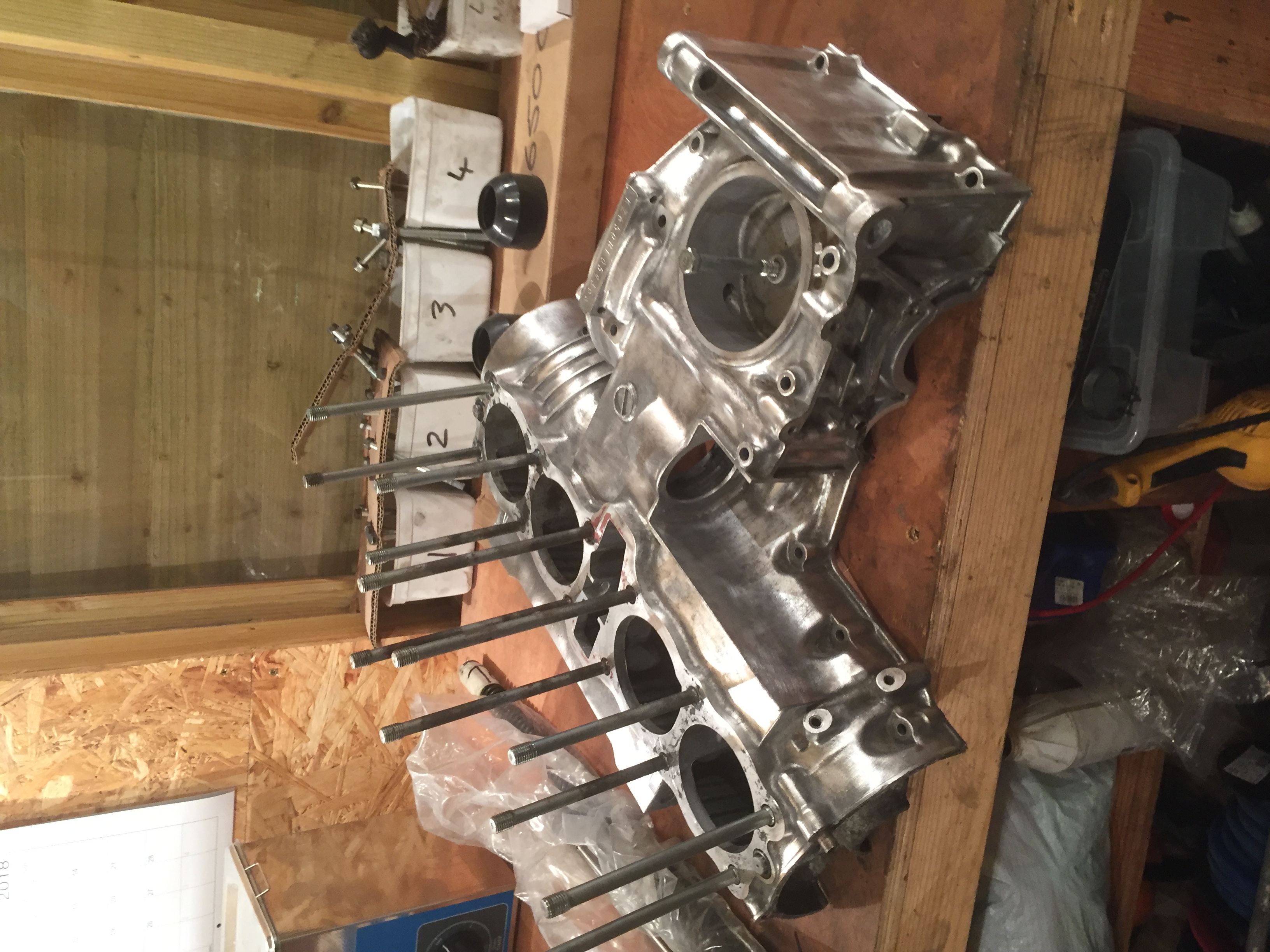

#5 PostAuthor: Bill P » Mon Oct 29, 2018 1:00 pm
And how it finally ended up

#6 PostAuthor: Philippe » Mon Oct 29, 2018 3:30 pm
Hi Bill
I see you collect Kawasaki bikes, great hobby by the way! I can see you restore them but please stop blasting the engines. If the engines are not thouroughly cleaned after blasting, the dust gets inside and acts as sandpaper when the hot engine oil takes the microscopic parts along to the moving parts...
Nice collection you have there. I can see a Z1A, a Z1R, a Z650, a Z1000ST (E2?) and a Z1300 . Good choice, keep up the good work and enjoy them!

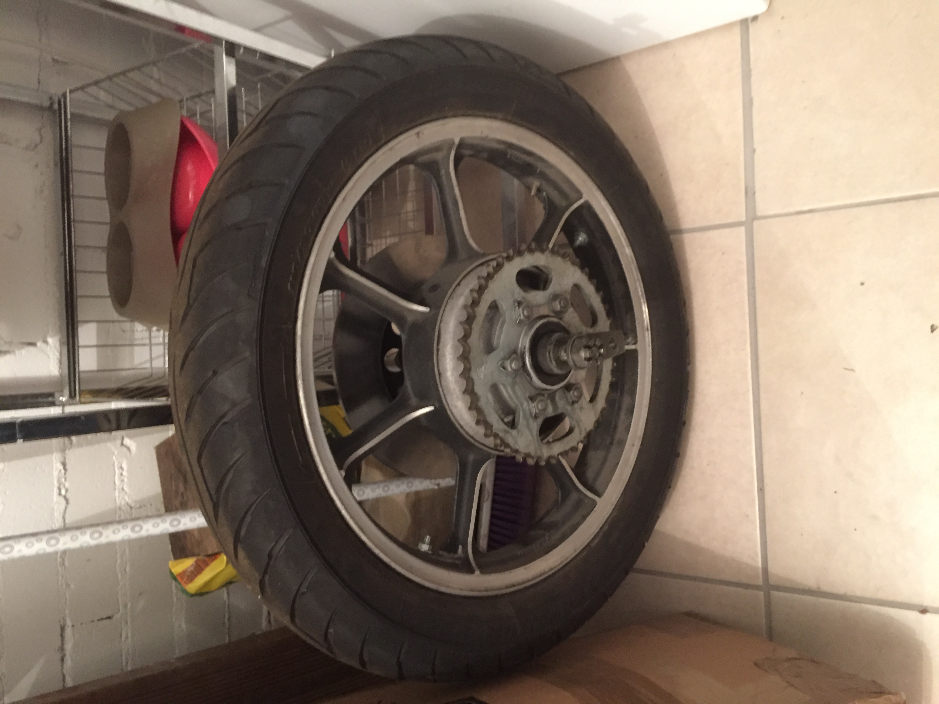

#10 PostAuthor: Bill P » Mon Oct 29, 2018 8:17 pm
Z650c frame ready for powder coaters tomoz all orifices bunged up
and wheels already sorted and shod with new Roadriders my tyre of choice

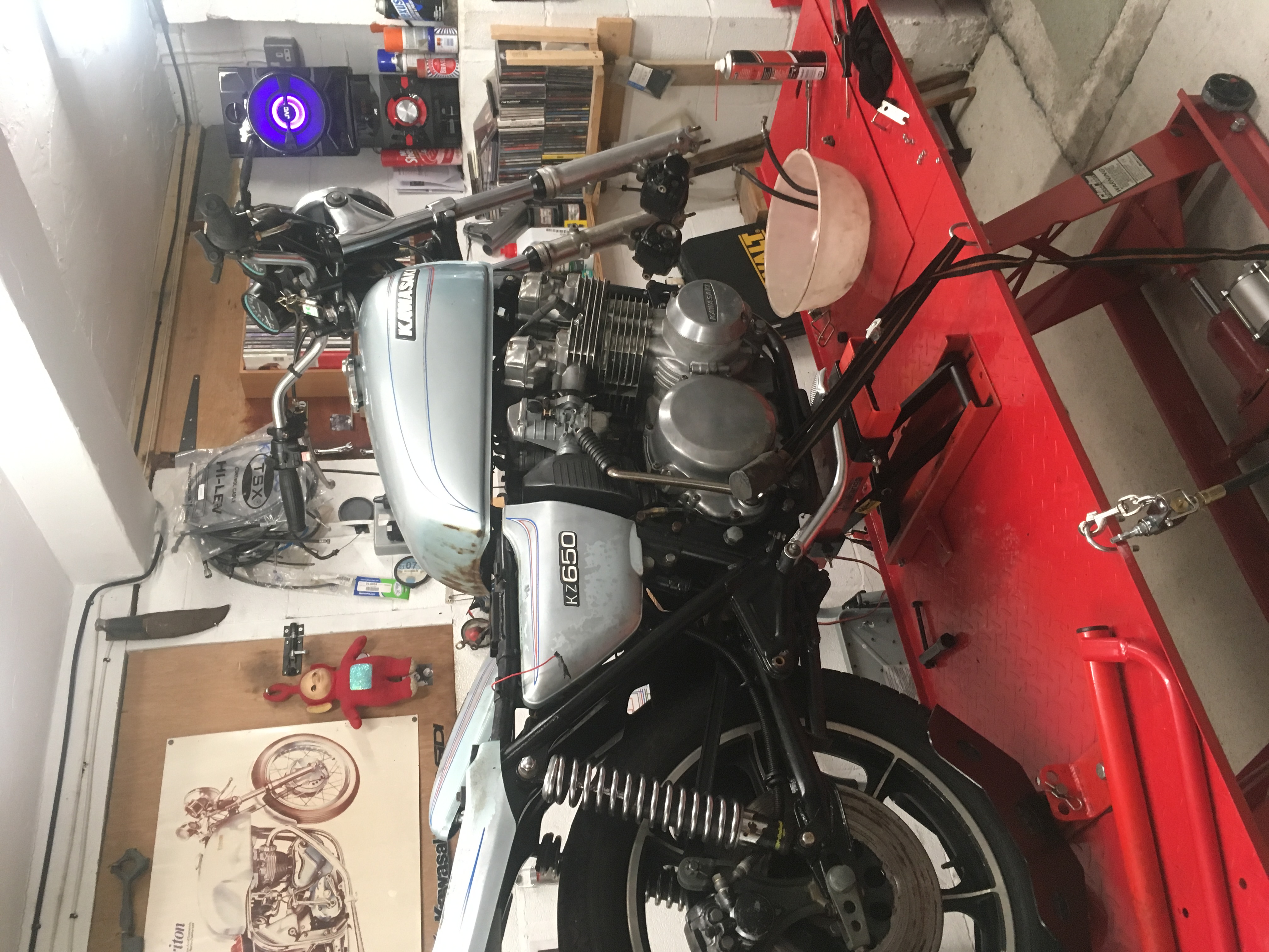

#11 PostAuthor: Bill P » Tue Oct 30, 2018 11:39 am
Thanks for comments chaps :D Philippe how do you get engines clean if you don't blast them ?
Couple of C2s ive tidied up in past and a late registered B1

#12 PostAuthor: Philippe » Tue Oct 30, 2018 4:05 pm
Hi Bill
I use different rotating brushes, take a look at "Z1B restoration" . It takes more time and effort but it's safe for the internals of the engine.
If you use sand to blast an engine, the sand gives a fine dust and it creeps everywhere in the engine.
If you don't clean the engine parts very, very thouroughly inside, the very fine sanddust particles get into the hot oil when the engine is running and acts as abrasive paper with disastrous results ...
There are other blasting media I know,(glass pearls and some others) which are not that dangerous but anyway, I don't take the risk.

#13 PostAuthor: Bill P » Tue Oct 30, 2018 4:59 pm
Cheers Philippe ill have a look , by the way i use glass bead and airline and wash
thoroughly afterwards

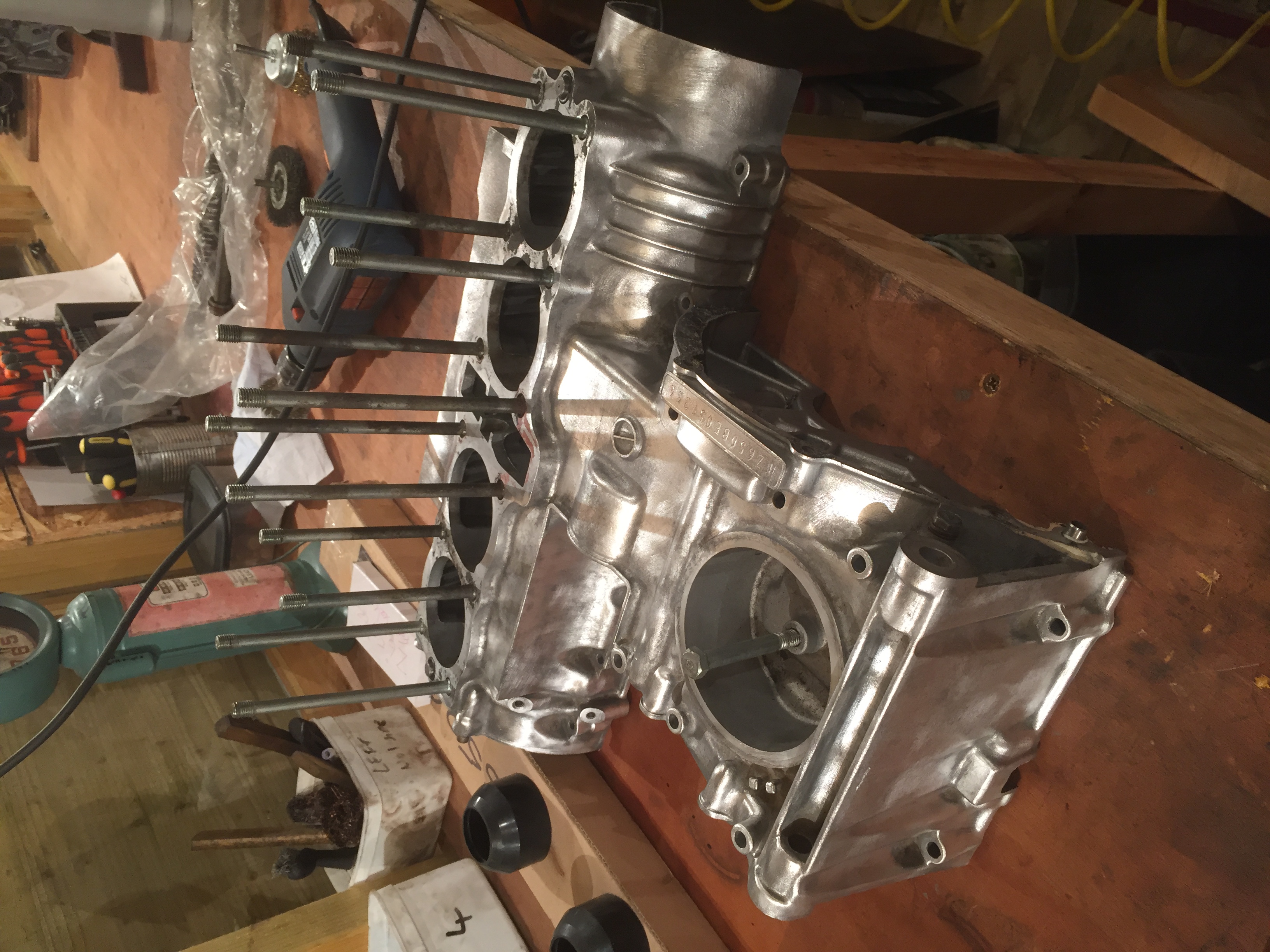

Had a go at cleaning z650 crank cases today the Philippe way , i found it quite satisfying so ive
ordered more brushes different sizes etc should be a picture to show progress after 30mins or
so .
