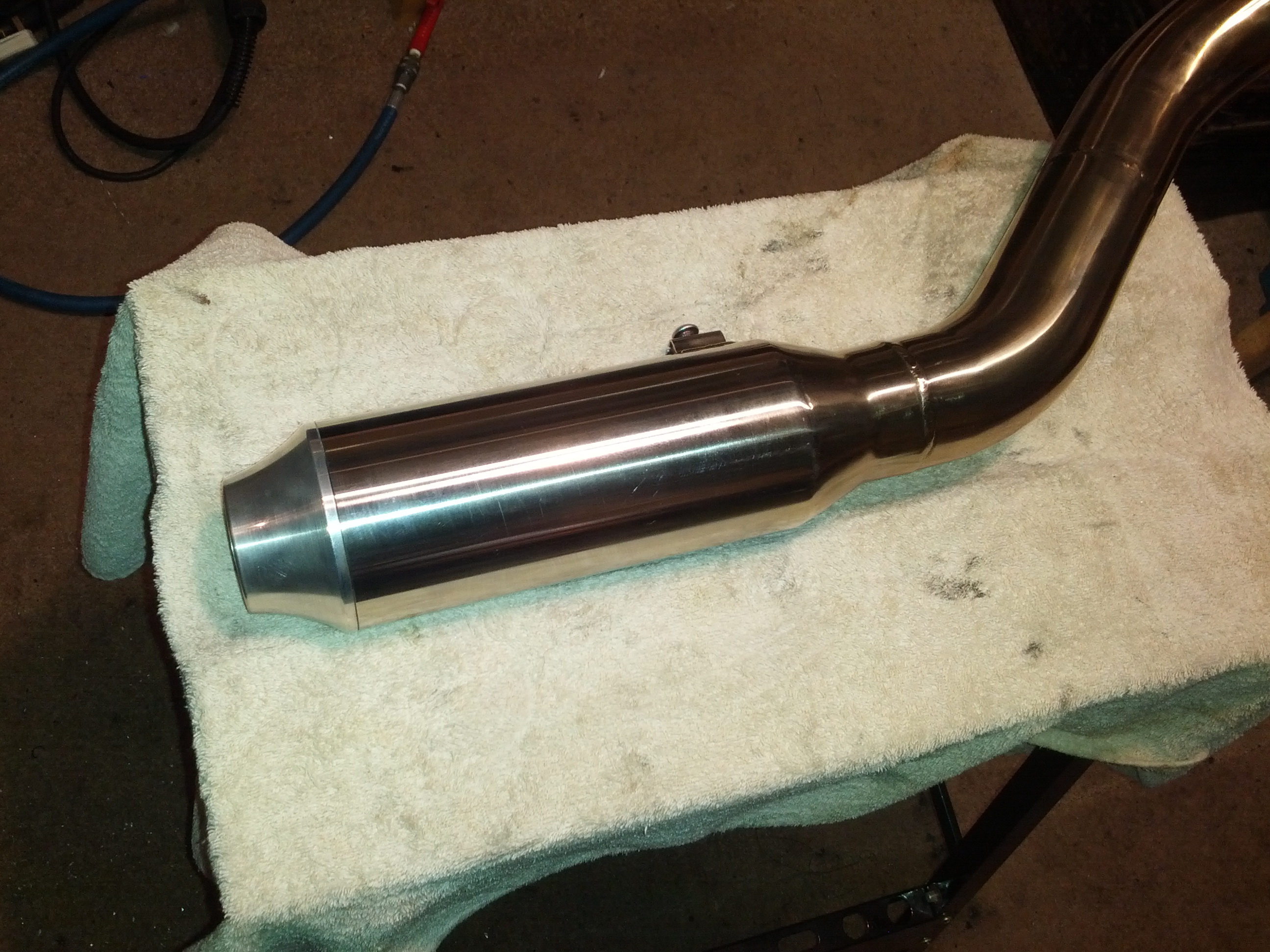

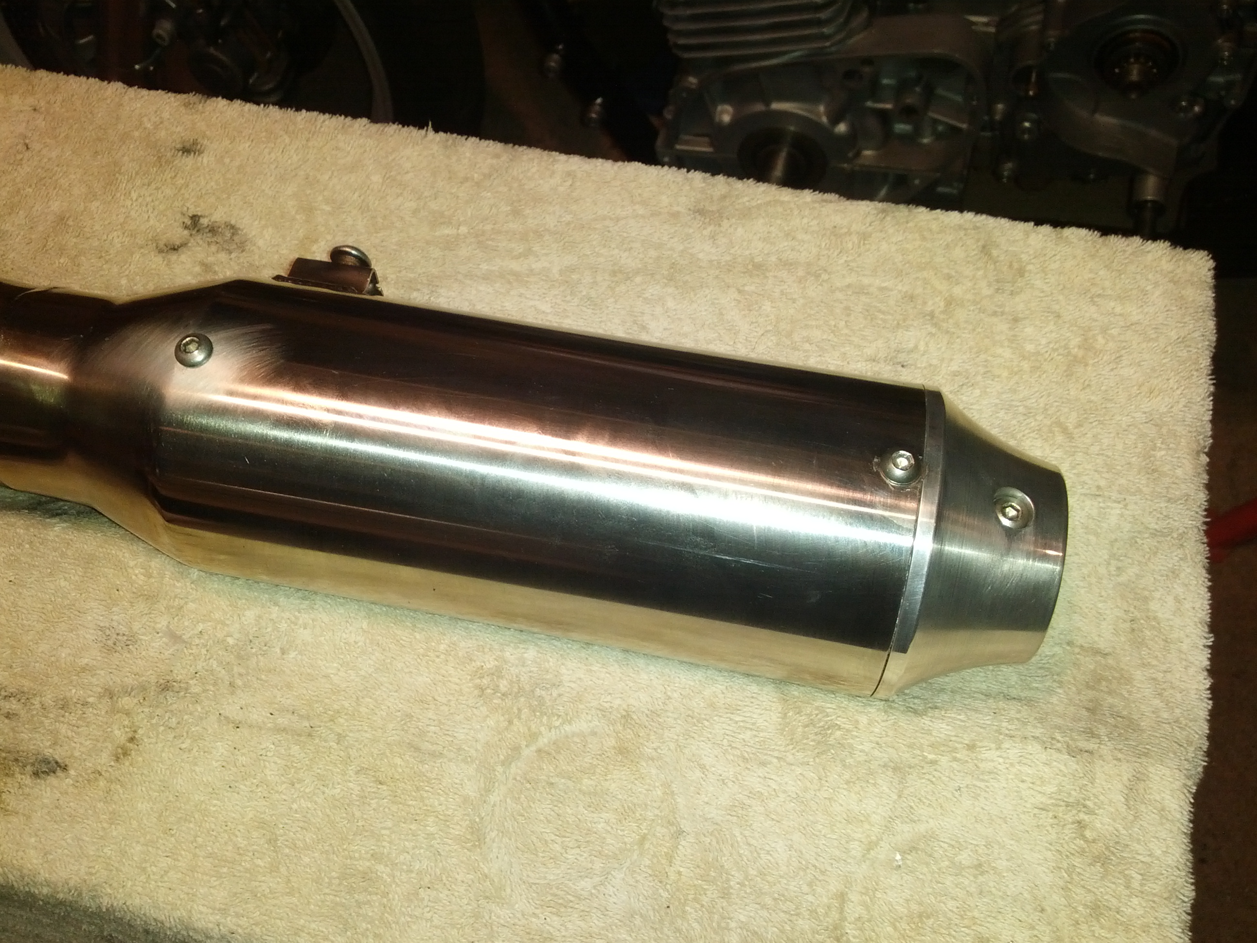

Whilst putting a few miles on the bike i noticed that there was a gap appearing between the end cap and the can of the exhaust. The baffle is a sliding fit in the outer tube with a pressed plate welded to the inlet side and the gas pressure is forcing the baffle and hence cap, so it needs to be held in a bit more securely.
First was to try and locate the baffle by drilling through the outer tube and into the flange of the pressed plate, then cut a thread in the hole in the baffle. This should stop the baffle creeping rearward
Held in by an M6 button head:
Then measure up for a second screw to hold the cap to the outer tube:

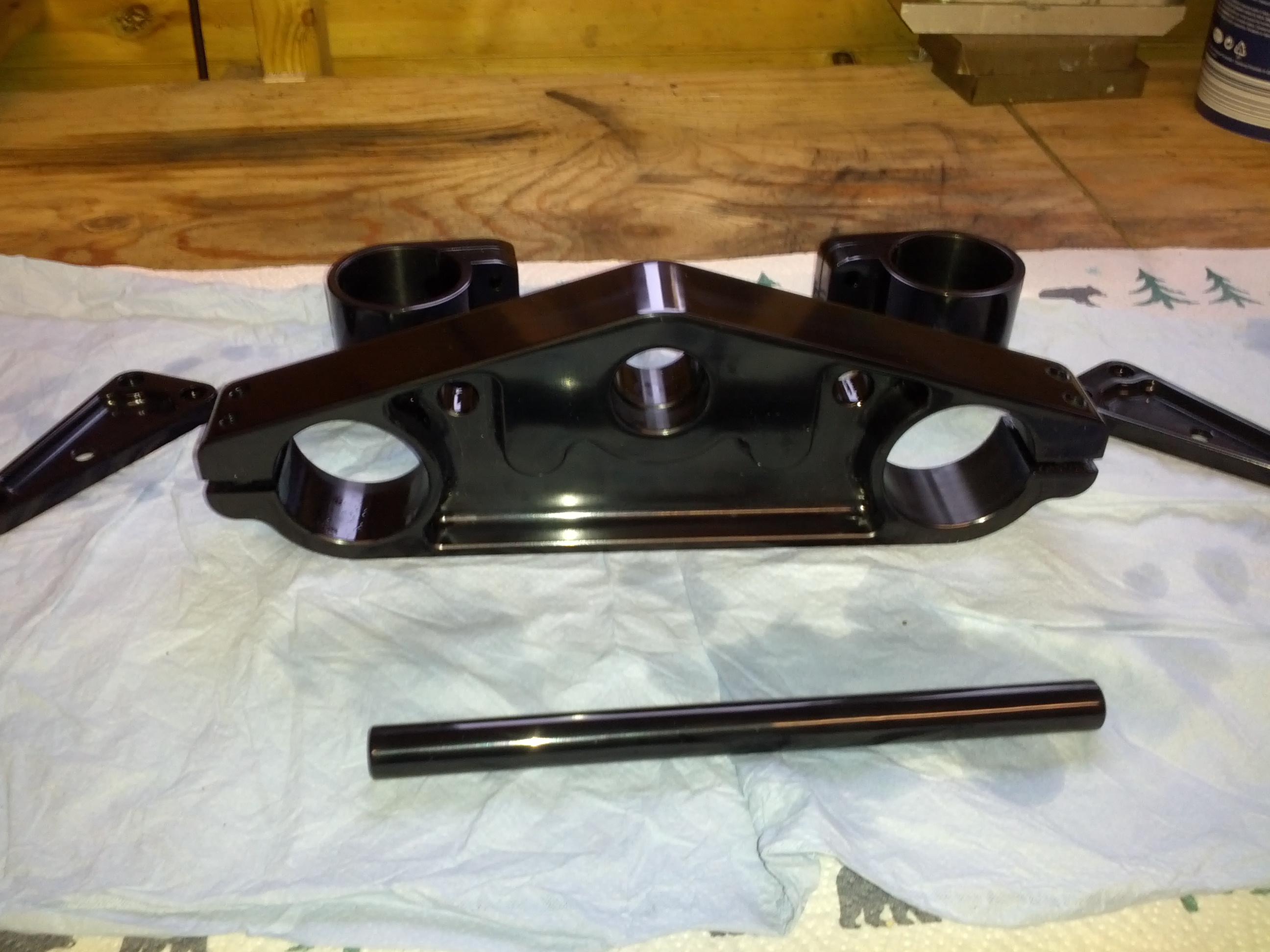

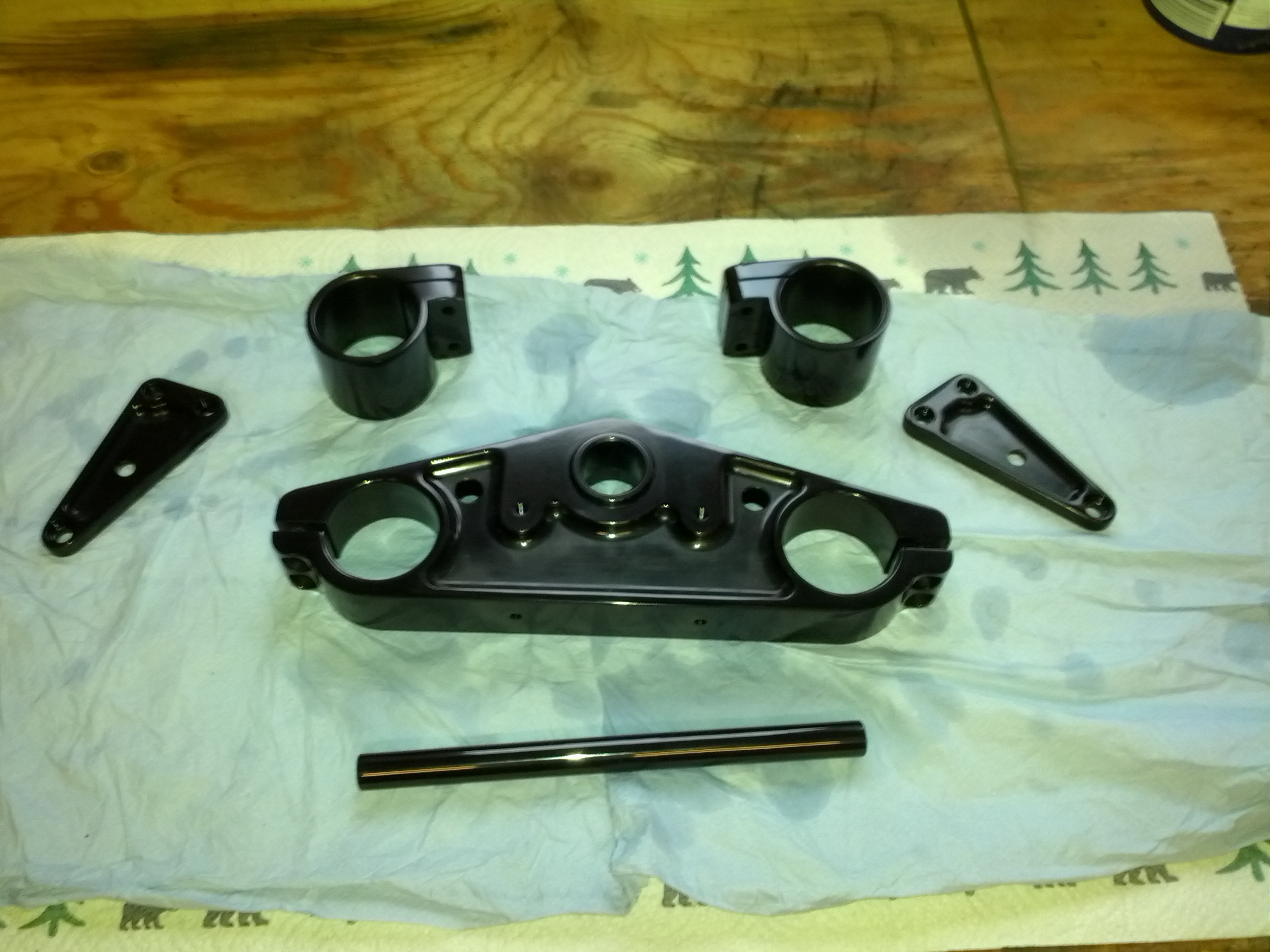

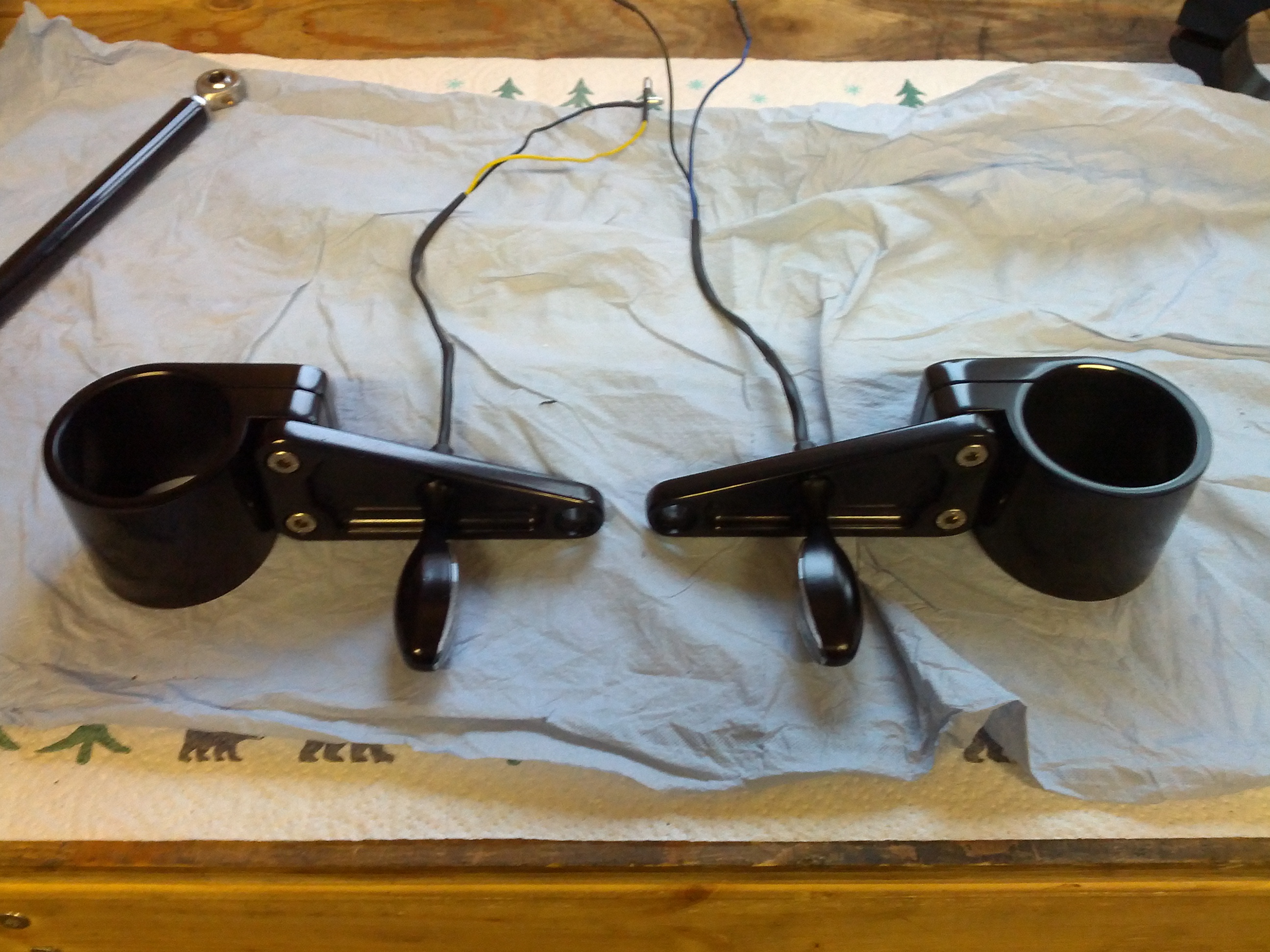

Picked up some anodised parts from Mikey:
Bottom yoke, headlight brackets and rear brake torque arm:
Gotta say he does a perfect job. This is one service supplier i am very happy with

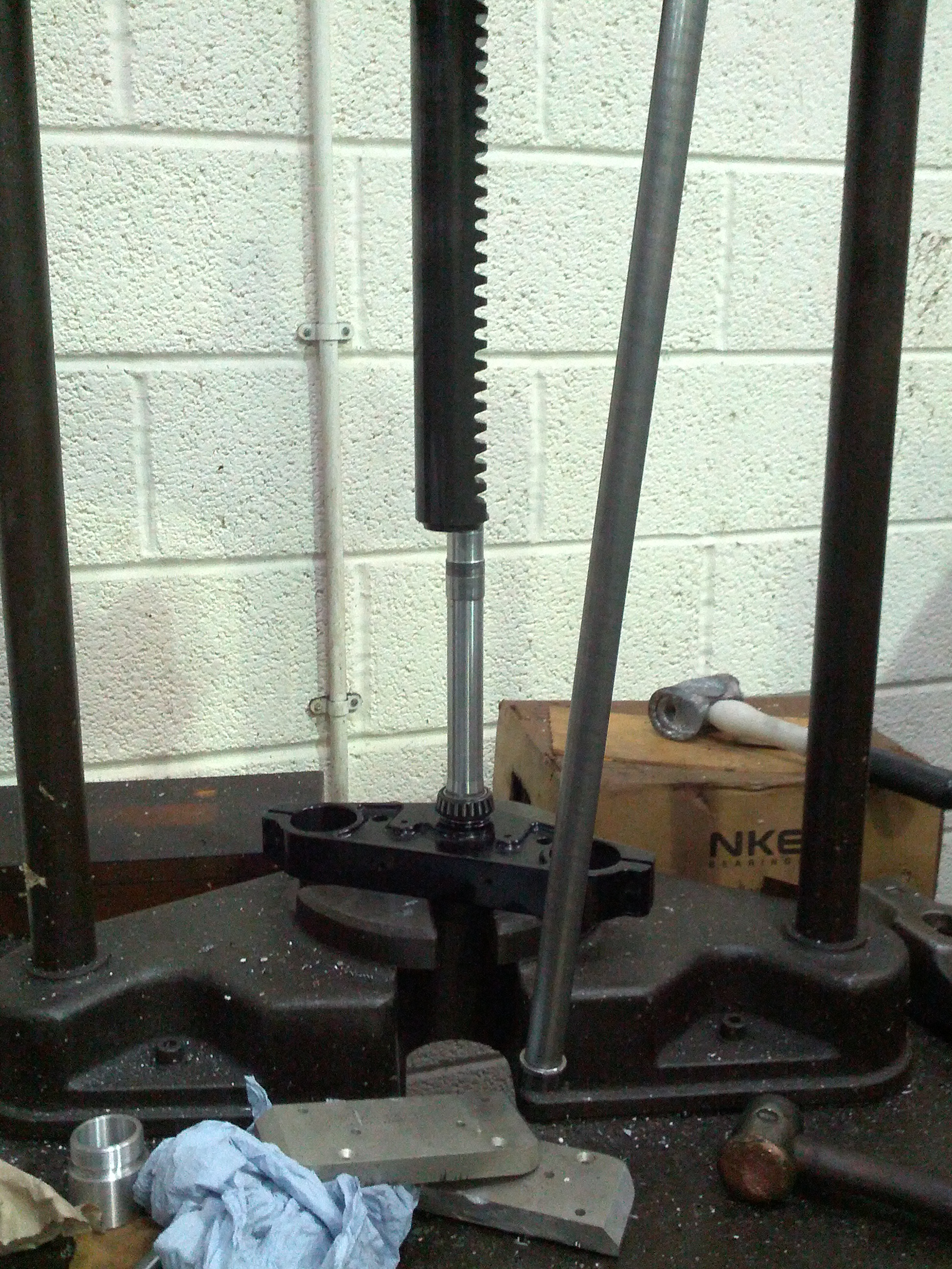

Spent an hour or so pressing the stem out of the R6 yoke and into the new one with the bearing and spacer:
Needed to turn down the stem slightly for thicker than anticipated anodising, but she went in with a bit of juggling

Re: My Ultimate Zed
very nice where did you get the head light brackets from , do they fit a 43mm fork
- Zomerset Zed
- 100Club
- Posts: 239
- Joined: 30th May 2014
- Location: Somerset
Re: My Ultimate Zed
I designed them and had a local CNC company make them, then got them black anodised.
They are for 53mm USD forks but could be designed/made to fit any size.

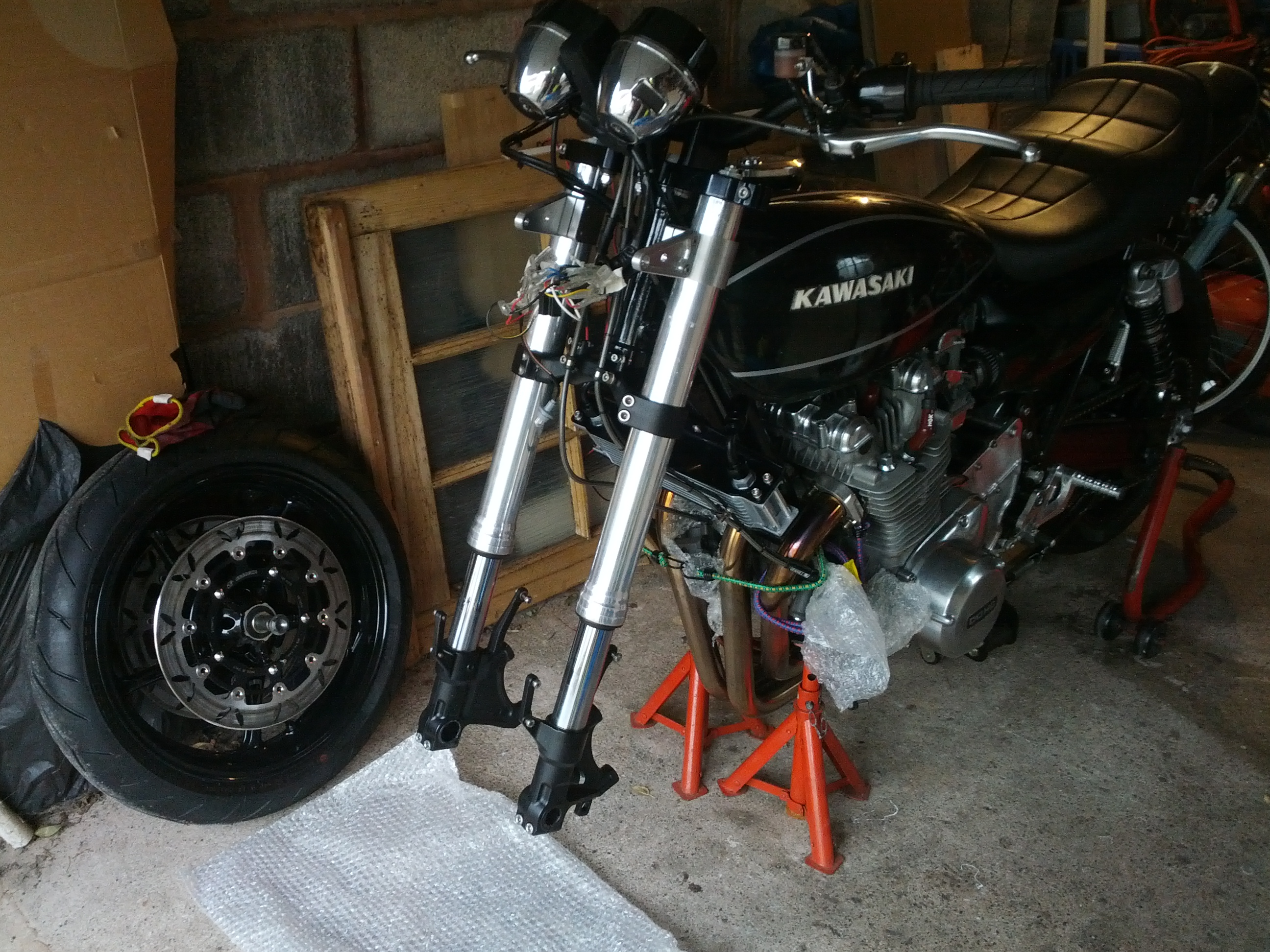

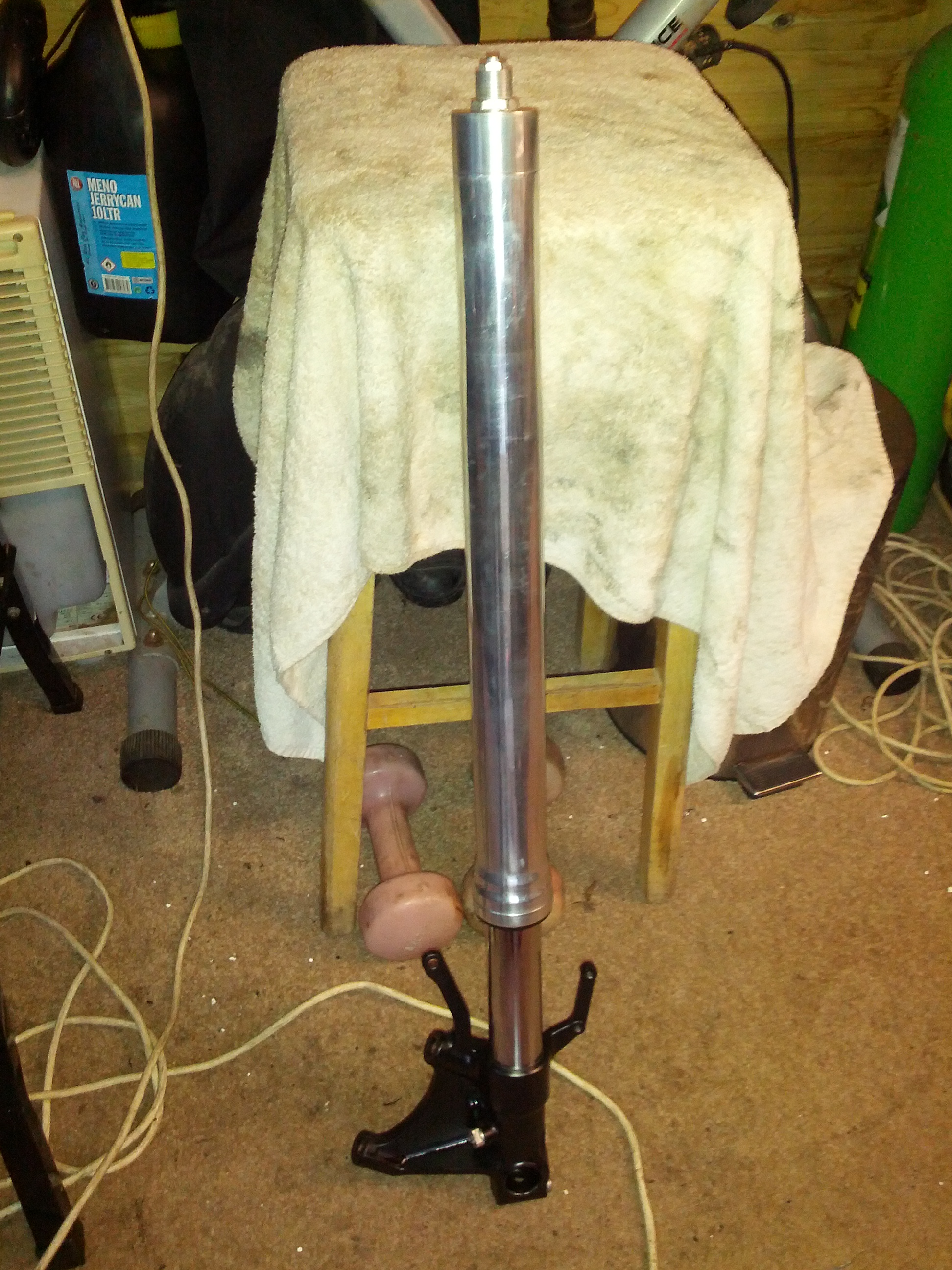

Got me fork extensions back from the machinist:
Internal extension fitted with copper washer to stop any bypass:
Top extender fitted with new o-ring:
Screwed in as tight as i could get it, but its not going anywhere once all clamped:
This now gives me 30mm more fork length to play with.
All finished with new seals and 26ml additional fluid to each fork.

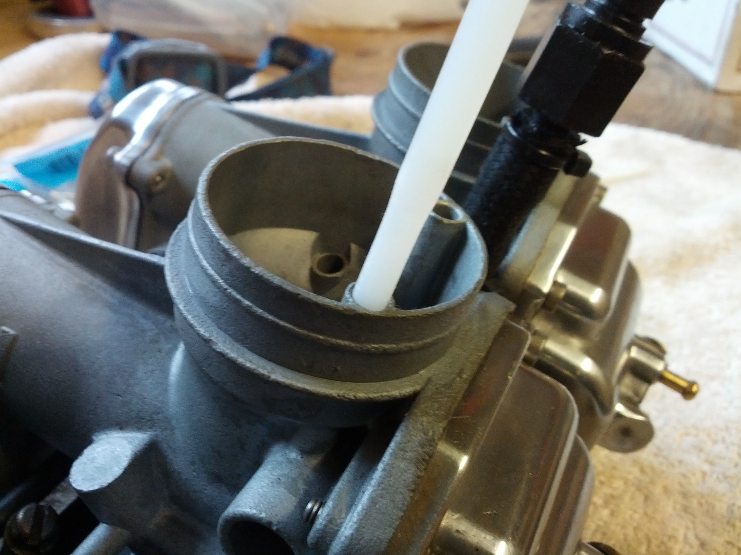

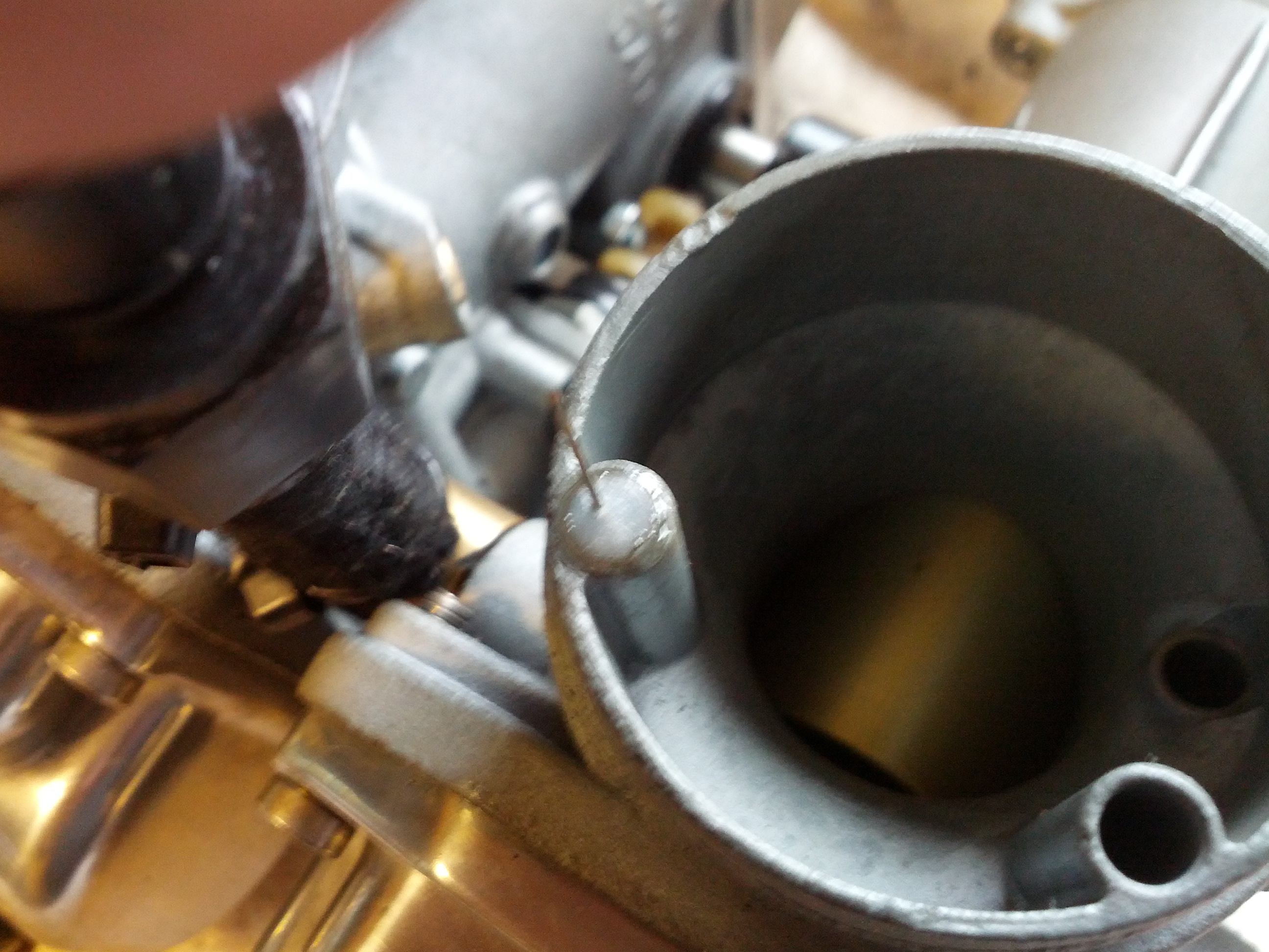

Carbs off again
Time to get the carbs off for the following:
Pilot jets up from 17.5 to 20
Main jets down from 130 to 120
Install air corrector jets
Mr Pigford had sent me a set of 0.6mm air corrector jets that i was going to fit to my carbs. Unfortunately Postman Pat decided to keep them for himself
To remedy the situation i got my hands on some 5mm natural couloured nylon round bar and turned it down in the drill with some emery paper to just under 5mm to slide into the airway that feeds the emulsion tube. I also ordered some 0.6mm drill bits to make them:
Fiddly and small springs to mind:
Had to hold the nylon in the drill chuck and offer up the drill bit in a small pair of mole grips to drill the hole, then cut off with a saw and sand to finish. Used super glue to hold them in place.

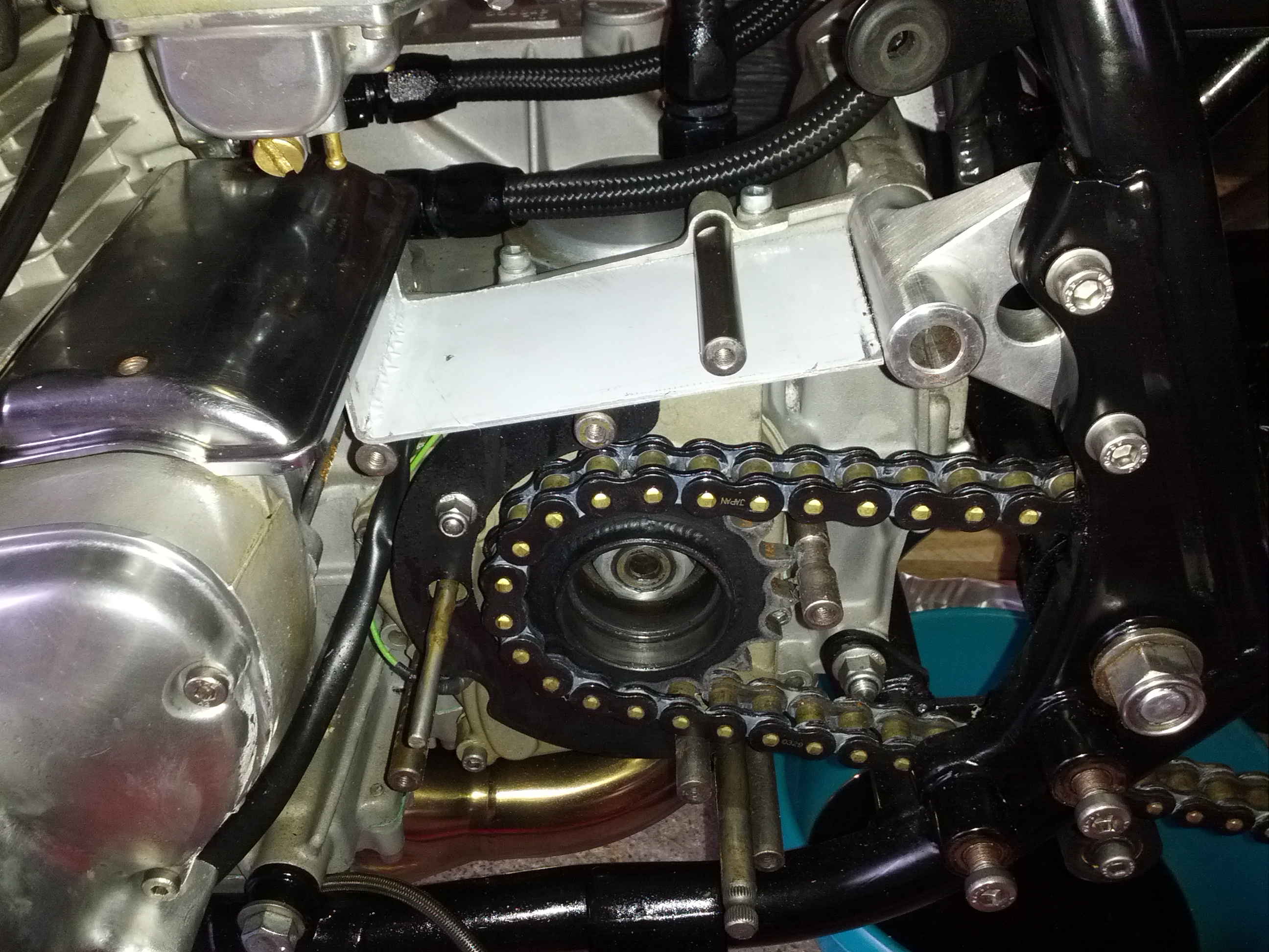

Sprocket cover
Decided to make a cover over the sprocket to stop splashing up the hole, so to speak
Made up from a piece of 2mm ally plate and backed with 1mm rubber sheet
Fits between the outrigger plate posts neatly and is in there pretty tight once the plate bolts are done up
Glued, and done

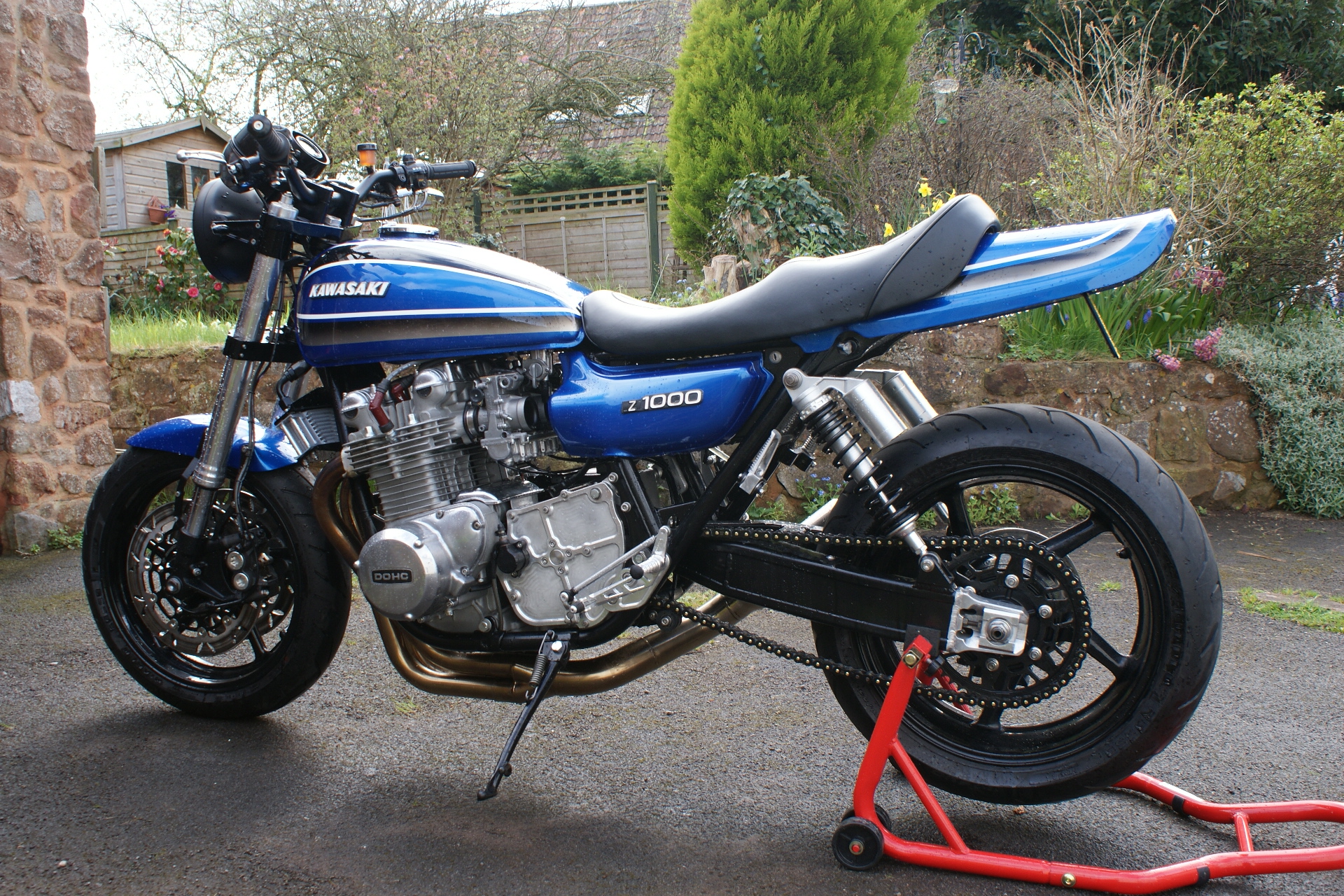

I finally got the finished paintwork back from Dream Machine. Can't fault any of their work and they did exactly what i asked for-this may be a 1st for me
Got it all mounted and badged up and did some other minor mods like liberating the fuel tap of the diaphragm, so now its just for decoration.
After much procrastination i find myself the owner of some new Mikuni RS flatslides. With yesterdays weather it was too much not to fit them and take it for a test spin:
It goes well
Then needed a bit of a wash (its muddy here in Somerset)
Now needs some miles, some air filters, fiddling and MOT
