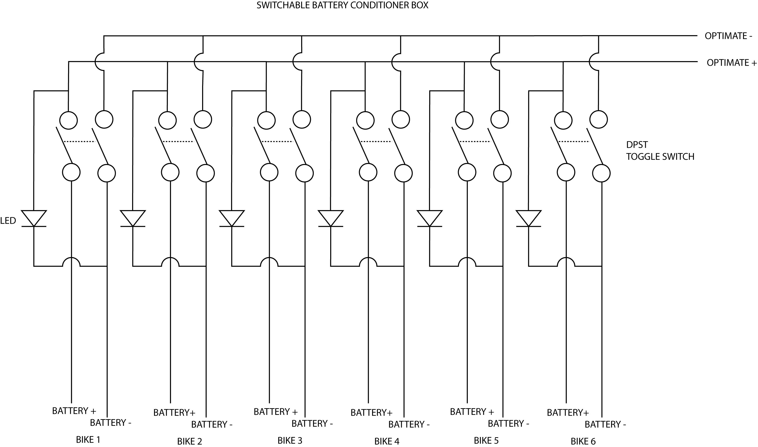

Right finally got all the bits to build the switch box. Six switches in a row. 4 terminal toggle switches. Connected all + terminals together and all - terminals together on one side of the swtches with a tail out the box from the the first switch + and - to plug the optimate in. I've run a 2 core from the other side switch terminals to each bike, so I can just switch each bike to charge alternatining between bikes with the flick of a switch.
Question ? How does a optimate "know" when to switch on or off? Reason for asking is I was going to run a led on each box switch so that when it is in the on position the led is lit.
The optimate has a red led to show charging which switches to a seperate green led when fully charged. Will adding leds to my switch box interupt this in anyway.? And which switch terminals should I use for the leds? Obviously either side of the switched connection but does it matter to not cock up the optimate leds/cycles.
Ps I like leds!!!!
Once I've sorted this I'll get back to the led rev counter project.

#14 PostAuthor: warren3200gt » Tue Nov 28, 2017 10:59 am
Seems to work without messing the Optimate conditioning cycle. Just select the bike to charge by throwing the relevant switch. Led is alight when switch is in the on position and Led's on the optimate show when the battery is fully charged and ready change bikes.
