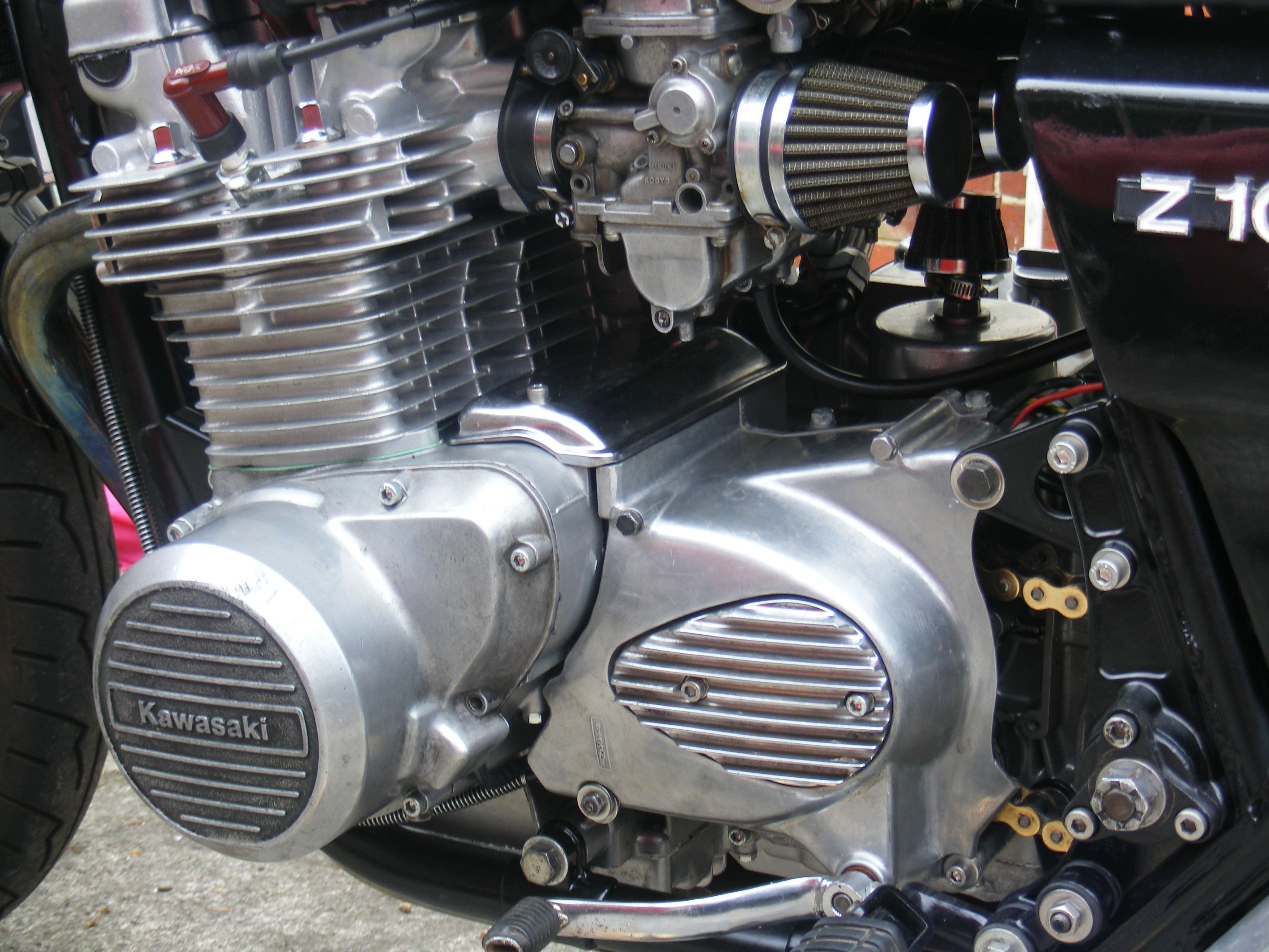

A few pics of bike to date ,taken this afternoon after a short ride round town ,have had a few teething problems since getting it running a few weeks back ,the gear change jammed once the engine was hot ,transpired the pin on the lever arm was catching on the inside of the sprocket casing ,this was in part due to me having to shorten the arm down to work at all ,resolved the issue by shaving a bit off the inside of the casing and also to be safe I doubled up on the gaskets to give extra clearance ,since then it has been fine,all in all I happy with the final result ,I don't know why I had a bee in my bonnet about converting a shaft to chain ,used to have an xs750 years ago and also thought that would look great as a chain drive bike!,from a financial point of few its probably not worth converting a complete st unless you already have some bits lying around ,its surprising how it adds up if you factor in ,swinging arm ,disc ,rear caliper ,wheel etc etc ,however the actual engine side of things dosn't cost much tho it is hassle as Ive already tried to explain the ST selector drum isnt designed to run behind an inner chain sprocket ,mine only cost so much as I bit the bullet and had the crank checked while the bottom end was apart ( this was then reconditioned etc by Debbens as bearings were on their last legs!),also fitted new bearings on both shafts and did the cam chain so as I say it all adds up!,its now running nicely and rides well ,gear change actually seems smoother than before ,also its a lot easier to push it out of the shed now! cheers all Stan.

#83 PostAuthor: ADRIAN H » Sun Jul 16, 2017 7:11 pm
Unfortunately can't see any pictures. Good to hear you are up and running :D
I think you need to reload the pictures straight from your computer. Just drag and drop.
Photobucket will not let you copy onto another website, unless you pay them for the privilege.

ur kidding ,mm so only I can see them then? :shock:

Fantastic result, I like that a lot.

That is much better. Looks lovely mate. :up :up :up
