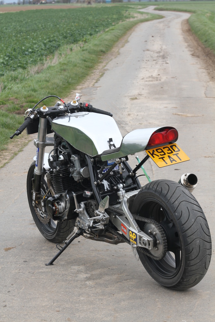

#401 PostAuthor: zed1015 » Sat Feb 24, 2018 7:46 pm
Just been through all this thread and replaced all the missing Photobucket images so they can be seen by anyone again..(done the same with the Drouin and Orient Express threads too)
Added a few "proper" pics here too that were taken by MDM for SF.
