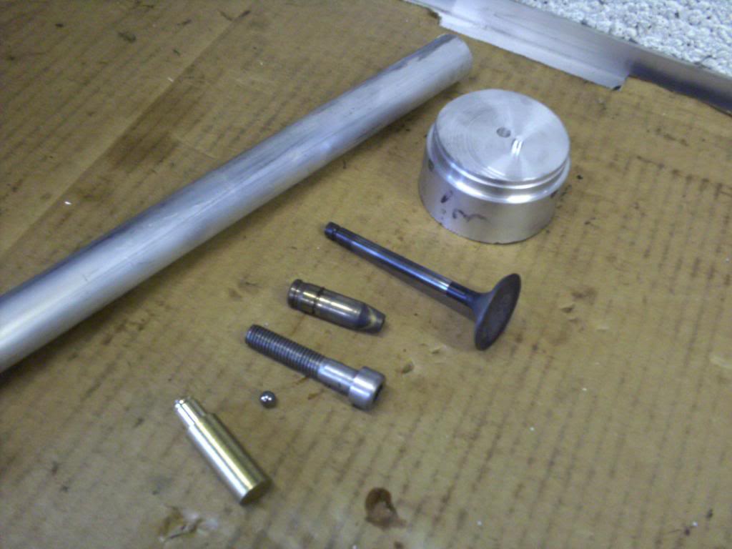

In a rare fit of extravagance i bought a PMFR clutch release mount (it was cheap) as the offset sprocket and chain fouled the original sprocket cover and i didn't want to cut it about as it's a 72 jobbie without the 1n2345 cast in to it.
Trouble was the zx10r clutch cable wasn't long enough to go the normal route under the alt cover but would easily reach under the carbs to here.
A chance to redeem myself for my frivolous spending saw this collection of alloy offcuts and bits from the scrap bin heading for a new life.
Along with the ally, an old exhaust valve , a guide, 10mm stainless bolt, ball bearing and a bit of brass bar were attacked with the lathe for a couple of days
To produce these
The short lump of ally combined with the old valve guide forms the main body.
The bar stock and brass offcut create the arm with pivot bush.
The turned down valve serves as a hardened pusher and the modified bolt with ball bearing pressed in the end provides the adjuster.
A bit of offset turning creates the arm mounting and the 7mm valve guide bore just happens to match the size of the clutch push rod.
Modded valve slides in here
And adjustment screw here
Then the arm slots on to the mount.
Ball bearing runs on the hardened valve pad for a smooth action.
The valve stem was trimmed down to meet the clutch pushrod midway in the guide with a ball bearing between them
And viola. One fulcrum arm clutch actuator :wink:
Just got to finish off with the outer cable mount and job done.
