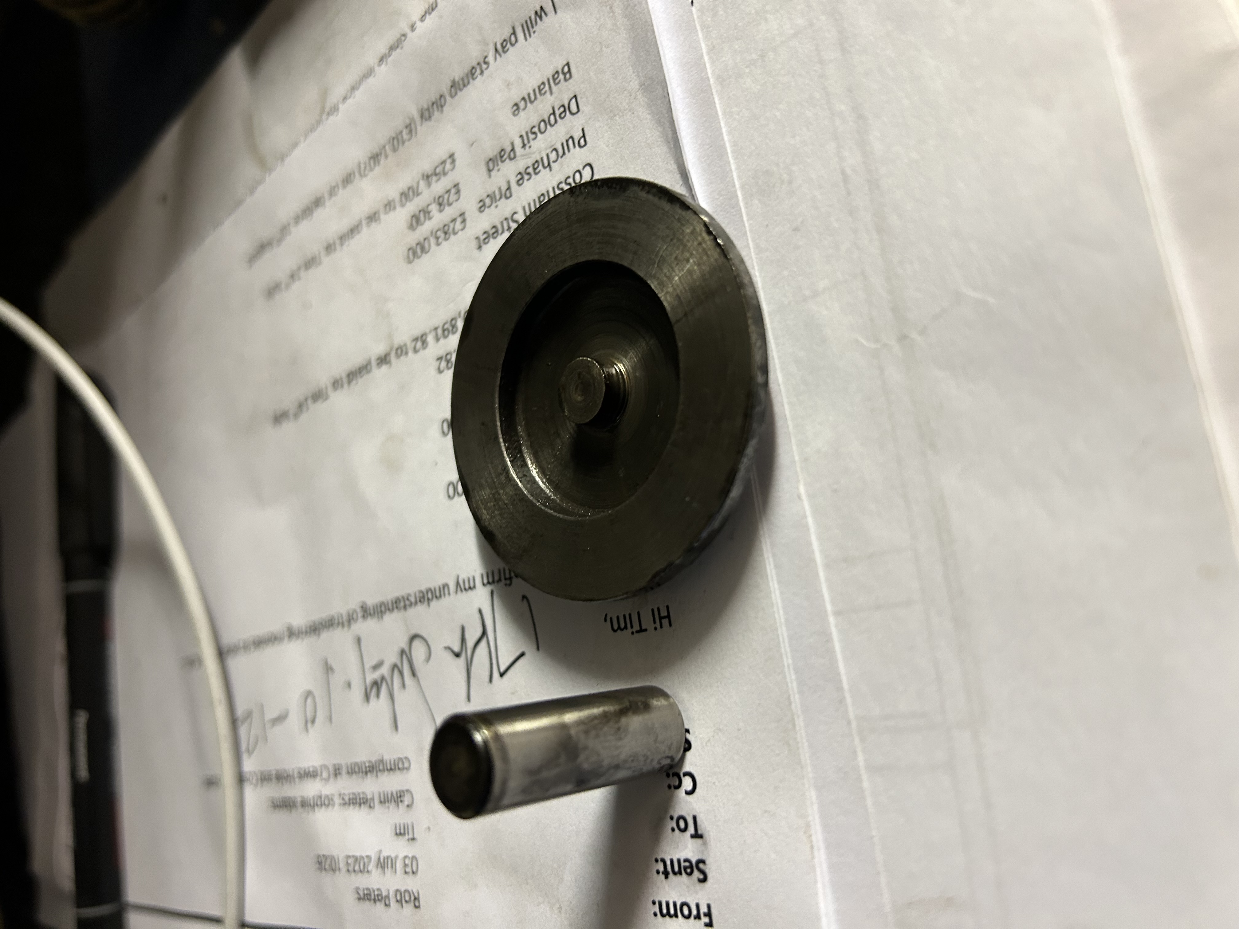

Recently purchased gpz1100 a1. Now starts and runs fine, just MOTd. Engine had noisy clatter from clutch side. Have removed pressure plate and found this. I can’t correlate the set up to the supplement manual diagram. I and guessing these two pieces should be one piece?

Appears to be parts 92043 and 92026A which are seperate parts..

thanks guys, yes looks correct Rob, the supplement shows the pusher set up in the box which is where I confused!....
I will remove the basket today and look check. is there a topic link to Buzzards thread??
cheers
