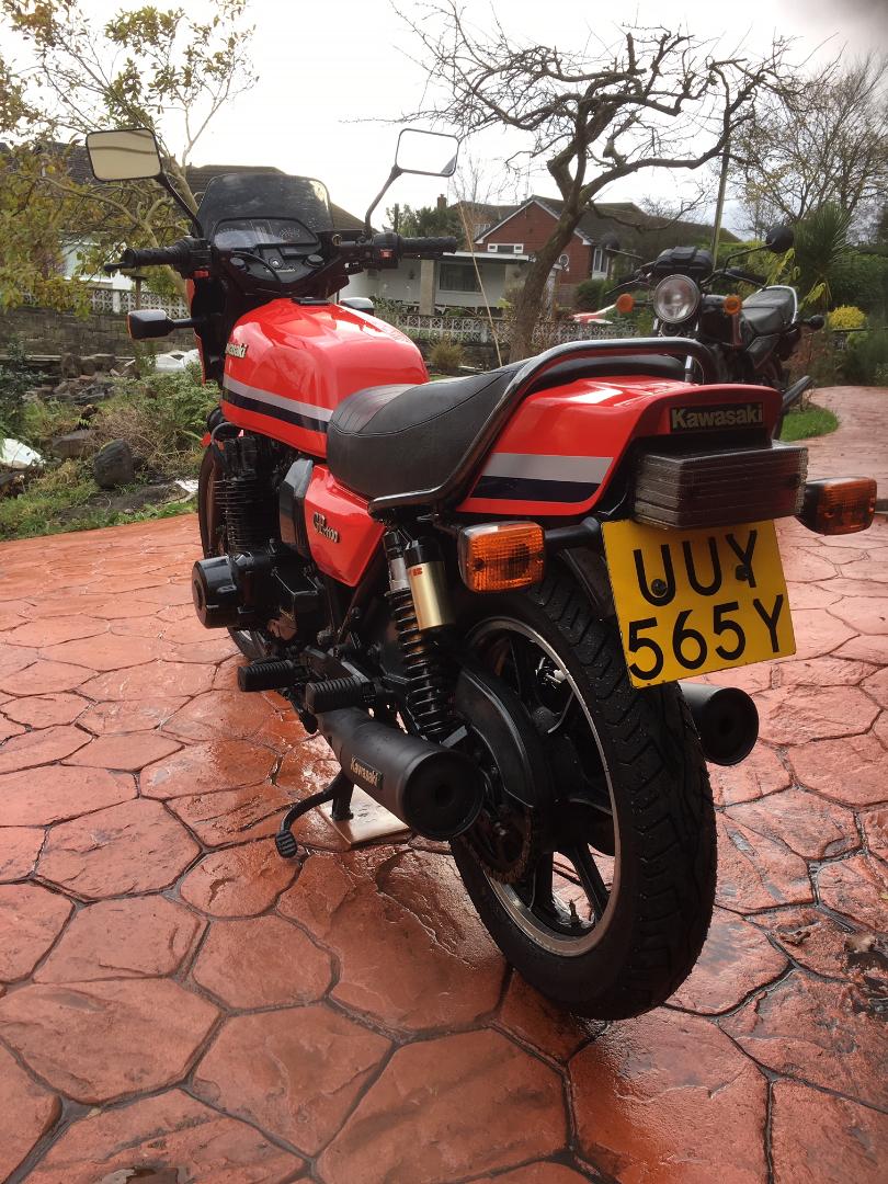

here you go scott zrx shocks on my b2 but i had to alter chain guard a smidge.

Very nice bike mate
