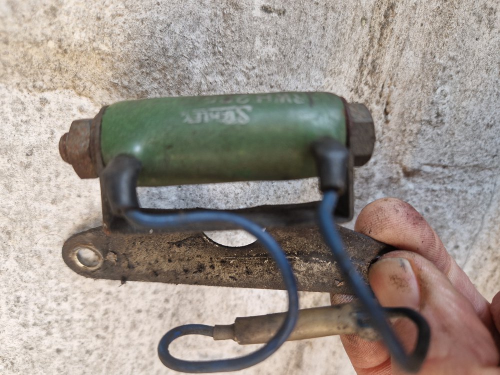

Just in the process of changing the coils, I'm replacing with Z Power parts shown. Is this a resistor? There is only one mounted under the right coil, cylinder 2/3. Do I still need it? It would have been like this since the late 80's when the frame was sprayed. I'm using NGK B8E S sparkplugs. The more I read up on resistors the more confused I get!!

It's nothing to do with coils. It relates to the headlight. It connects to the blue wires on the RH and LH switch blocks

Thanks a lot, I will junk it then. It's had its wires plugged together since....

I remember when I was restoring an XL185 it has a "ballast resistor" connected in the headlight circuit. it was broken so I deleted it and just joined the wiring ends together , but then it started blowing headlight bulbs - turns out it damped down surges in voltage/ampage when revving , which could lead to blown bulbs through overload. Prob was sorted when I found one and refitted it. So it may actually do something - if you delete it then watch for electrical issues elsewhere

Many thanks, I discovered it as pictured, the blue wires are connected together and have been for 30 years.
