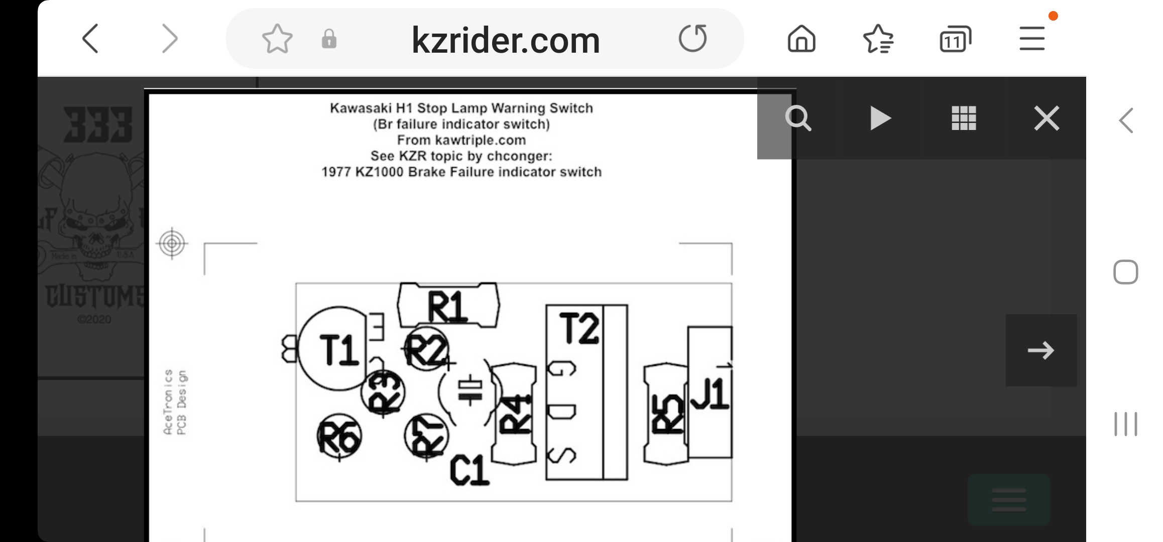

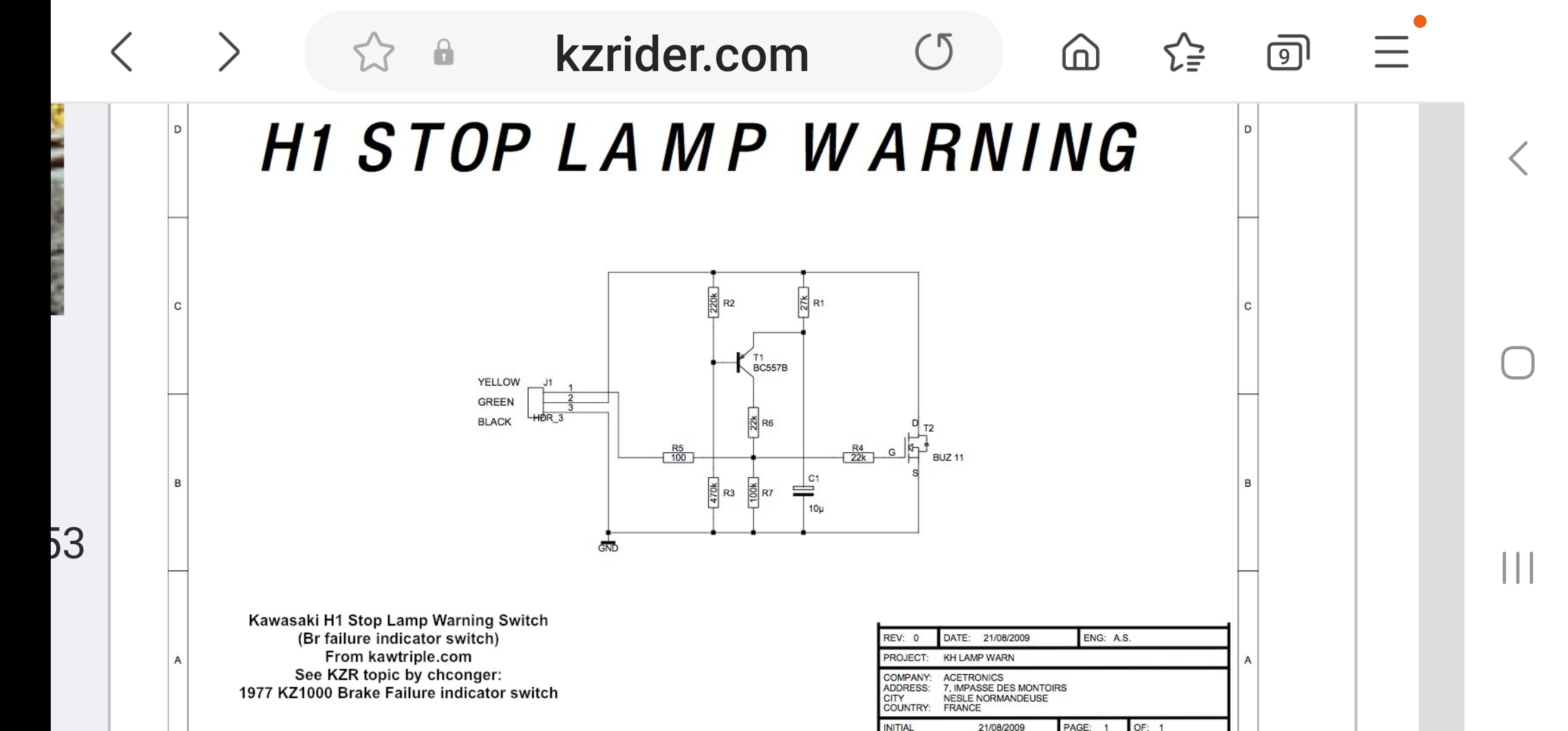

Anyway i stumbled upon a circuit for this using a handful of electronic components so you could make up your own, if your that way inclined See photos
Parts needed
1. Transistor BC558B
2. Mosfet BUZ11
3. Capacitor 10uf 16v or 25v
4. Resistors 1/4w 100, 2x 22k, 27k, 220k, 470k, 100k
5. Piece of veroboard
6. Project plastic box
Total price for all components about £12 but you do get 10 each of resistors. So may have a go if cant get one fully built.
Anyway thought I'd share it so any budding electronics gurus can comment, or indeed if they've already built one.

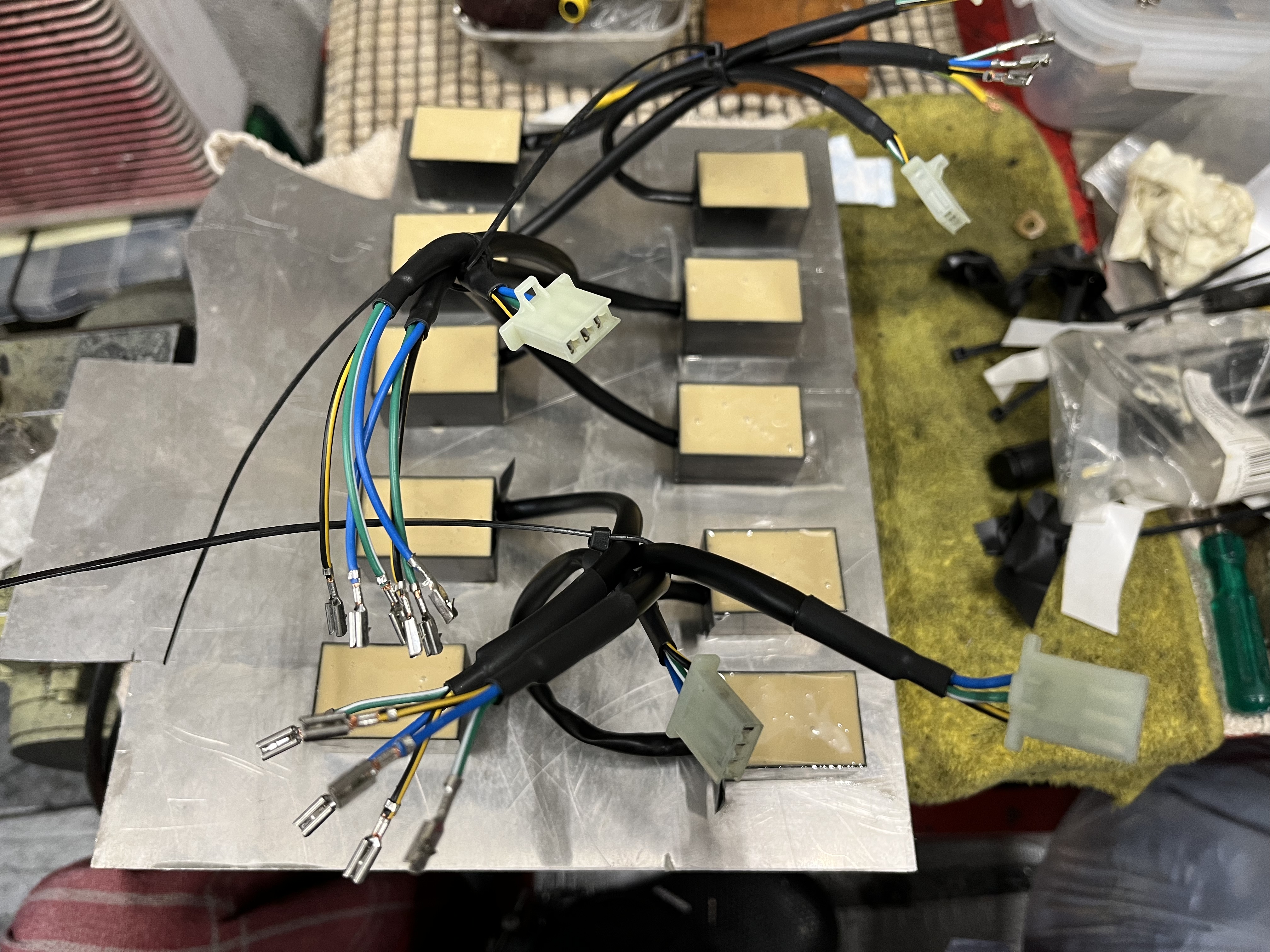

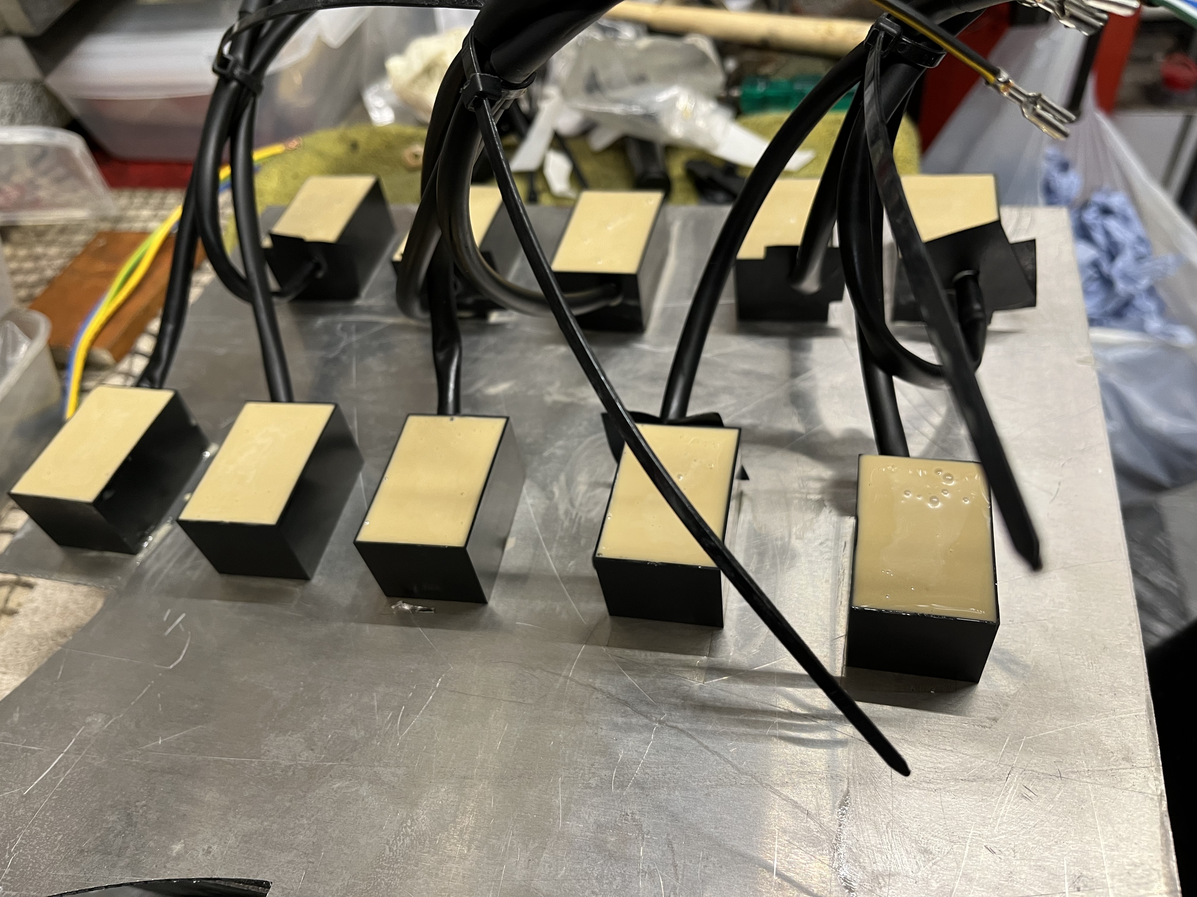

Already been there and done that.
The prices you have quoted look a little light to me having made a quantity of these.
I made 10 for economies of scale but the correct connectors, correct coloured wiring and the potting compound bump up the cost.
I also used slightly higher wattage resistors as a belt and braces approach which does make the finished unit slightly larger than the original.
These units fit most Kawasaki’s with the brake failure system as well as some early Yamahas.
I have 7 left if anyone needs one at £30 each plus postage. This figure covers the cost of all materials plus a small labour charge.
