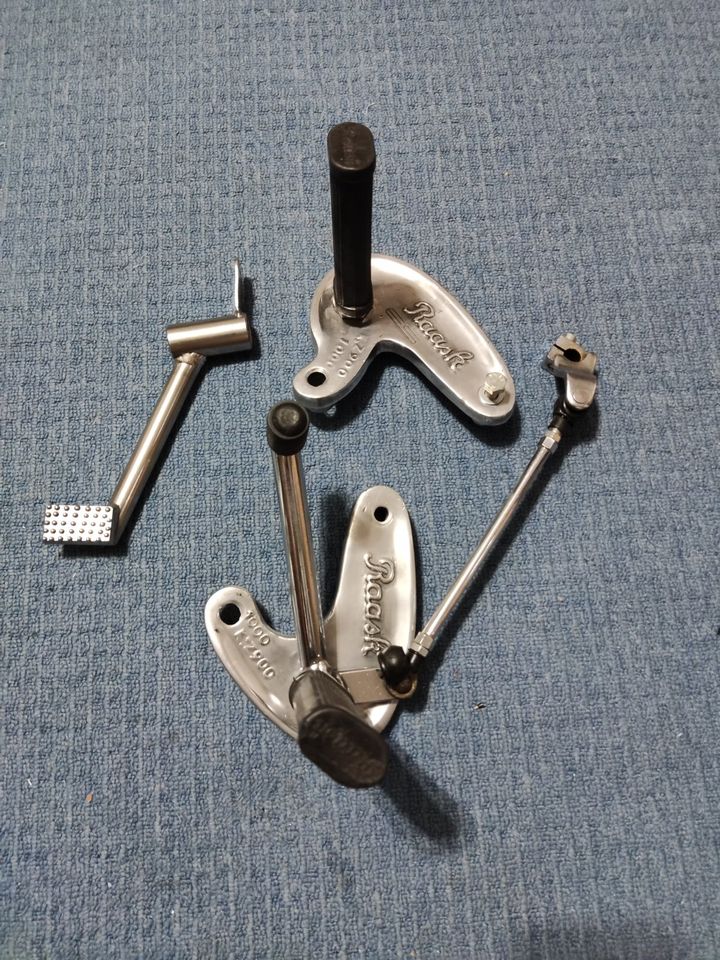

Raask did a near bolt on set up back in the day, they look like these below.
Edit. Apparently they can be still bought new.
https://www.suzukiperformancespares.co. ... sets/6867/

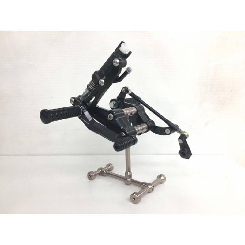

As Zed1015 said there is no direct bolt on (trust me iv looked) but for a bit more cash there is the K-factory rear sets from Japan, a bit of a cost outlay but between buying a set of rear sets, time taken to modify them and other bits and pieces you would probably be paying out nearly the same. Here is a link to webike and a pic of them.
https://www.japan-webike.ie/products/23658020.html

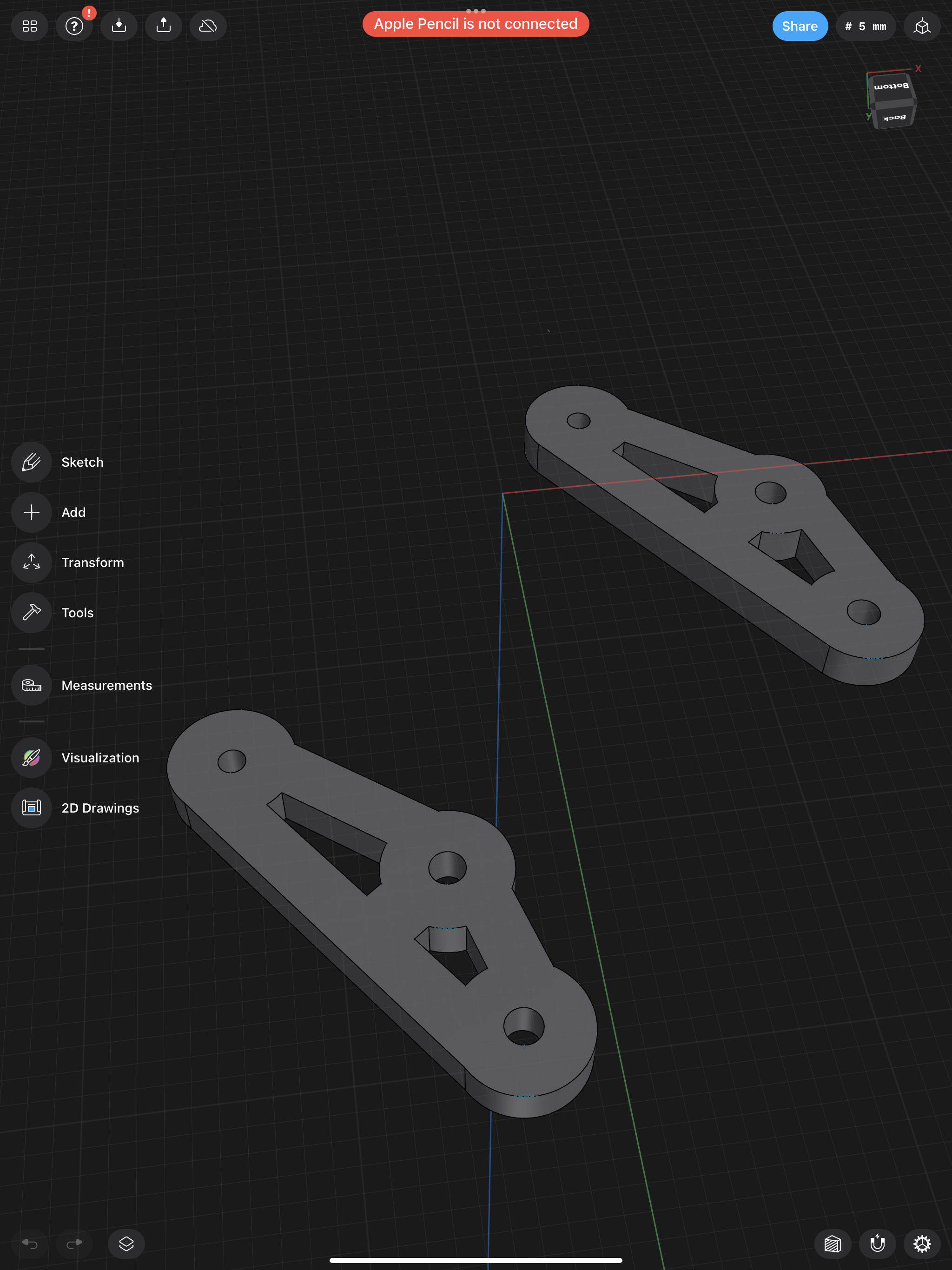

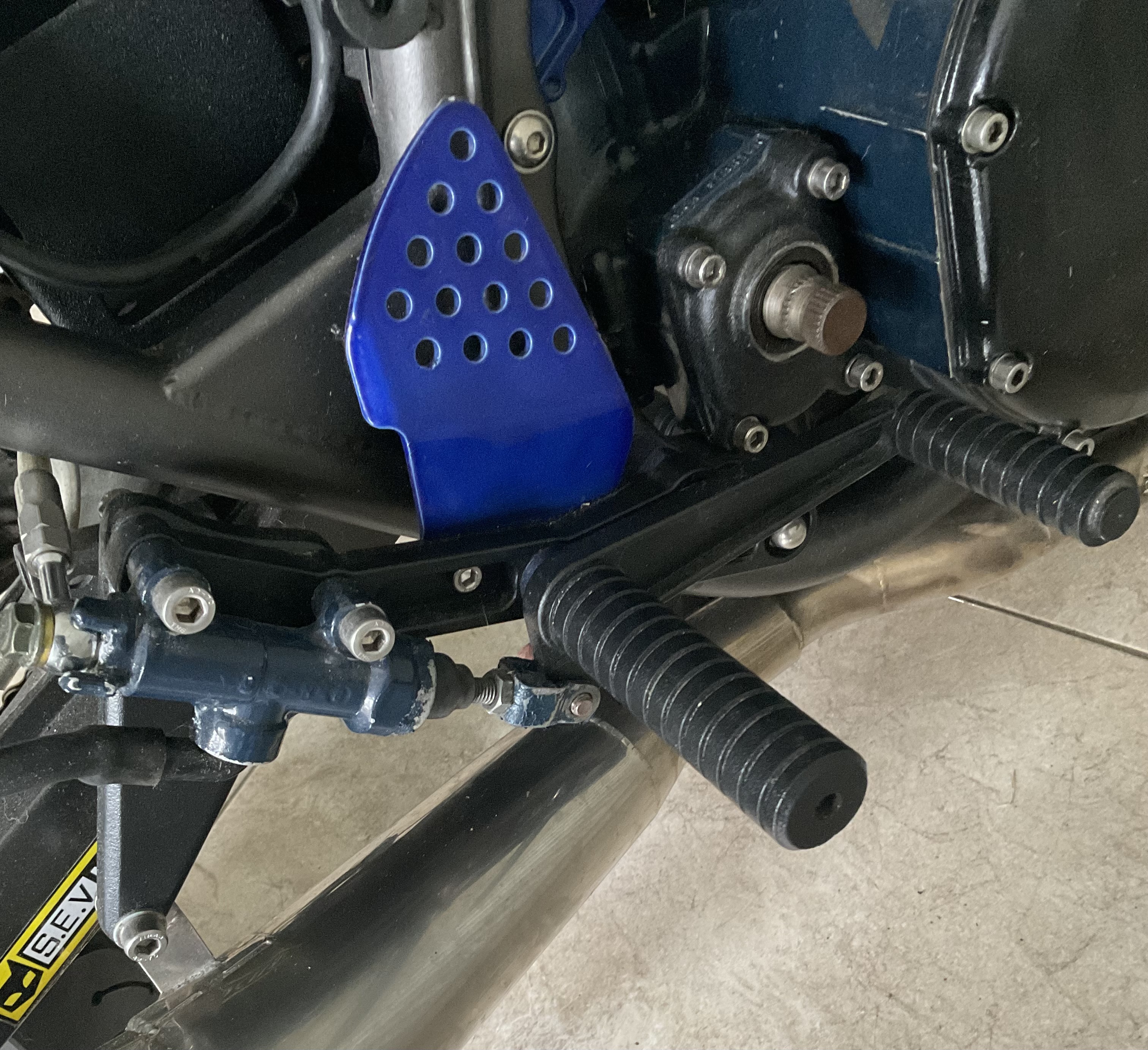

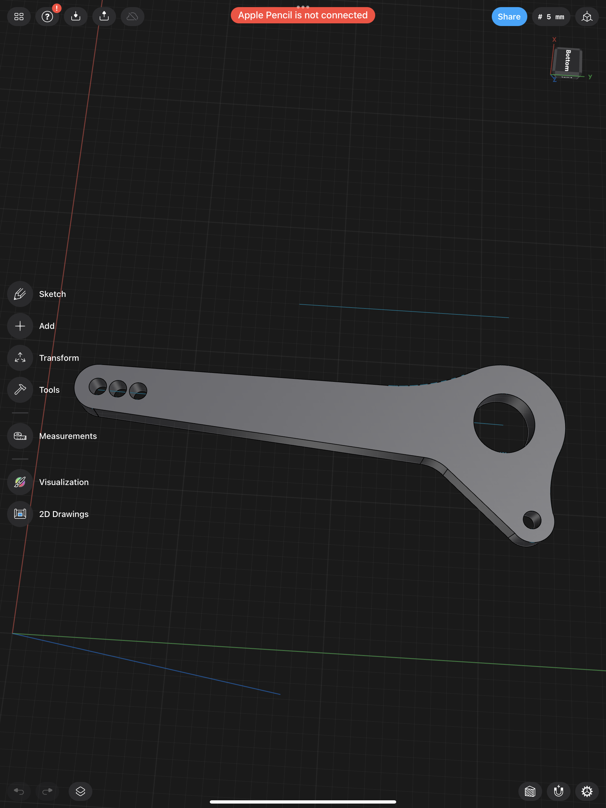

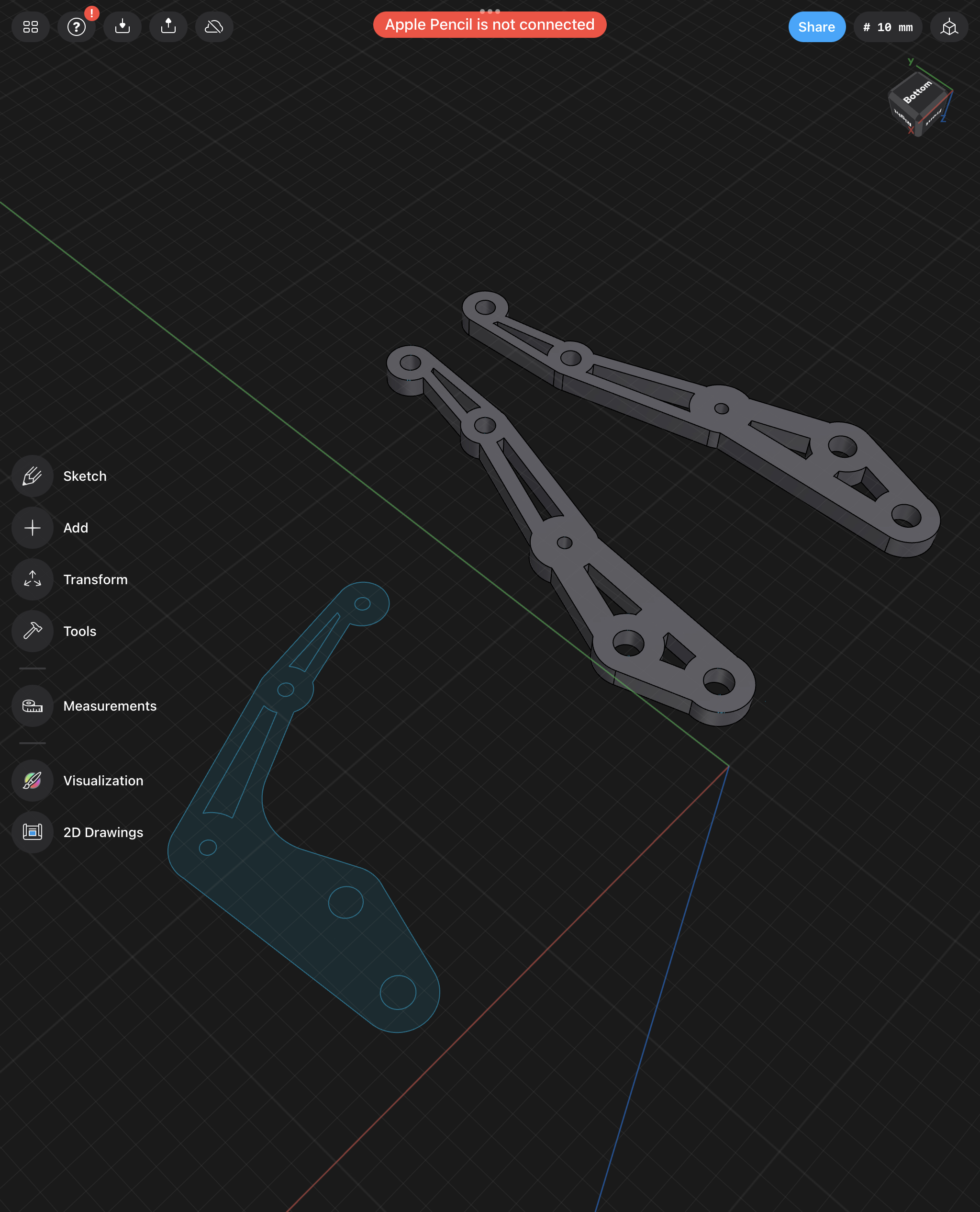

I also have a set my my z1000a1 (self made) and will be making a few later this year (once I can afford the cutting time…) for a few of my bikes.
