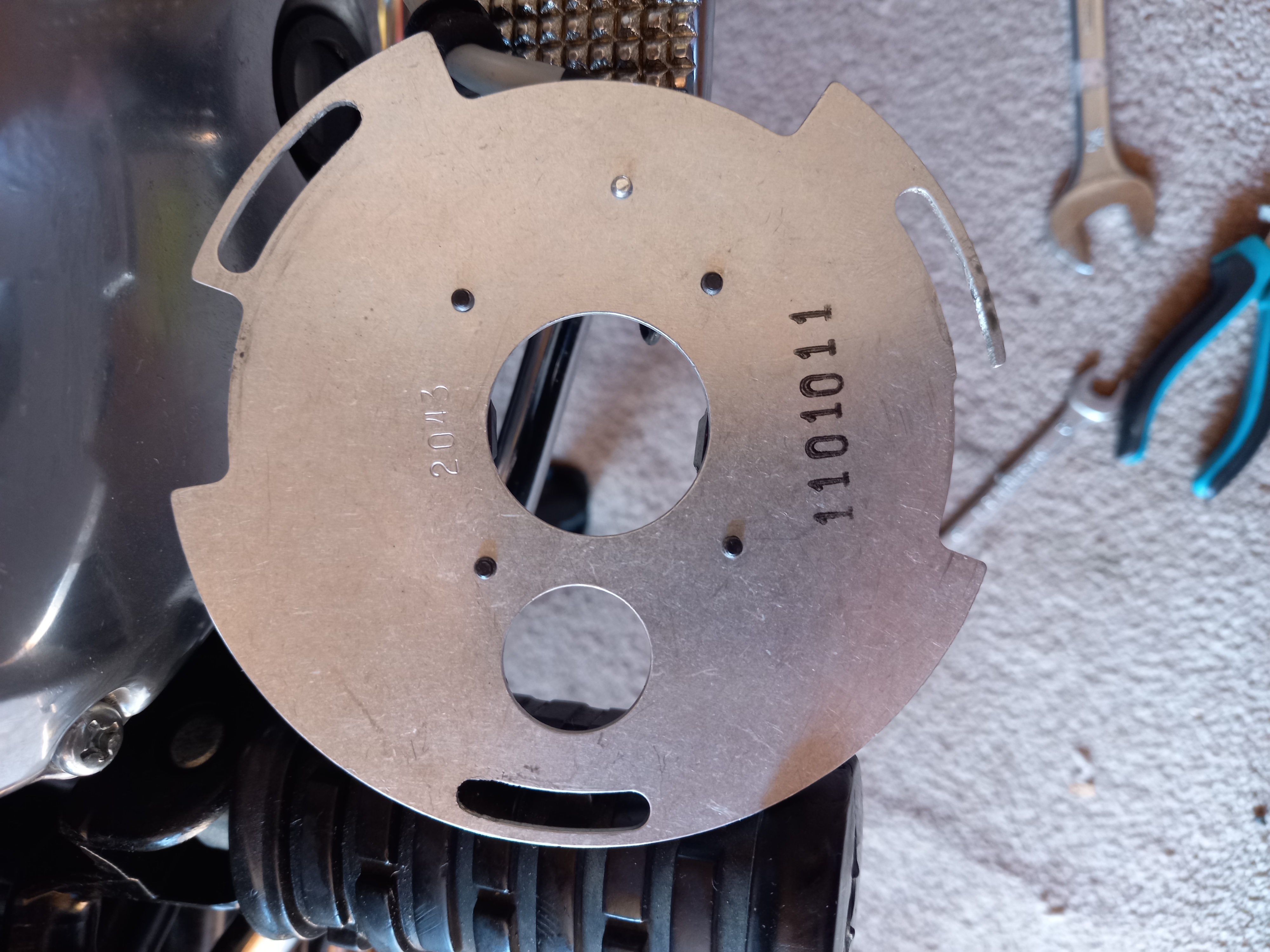

See photo for dyna date stamp.

If that was bought new 2021 i'd say that date code is manufactered 43rd week of 2020.
They have changed somewhat since i last had one ten years ago. It was dated 1995 so did a good few years work and then i gave it to someone and it was still OK!
That is the newer version of pickups which potentially puts it in the range (very vaguely) of the faulty batch. Not that thats likely to be any consolation as they will probably say its out of time. I would still phone them and explain though. They still appear to be offering the 15% discount which may ease the pain a little.

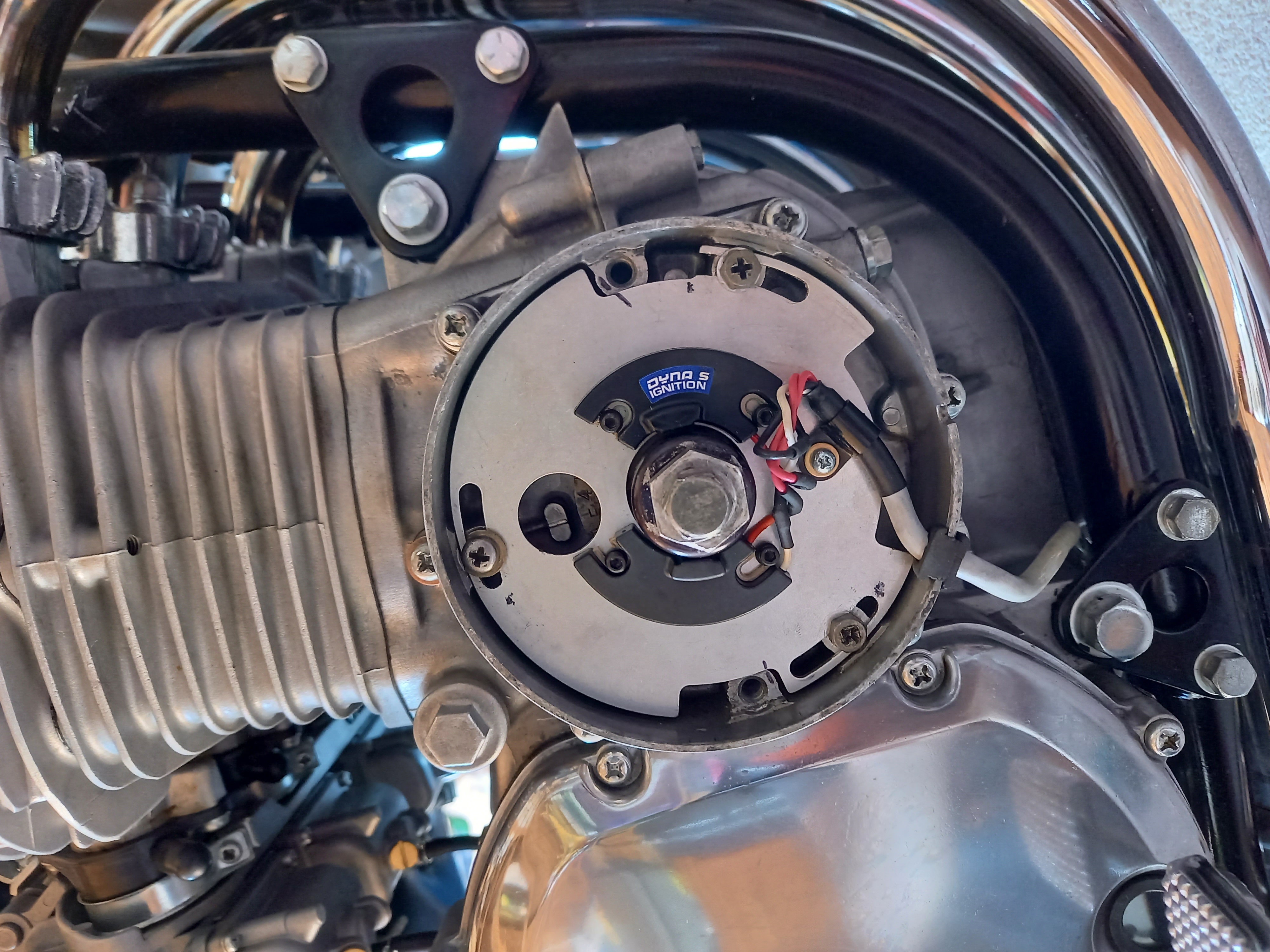

That centre rotor has had a spanner against it, a lot! More importantly; it looks like it has been rubbing against the pickups or one of them at least!!!

Al wrote:That centre rotor has had a spanner against it, a lot! More importantly; it looks like it has been rubbing against the pickups or one of them at least!!!
The marks on the rotor are unavoidable- from my spanner rotating the engine to check valve clearances as I start to wonder what else might be set incorrectly (new bike paranoia syndrome :D ).
There are no signs of anything rubbing against the pickups and no witness marks on pickups or rotor.
Still waiting for new bits to arrive.
Today I thought I would static check the timing out of interest with the Dyna in its original position.
According to Dyna timing instructions, 1/4 cylinders, left hand Dyna module, with rotor held fully clockwise and bulb connected to coil trigger wire (+ earth) then the bulb should light up when the timing mark on engine is aligned with the small mark on the ret/advance unit (the mark about half an inch to the right of the "F" mark).
This was not the case. When the bulb lit up the actual "F" mark was aligned?
So that is wrong then? (Although engine was running strong before the coil/dyna packed up?).
The 2/3 side is dead so couldn't check owt with that.
