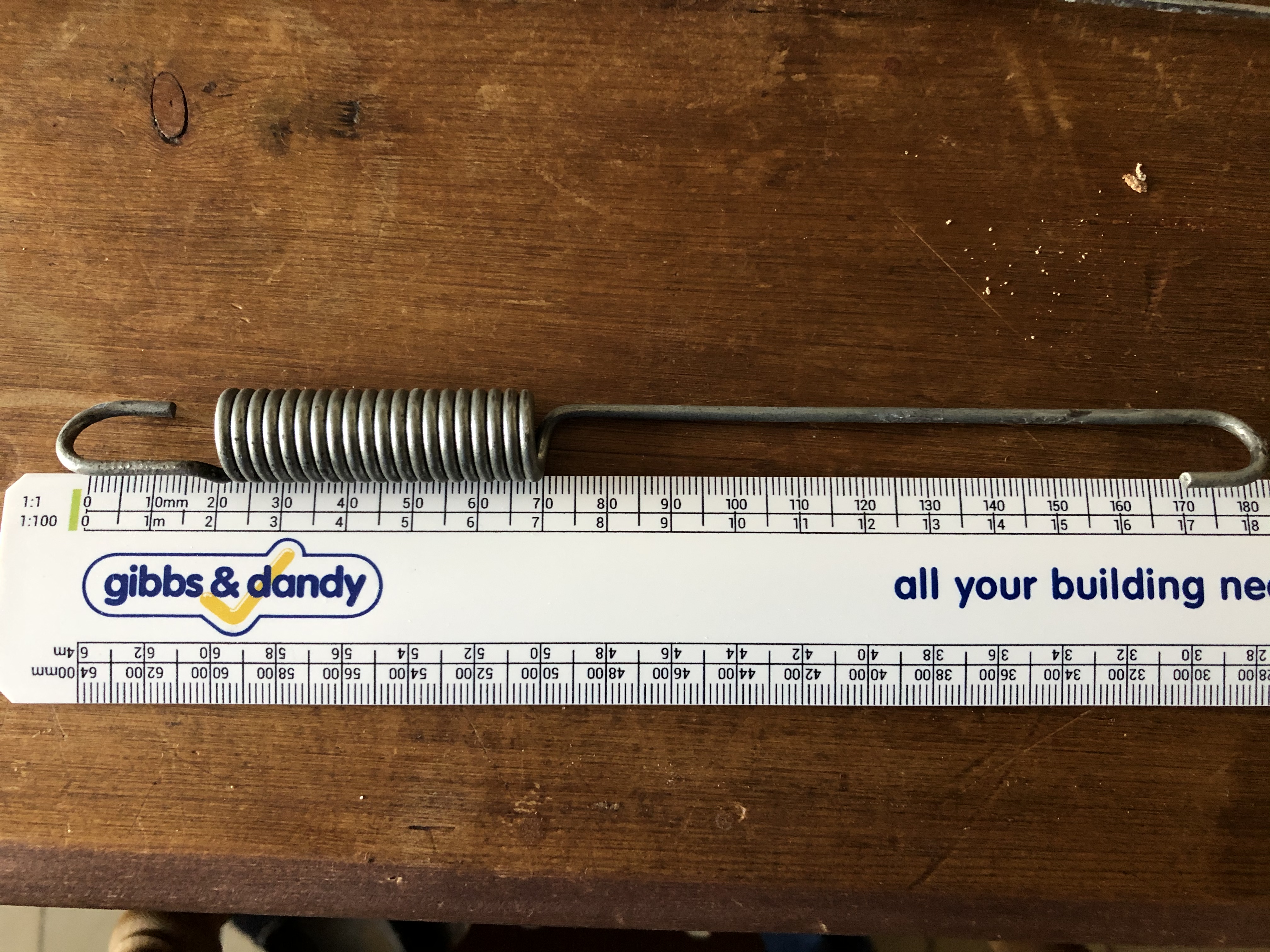

Just getting the J all ready for when were allowed out again and last year I had a rather scary moment when the side stand decided to flip down on me when ridding! Assumingly because I had the wrong spring setup on it.. SO I am after the correct three Springs needed but all seem to be no longer available. Does anyone have any ideas on where to source these?
92081-1464 - SPRING,SD STAND,L=49
92081-1480 - SPRING,S STAND,L=177
92081-1463 - SPRING,SD STAND,L=109
Thanks in advance everyone!
Lee

Lee not your part No’s but look at other mods German ebay is ok for springs them sizes look common :biggrin

Lee take it with 3 ur running cutout switch just checked yours there the same as German z1r :biggrin
And if u are do u need the switch spring ?

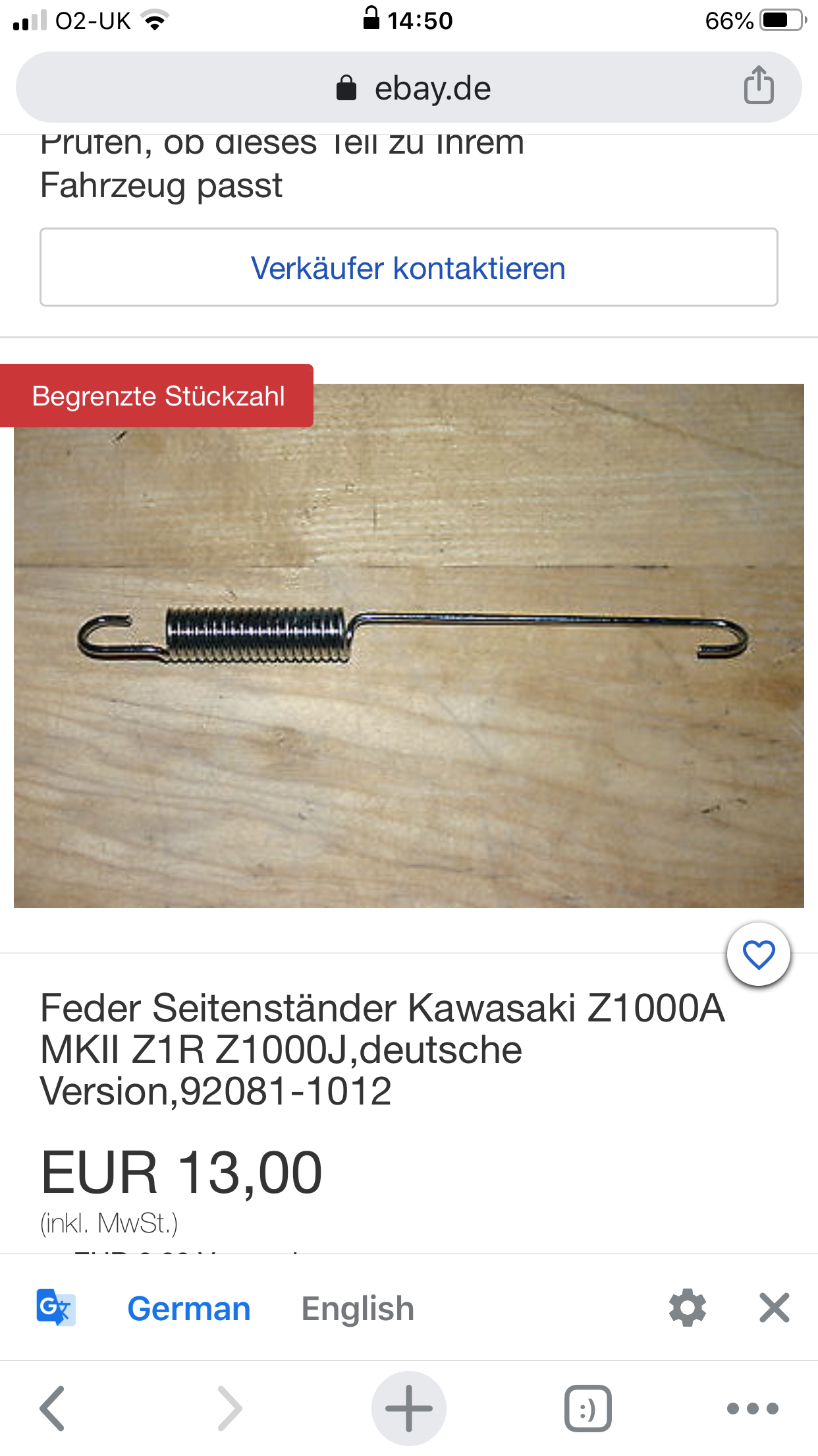

The 13 euro one fits ? Last time I looked there all on eBay. De

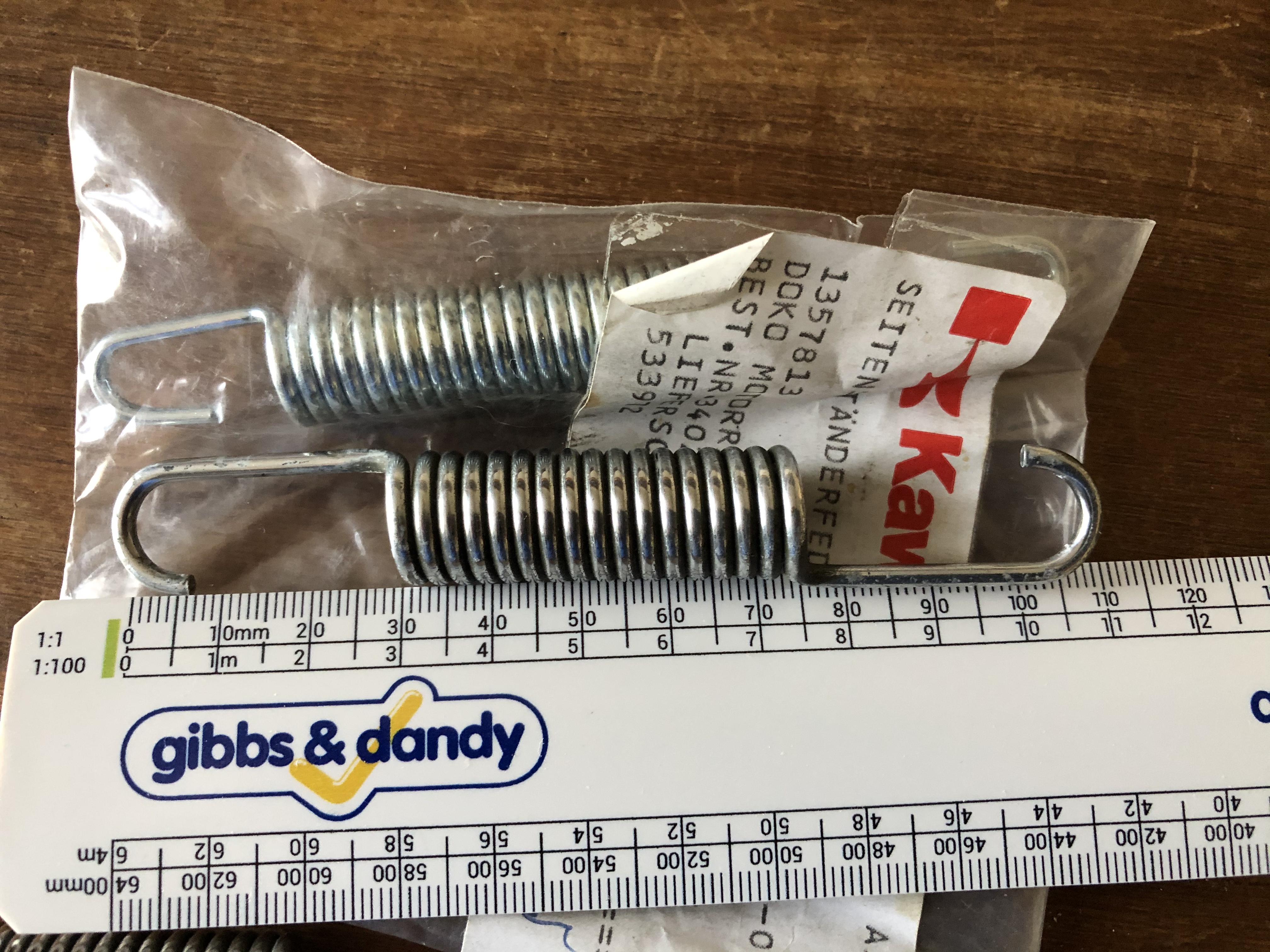

Lee u may have incorrect side stand and had correct springs ? Look at pic 2 the other spring is a bit distorted and longer as incorrect stand was used on the 1000s I got Germans had 2 for 18” wheel and 19” make sure ur stand is right first :biggrin

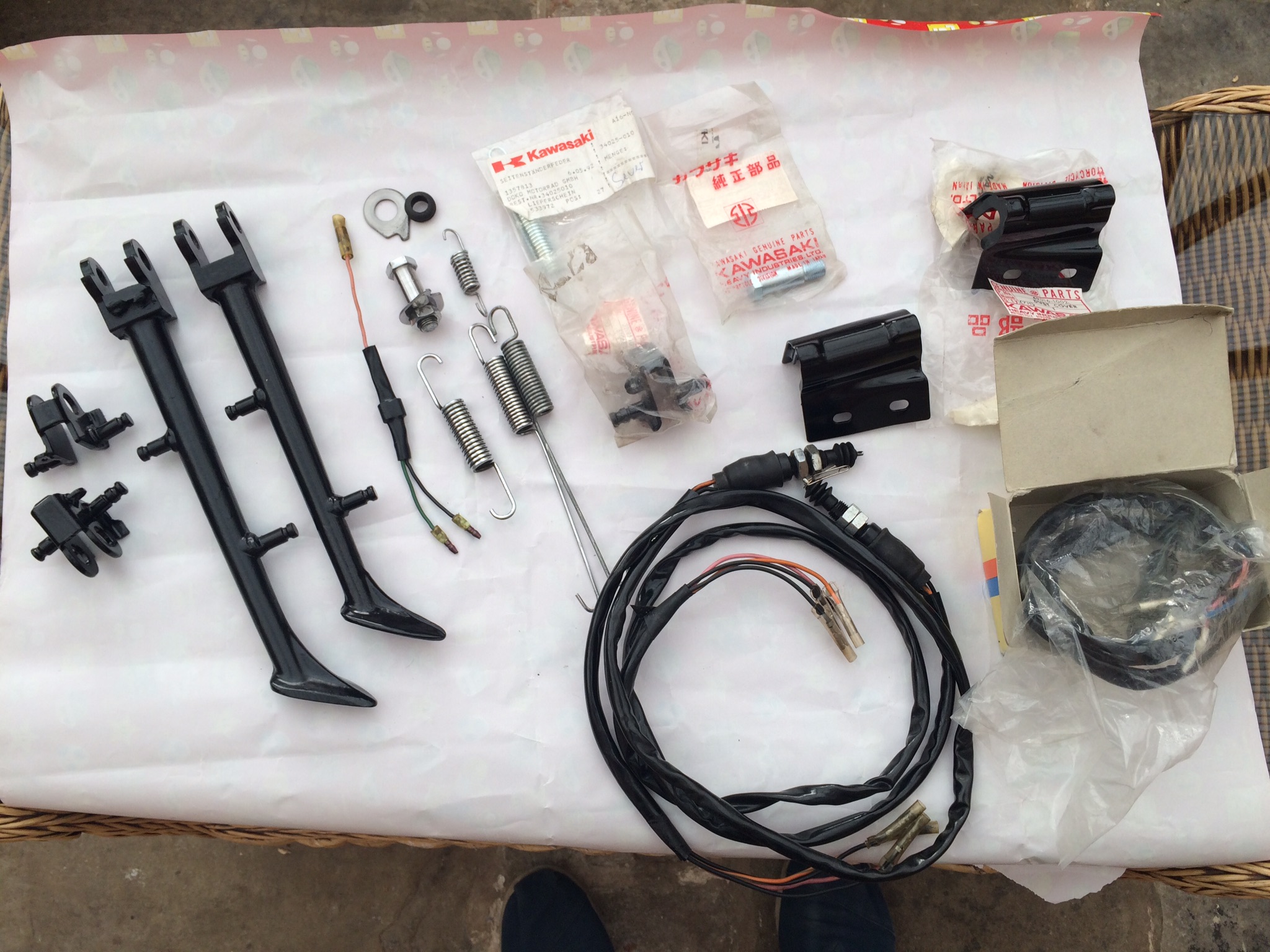

I have a complete set up if you need. Stand, washer and 3 springs.

compo z1r wrote:Lee u may have incorrect side stand and had correct springs ? Look at pic 2 the other spring is a bit distorted and longer as incorrect stand was used on the 1000s I got Germans had 2 for 18” wheel and 19” make sure ur stand is right first :biggrin
Compo thanks for the feedback, I don’t need the short spring indeed as I’ve no cut out switch. To complicate things identifying the setup needed this bike came from France although when I checked the French drawings it looks like it had a single spring stand so all a bit confusing.. bike started life as a standard J2 and was very much standard so I’m thinking the stand should be correct. The springs could have gotten confused in my own mess though and I’m damned if I can find any more to cross check. So the stand you picture there look two different lengths so I assume two different spring setups?

tlc wrote:I have a complete set up if you need. Stand, washer and 3 springs.
TLC - long time hope your well? Now that may be the easier option to ensure I don’t get the wrong combo of stand and springs. Will send you a PM. Thanks!
