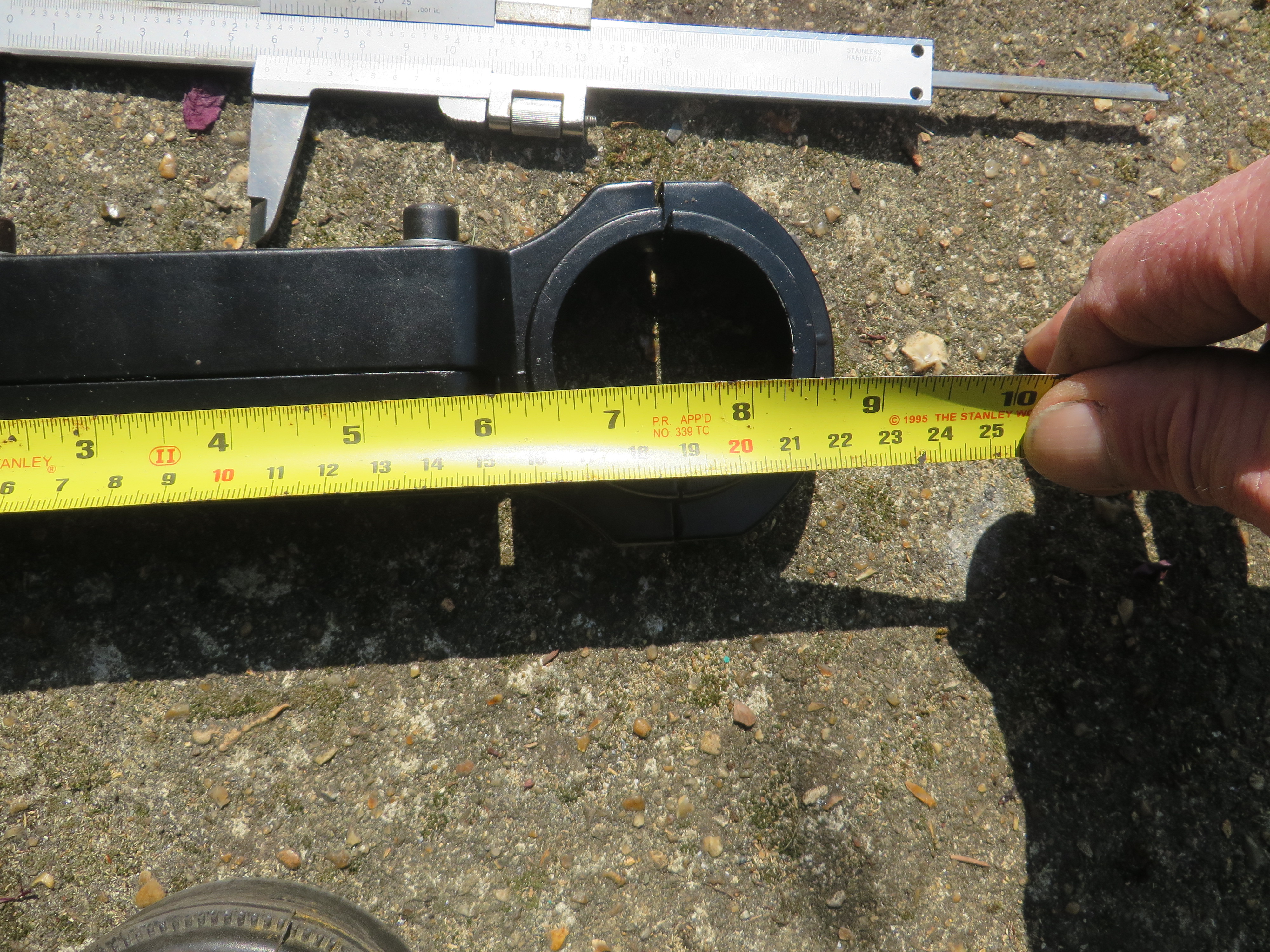

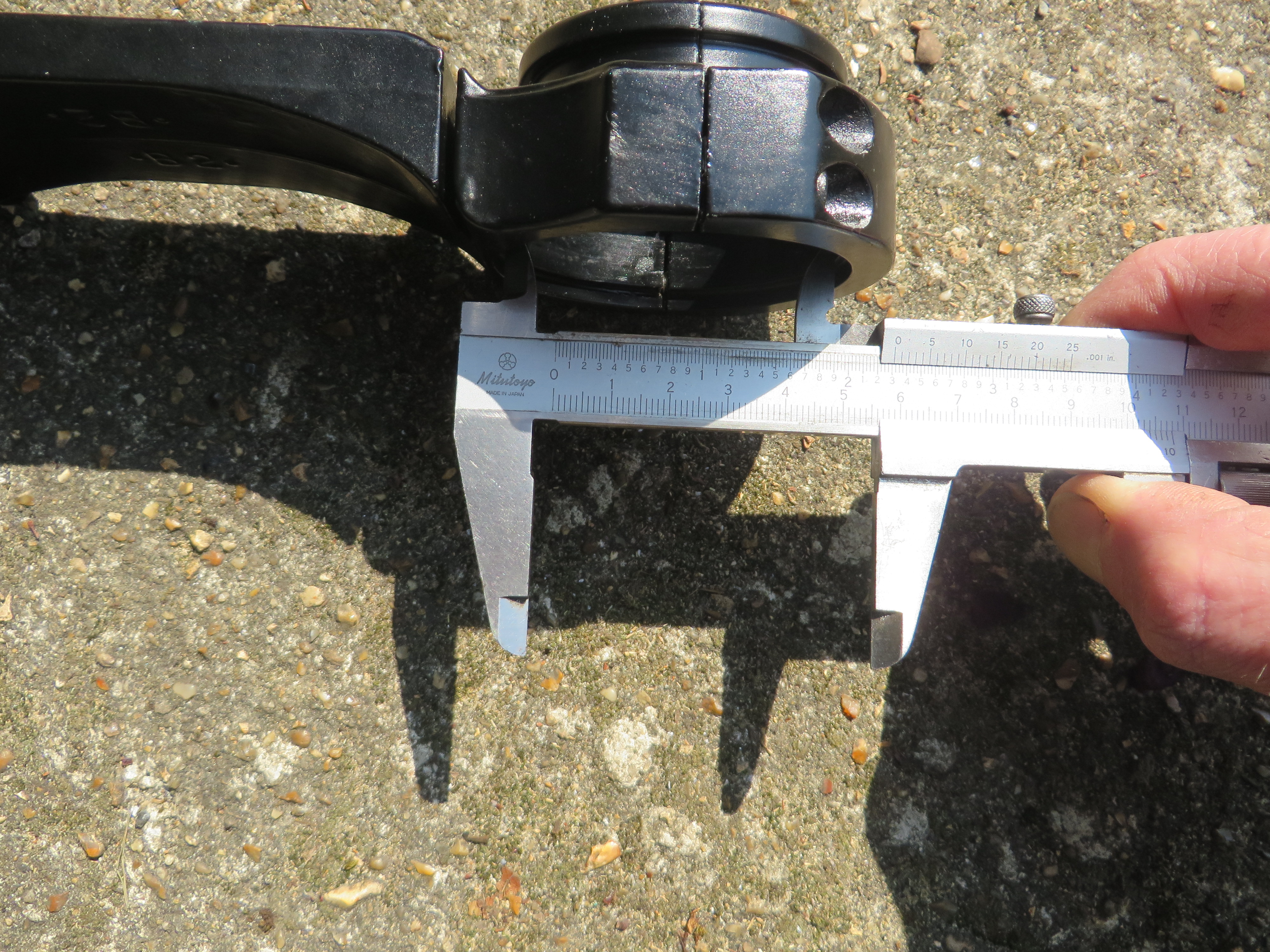

Great info! The dimension of the forks where the brace would fit looks to be 59.5mm? Think the the only option for a mudguard is as you say Al.

#13 PostAuthor: Al » Fri Apr 10, 2020 12:12 pm
Scott's fork brace is 59mm at the point you measured your forks so should clamp up just nicely.
The fixed distance centre to centre of the fork legs is 185 to 186mm although there is some movement / adjustment with the two 'through' fixing bolts.
