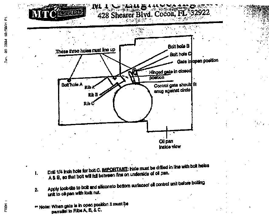

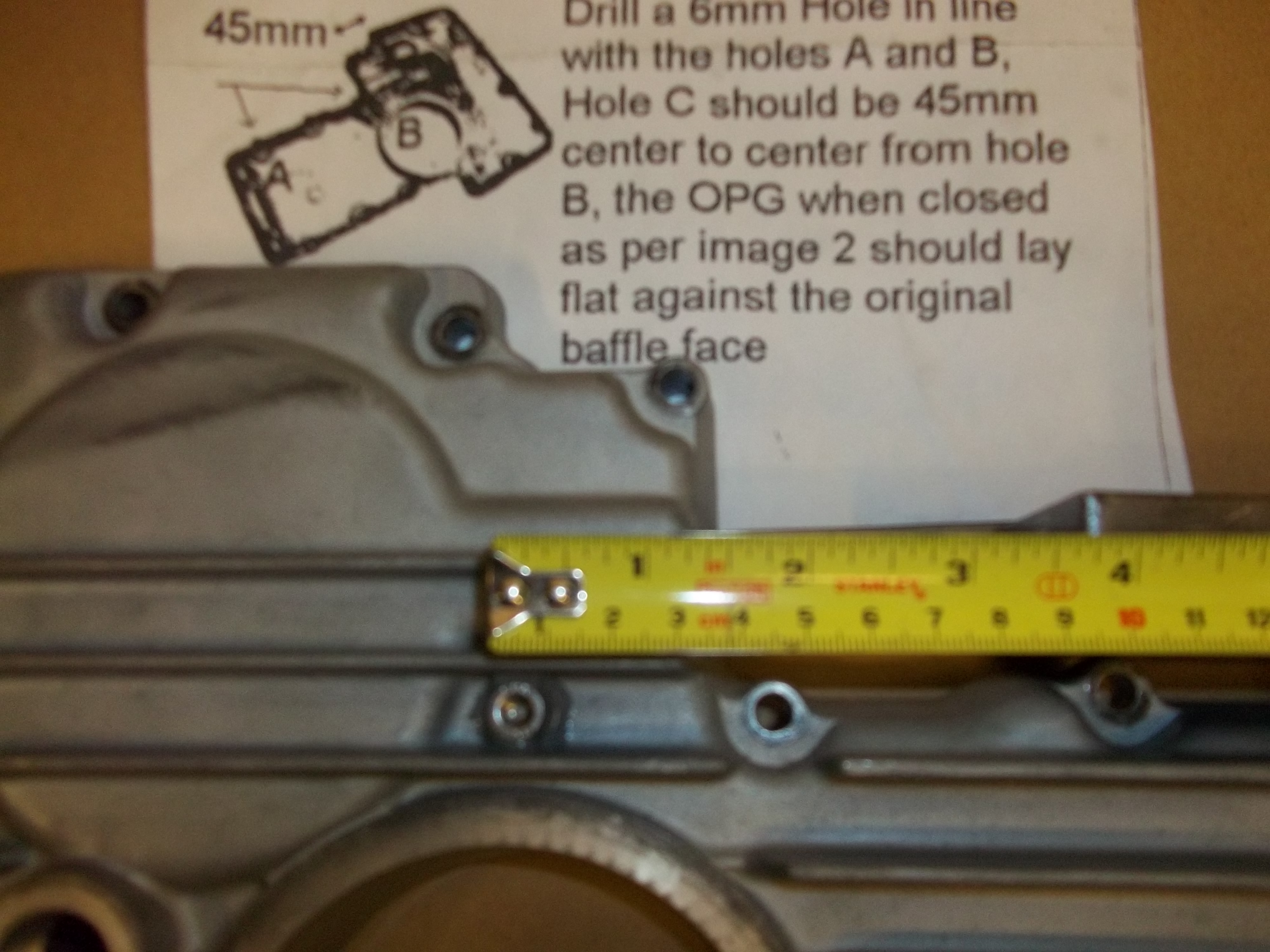

Hope to take the sump off soon to drill for the oil pan gate. This is a similar drawing found on the web - if anyone else has put one in, is there anything i should know before i 'go ed'and bolt it up?

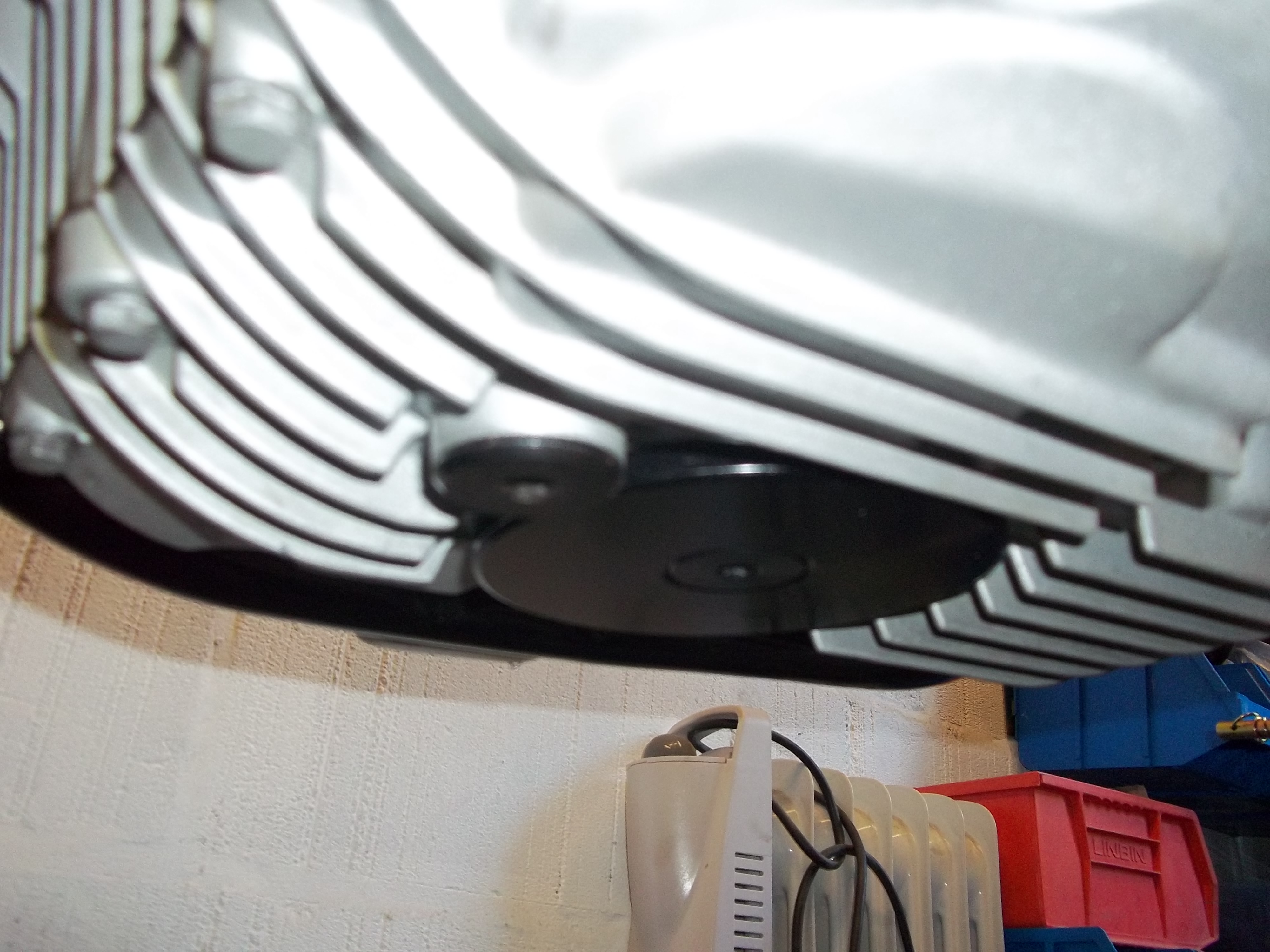

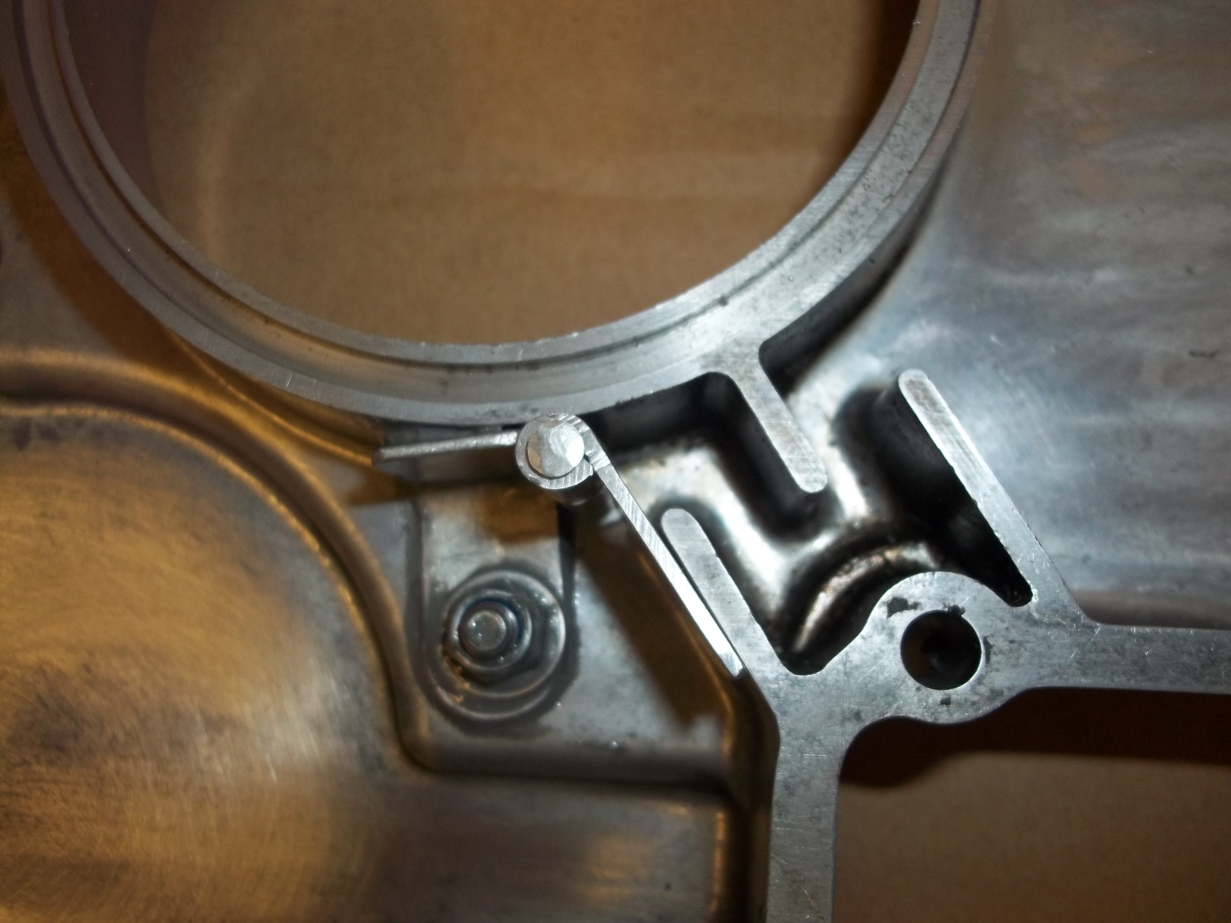

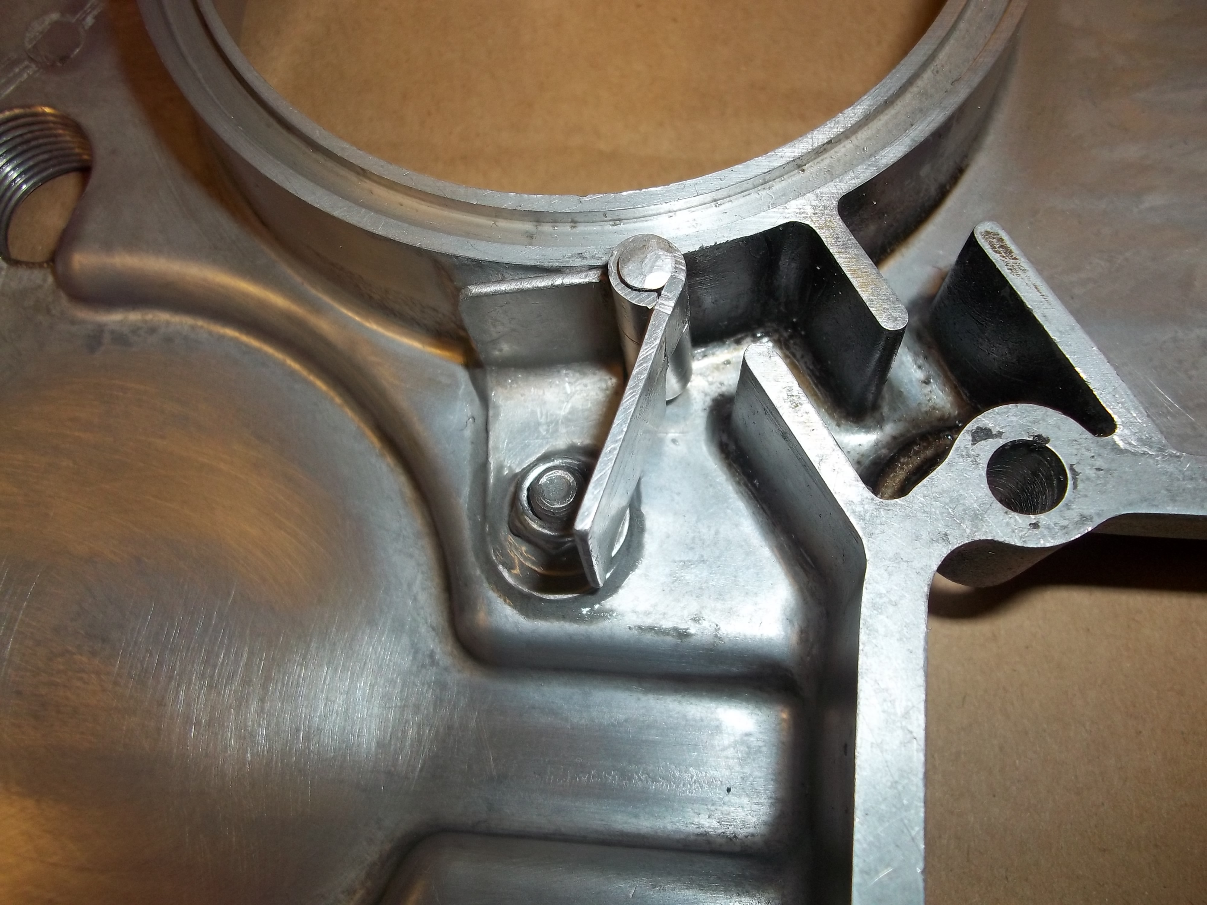

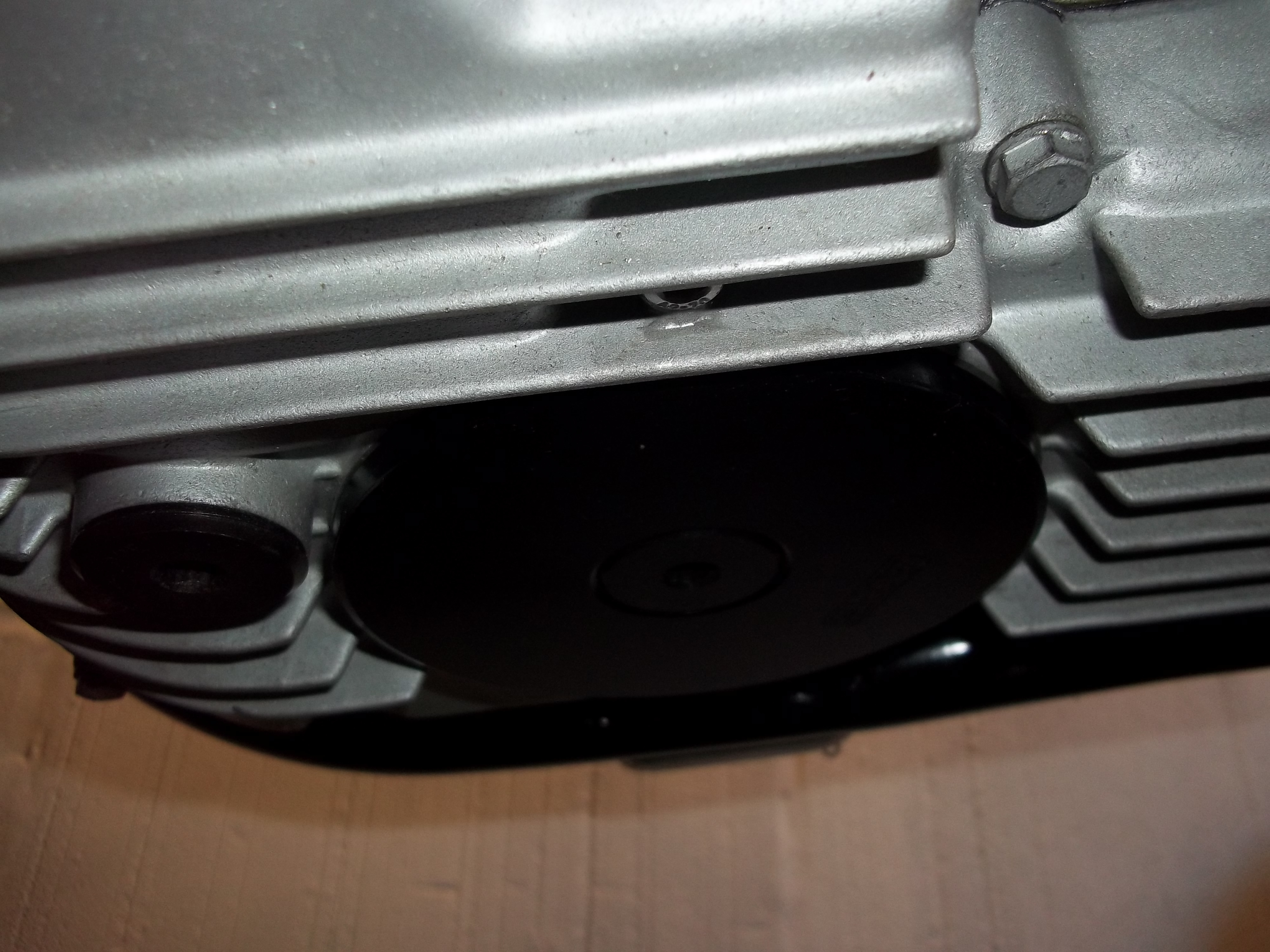

I have actually fitted the Oil pan gate tho' - i know many have put these in but i couldn't find any pics on the forum of what i consider a worthwhile (relatively cheap) mod - think it was £16 from Debbens.
I drilled and tapped the sump for the 6mm bolt, then bonded it in (bolt/gate/nut) with Double bond cream (supplied FOC
) and have used it before with good results.
http://www.silmid.com/Products/Surface- ... 001KG.aspx
If its good enough for the Aero industry - it'll do for me.
Gate open -
Gate closed -

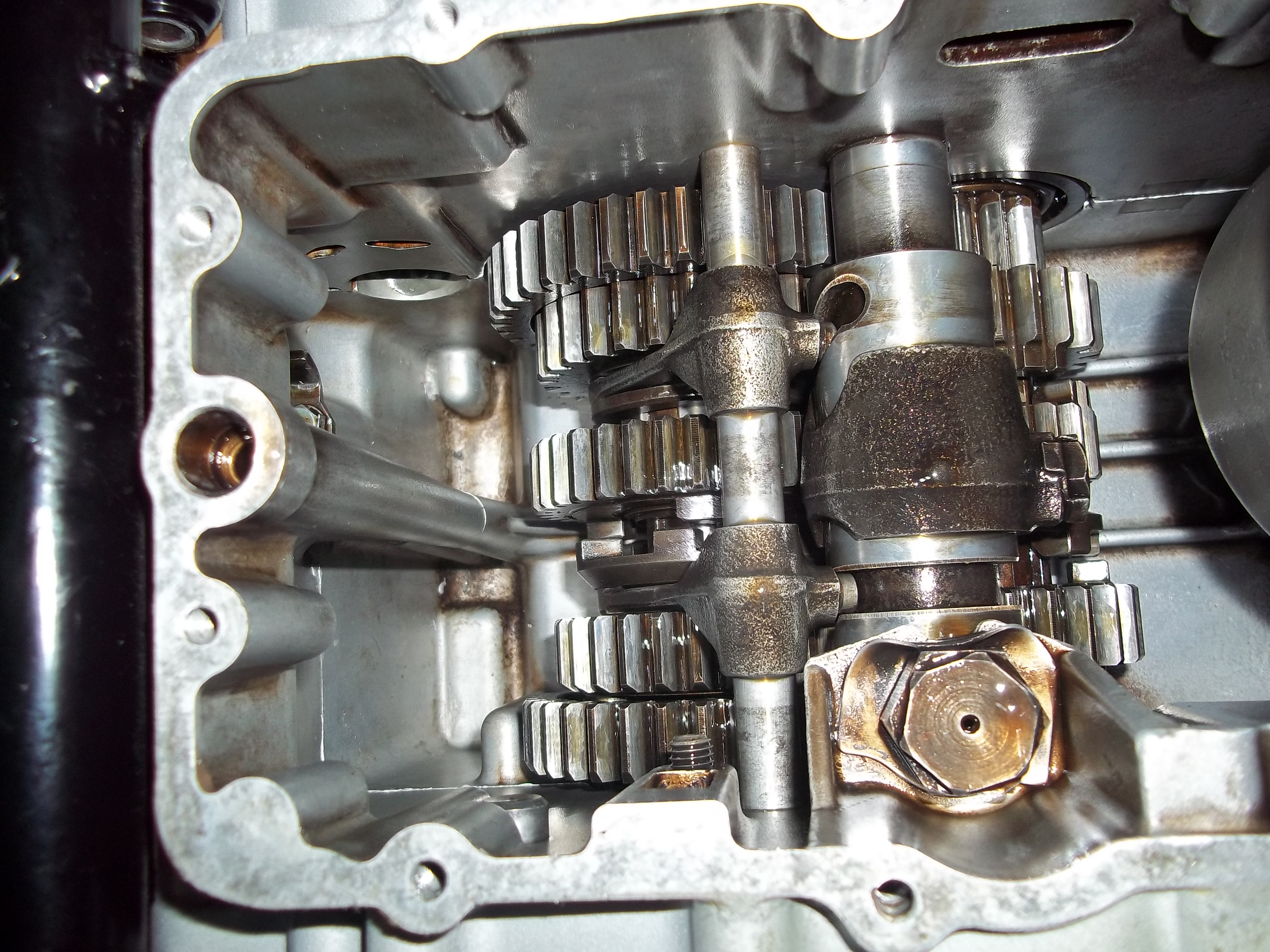

Gearbox seems ok - unless someone can see anything wrong..... (i might have actually done something right
) .....dont know where that missing teaspoon ever went but.....well it aint in the sump.
Anyone notices anything let us know! I'll be putting the sump /exhaust back on .....well..... errr soon.
Gate open -
Gate closed -

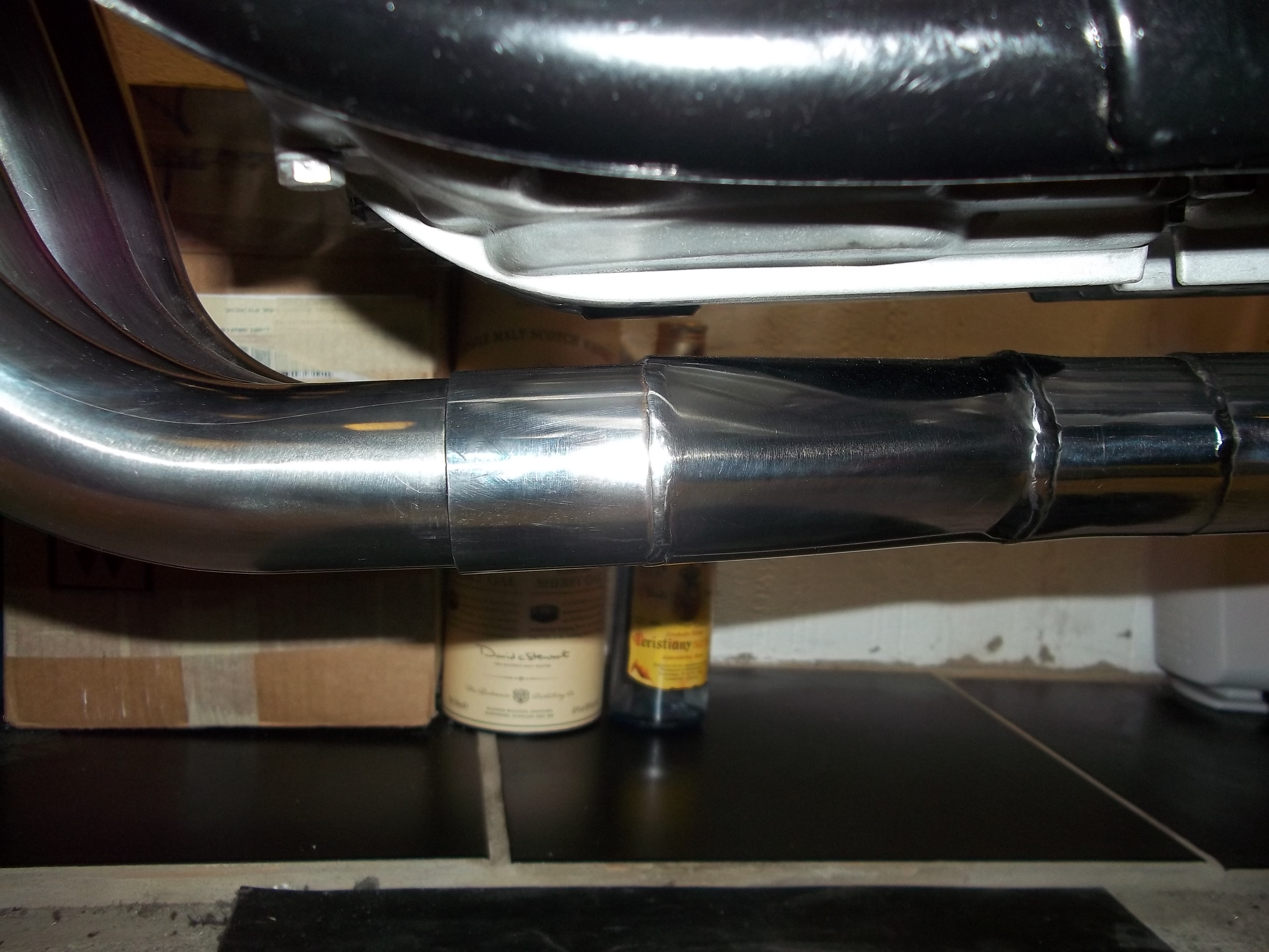

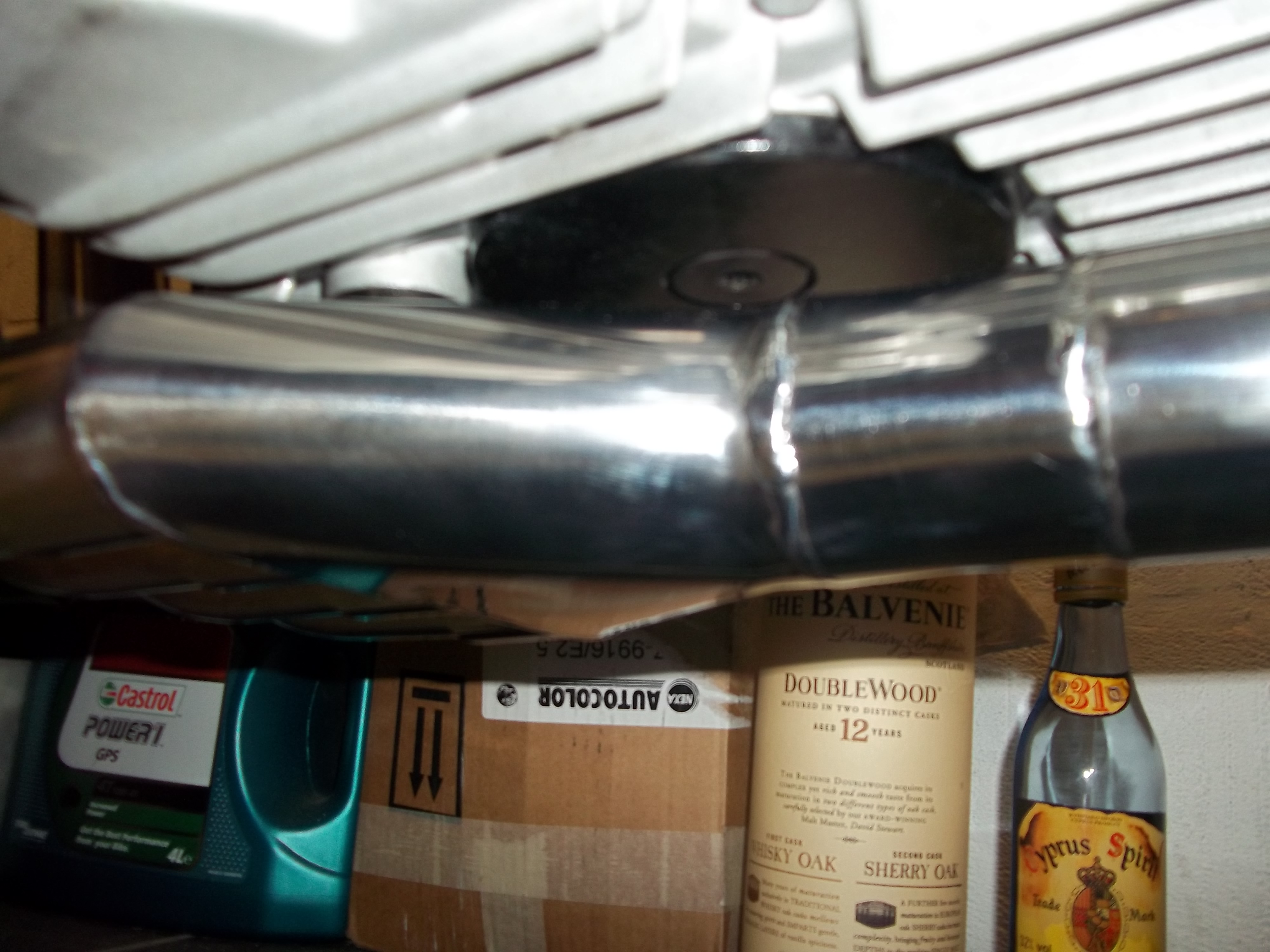

Sump cleaned out and refitted so the Low profile filter cover could go on - the oil pan gate bolt is just visible in the pic (between fins)
With that all tightened i could then put the exhaust back on
My main reason for this was for MORE clearance but i must stress the fact that there WAS adequate clearance already between the filter bolt and the exhaust.
No need to ask about the clearance now - plenty

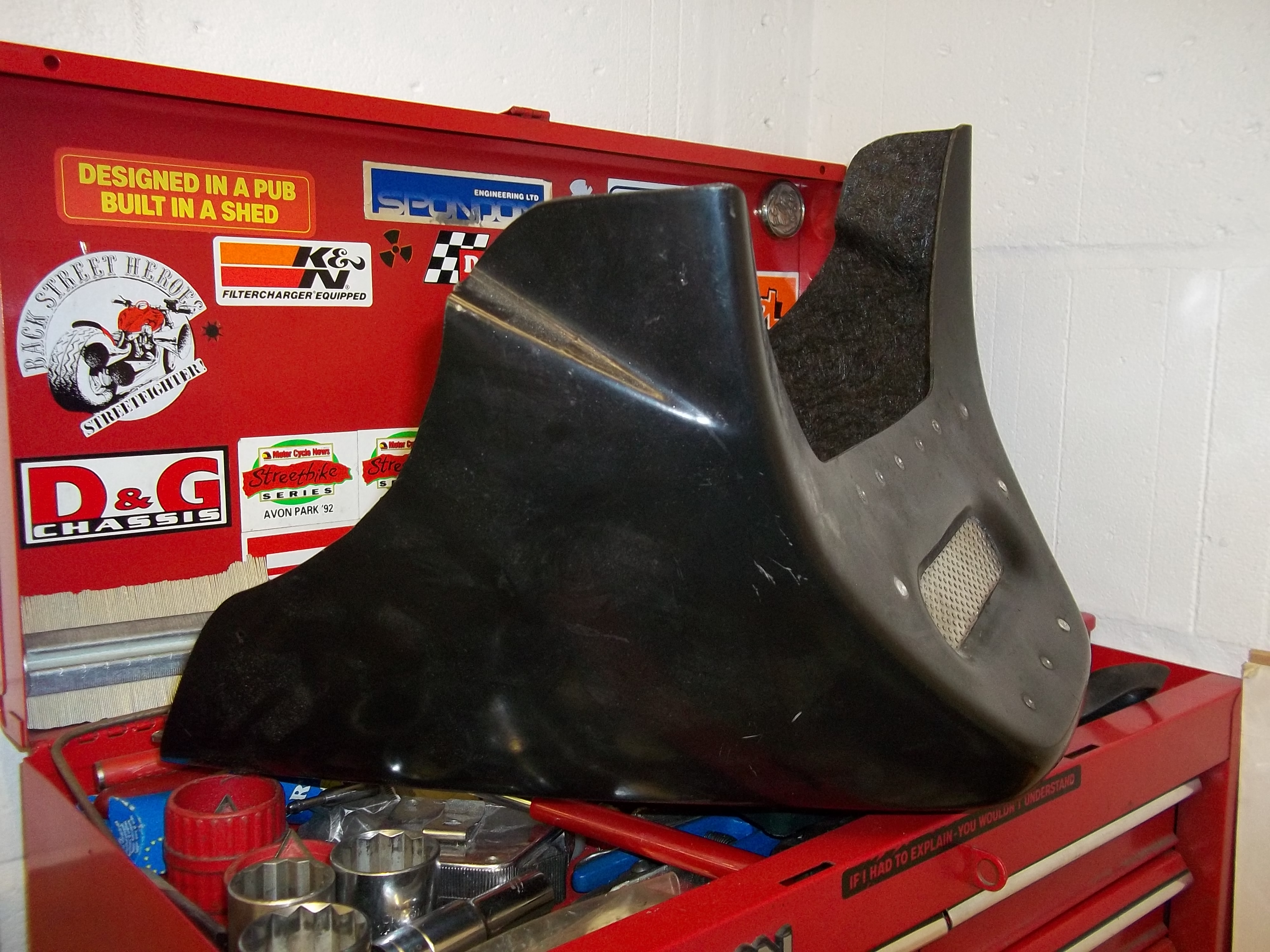

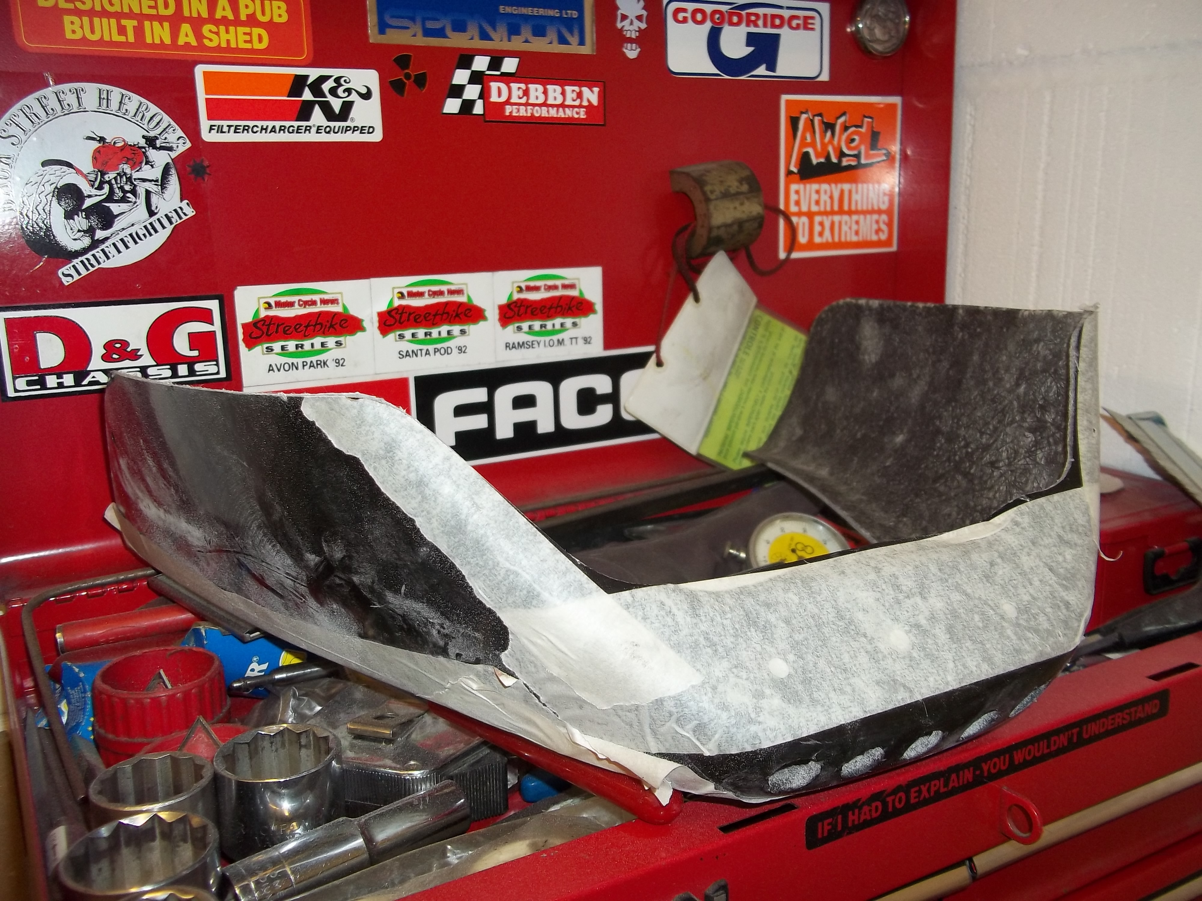

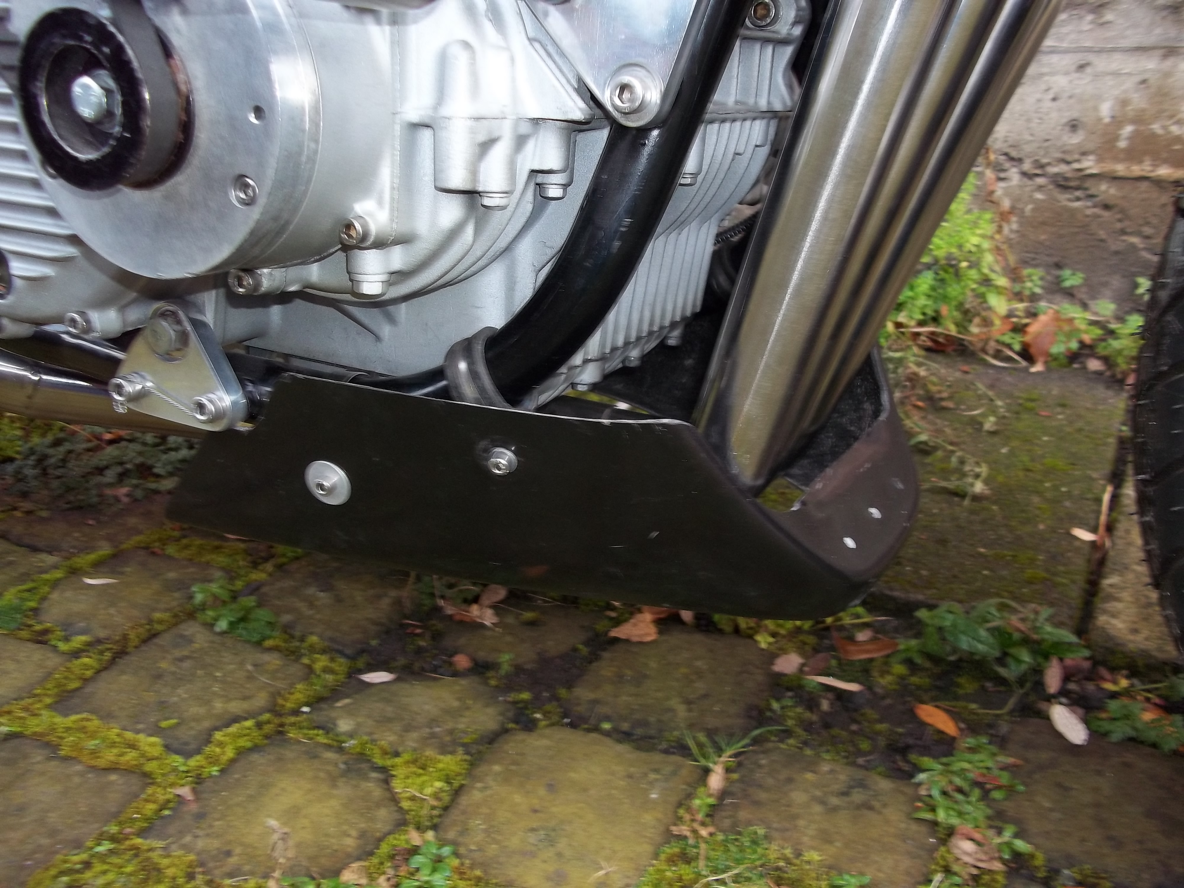

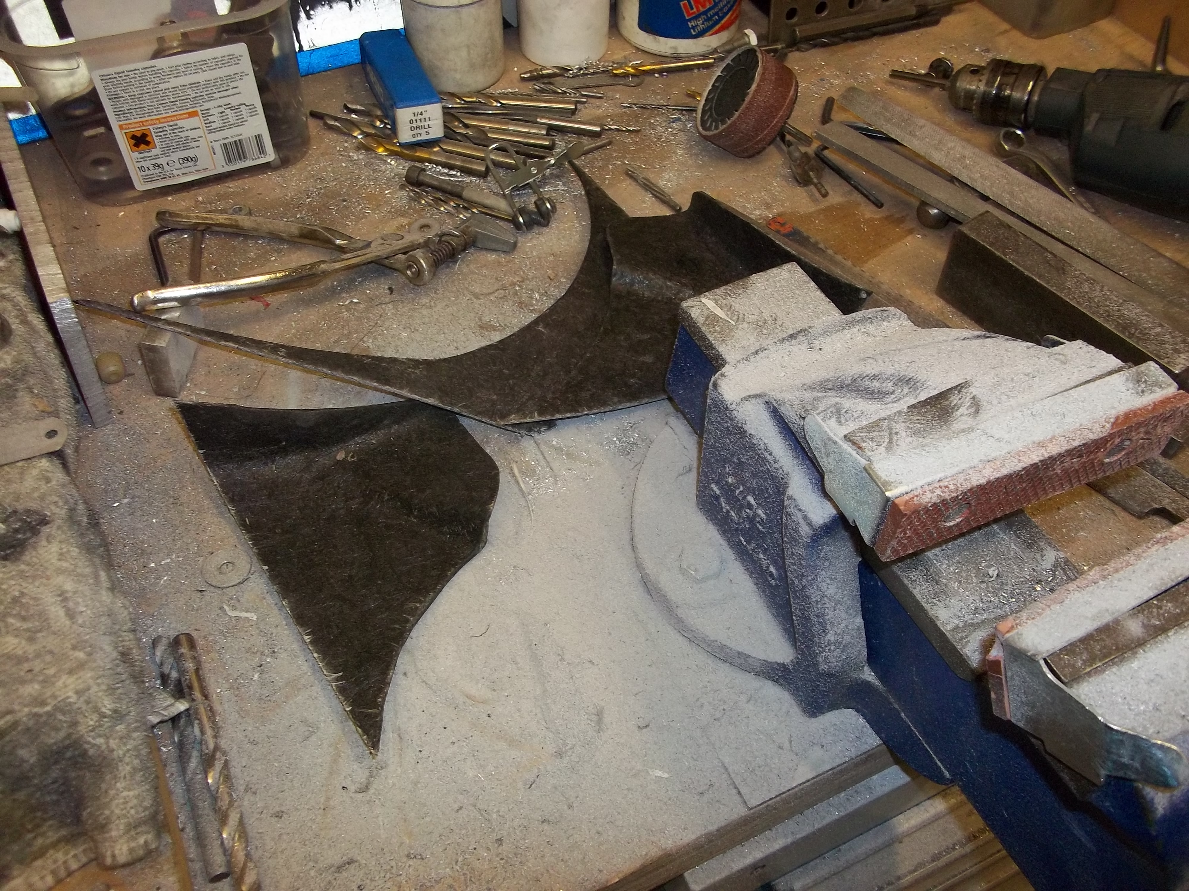

Well, the belly pan got 'the chop', what a mess! Dust mask was a must!
It now looks like this (not finished as some more 'fannying around' to do yet)

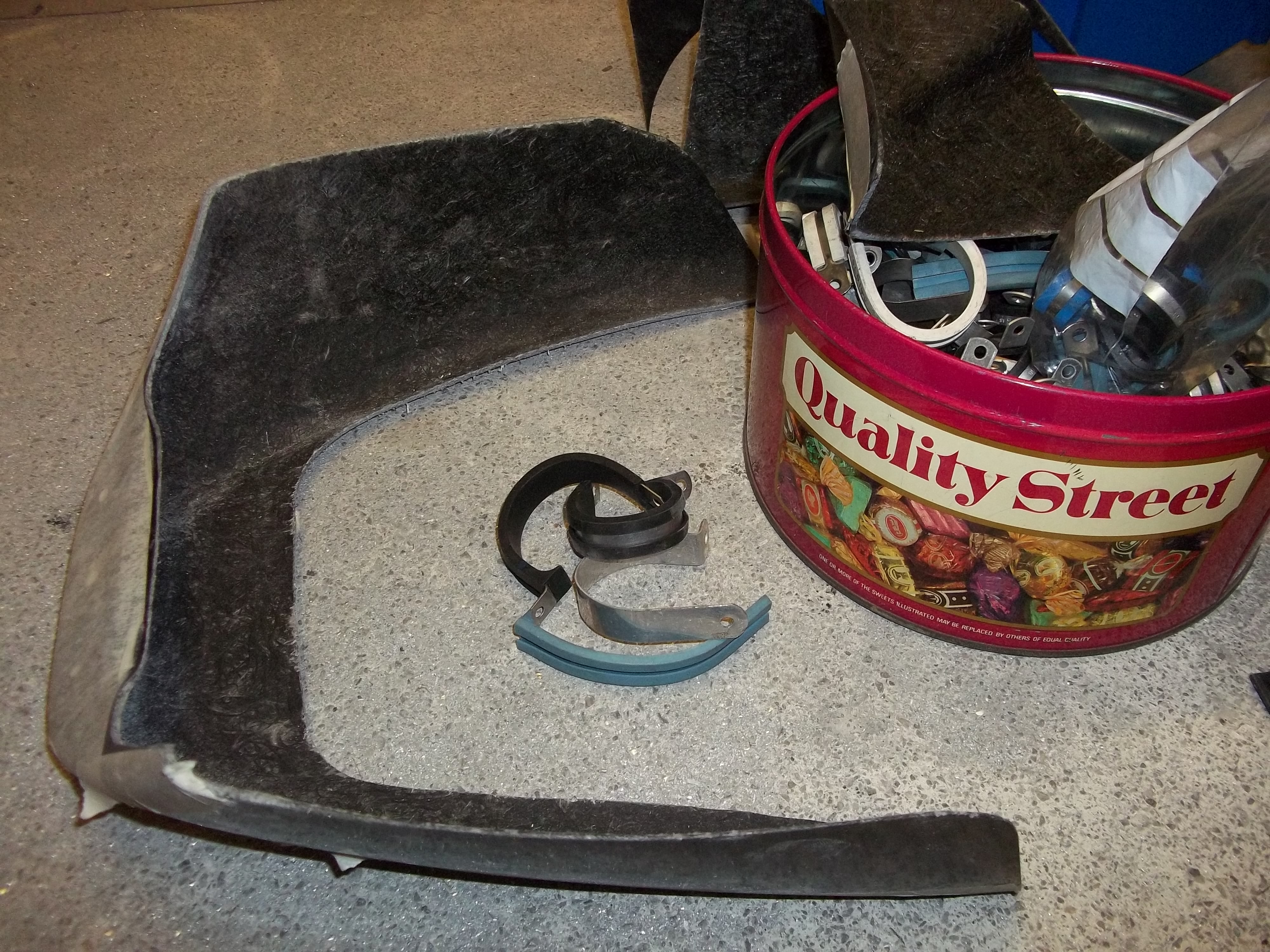

Had look in one of the many tins i squirrel things away in (should mark them up as its either Quality Street tins or Cadburys biscuits
) and found the assortment of 'P' clips. As luck would have it, 2 just the right size - result!

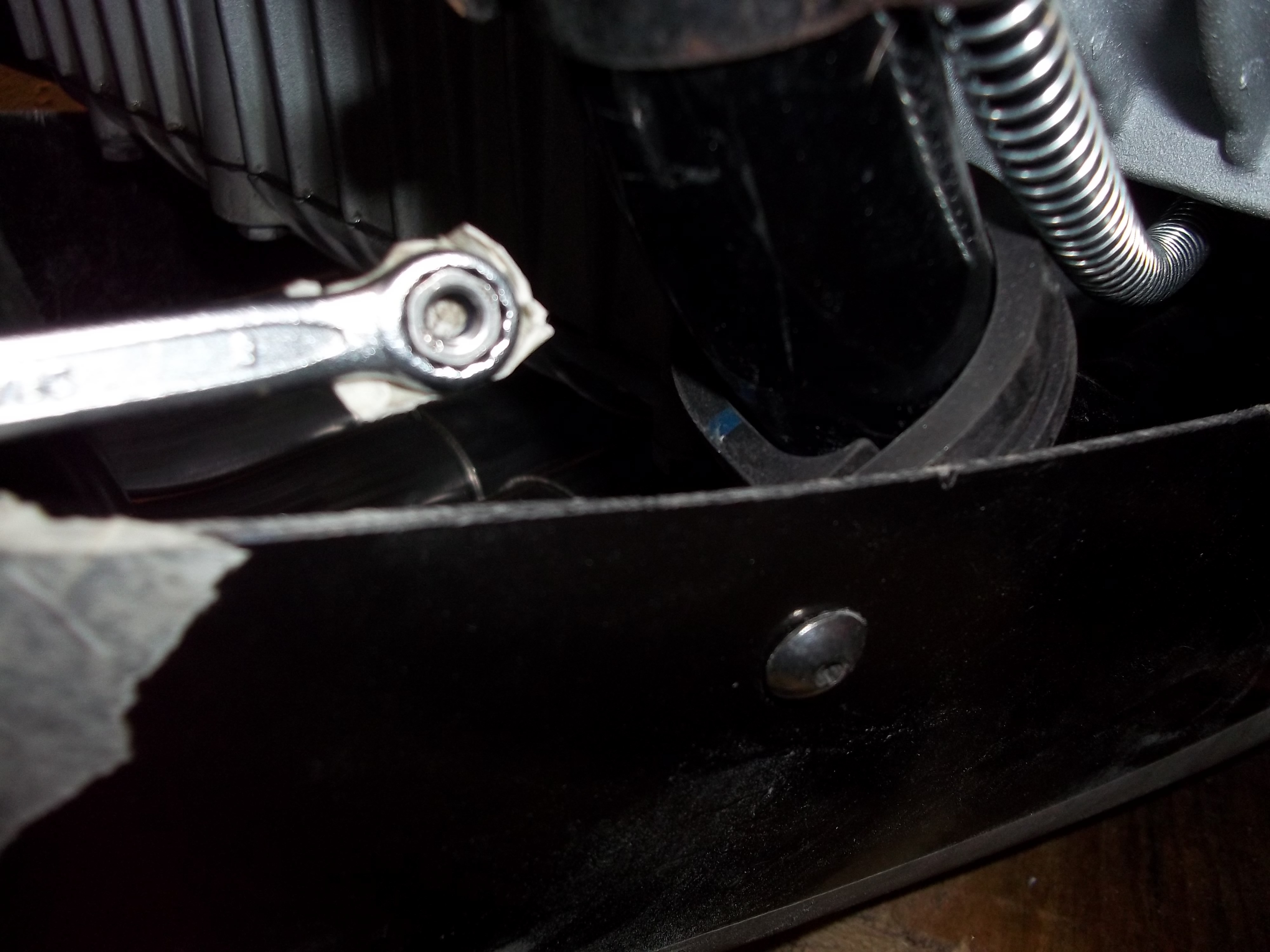

Dont know if this is a usefull 'tip' but the nut on the inside of the belly pan was a little awkward to reach, (if you have fingers like cows tits) masking tape nut on the spanner (or a little in a socket) holds it in place.
Still a little unsure if this is the "look" i want but if it works out i'll make 2 stainless brackets to fix off the engine mounts underneath the cradle, then use some 3M carbon look all over and fix the 900 DOHC badges along the bottom.
Needs to be straightened up along the frame rails yet but its coming along
This pic is to show that the belly pan still gives the max clearance underneath (well hopefully
I'll keep on chopping / butchering / tinkering / filling and drilling and see what i end up with .......
No doubt the BIN awaits .......
Ah well

...interested by the 'pin pliers' in the top picture. Are you ex-aircraft? We used them at BAe with skin pins when I did my apprenticeship - I still have a pair - I think they must have given them to me
along with a few bags of skin pins. I don't use them often, but they're invaluable when you need them

vduk - yep, ex-aircraft, the pin pliers (sometimes called Clecos) are only used in me shed these days, but come in very handy when pinning up or clamping

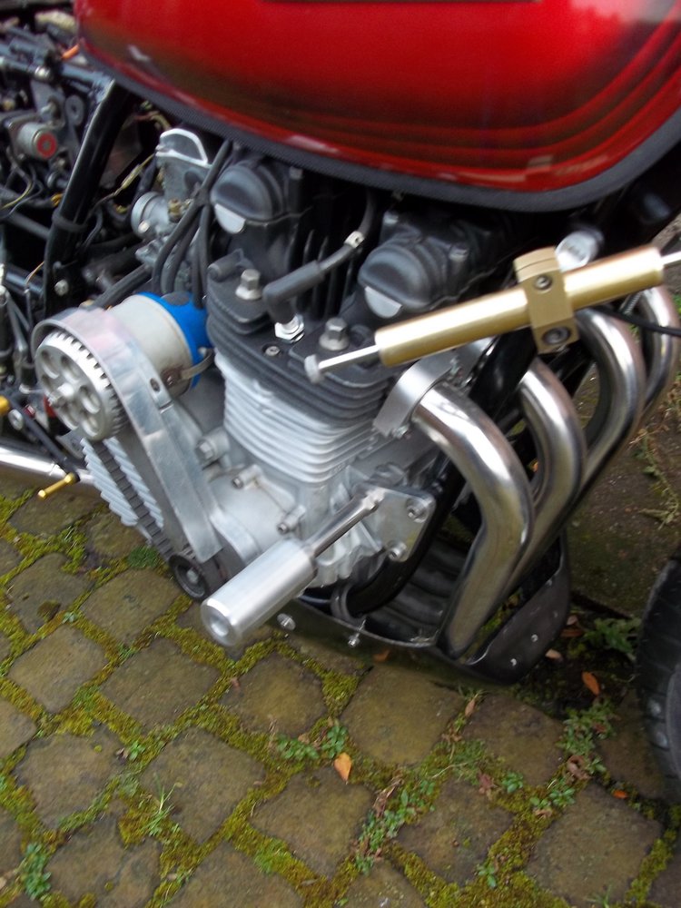

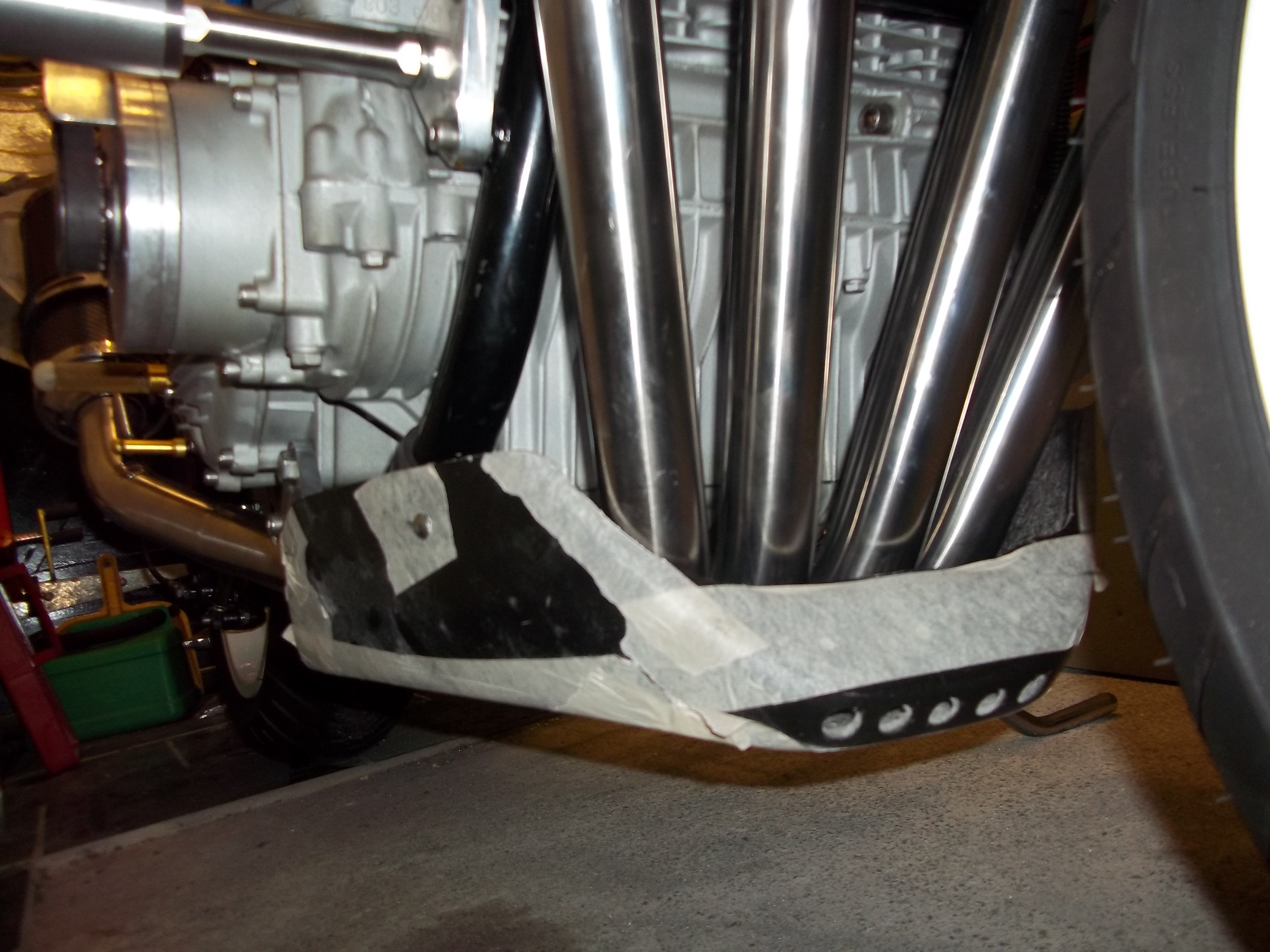

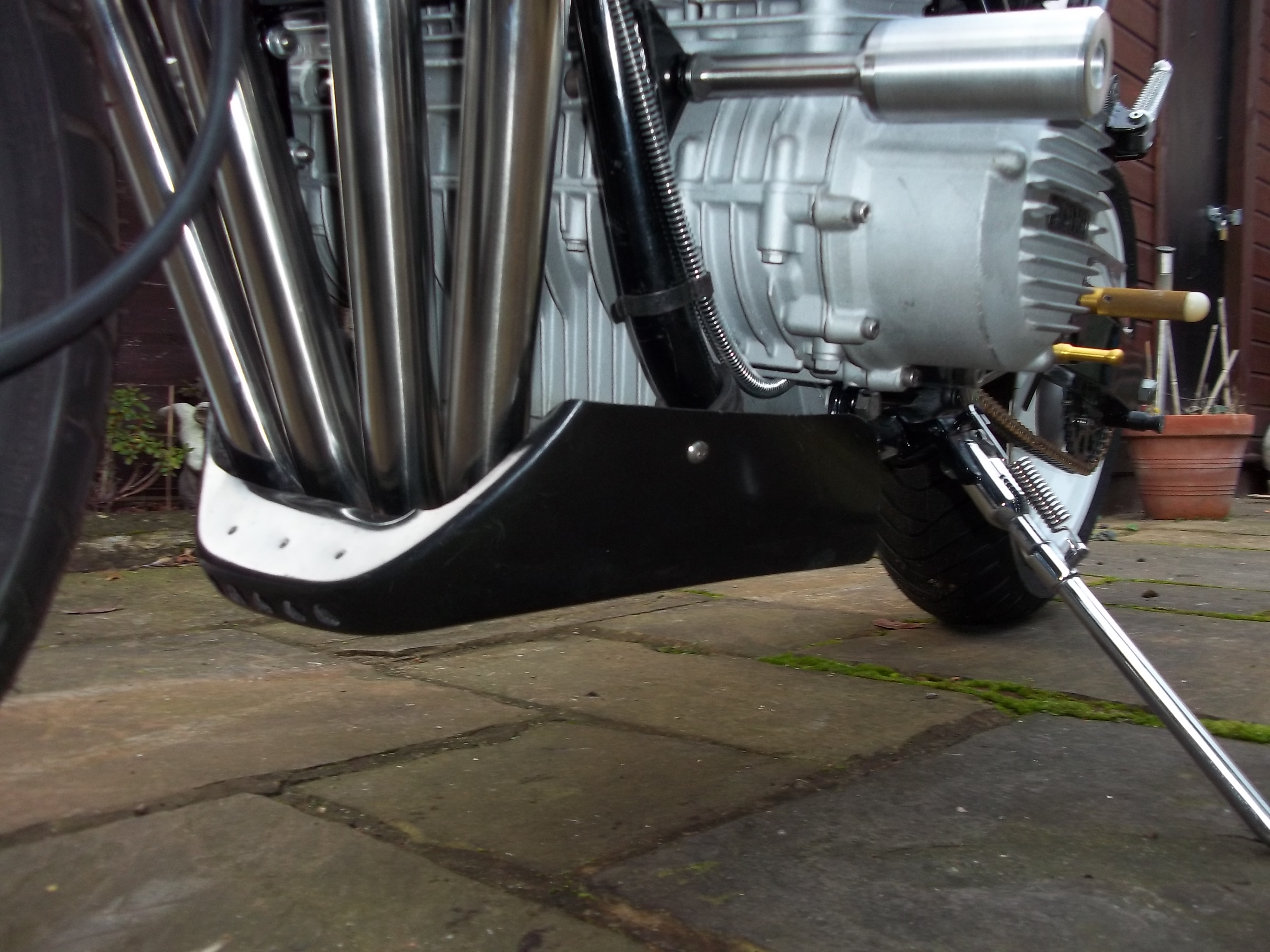

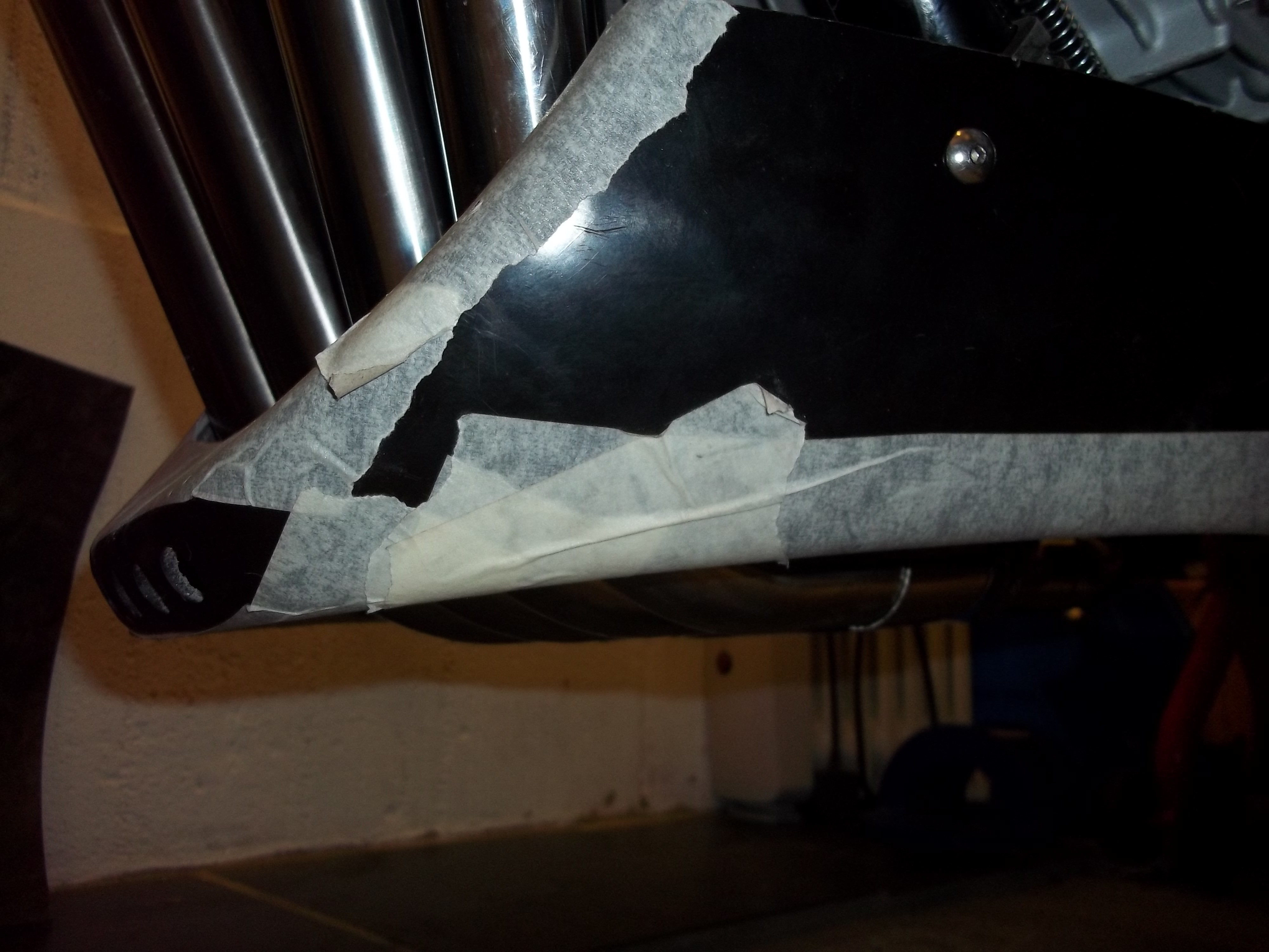

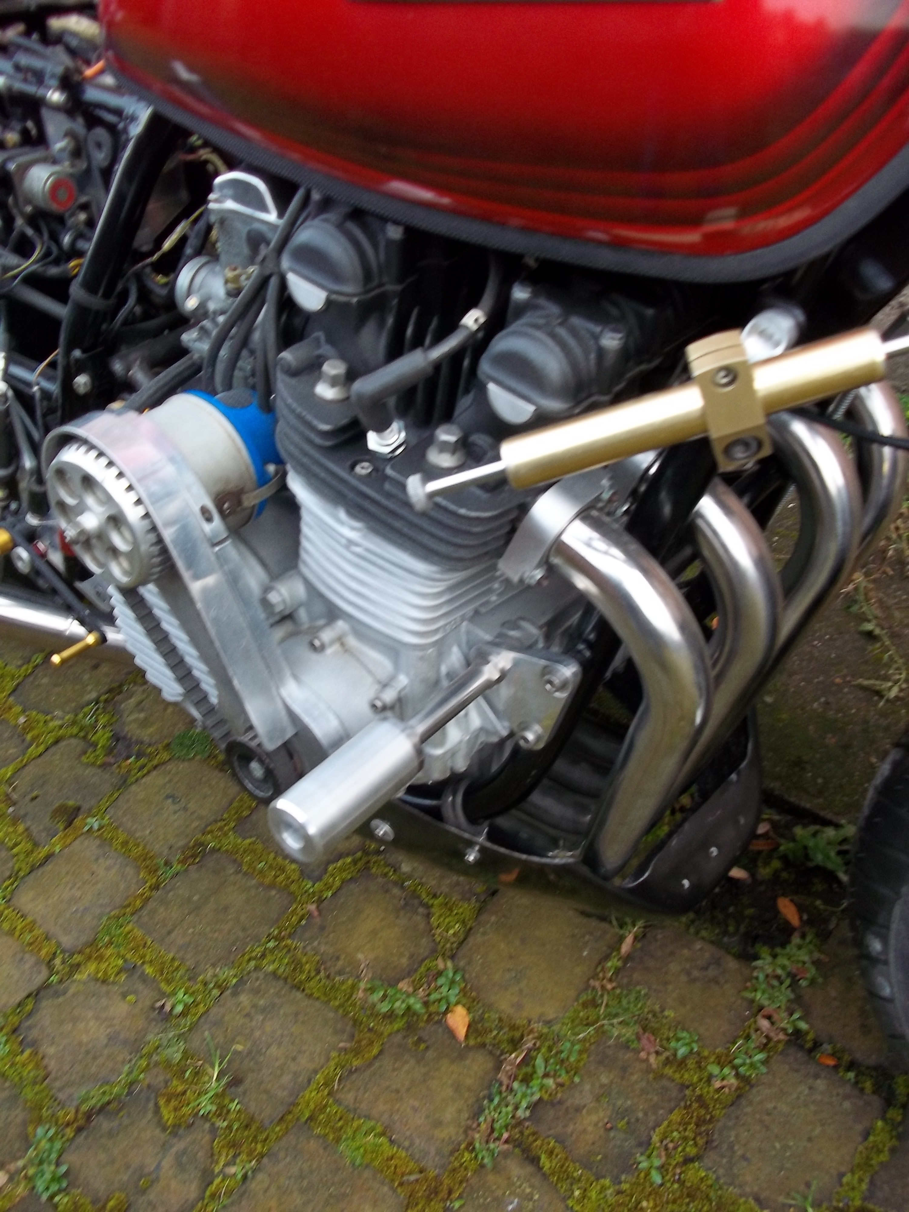

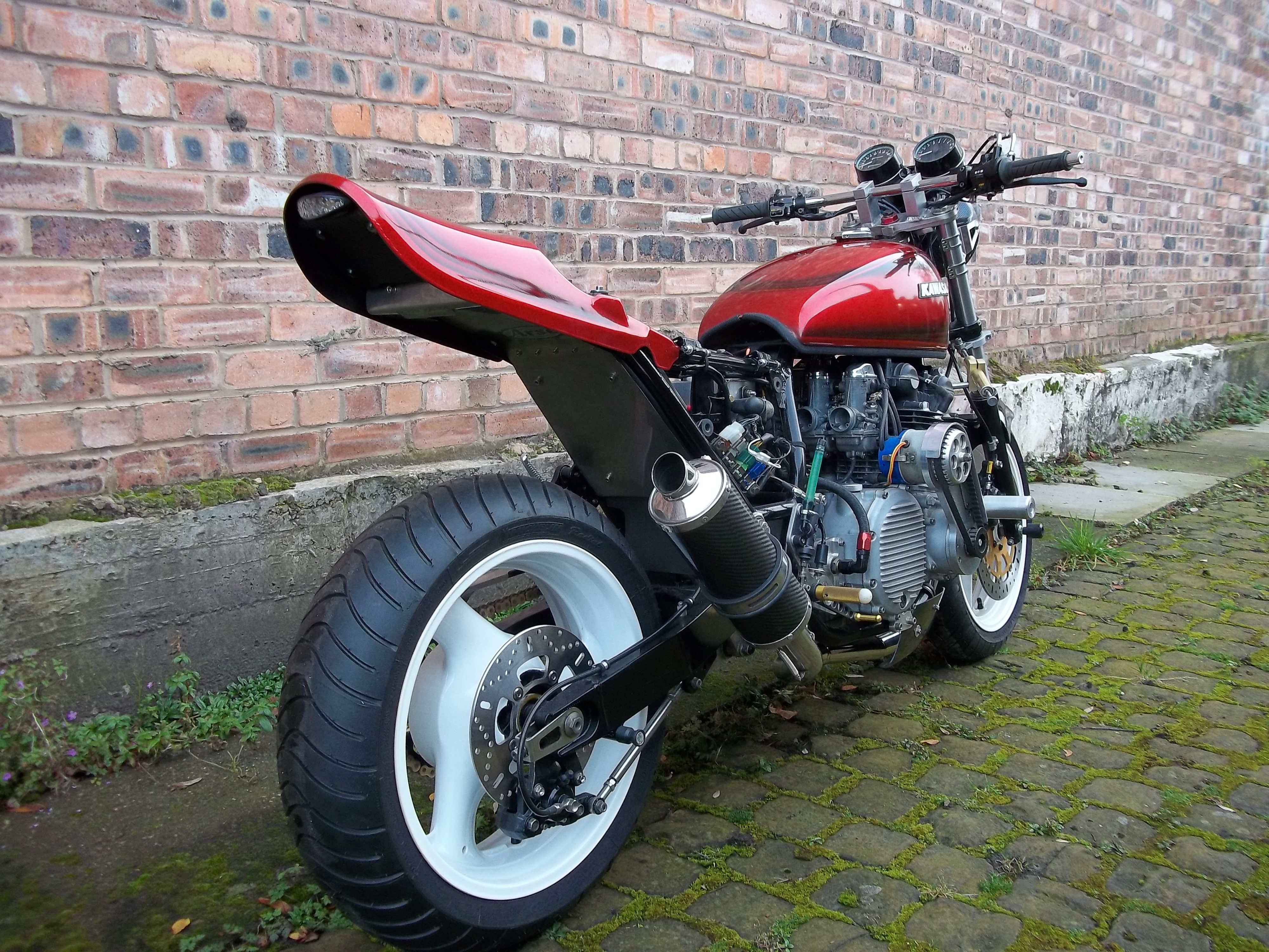

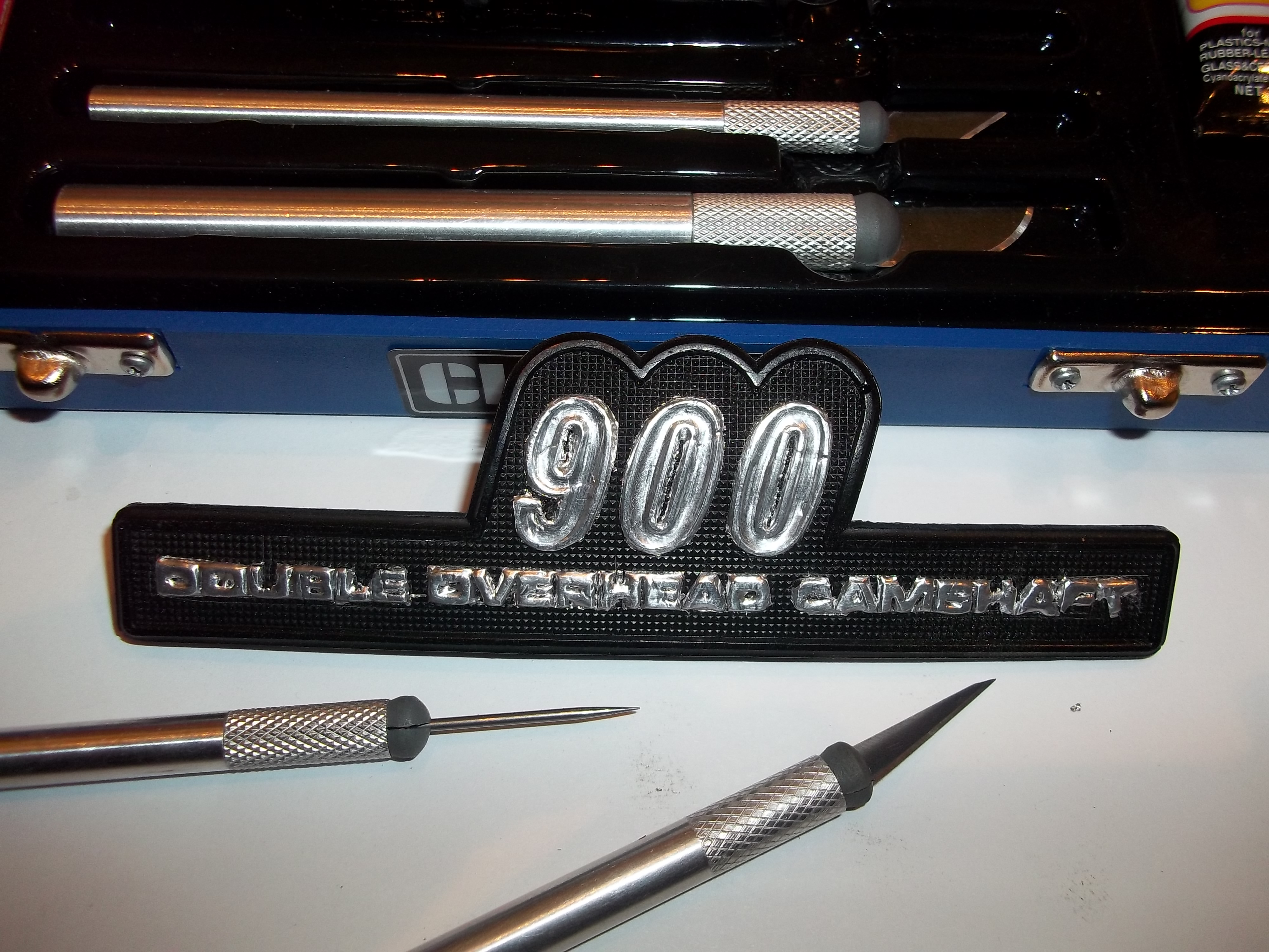

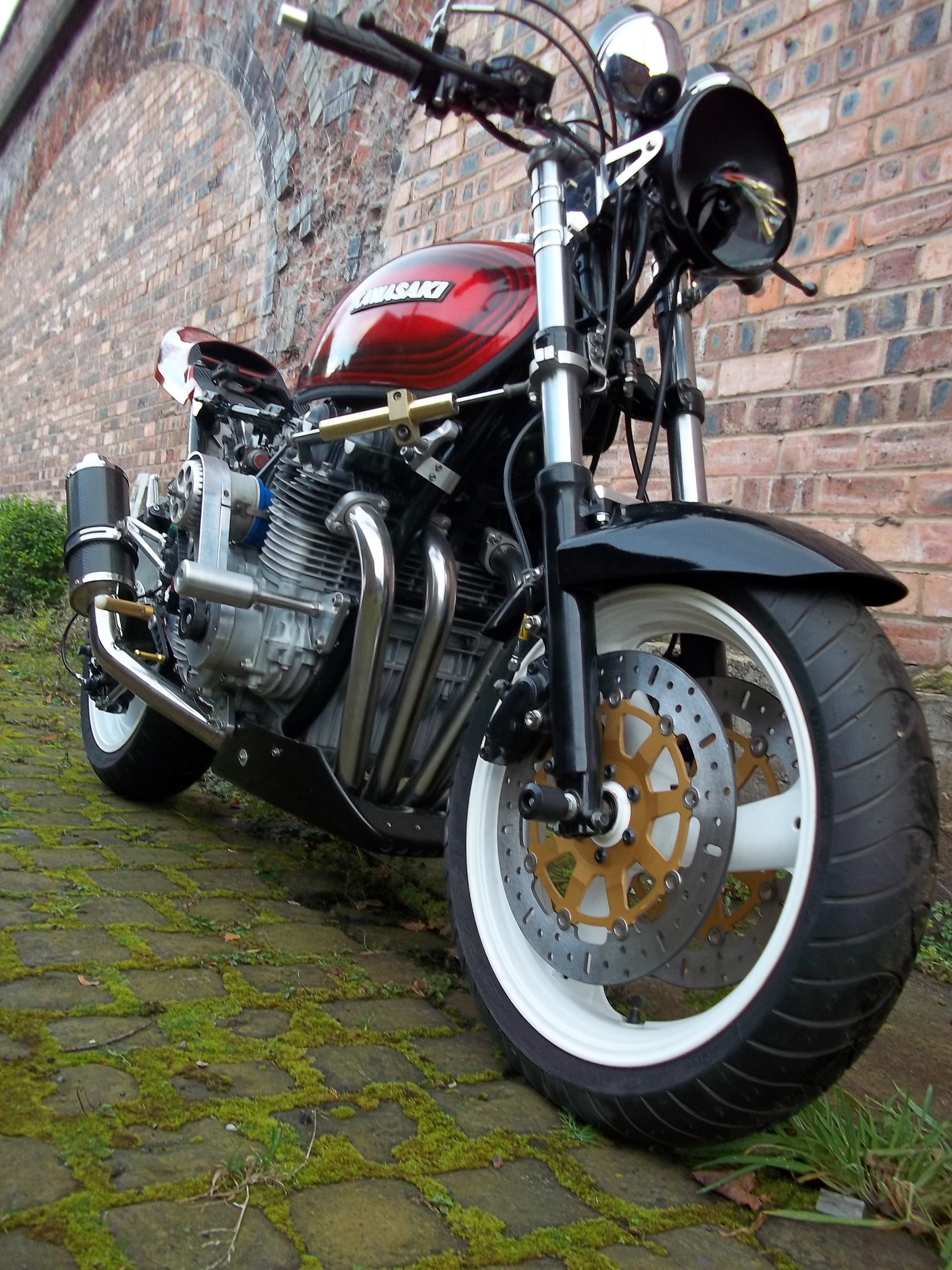

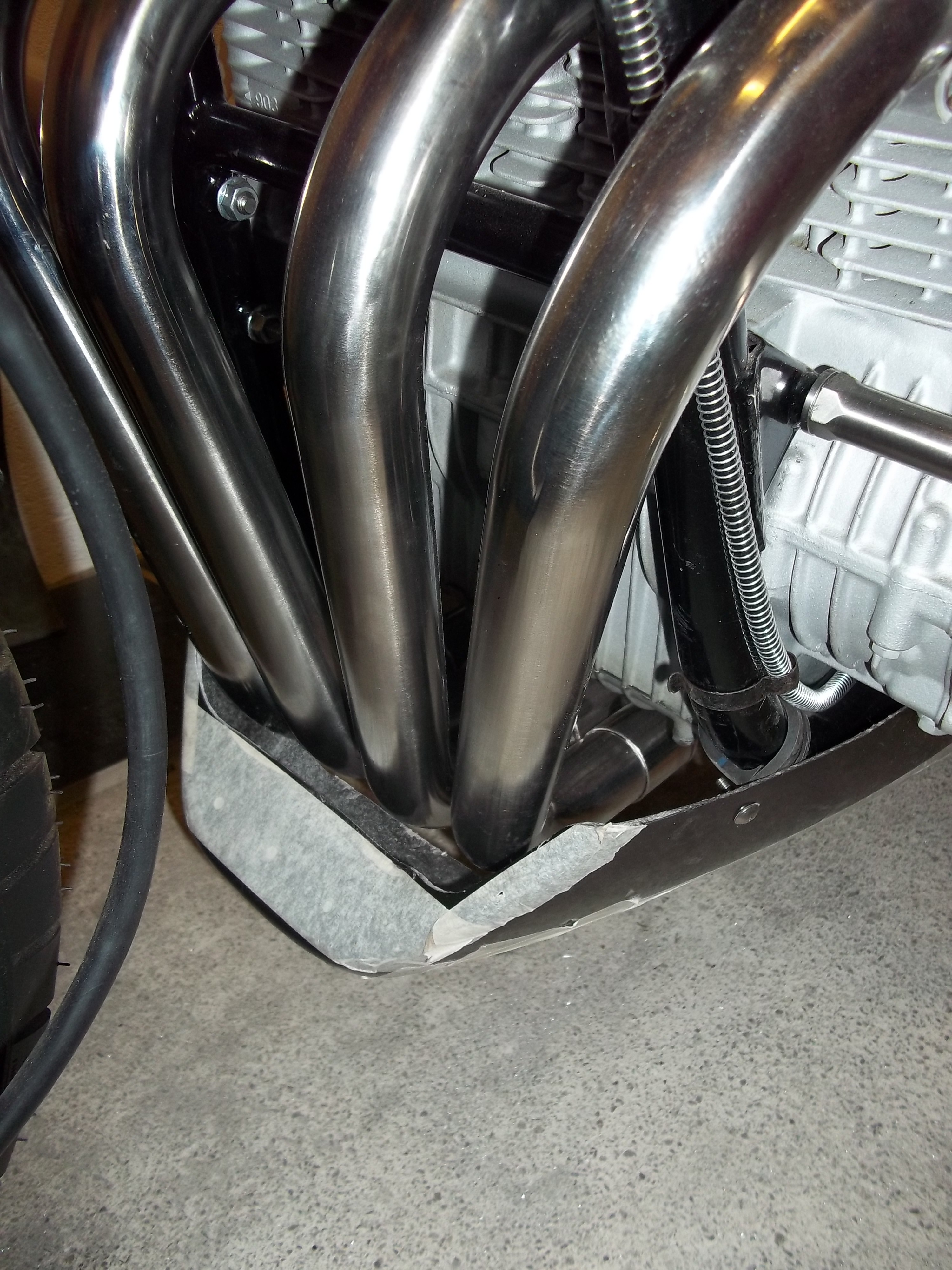

Well ive cut the pan about a little more - not finished yet as i'll add the 900 badges to the sides, clean it all up and think i'll bond a little offcut of titanium in the lower part. Also the fasteners will probably be changed for black alloy.
So having sacrificed some 'wank time' to get meself in the shed thought i'd dust the mongrel down (thats not a euphemism) and see how its looking.

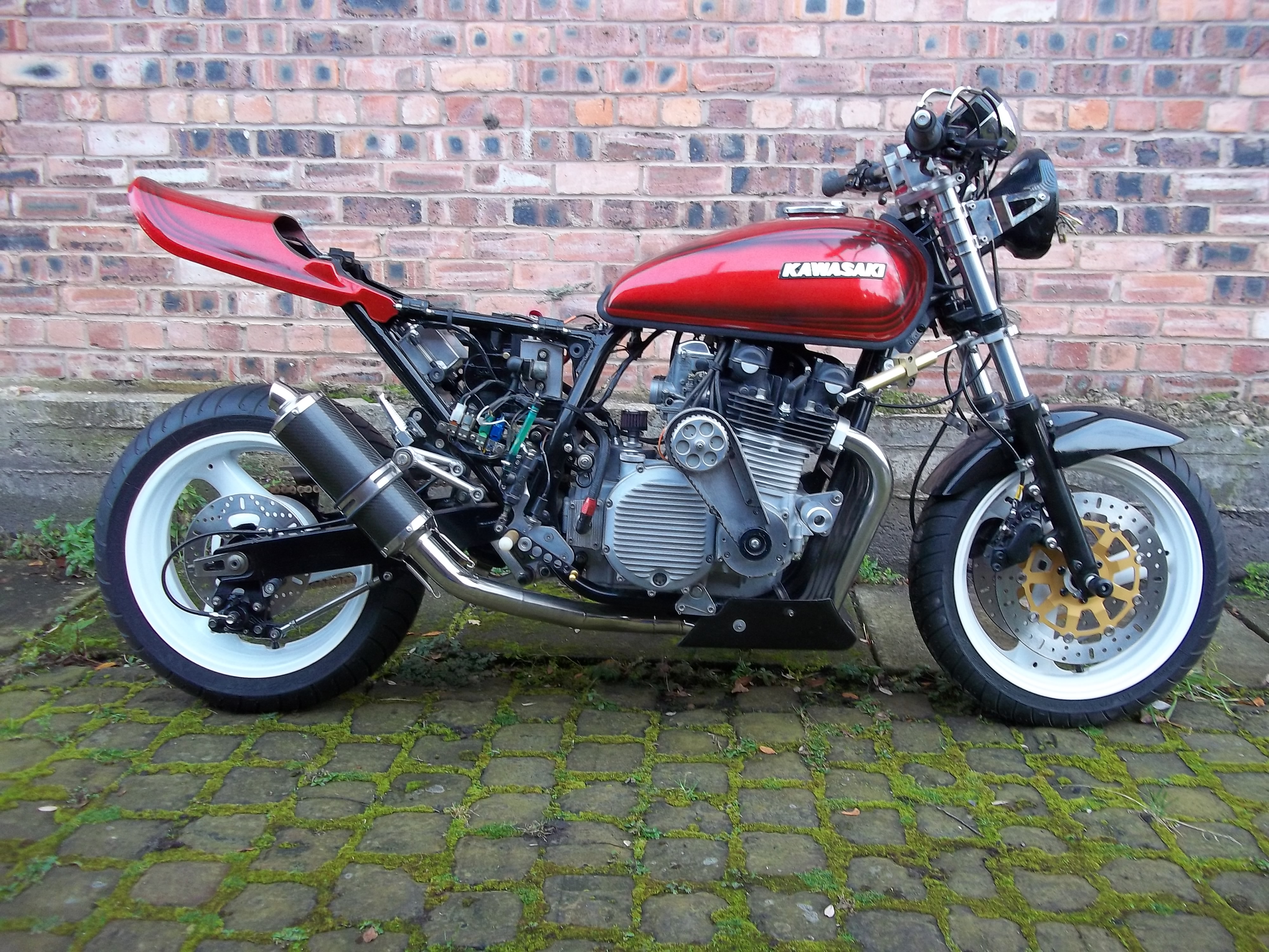

So the debate i have in my head now is "to belly pan or not?"
As the song says "How do you like me now"

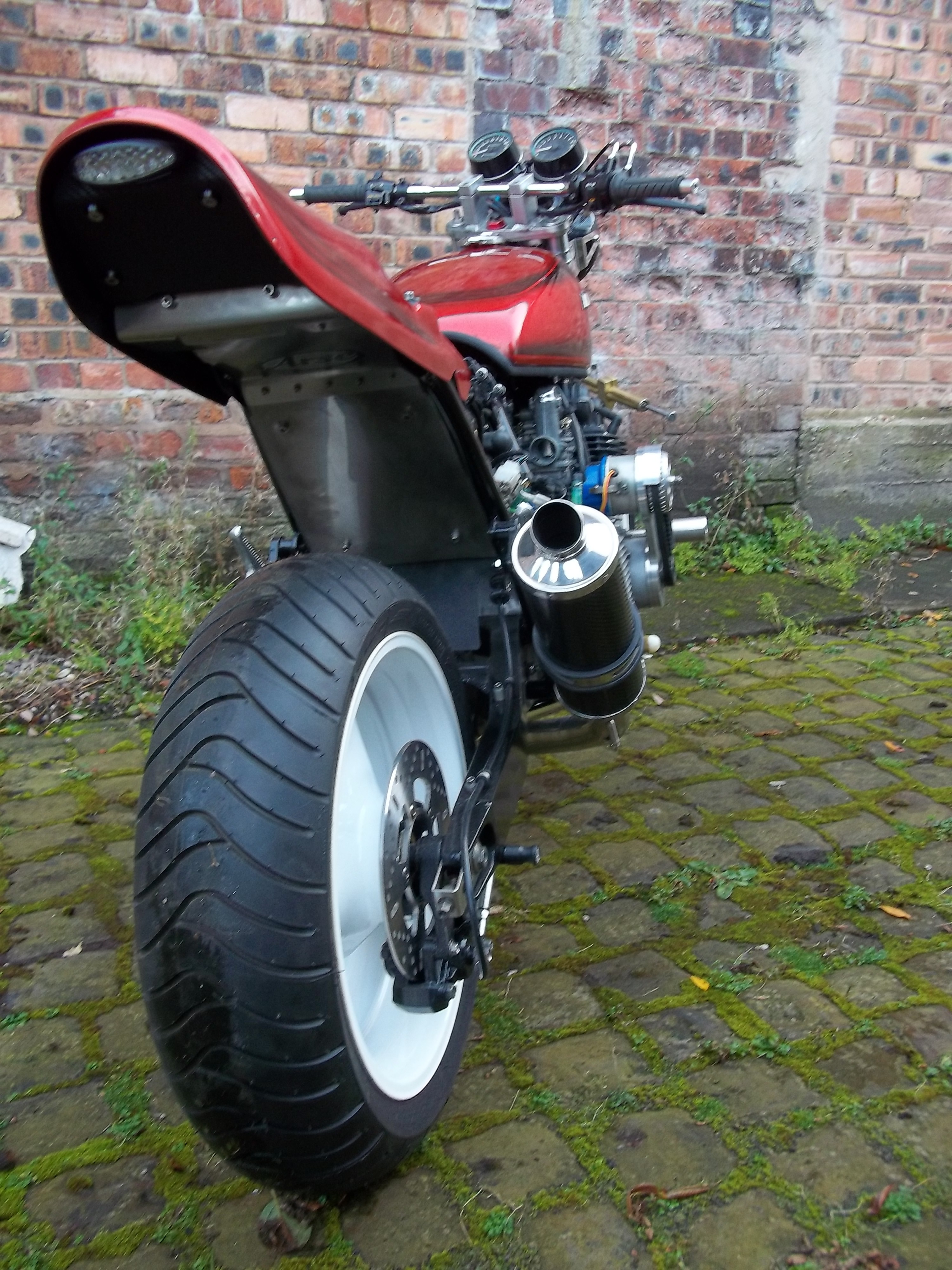

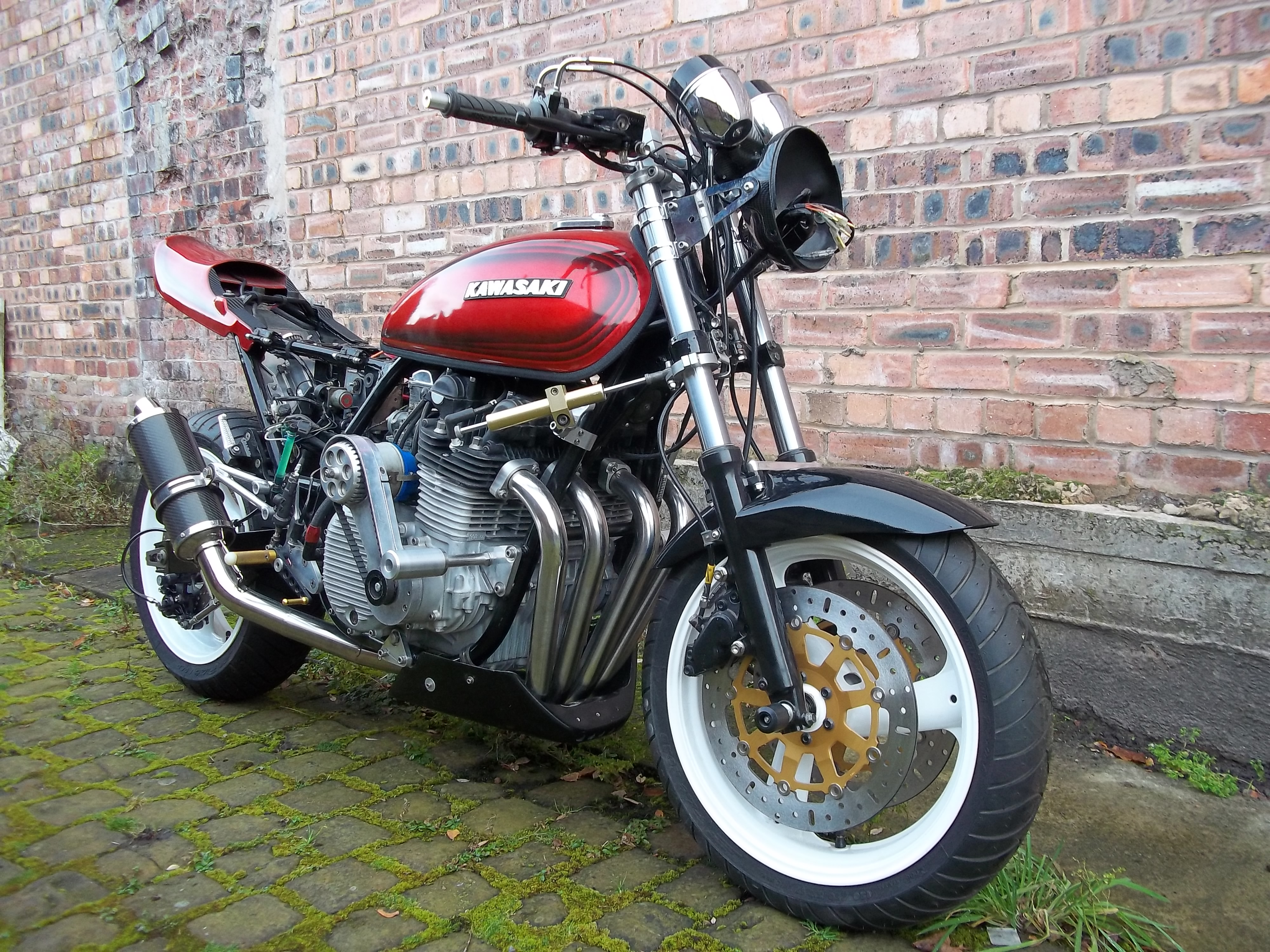

Thats the close up pics, guess a 'side shot' shows more so for those that asked (and for my own head debate
Still a few odds an ends to make - bracket for block connecters are one (been on the list a while that one
I'll keep chipping away tho'
)....Still a few odds an ends to make - bracket for block connecters are one (been on the list a while that one
