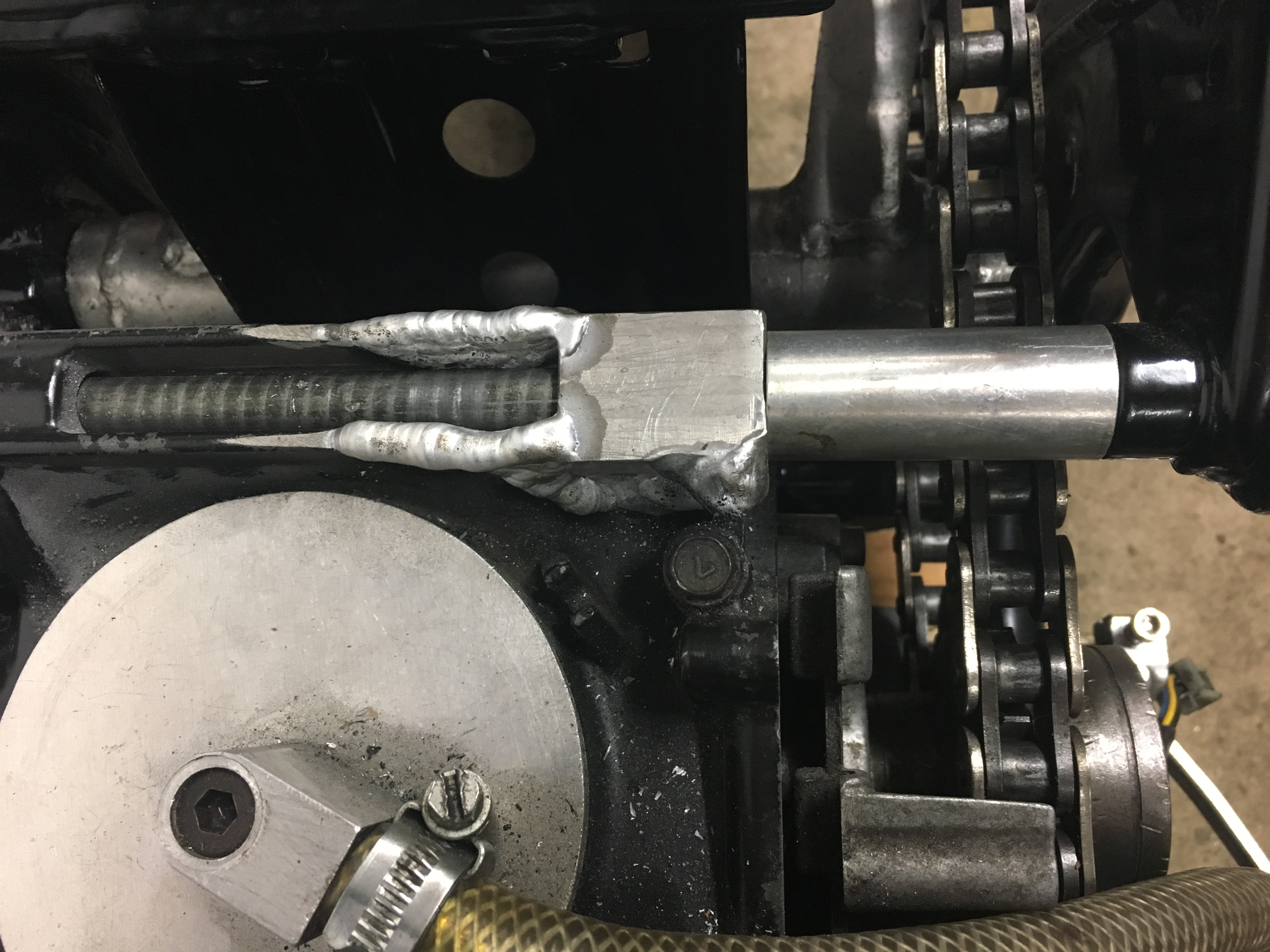

A talented friend of mine repaired the cases with a strong and functional welded in box section. Its not pretty but its a drag bike and it will hold. So thanks go to Andy.

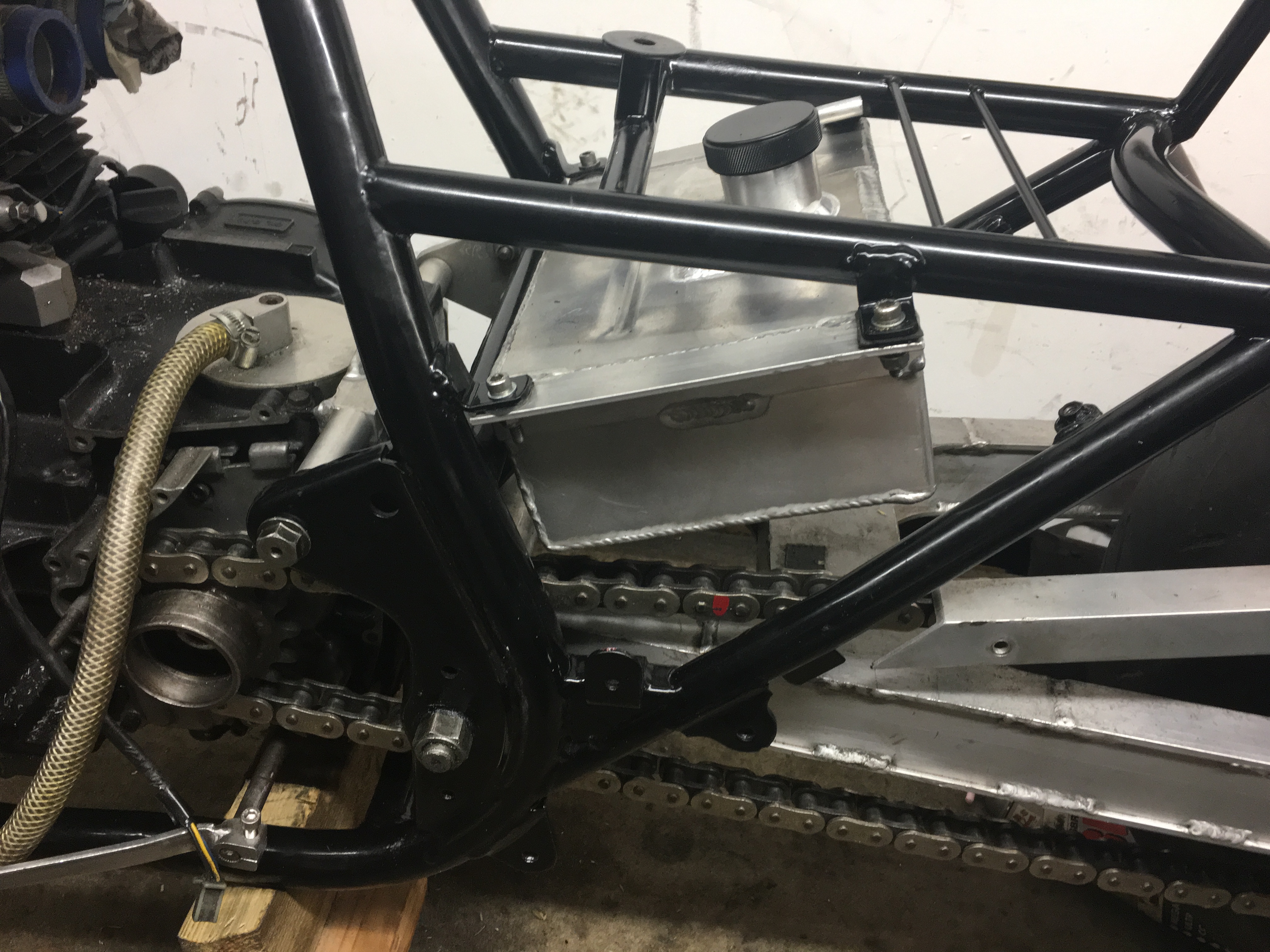

I then started the rebuild,

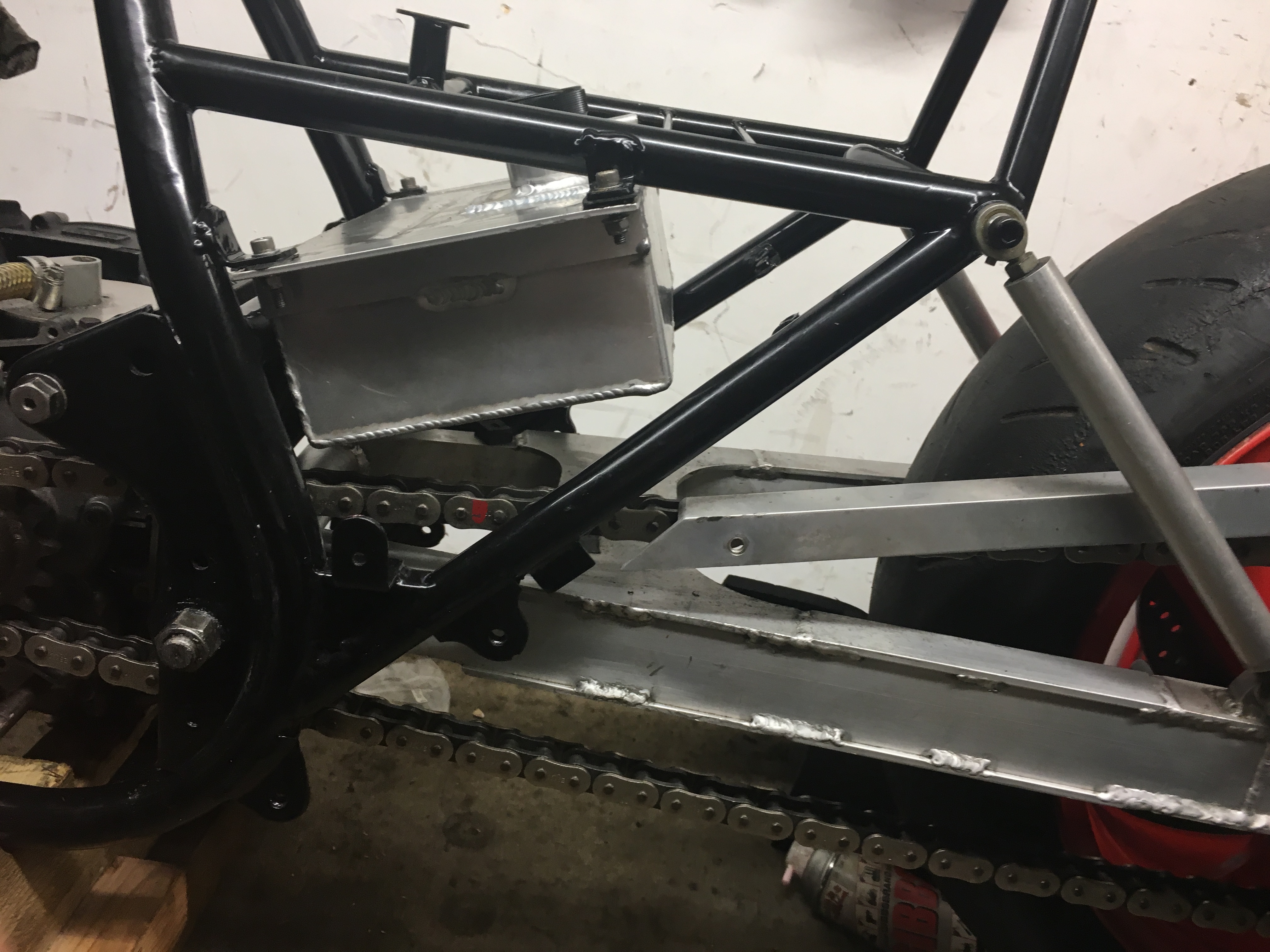

Fitted my custom made alloy fuel tank.

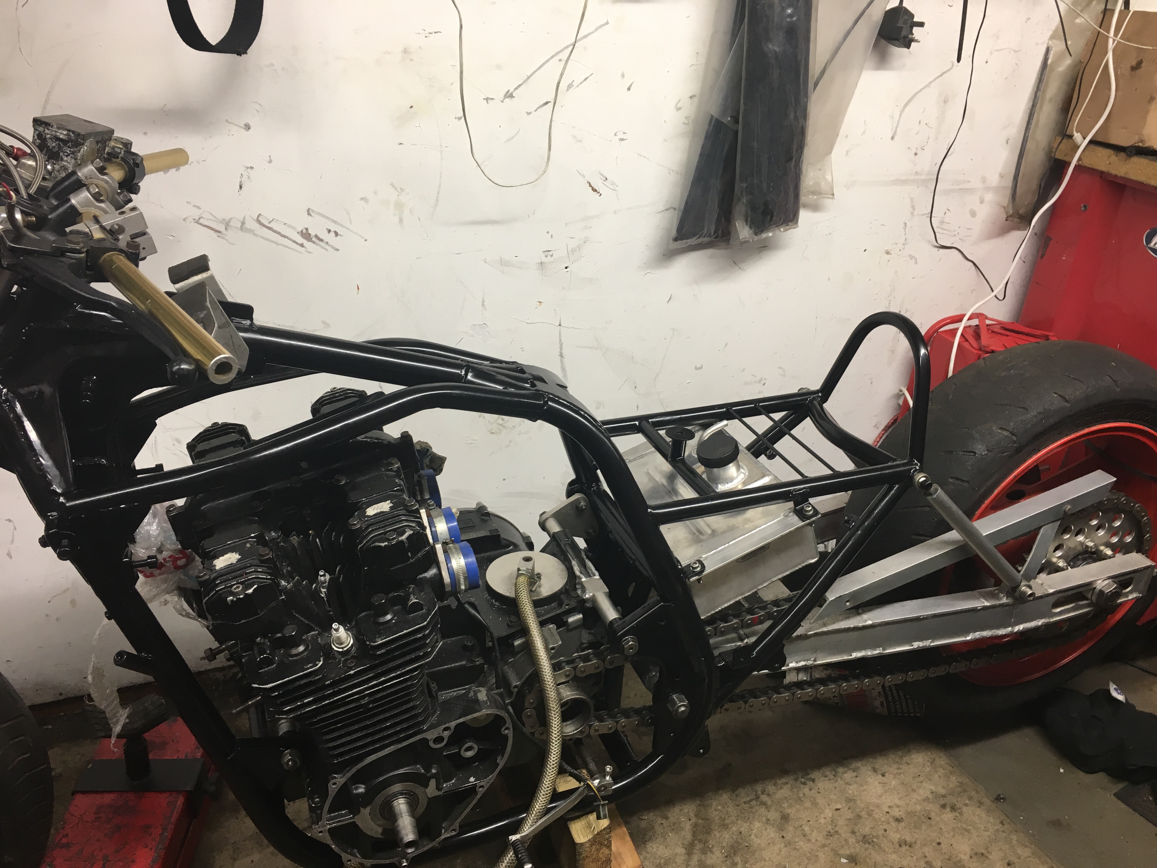

And rebuilt the chassis,

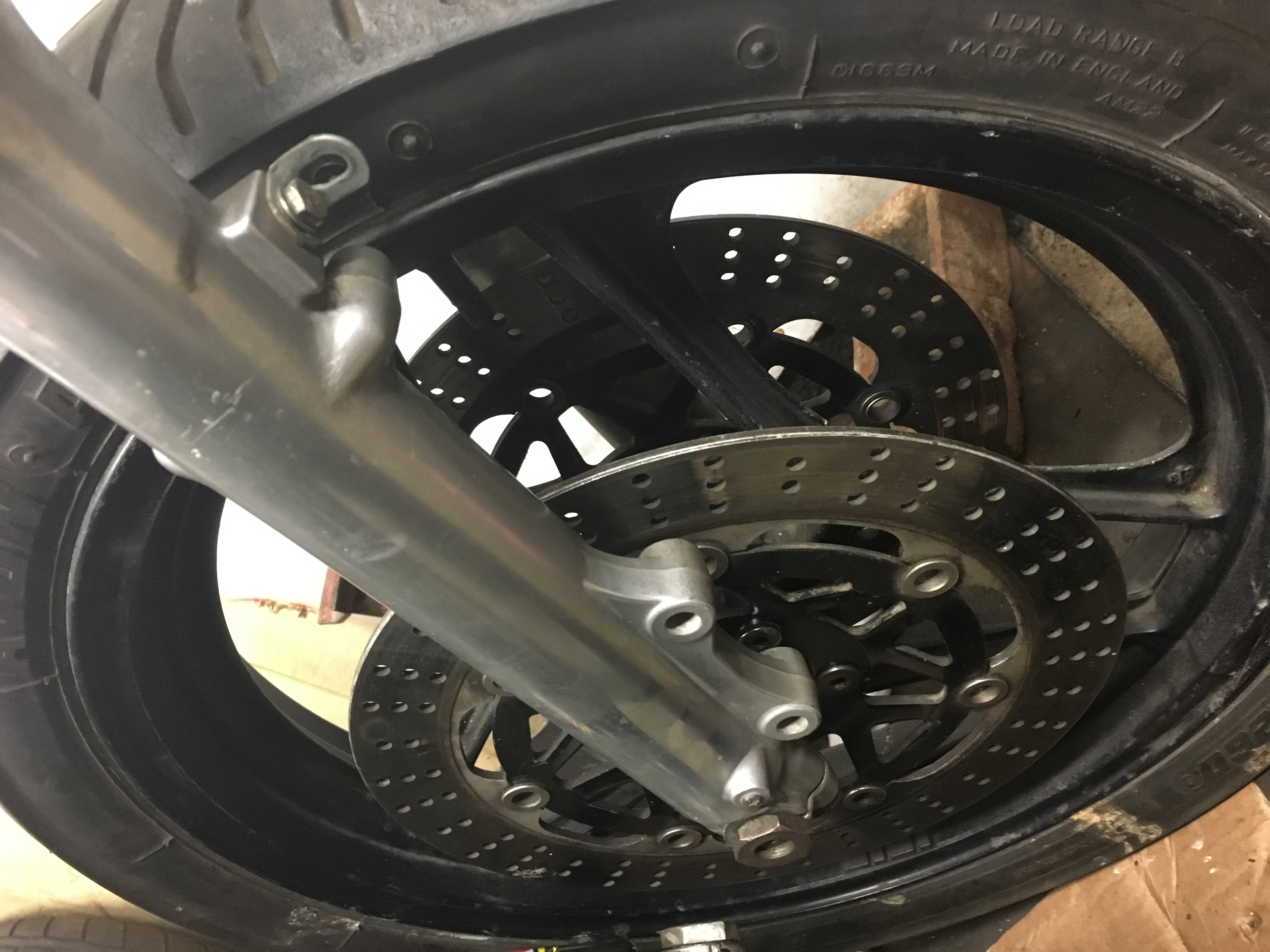

I have replaced the dodgy yamaha front wheel and brake setup with a 18" slabby wheel as they are light weight for old skool wheels and I am using 300mm ZX6R discs.
Brembo single pot calipers will be fitted once I have scrounged them off a friend. :blush
