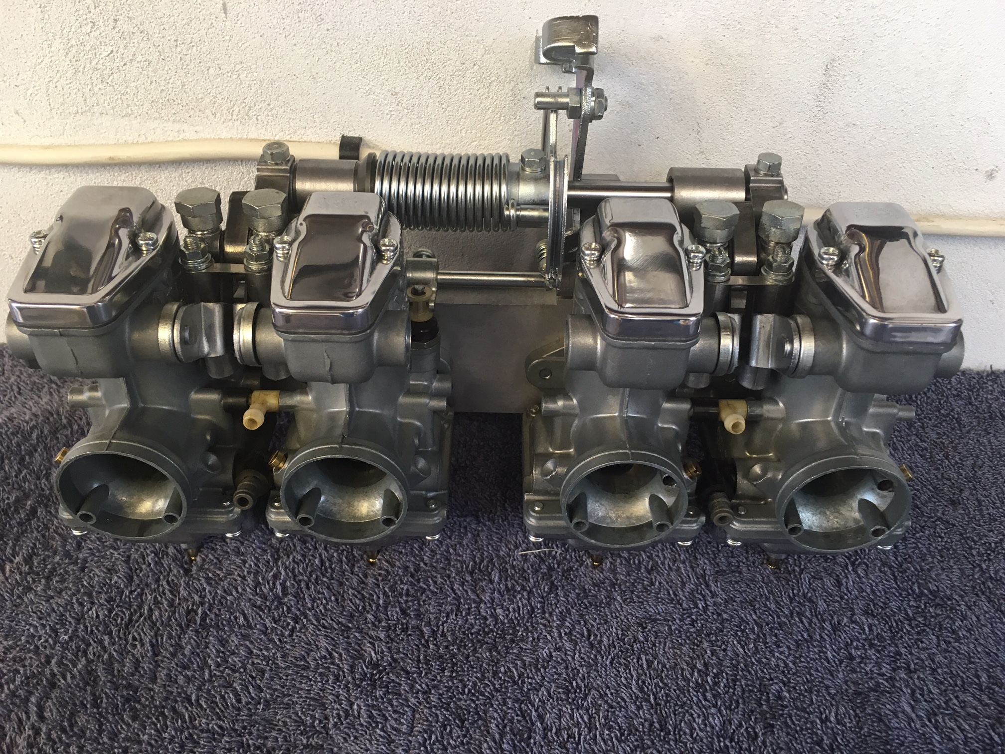

DaveZ1, Great job on the Carbs.

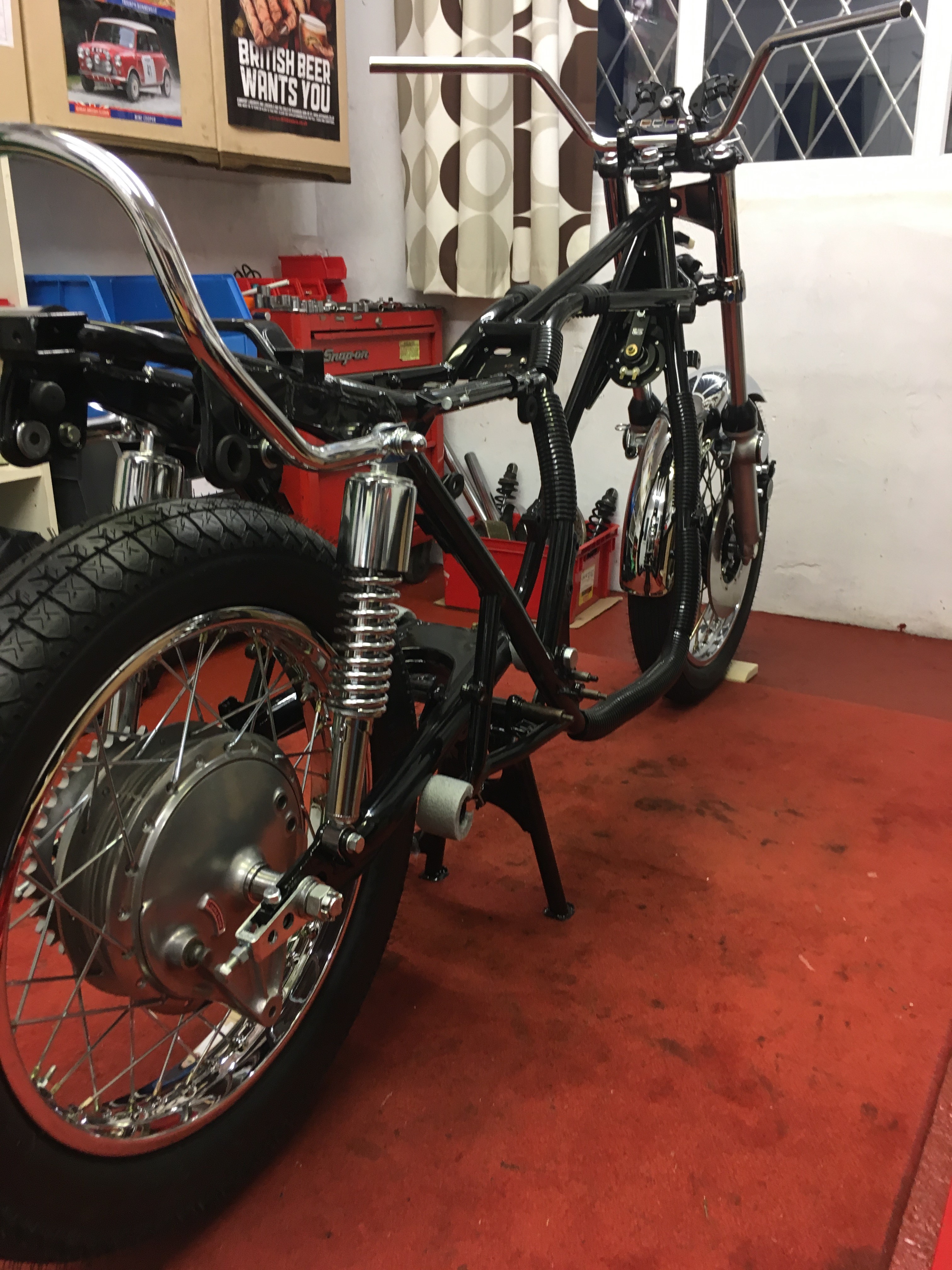

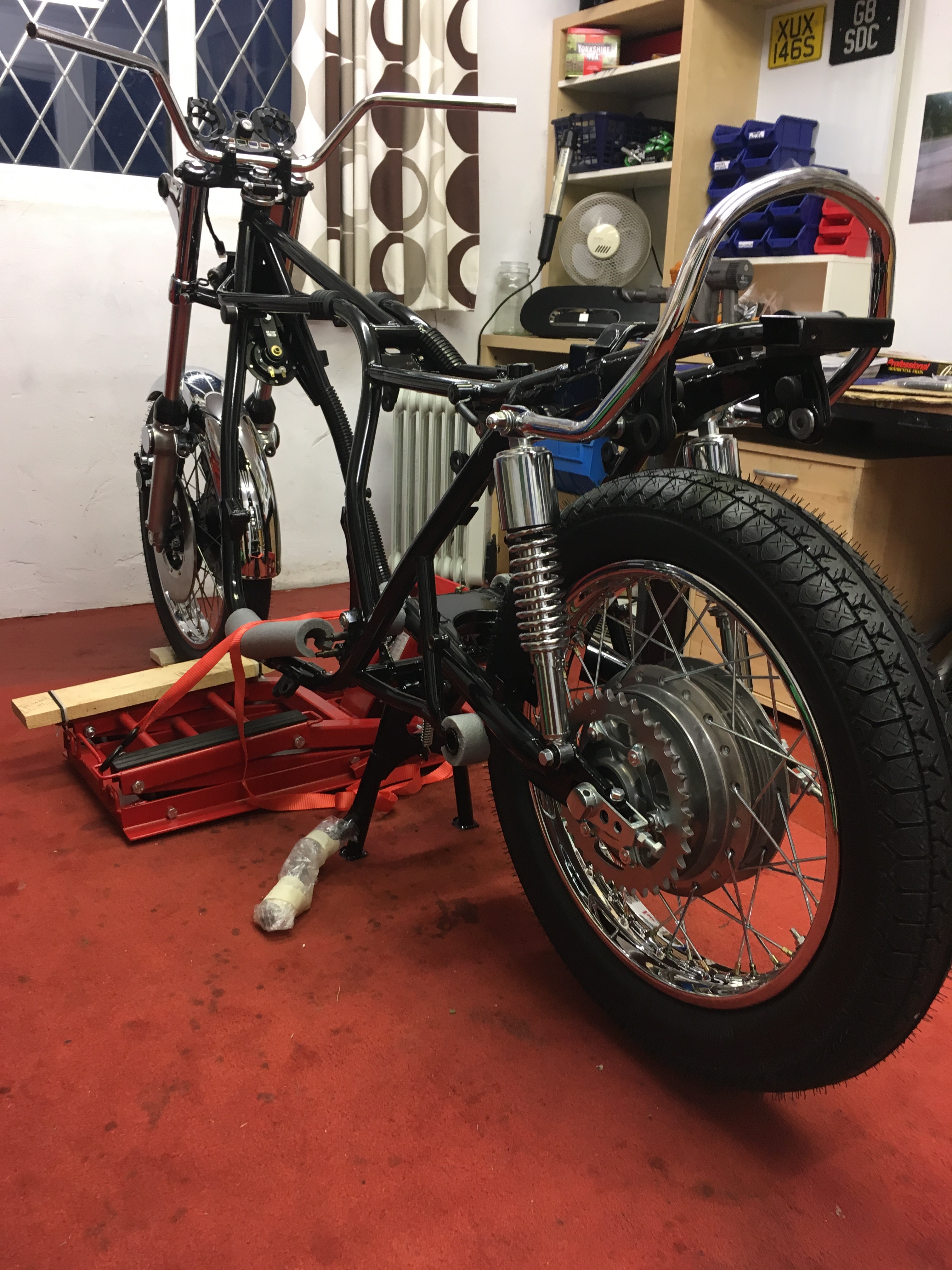

Have fitted new steering head tapper roller bearings and Fork Stanchions.
All going well :)

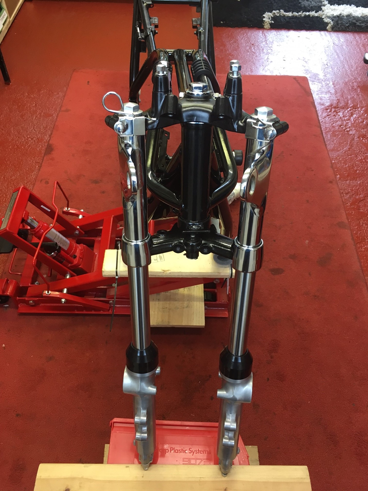

#18 PostAuthor: BigZCas » Tue Sep 12, 2017 7:44 pm

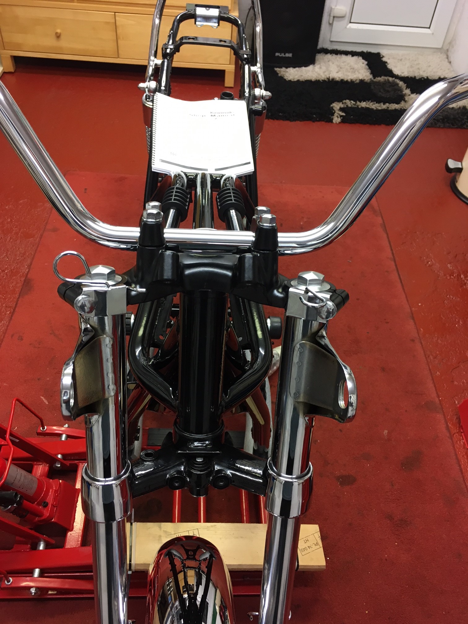

Rushed home from work tonight armed with Fork Top advice from z1bman and a manual from Dave @ Saisei.
Front end now correctly assembled :)

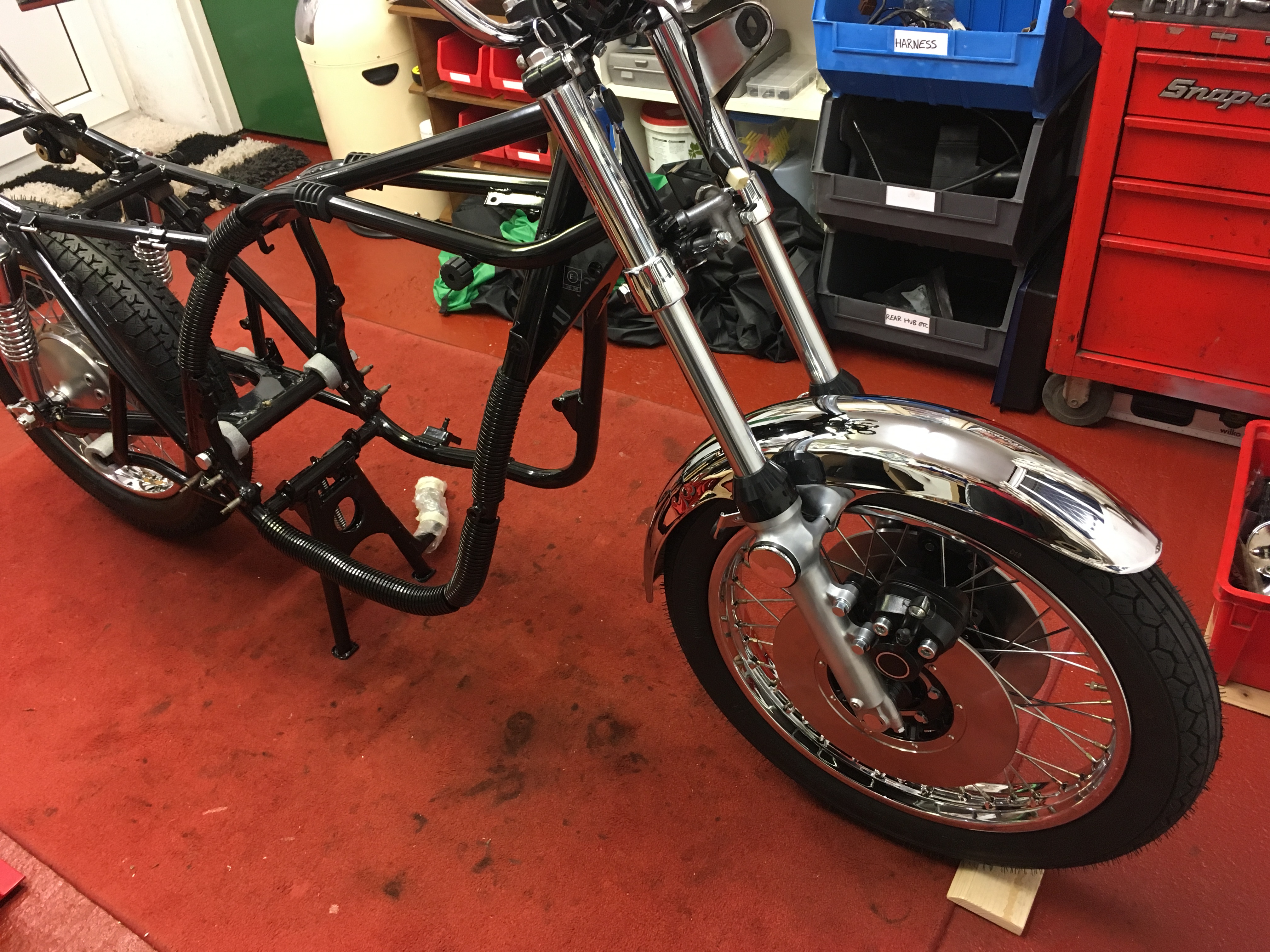

#19 PostAuthor: BigZCas » Wed Sep 27, 2017 7:08 pm
Quick update.
Engine taken down to Buzzard for restoration.
His workshops are very impressive, well nice guy.
Build steady as she goes :lol:

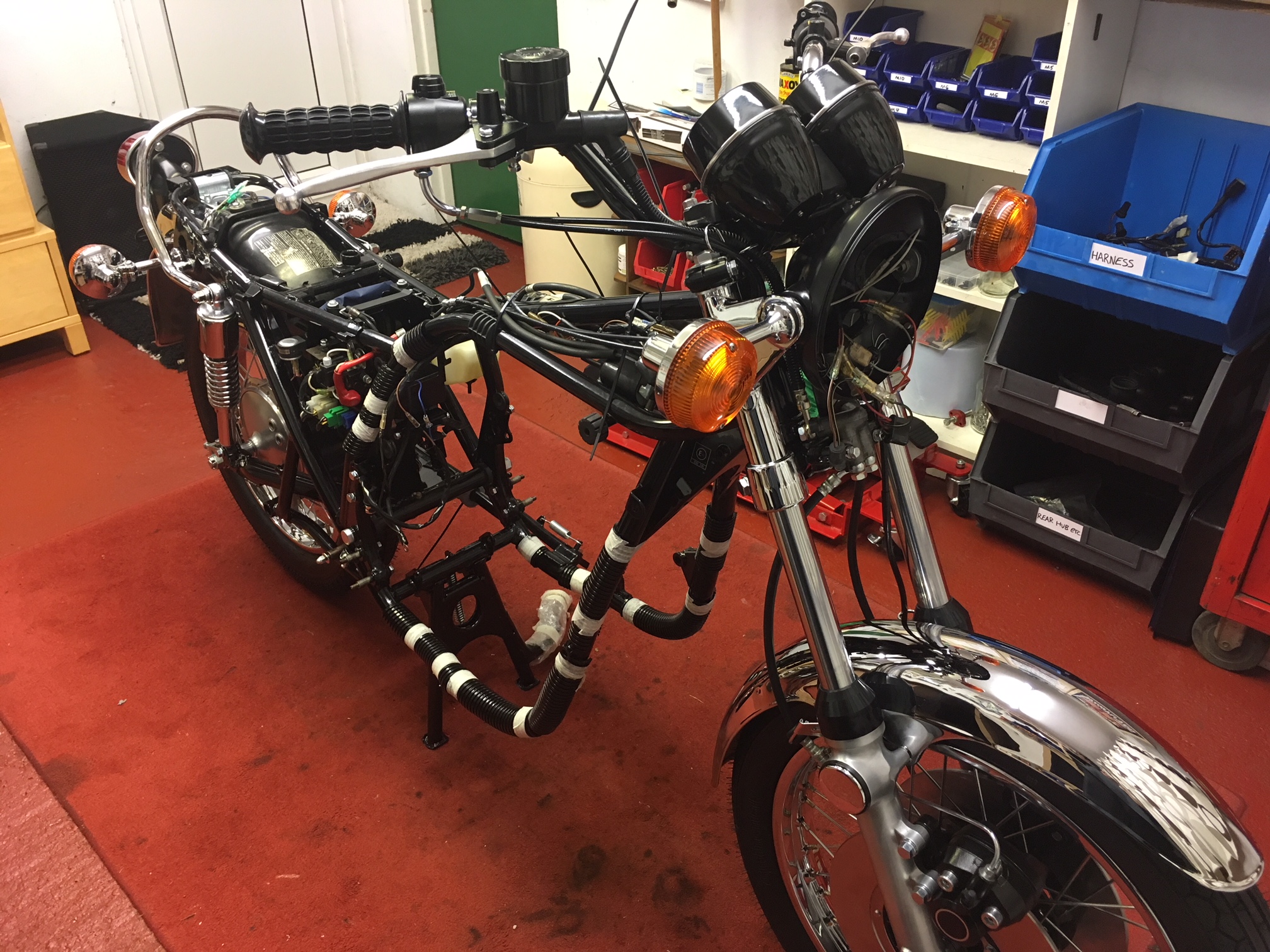

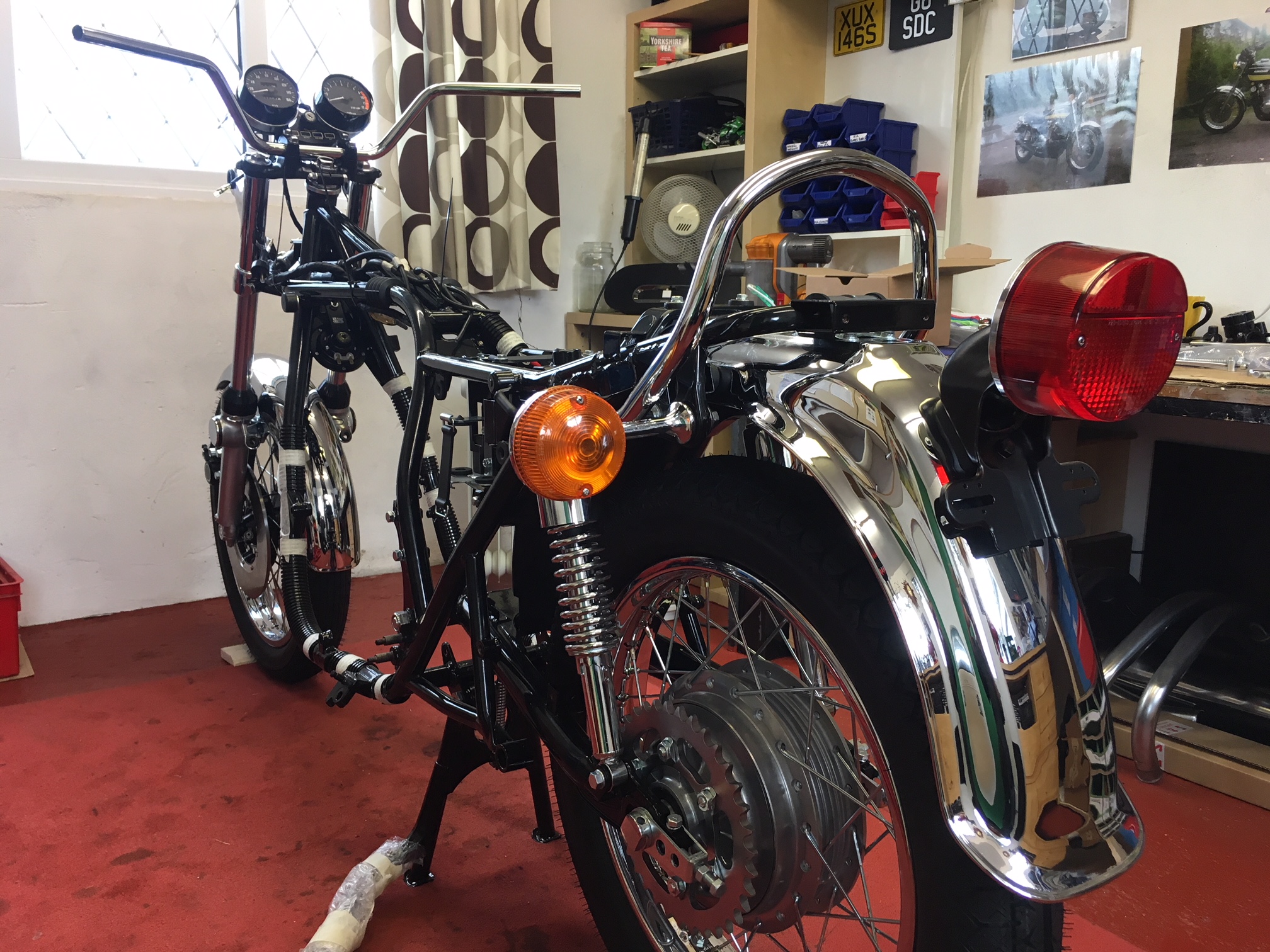

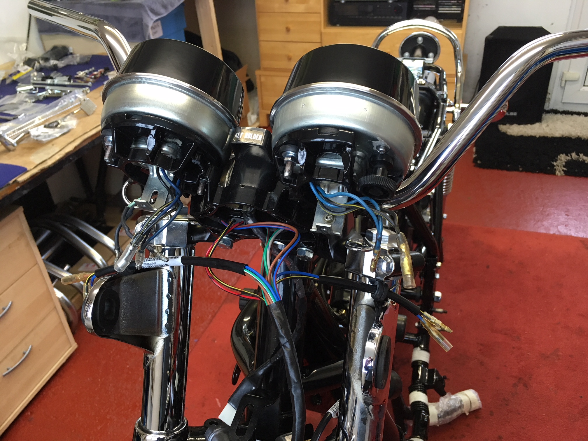

#22 PostAuthor: BigZCas » Sat Nov 11, 2017 6:29 pm
Wiring under way :)
Thanks Philippe for the clock wire positioning advice..

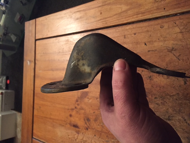

Looking good ..... be a while before I am at that stage and I am very envious of your rear guard ... just got one myself but its not as nice
Is it correct that the UK light mounting bracket is different to the US one ?

#24 PostAuthor: BigZCas » Sat Nov 11, 2017 7:49 pm
Thanks Chris,
As far as i am aware there is no difference in the mounting brackets ?
Certainly the mountilng holes are exactly the same.

#25 PostAuthor: wheelysteve » Sat Nov 11, 2017 7:56 pm
The mounting brackets are different, the UK (long fender) is longer and has a different angle to match the fender.
US (short guard ) part no. 23036-017
Euro (Long guard) part no. 23036-033
They look completely wrong if fitted on the wrong fender.
Steve

#27 PostAuthor: chrisw1 » Sat Nov 11, 2017 9:49 pm
I was comparing them yesterday .....the euro one seems to be more bulbous at the top as well as a different angle

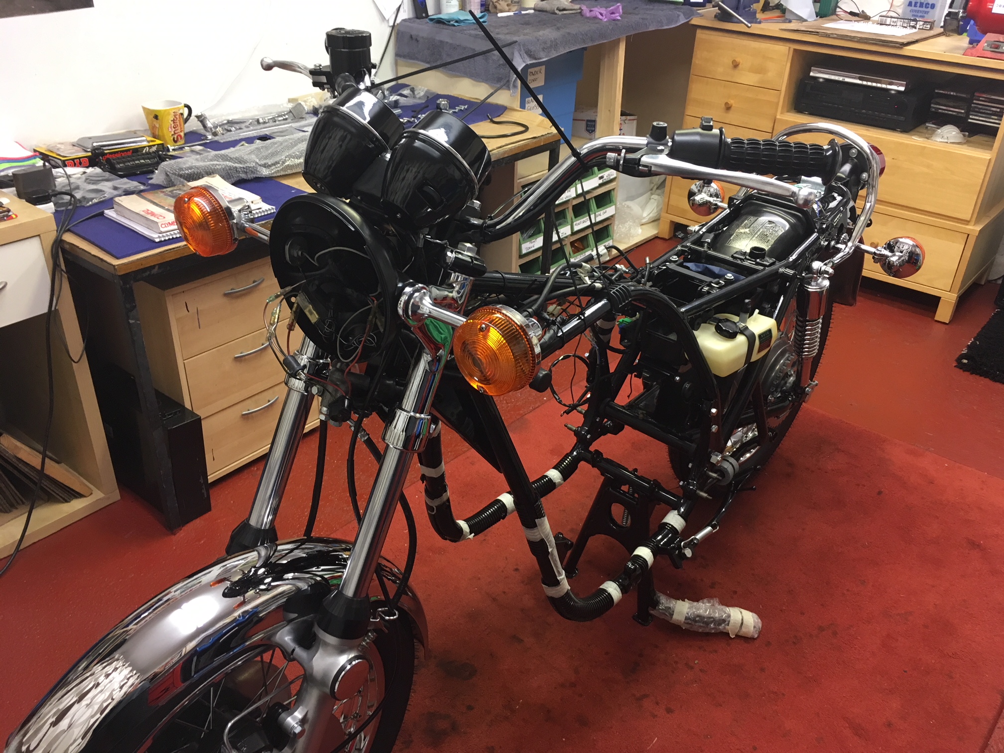

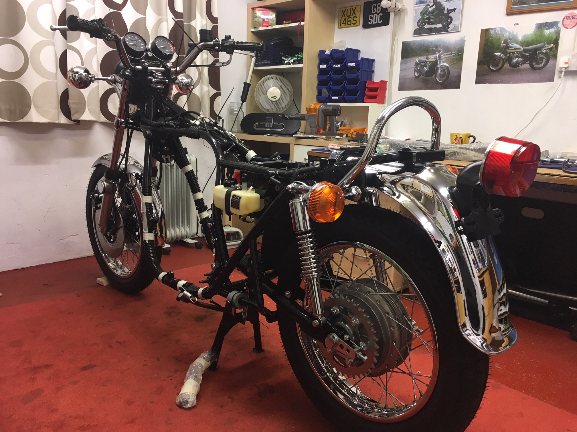

#29 PostAuthor: BigZCas » Mon Nov 27, 2017 7:01 pm
Quick update,
Soon be waiting on the engine...
Will test lights etc + Sort front brake fluid at the weekend. :)
