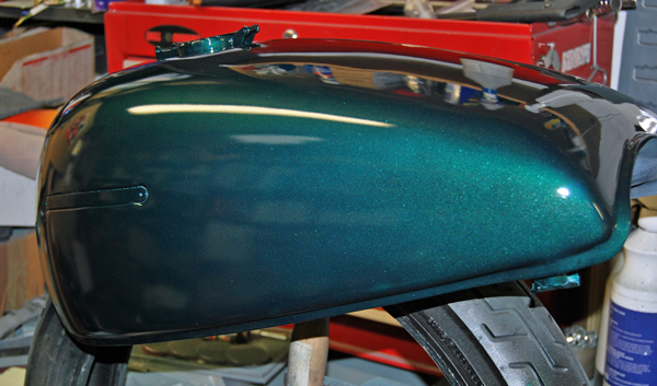

So - now she runs - it's time to finish the temporary tank.
Balancing the tank on the old Ltd rear tyre which was itself perched on the vice turned out to be a really bad idea, much work was duly ruined when it fell off.
So cunning plan 'B' came into action, this time the tank would be perched on an old Ltd front tyre (such brilliance) which in turn would be perched over a copper rawhide mallet (fall off that yer bastard). The mallet was then clamped in the vice - Humph!
After removing the new dents and scratches - it got three coats of rattle can topcoat (rover green again) and two of clearcoat - we are now good to go.
We don't mention the run(s), nor the dents I didn't fill - Oh - and the bit I caught my jumper on, or the finger print :oops

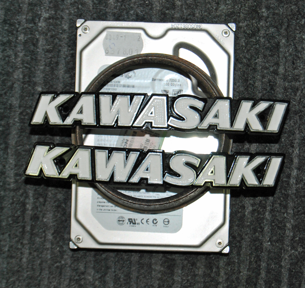

Gave the original tank badges a couple of coats of Humbrol Enamel Airfix paint - thanks son :ws

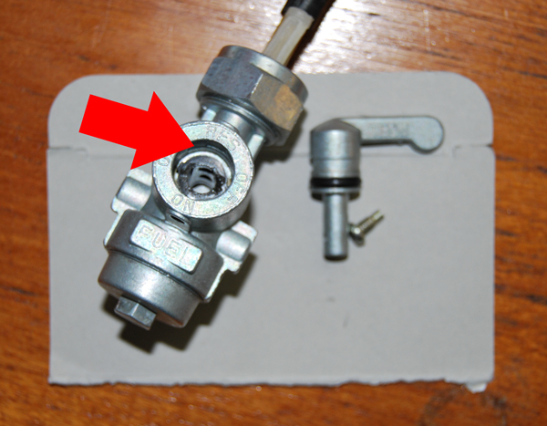

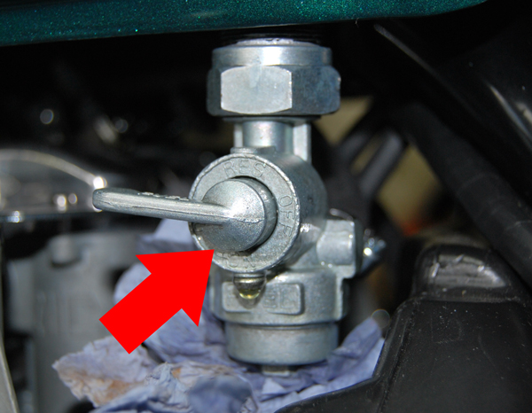

Came back from lunch and discovered a drip from the tap, although not masses it was a drip every 10 seconds or so.
Expecting the tap to tank seal to be the culprit I was surprised to see the leak coming from round the tap lever!

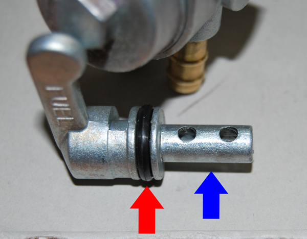

Drained the fuel and removed the tap, I had noticed on installation the tap lever was stiff to operate, a good seal or so I thought, now it was behaving very very loose.
The seal visually looked Ok, but the seat wasn't exactly round or smooth!
The internal design of the pattern tap differs greatly from the genuine article - although it is not to the same quality standard the design should still function in a similar manner.
The seal arrowed red is good enough, however with the seal 'seat' not correctly finished - it stands no chance of sealing.
To add to this the 'valve' arrowed blue looks fine in the pic - but it is not exactly round, it looks like finishing has been done with a hand file instead of the expected machined finish!
When preparing to remove the tap I found it did not shut off the fuel completely - when the hoses were removed it dripped fuel continuously from the outlets!
After speaking to a few suppliers it would appear this is a VERY common problem with pattern fuel taps from a particular manufacturer in China, and has been so for quite some time.
From what I understand the pattern fuel tap I have(although not marked) is from the same 'Flung-Shit'(correction needed!) manufacturer in China.
I am told these particular pattern fuel taps are all that are available at the moment - It seems PMC had problems with theirs and are not producing any at this time.

#125 PostAuthor: wilsonsjw11 » Mon Jun 01, 2015 12:39 pm
Look round for a genuine Kawasaki unit there are some still about but will cost£££.
The pattern items are shite.

#126 PostAuthor: steve bowdler » Mon Jun 01, 2015 2:06 pm
It seems Pingel are the best choice at present but unfortunately not when going for the original look
http://www.debben.co.uk/Pingel.html
Hinckley

#127 PostAuthor: Hinckley » Mon Jun 01, 2015 2:37 pm
Regards
Steve
Have found a replacement in the states, I'm reluctant to push the button on it as the guy that has it - is a gloating arse!
Pingel wouldn't be so bad if they wern't so darned ugly!
Had one before that leaked and I couldn't get it apart, looks as though the new ones are not serviceable items, unless someone knows different.

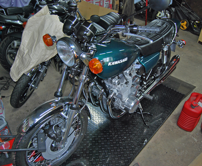

June week 1.5 update - D day :D

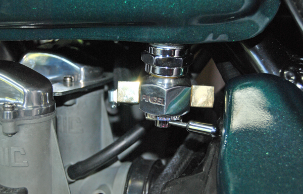

So after much deliberation on fuel taps - the obvious Pingel tap arrived from messers Debben.
#3211D - Twin outlet tap £70
#A2001C - M22 tap adaptor £18
#TYGON - Fuel hose yellow £7
I didn't end up using the hose as it looked hideous, it would look ok with some cotton overbraid - but I don't have any - the hose I had stretched over - just!
The threads were treated to some PTFE tape and the adaptor gently screwed down, nipped up with my trusty 1" service wrench and we are good to go!
Closer....
A gallon of fuel went in - and stayed in - no leaks this time!
To be on the safe side I drained the fuel bowls again and flushed em through. yet again more black bits and blackish jelly blobs emerged - but less than last time - with clean fuel flowing I pressed on.
Closer....

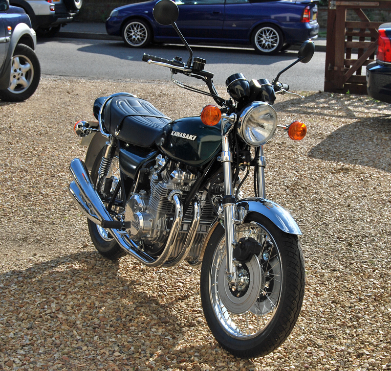

Wheeled her out the garage for the first time.
I had an audience so was a bit nervous - I neednt have worried - First Prod - Brrrrrr, rumm, barrrr, rumm, barrrr, rumm - rummm, barrr - brrrr - perfect!
Ready....
Went to load her in the van and - the clutch was stuck fast - bugger!
another ten mins of adjusting and general buggering around trying to dig up the drive with the rear bridgstone and the clutch was free - yay - in the van she goes...
So - First Ride Report.
Unloaded and warmed her up......
Sun shining - Fuel on - Ign on - Start - into 1st gear - and off we go.............
1st, 2nd, 3rd, 4th, 5th - nice and so smooth - no issues.
Round the twisty bits - over the bumps - on the brakes - purrrfecctt!
The first thing I noticed was how smooth it is, steering is light and very positive, suspension is nice and firm - but not too firm.
It flows naturally into the corners with just a hint of understeer - but that's being really picky.
The riding position is very upright but not uncomfortably so, the wide bars take me back to bikes of old, pootling around it felt more like an old flat-tracker - just waiting for me to get its tail out!
The gearbox is super silky smooth, positive selection with plenty of lever feel.
Final drive ratio is great - just what I wanted, I'd calculated the ratio for using the 530 set up and wanted a touch taller gearing.
Going with the 1 tooth less rear than the standard set up for the 530 kit brings the rev's down a few hundred rpm for cruising but is still responsive enough if required, first is still pretty low - so I could easily go down 1 tooth more on the rear if I want (or up one on the front and two/three on the rear if clearance becomes an issue).
The motor is extremely silky and so so smooth, still a touch tight but I was surprised how much low down grunt it's got, to be honest I was expecting less.
The fuelling seems spot on - ticks over perfectly at 900rpm, pulls cleanly from the bottom with no hesitation whatsoever - power is linear and progressive.
I didn't rev it hard at all on the test ride - so the top end is something to discover on another day :D
The first ride was unfortunately cut short as a ticking sound had started to appear on acceleration, four miles into the ride.
With the bike stationary it sounded like cam chain lash or a loose shim or two, will pull the cover for an inspection at the weekend.
With the bike back on the ramp I gave it the usual once over.
Save for a bit of wet-staining from the cam cover gasket she had No oil leaks and after a quick go around with the torque wrench - No loose bolts either - result!
The motor was too hot to do much, so I sat with a tea and made a few notes of things to do.
1 - adjust clutch lever, as the plates started to bed the lever play got bigger, I adjusted the lever adjuster a couple of times but I'll adjust it gearbox end as I know the cable will stretch as it beds in.
2 - pull the forks up a touch in the triple clamps, just to quicken the steering a bit - although the steering is very neutral and doesn't need adjusting - most of my bikes are a bit quicker to turn in so it suits me to make the change.
3 - bleed the front brakes again, just a touch on the soggy side, the lever was just a bit too far back to the bars.
4 - pull the nearside front calliper, although on the test run I didn't pull very hard on the brake lever - it had not wiped the paint off the disc completely - the offside had - so I'm going to pull it and check it slides freely, if it has stuck that would also explain the slightly more soggy than normal (for bedding brakes) feel.
5 - pull the cam cover and have a look around, re-tension the cam chain.
6 - adjust the rear brake lever, the more I used it the more it went out of adjustment, as it started to bed-in the feel was getting better and better, not snatchy but with firm pressure it had already started to be effective - something I'm devoid of with my tuono - shite rear brake on that.
I really don't know exactly what I expected - but I was very pleasantly surprised.
As I type a parcel has just arrived from the states - thanks Jeff :D
Such fun :D

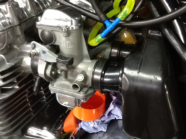

Drained the float bowls and very dark fuel came out with lots more black jelly blobs and what looks like very fine black sand! WTF!
Pulled the tank and after a dam good shake and drain - I found the source of the black jelly blobs - but no fine black stuff - just a few rust flakes!
I stripped and cleaned the pingel tap, carb hoses off, float bowls off, pulled the jets and blew them through.
I noticed the fuel hose had expanded a little, and black bits were coming off on my fingers - that's the source of the black bits then!
Filters and the horrid debben yellow fuel hose were installed.
I rigged it up to the remote fuel tank and flushed the carbs through - just to be on the safe side, a cut down aerosol lid makes for a good catch tank! I found a cold chisel was a good fit for the drain screws to stop from getting the screwdriver marks on them.

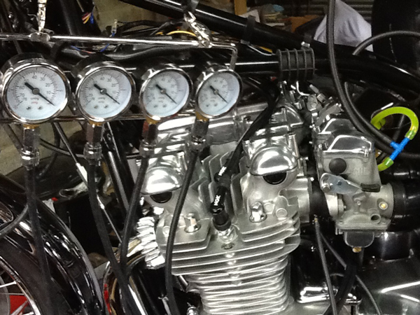

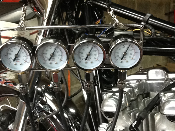

Cam cover back on I hooked up the carb balancer for a quick check.
Motor fired up first prod and was noticeably much noisier with the larger shim gaps.
Warmed up and after setting the Idle the vacuum on No2 was higher than the rest, a quick adjustment made the throttle hang - bugger!
Re-set No2 and adjusted the other three up to match - job done.

June week 4 update.
On the subject of fuel hose - for now the debben tygon yellow hose has been replaced with marine fuel hose.
The short length of hose debben supplied turned out to be not long enough to cope with the bulky fuel filters I'm using.
The tight turns necessary caused kinking when warm as the tygon hose has no wall strength.
It wont run fuel filters when the new tank goes on - but it will be using the genuine tap currently fitted to the Ltd, and (if I can find some) black tygon hose - if not marine hose.
The leaking cam cover gasket that was sold to me as 'genuine' by Cradley Kawasaki has been changed for one from supplied by Dave @ Sushi.
I was suspicious about the 'genuine' gasket as the one I got from CMS was a 'pinky' colour, this dark grey one seemed very rough around the edges and very thin by comparison.
I have a spare original CMS supplied 'pinky' coloured 'genuine' gasket.
This gasket is made from a different material and much much thicker with a much sharper cut - I'm keeping it back as a get out of jail card.
The gasket supplied by Dave is not quite as thick as the 'pinky' coloured 'genuine' one but it seems good quality and has some elasticity.
I have only ran the bike for a few mins but no leaks so far :stfu
The MOT is booked!
I spoke to the tester about the headlight from Z Power and after showing him a pic was told 'That beam pattern is for driving on the other side mate!' - oh good....
I'm going to use the original sealed beam one for the MOT - The dip beam pattern from this is more or less straight - I'll take a bit of black sticky tape just in case.
Ever closer :D
