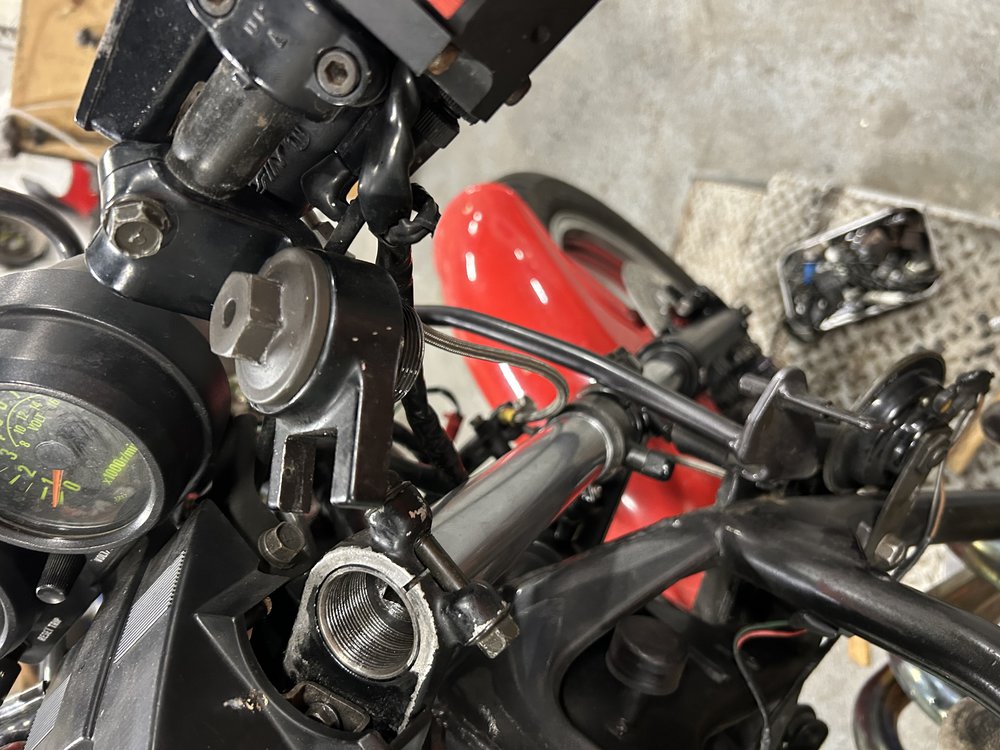

Sorry, to be clear, the fork is flush with the top of the yoke and the long cap bolt extends down through the handlebars to hold them down. I will post a photo in a minute.
The top yoke is just over20mm. The gap at the bottom of the balance tube is 17mm even if I steel 3or4mm on position of the tube I will have only 7mm or there about in the top yoke. Wtf! :?:

the top of the fork being flush with the top surface of the top yoke is right, was the balance unit sat on the bottom yoke before it was stripped ? thats the usual position. if everything is in the exact position where it should be theirs a chance the balance unit can slide down due to road bumps, you could get a bit of black plastic tube cut to size that'll fit over the fork leg and sit in-between the gap.

Hard Road wrote:the top of the fork being flush with the top surface of the top yoke is right, was the balance unit sat on the bottom yoke before it was stripped ? thats the usual position. if everything is in the exact position where it should be theirs a chance the balance unit can slide down due to road bumps, you could get a bit of black plastic tube cut to size that'll fit over the fork leg and sit in-between the gap.
That’s what I’m afraid of. I’m happy enough to make up a spacer, my real concern is, what has gone on here. Have I dropped a bollock or was this always the case. Never minded the position of it before, just presumed it was down tight. I am going to compare to a turbo forks first chance I get. I wonder were they changed at some point for a set that where “near enough!”

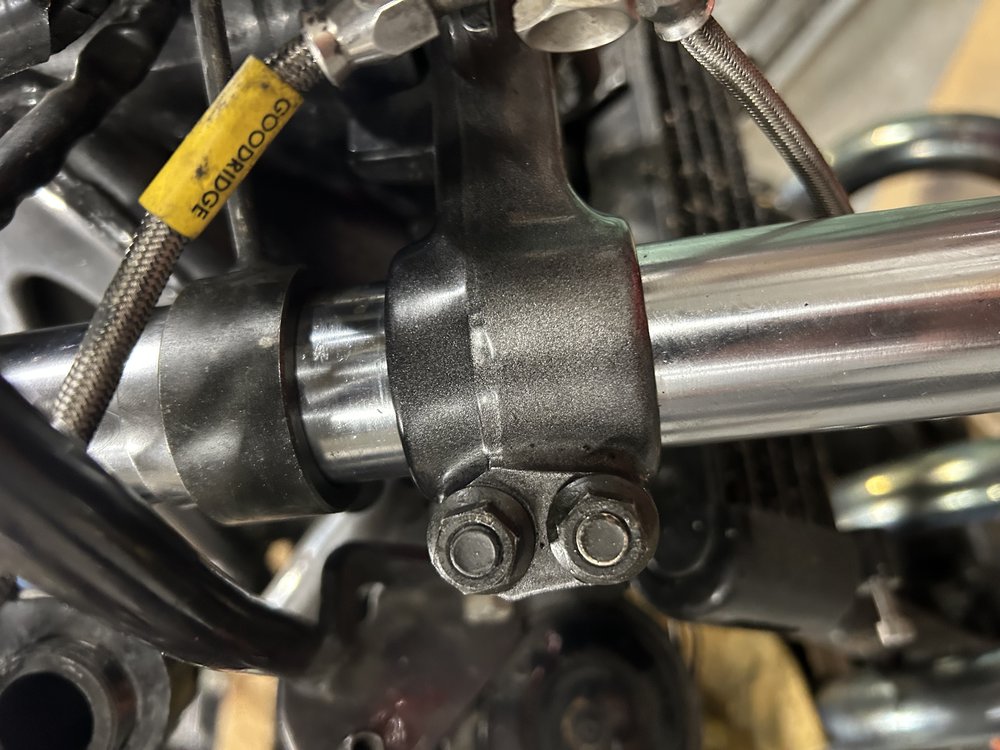

I may be up the wrong tree but forget the length of the forks for the moment. The issue is the position of the balance hole in relation to the bottom yoke. Here's a pic of mine when I first got it home.
If you zoom in the balance pipe is sitting on the bottom yoke.
I've just measured the length between the top of the fork to the centre of the balance hole.
21.7cm
If your balance hole has the same position the only other thing that could change the pipe postion would be the yokes or fitting of.
If the complete fork was a different length the only thing it would alter is the postion of the front wheel because the top yoke is the datum.

I slipped the tube down and this shows the position of the hole when tibe sits on the bottom yoke. Tube is as per previous photo in line with top of yoke. Nothing for it but as you suggest cut a spacer to prevent the tube slipping down. Inly explaination i can come up with is they are a slightly different replacement fork. Old bikes, old problems!

my thinking is, if both yokes are in the correct positions as per the factory spec then the only explanation is the fork tubes have been changed, either with aftermarket ones or tubes off a different model.
and as I said a simple fix is a spacer. :wink:

I got 218mm to the centre of the hole from the top of the tube, so we are pretty much the same. The diffrence must be the space between the bottom and top yokes? I got 249mm top to top. would you mind measuring yours? Either way I agree about the spacer. I just want to find what the cause is.
