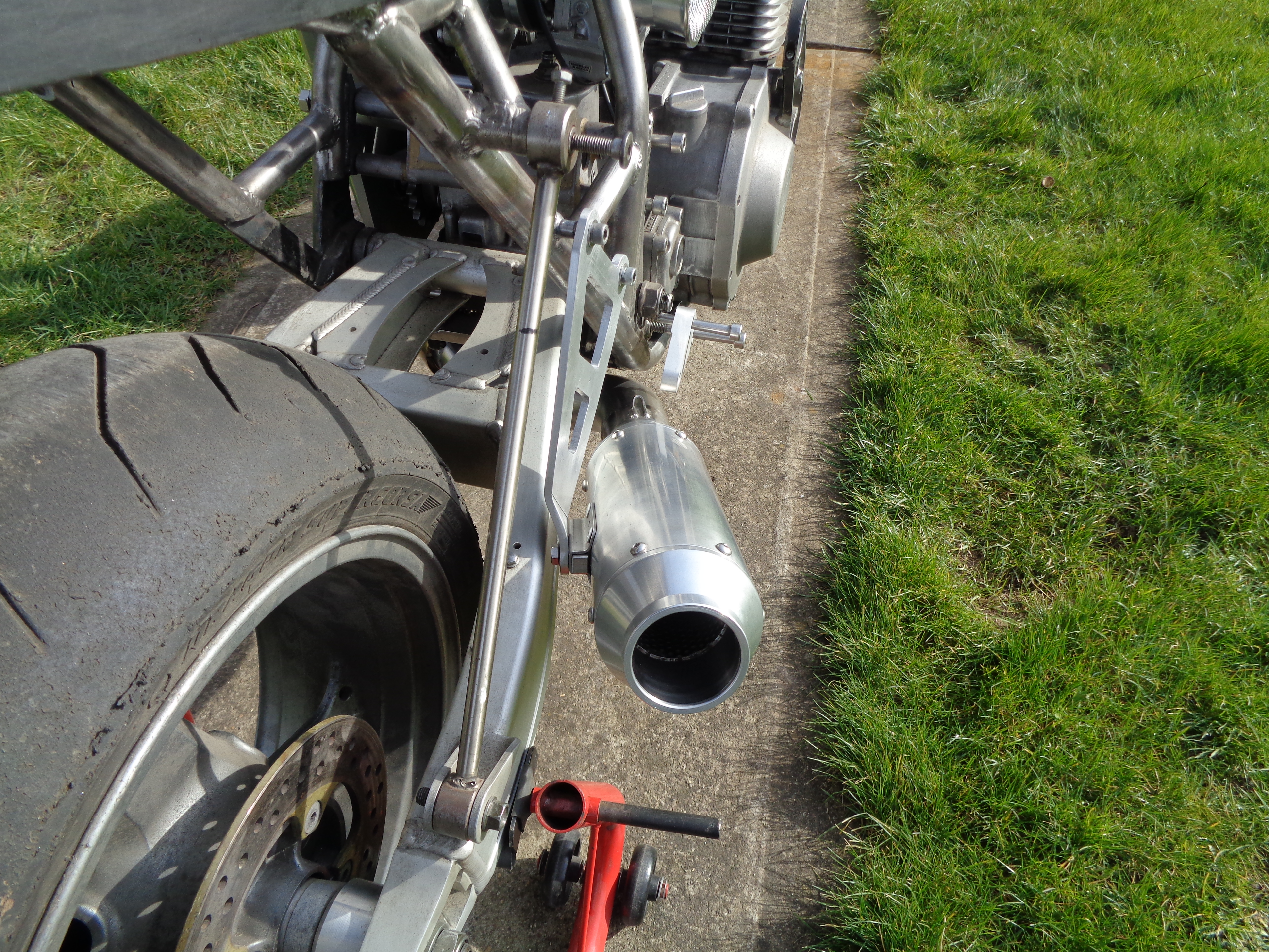

Posts: 4029
Re: Double the troubleZZ. AMA style Racecrafters Z1000 (completed) and Moriwaki Z1R Turbo.
#294 PostAuthor: zed1015 » Fri Feb 21, 2025 9:51 am
The original idea was to have the can a bolt on fitment but the diameter of the flange needed for the 63mm link pipe wouldn't allow for hardly any taper on the intake cap so changed the design to a slip on which incorperates these reducers to serve as the connector and baffle holders
Both reducers have had their smallest diameters skimmed externally so that they are truly round and parallel on the narrowed sections with the top one for the slip on connector and the bottom cut down for the outlet end cap.
The wider section for the slip on connector was a very slack fit and tapered so was slotted and welded back up whilst clamped square to the pipe.
Then the lump of ally earmarked for the intake cap was whittled away on the lathe until i was happy with the shape and bored out to take the slip on connector.
Which now has the spring tags welded on that were formed from the stainless rod.
I had thought that i may need to secure the connector to the cap with some rivets which is one reason i left the 12mm long straight portion at the end but it was such a tight press fit i don't think it will need it
Inside of the cap has had as much material removed as possible to reduce the weight and expose around 10mm of the pressed in reducer for the baffle tube to locate on.
Quite happy with how that turned out so next job is to tackle the other end.
Posts: 4029
#295 PostAuthor: zed1015 » Fri Feb 21, 2025 3:20 pm
The same treatment for the outlet but 20mm shorter then bored out from the inside and stopping short of going all the way through to create a raised lip.
So that the reducer/baffle holder has something to stop against once pressed in .
Which gives a neat blended in finish to the exit.
And the baffle tube slips in here.
All done more or less and ready for assembly.
Pretty much what i was aiming for.
And looking much better once i'd spun the endcaps in the lathe, run over them with the wet n dry to smooth and radius the sharp edges and then gave it all a quick polish.
Some finishing to do when it comes to the final build and i may highlight the Moriwaki text with some paint.

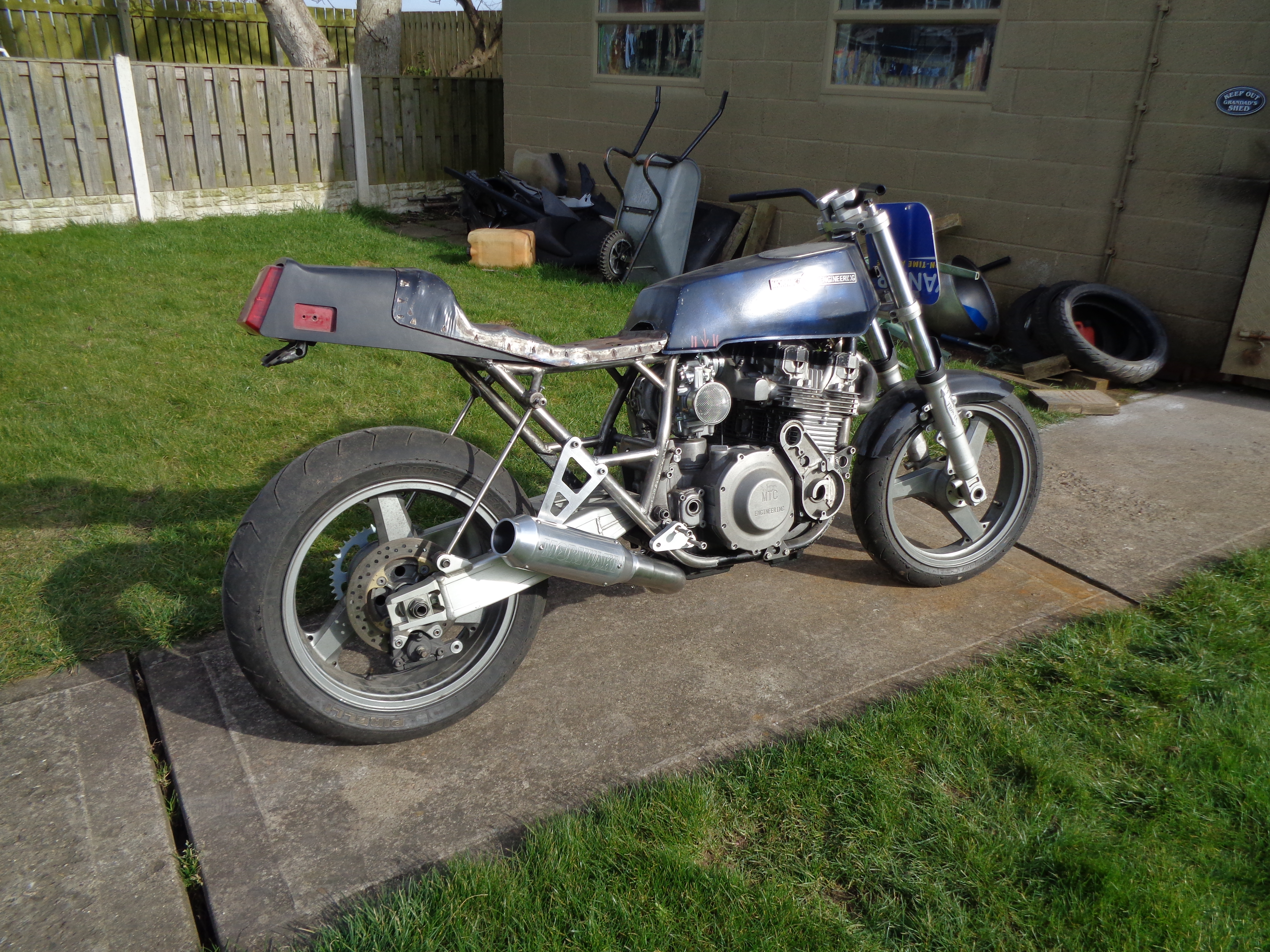

#298 PostAuthor: zed1015 » Mon Mar 03, 2025 3:40 pm
Needed to mount the can in the position i want so i had a point to build the link pipe back to.
Started with welding some threaded stubs on the frame the same as i did with the racecrafters.
Then turned my attention to the can mount.
I didn't want to obscure the "Moriwaki" text with a strap so cobbled up some square steel bar and flat plate into a press tool to form a rivet on stainless bracket the same as was common back in the day on Micron cans etc.
Which had an 8mm wide slot milled in
And a sliding captive nut to allow some adjustability.
After which the two were linked together via a suitable hanger made from 6mm aluminium with a couple of angled holes to suit the Z1R's styling milled in for lightness.

#300 PostAuthor: zed1015 » Mon Mar 03, 2025 6:32 pm
The gap between the vertical outlet and end can is now bridged with the link pipe which tucked in nicely behind the sump and in the correct position at the first attempt this time.
Just need to add the spring tags for the can and a support bracket to one of the original Z1R exhaust collector mounts so that the link pipe doesn't drop when the vertical outlet section is removed.
