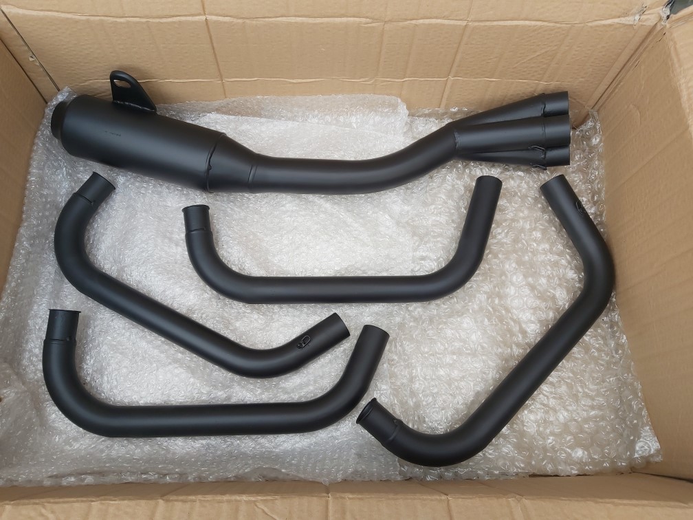

I've also had my original Harris 4-1 Ceramic coated. After a false start with another company I eventually sent it to Maldon Powder Coat and they turned it round in about a week. The finish is "Glacier Black" and looks quite smart, I think.

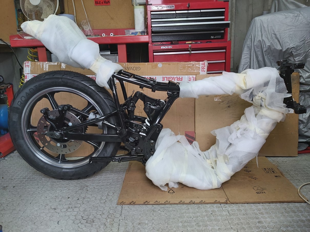

This weekend has been a good weekend :D The swingarm & shock are in, as is the rear wheel. The yokes are also on, but the forks are still not built. I thought I had everything but the NOS bushes for the bottom of the stanchions I have are not the correct size (there's a story to this which I shall elaborate on in a later post ! ) Hopefully the correct ones now are in the post.
Anyway, here's the progress so far.....................

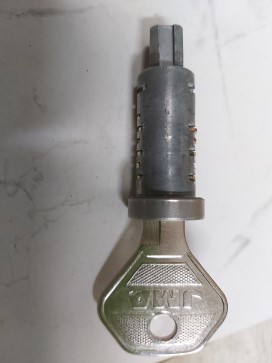

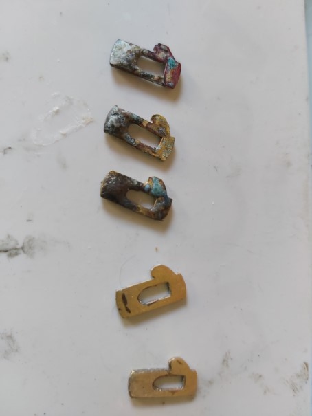

One job I did have success with was rebuilding the old ignition switch. The lock worked OK, but it had worn so much you could remove the key in the "on" position" :shock: I know I could have bought a pattern lock and possibly had it modified to my key, but all the locks are original and 1 key fits all, so I wanted to retain it if at all possible. I had a couple of other , old ignition locks from other bikes, so used them as a guinea pig to see how to strip them down and what I was faced with. I also thought I might be able to cannibalise them to make a good one for me. Once stripped down, I found the issue was wear on the brass tumblers - over the years, the action of the key being inserted & removed had worn a groove in all of them. Looking at them, I thought maybe I could build them up using a brazing torch & filler rod. What followed was a very lengthy process of brazing up, then filing down 7 tumblers, checking all the time to get the correct height when the key was inserted. Although very time consuming, it was very rewarding to re-assemble the switch and have it not only work, but the key does not pull out in the "on" position - result :D A coat of paint on the switch body and a new decal for the lettering completed the job.
You can see the original tumblers at the bottom and the lower edge of the inner cut out is dished - this is the area that needed building back up. Above are the tumblers after brazing. The filler went in places I didn't need ! So it was a lot of filing to get them perfect !
But when they all line up when the key is inserted, all that effort is worth it !

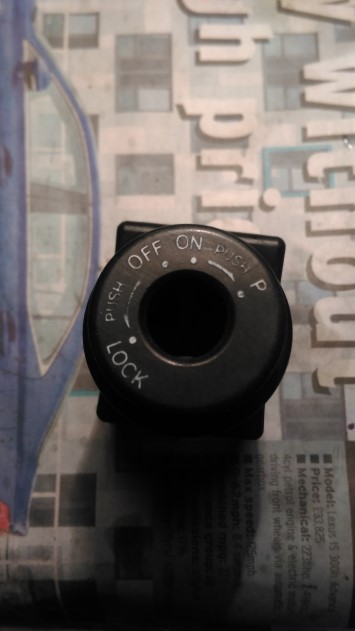

The lettering on the cover was just a bit too faded. Unfortunately, the lettering is very slightly raised off of the surface, so despite my best efforts, I couldn't touch it in to my satisfaction and used a decal instead.

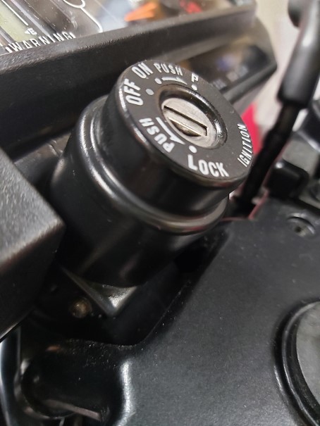

And here it is, complete and fitted to the bike.
Ignition Switch.jpg (55.39 KiB) Viewed 145934 times
