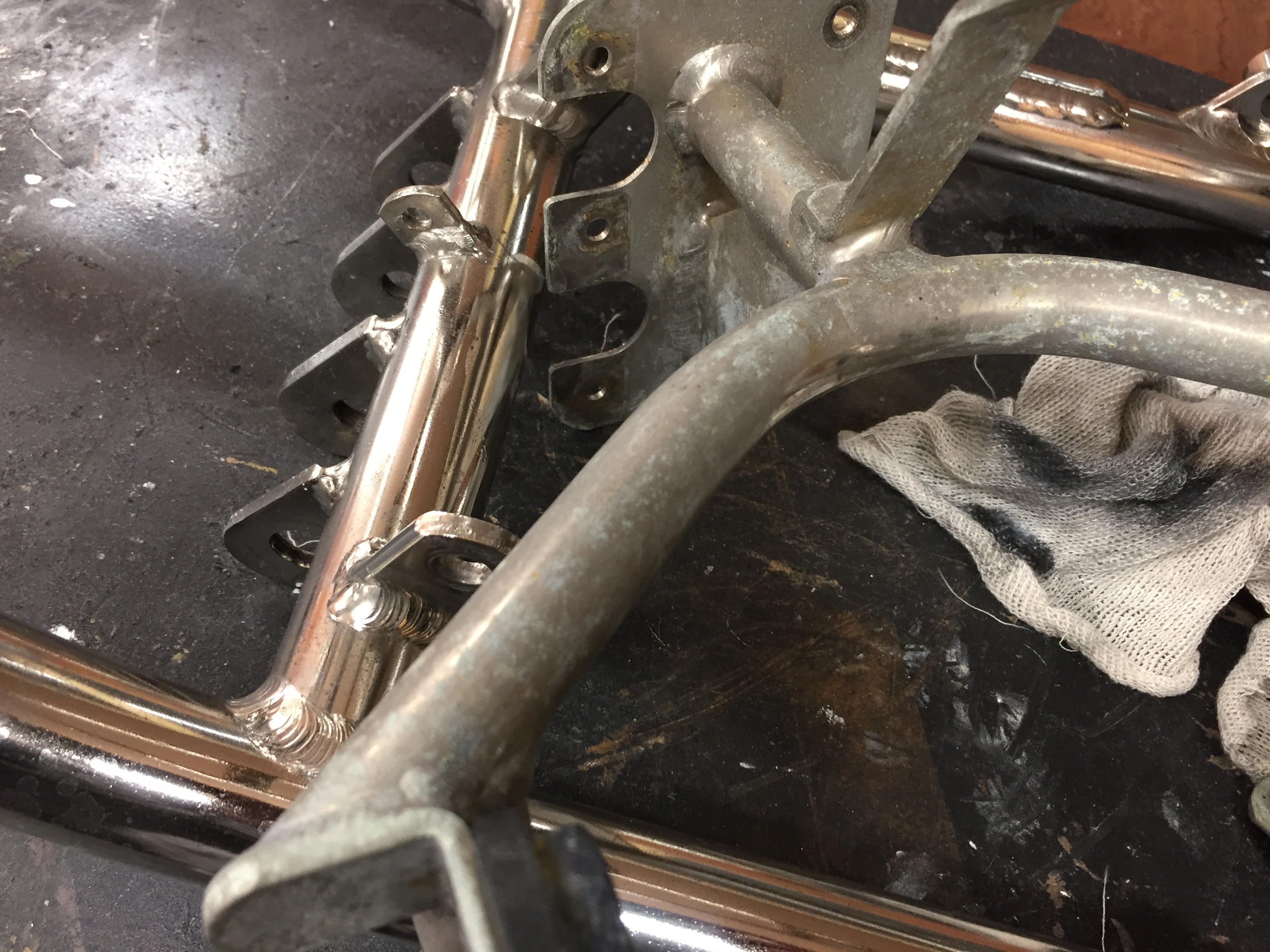

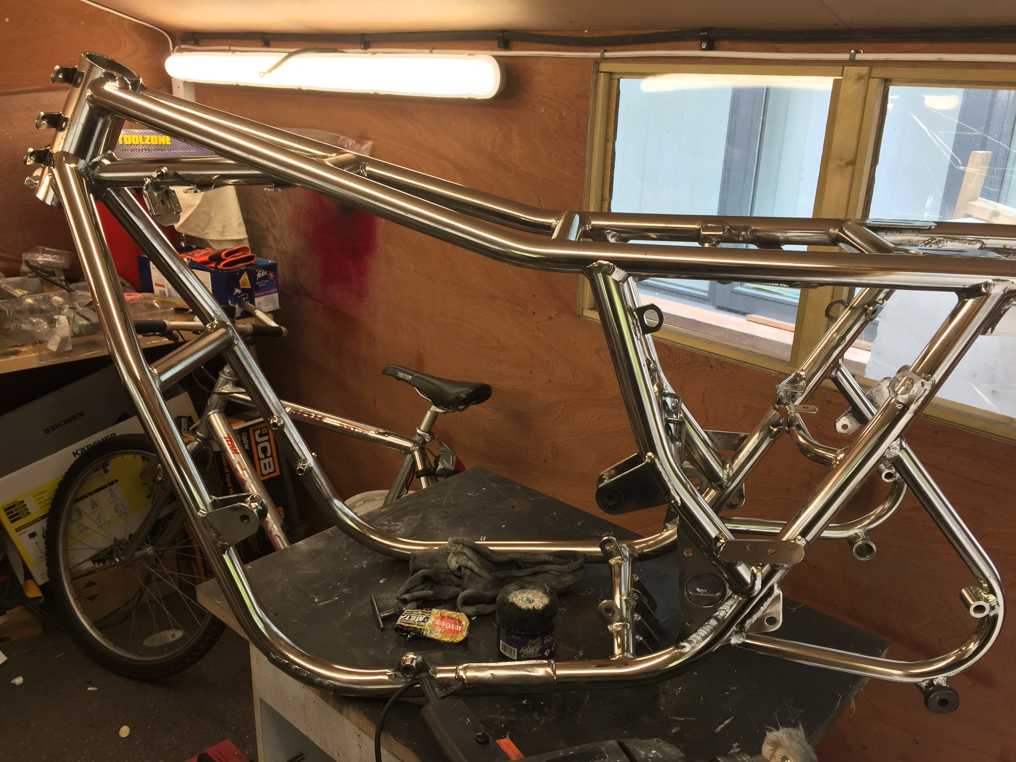

Update , frame finished , it’s amazing how well it’s come on , a lot of it was oxidised, give it a good coating of wax now

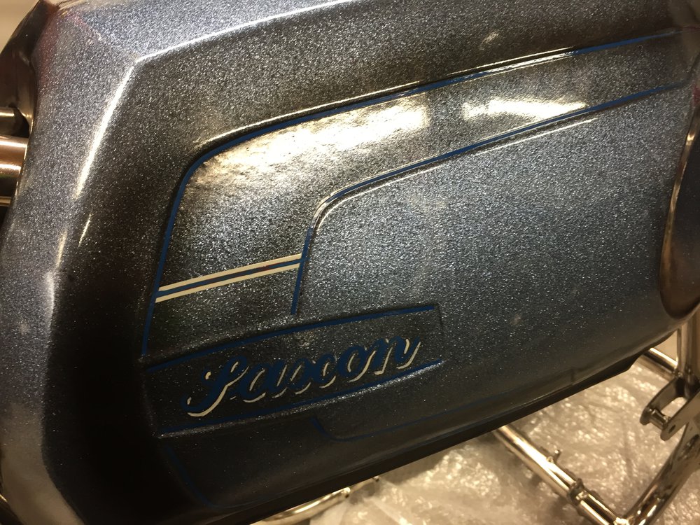

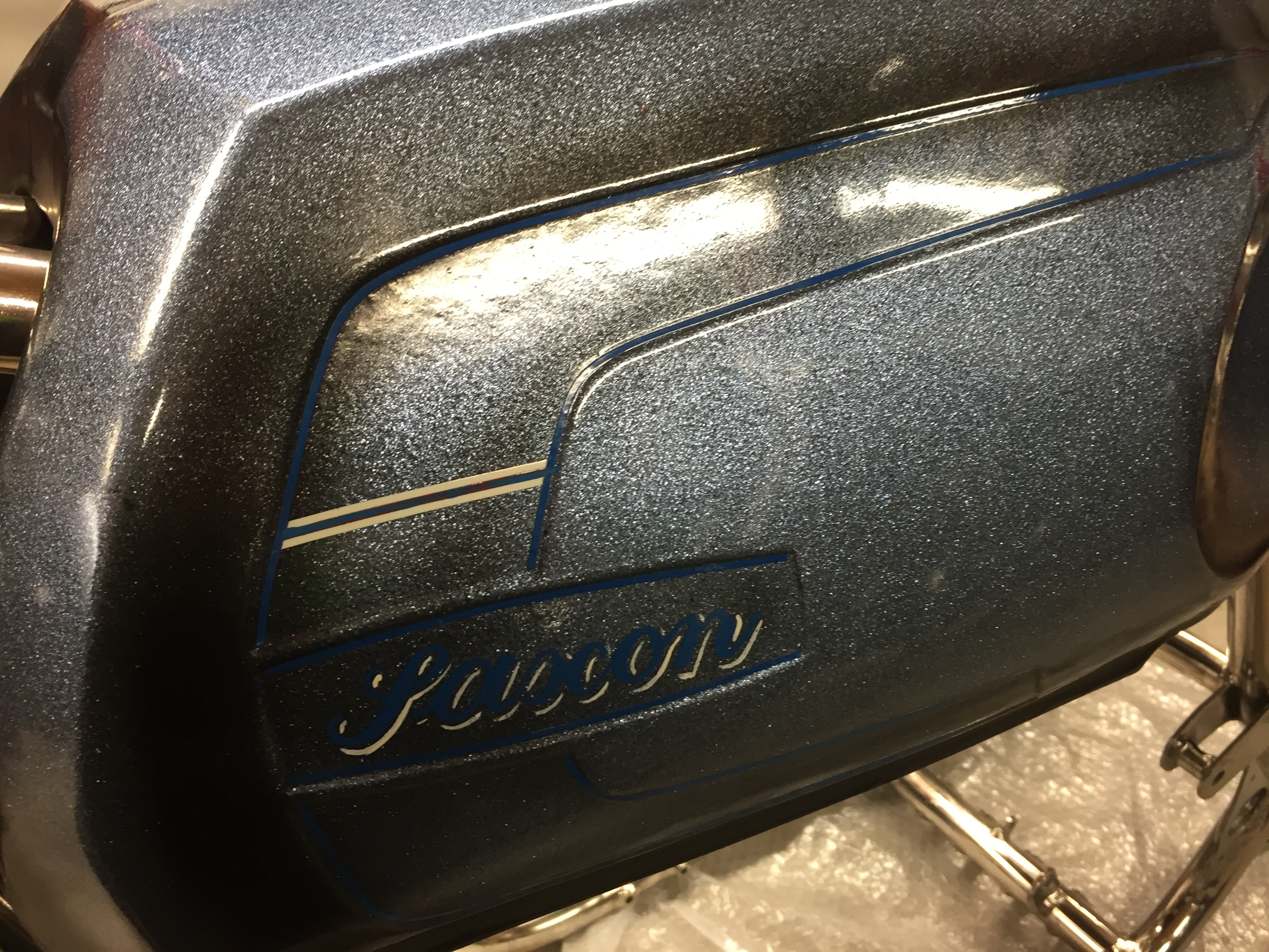

#35 PostAuthor: RAYZ1 » Sun May 12, 2019 7:44 pm

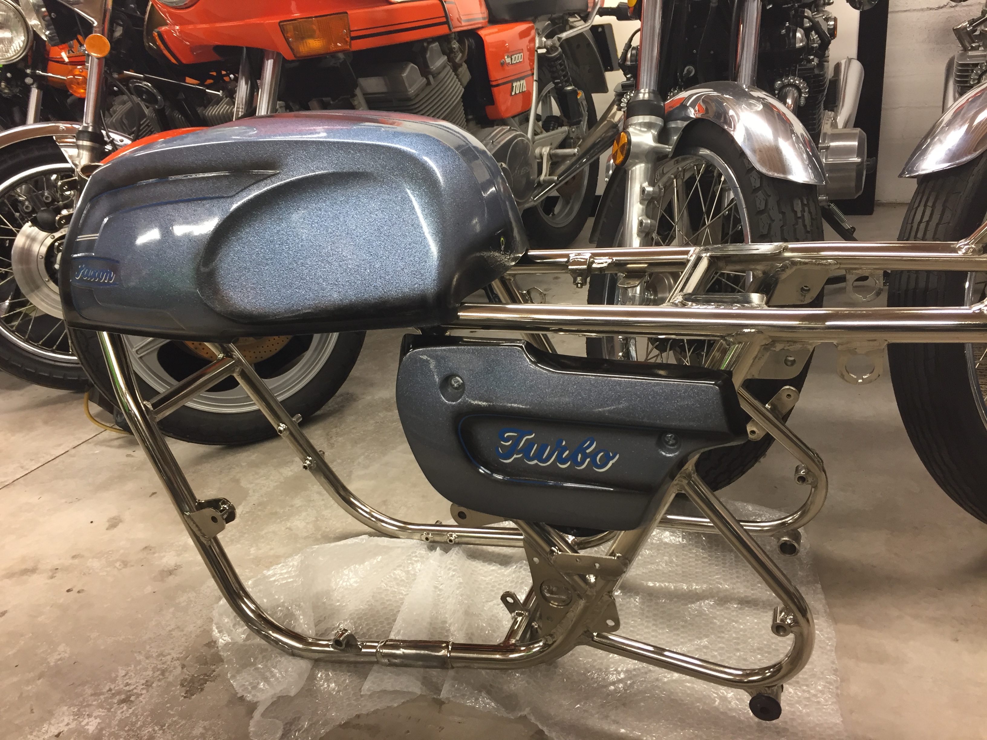

Next stage , I was going to put the frame over the engine but think I will complete rolling chassis next , a lot of fasteners and plates to sort out first so will take a minute or 2
Put the original paint work on the frame just to see contrast with polished work , the frame certainly brings it back to life , can’t change the paint as it’s probably the only original Saxon paint job left , complete with hand pinstripes and lettering,and it’s real 70s glitter flake

For contrast of the paintwork, here's the prototype how it was sold to Saxon.
side 1.jpg (56.68 KiB) Viewed 12933 times

My wife laughed and said I looked like the coalman, yes it was a dirty long job , but satisfying

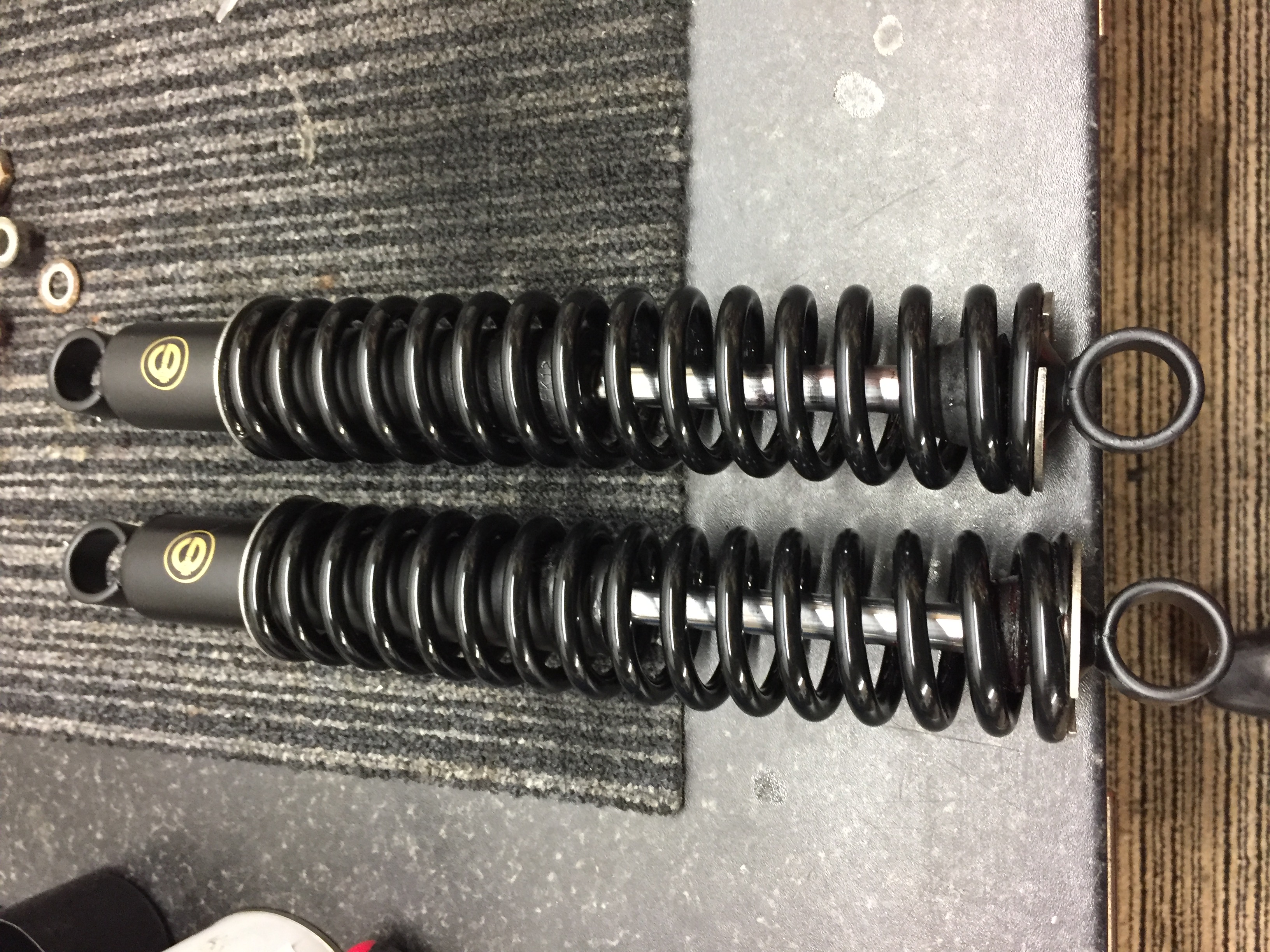

The original Girling shocks refinished , dampers still fine , springs powder coated , were painted black originally, nickel plated the collets in a jam jar with 5v

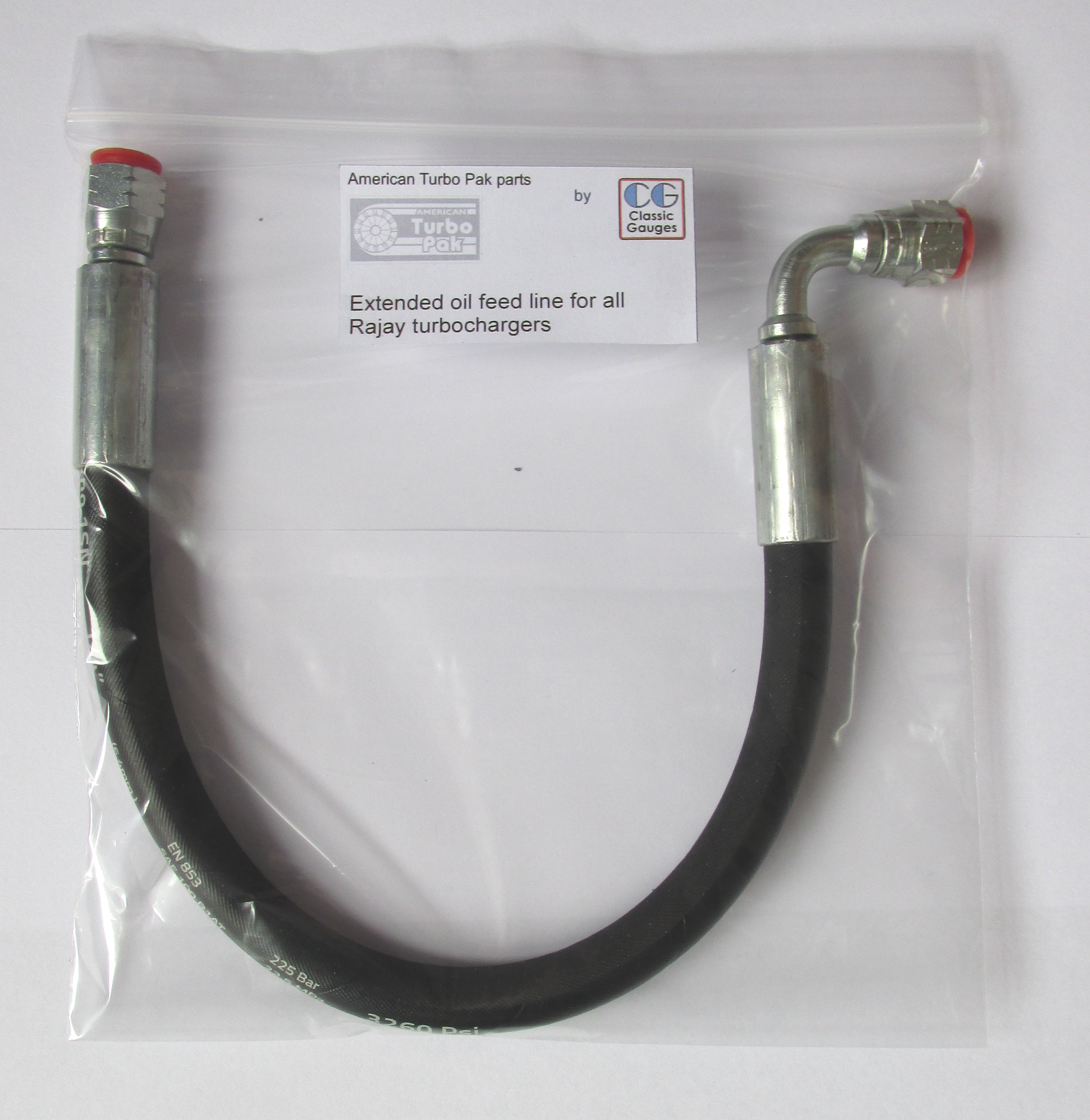

Next job is to sort out spindles , bolts and engine plates , I’d be delighted to send you all the brakes for an overhaul and new lines , I also need the small elbow bend hard pipe that goes in to the turbo as the feed

Garry.L wrote:Loving the paint. Nothing says 70's more than Metal flake. :luv
Yes it has to remain , it’s far from today’s perfect acrylic jobs but it’s genuine and original as S&S wanted it , I think it will polish up well , I never liked it at first but the rest of the bike looked so crap it didn’t help so I think it will come back to life when’s it’s married up to the new looking bling frame, chromework and engine
Re: S&S Silver Saxon #8
#43 PostAuthor: Garry.L » Fri May 24, 2019 6:03 am
Was chatting to my Painter last year when I picked up a Z1R paintset he'd done for me, and he was saying that Metalflaking it's not an easy process to get right. He showed me Jars of the different size's of the flakes which are lay'd on with the colour and if it doesn't go right they can sit proud causing a rough finish.

Yes Ray, I can supply a new extended hose complete with elbow where it feeds into the TOP of the turbo like this. Drop me an email for special price :wink:

on mine ,I use goodridge braided steel hose and fittings like brake hose but larger dash ,also loop the feed pipe under the unit and up the back .so it feeds from the top ,but hang the pipe high above the unit so when you cut the motor you have oil in the pipe still feeding the bearing through gravity feed,also a longer pipe will allow you to connect the pipe up then place the unit in situ on assembly as it can be tricky some times trying to connect the pipe in situ
