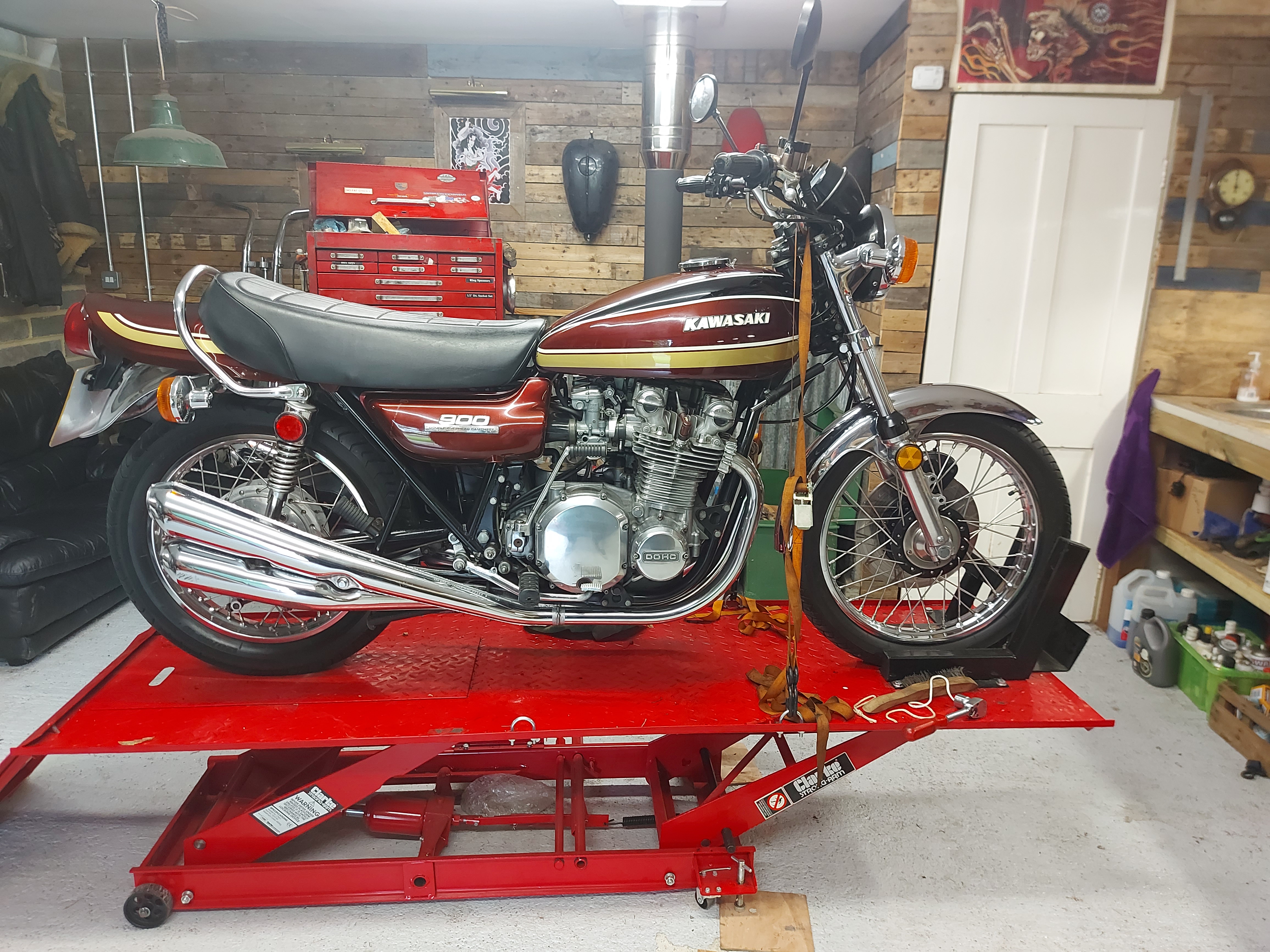

Here it is,
I'm just striping the carbs, are the Keyster kits any good?
Any recommendationd would be great

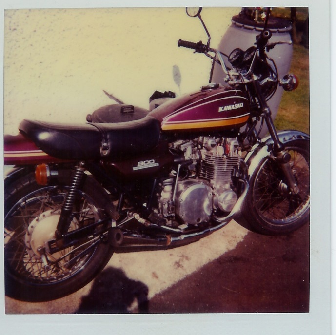

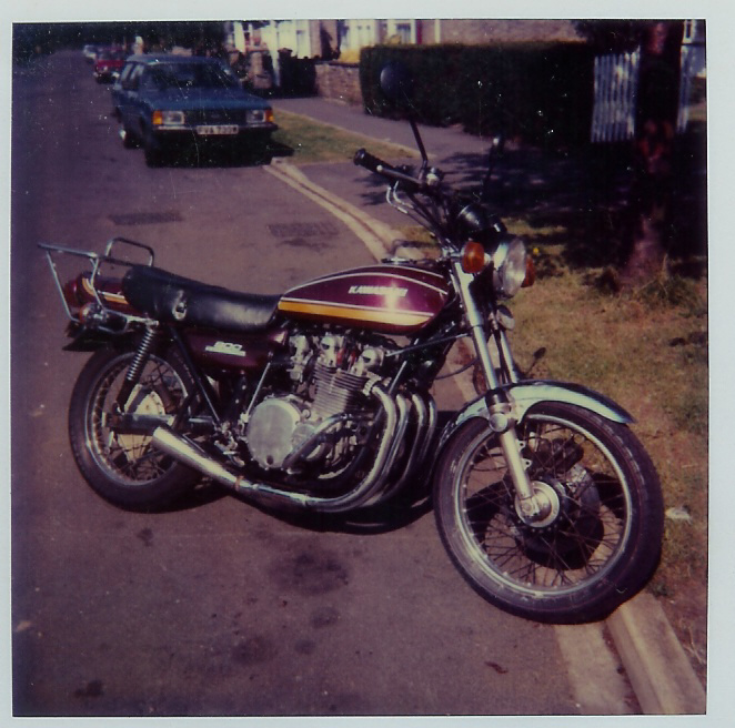

And here's the old one if you want pics :D

Nice looking bike!

Lovely looking bike, get the carbs sorted and enjoy it while the sun is out. If its stood for 8 years it would be worth giving the brakes a good seeing to !

Great looking Zed

If the brass parts on the carbs are in good condition refit them as although the Keyster's are probably the best replacements viz. quality the originals are always best. Also, if not already done get the choke plunger seals replaced or you will be running on choke all the time. PM Rob Meggitt (zed1015) on this forum for top of the line service. I've attached a handy pdf covering carbs which I used when rebuilding my Z1-B, but which unfortunately I cannot cite attribution as I cannot find the author mentioned. If you need any help let me know as I have lots of pics of my rebuild.
Good luck.
