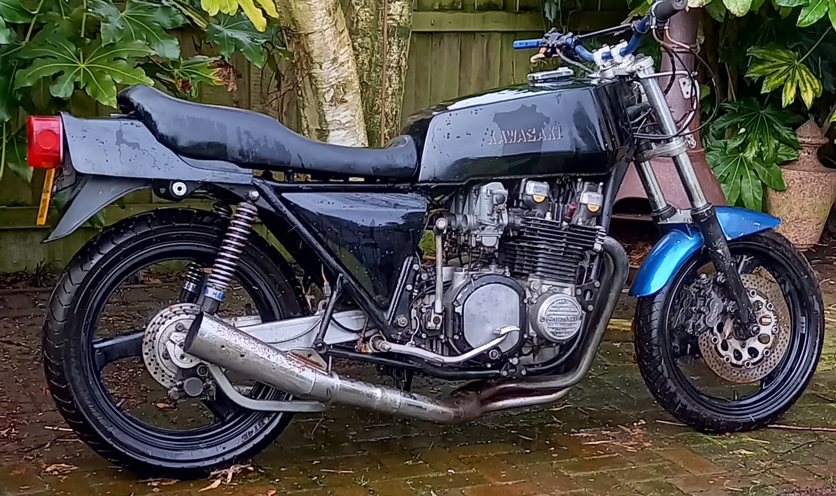

Couldn't find my wax crayons...others taken away coz they've got sharp point....
you wanted a photo...on your head be it!!
it's not pretty, its old, but its mine...
I can hear the clang of dropping jaws from here... :P

Pete,
Well done for posting......no shame there
If you squint just a bit with your eyes nearly tight shut, you can just about make out a showroom condition Z1R D2 in the picture
Good luck putting it back to usable standard, lots of help available from this knowledge bank
Can't wait for your next instalment

don't forget the dark glasses!!
replacement front end in shed...gotta decide on a rear wheel.
Engine has a z1a bottom end with z1r top....apparently makes for better acceleration?
Once the f7 is off the bench this will be going on....eventually!

Welcome pete think that bike looks really cool :vcool

Looks ok to me :) Show Queens are alright if you don't want to ride them

Nowt wrong with that! Blank canvas to make it whatever you want it to be! Just make sure you post pictures of your progress!

Hi Pete
thanks for putting a picture on here!
Waw, it's quite amazing what you have there. I recognize some Z1R parts and a whole lot of parts coming from more recent bikes.
If the bottom of the engine is a Z1a and the top is from a Z1R D2 or D3 I hope you used the correct camshafts or at least the correct sprockets.
The cranckshaft of a Z1a has 15 teeth for the camchain, the camshaft sprockets have 30 teeth each, the camchain has 122 links. The cranckshaft of a Z1R D2 or D3 has 16 teeth, the camshaft sprockets have 32 teeth and the camchain has 124 links.
Don't mix those up !
Anyway, I'm sure you know what you're doing.
Good luck with the bike!

Thanks for the comments guys...appreciated.
Philippe...the engine was already built when I bought the bike about 25 years ago and was/is really really strong.
I'll keep a note of your numbers just in case I've got to do a teardown. thank you.
got a zx9 front end for it to replace the rgv250/bandit bits. Just got to have a think about the back end.
Happy days!

Thanks for posting. Nothing to be ashamed of, looks like a decent basis.
Will look forward to your progress.
