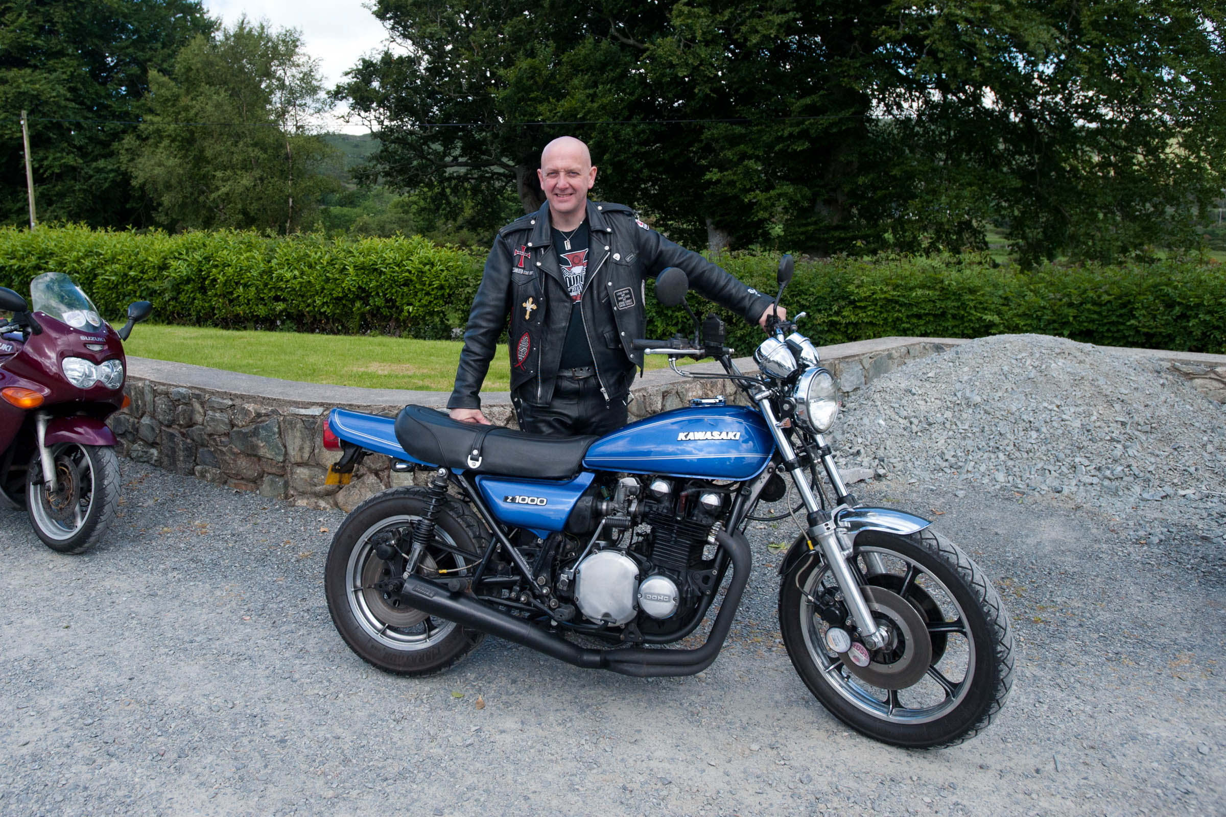

If you’re not fused about originality an LTD can be made to look pretty much exactly like a non LTD. The main differences the tank, seat and back wheel. They do tend to be cheaper as all the money’s in “originality” but the LTD styling doesn’t lend itself to that, although I have seen a quite few nice standard LTDs people don’t generally like them.
As Mark said the Z900 has a different rear brake but the Z1000 setup is the same
This one belonged to a member on here called Stevie, I don’t know where it is now he sold it on, apart from the back wheel you’d have been pushed to tell what it was when you saw it on the road.

i totally agree chris..they're great bikes in their own right, but can be tailored to your needs like anything else.. steve (above) still kept the 16 on the back n headlight brackets n the bike looks great.
