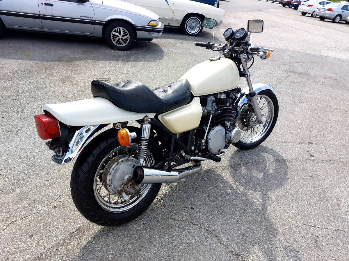

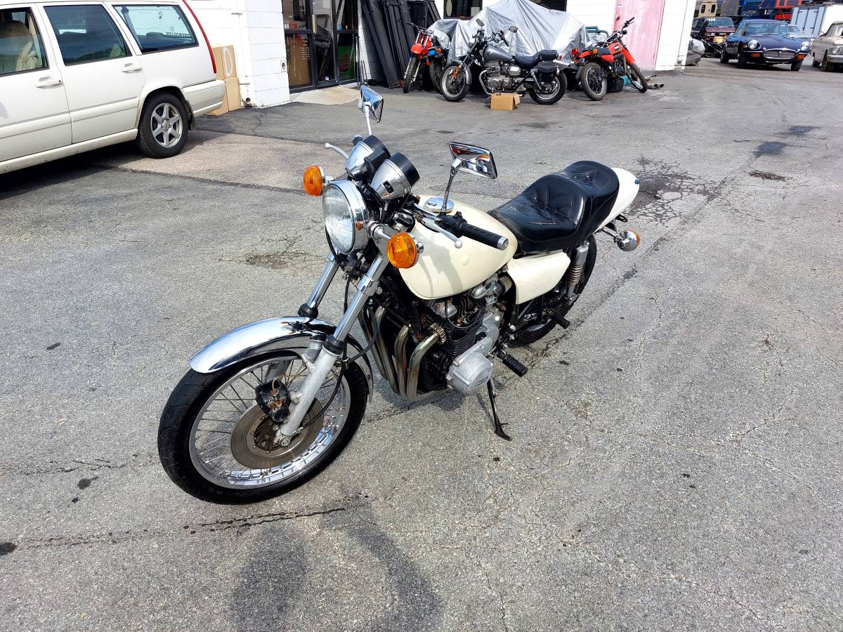

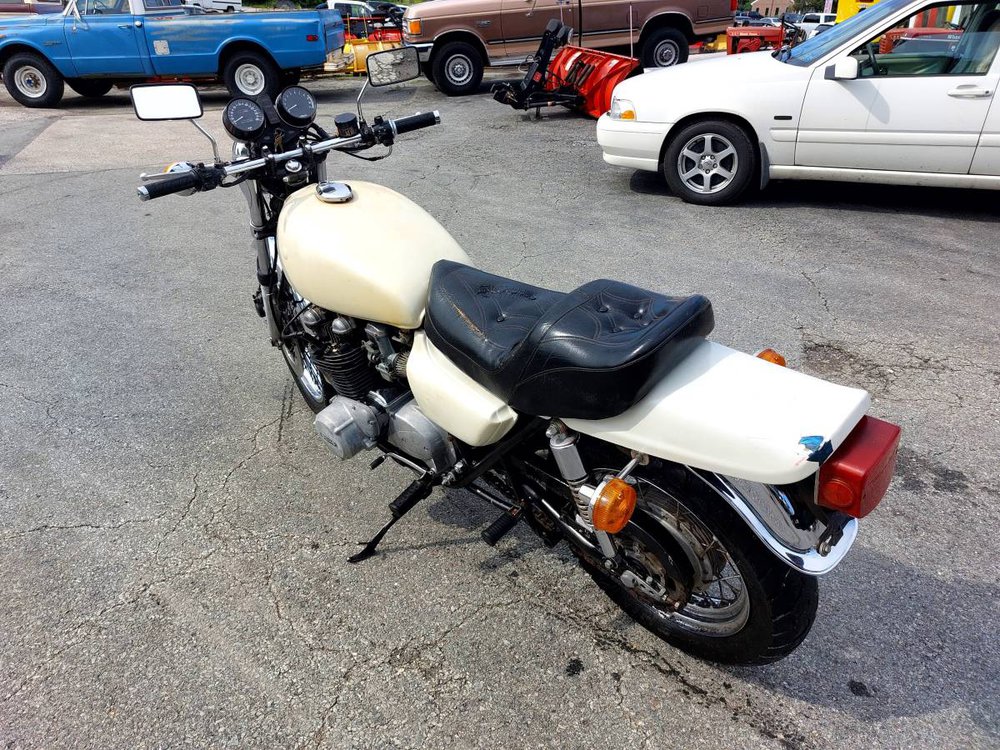

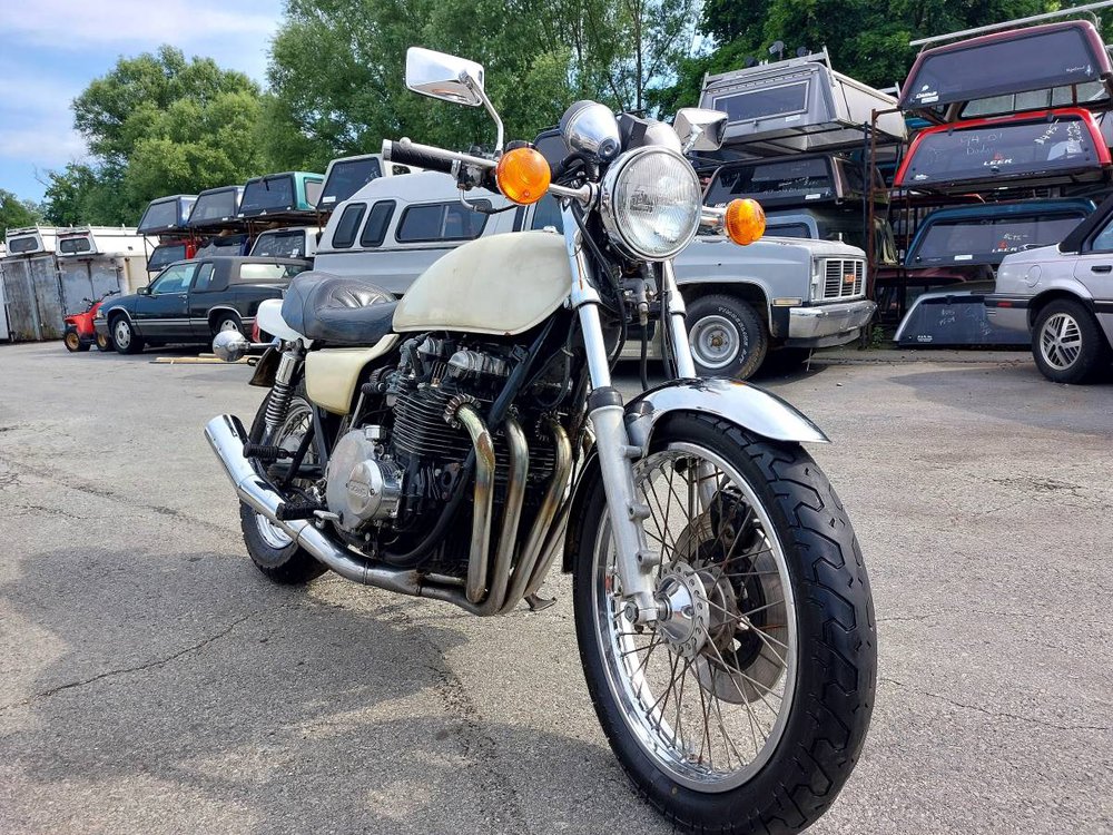

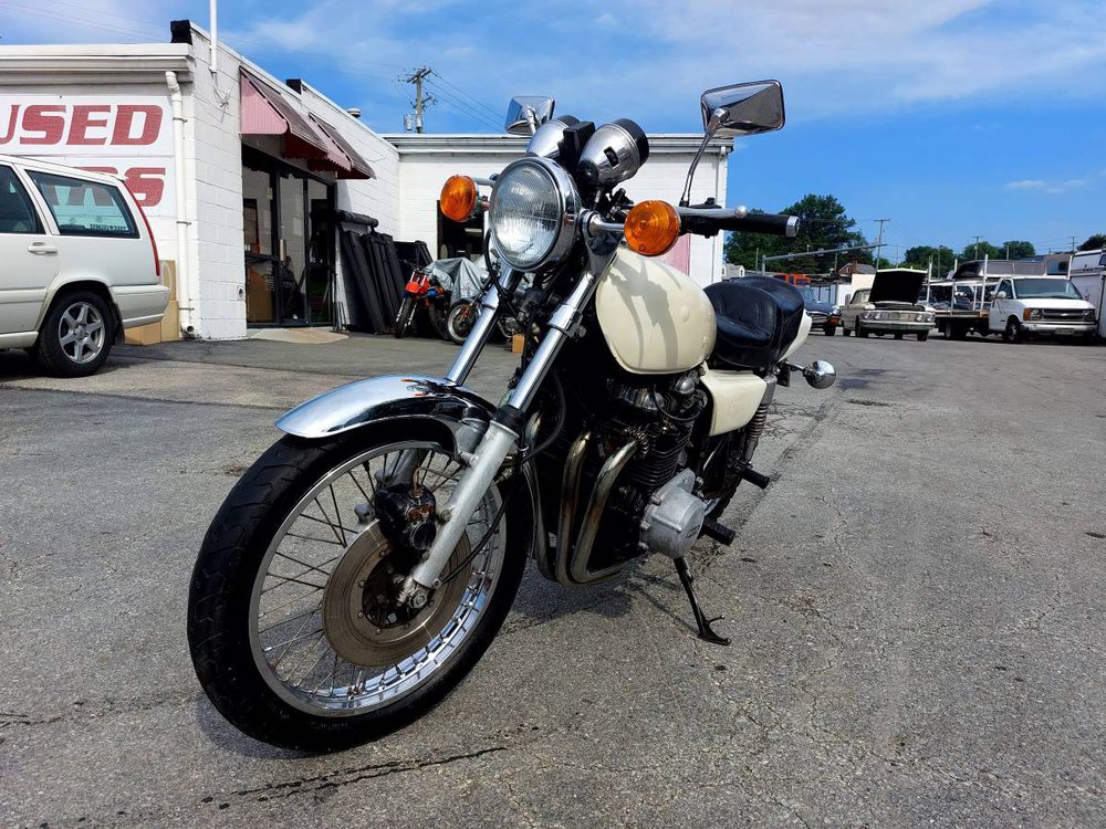

Few more pictures

That looks like a tidy bike mate.
Just sticking my neb in again....the engine numbers starting z1e-1***** are, I believe, B1 Ltd.
It's 45 years old so no great shakes...it's a survivor!

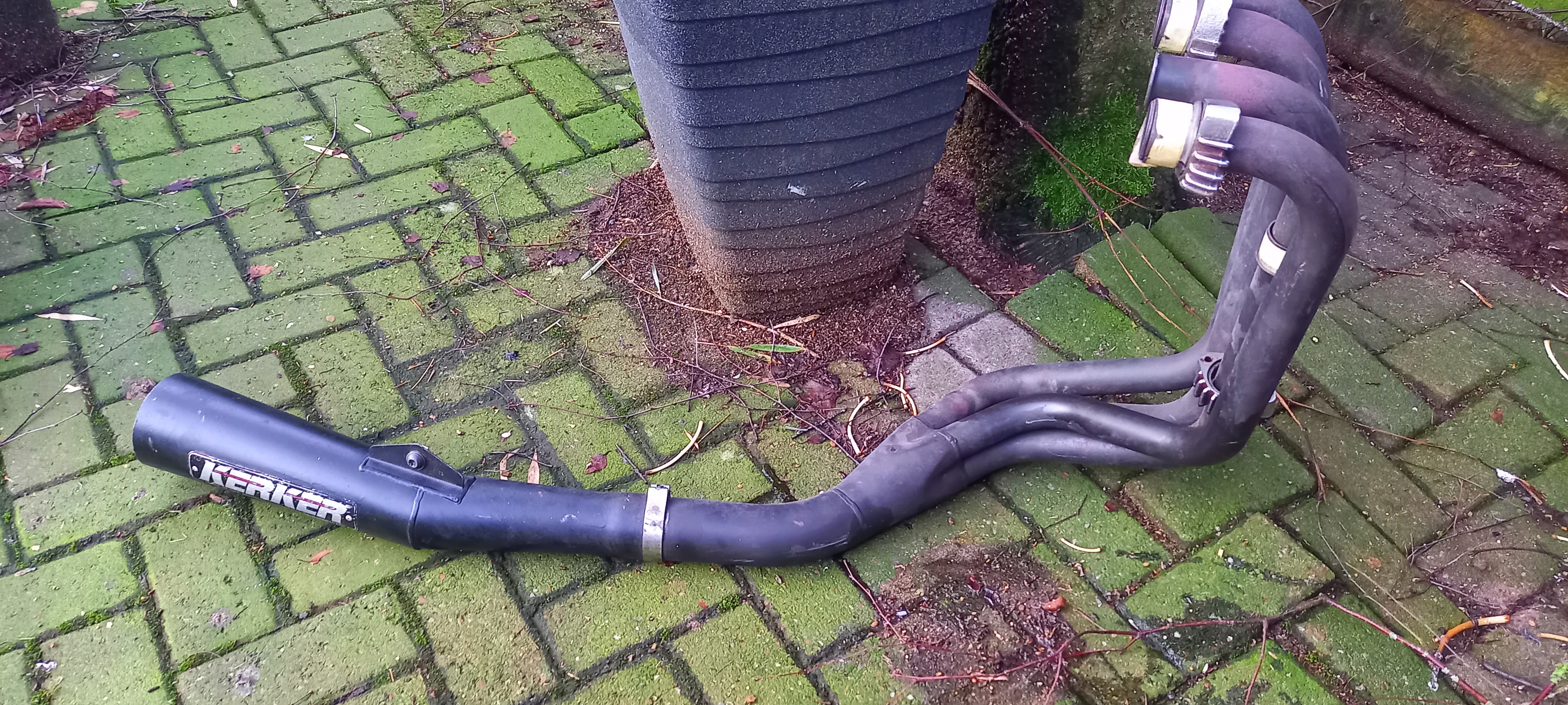

The exhaust looks more like, as Gray said earlier, a Delkevic.....the pipe bracket is nearer the front peg, the Kerker has the bracket on top and closer to the original exhaust mount.
Enjoy it when you get it and have a good think what you're going to do......ride as is or complete resto......it's yours, do whatever you want
Enjoy!
Re: Just bought this
Peteypops23 wrote::D
The Delkevic and Kerker headers are a very similar shape the collector is even the same diameter - my Kerker megaphone fits one perfectly, but the Delkevic has a lot more springs and the header pipes aren’t welded into the collector. Some of the Kerker megaphones do have a bracket underneath not on top. The Delkevic megaphone is a completely different shape to the Kerker.

No worries Chris, I was just comparing it to the three kerkers in the shed.
Every day is a schoolday.

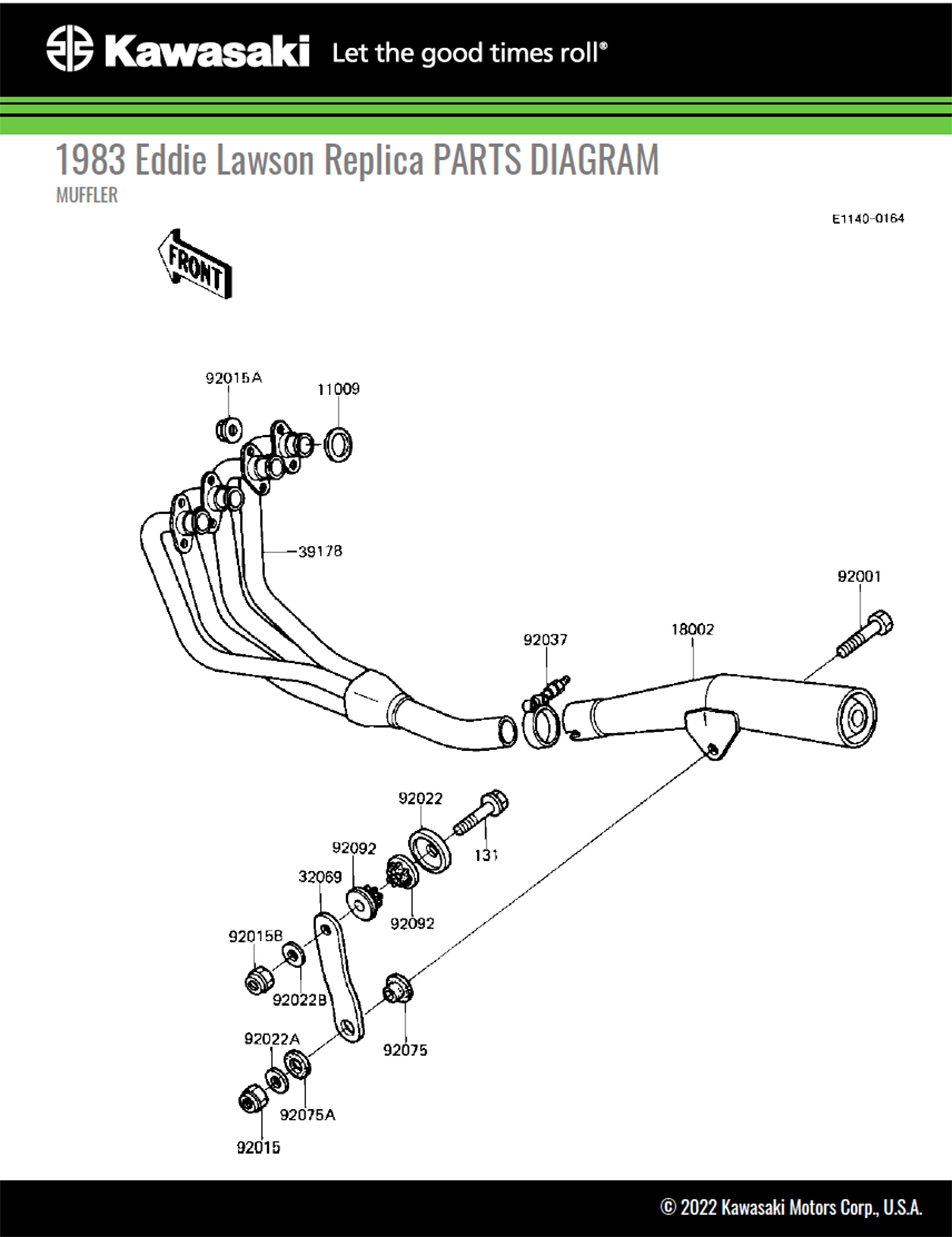

I only know because I've got some Delkevic headers AND a Kerker in the shed...
Most of the Kerkers do have a top mount but the Lawson ones (and possibly some others) are underneath
