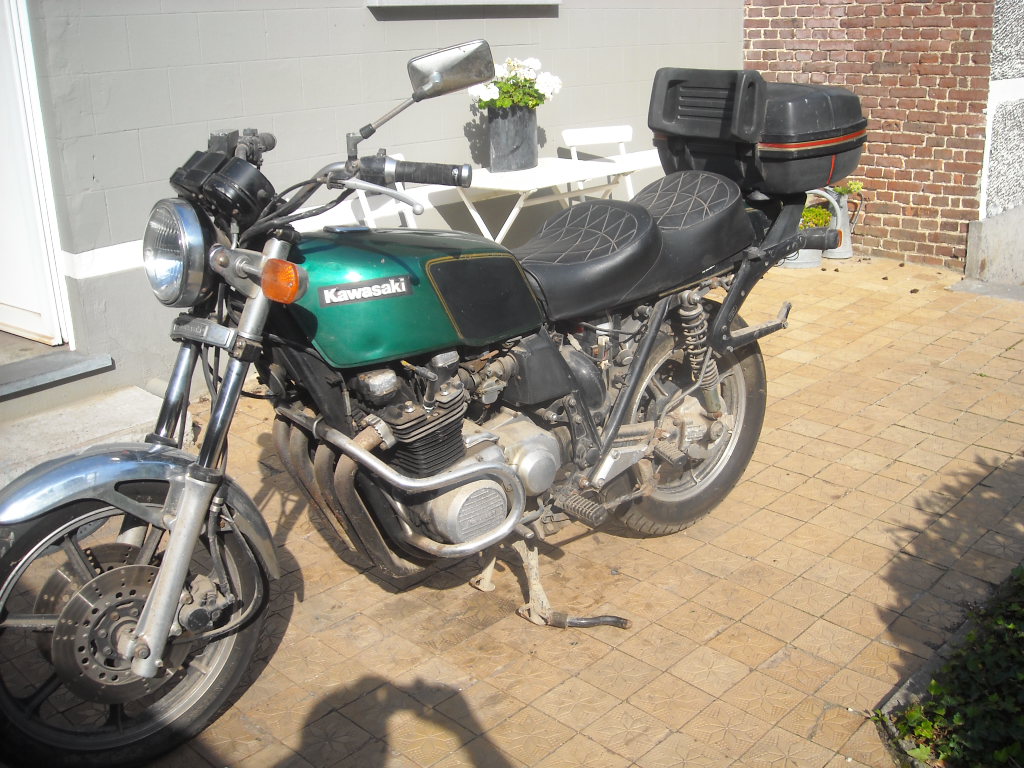

yes I've started the restoration of another Z1000ST E1 (1979).
I bought her in the summer of 2020 and now it's time to restore her.
The "old lady" stood about 14 years in a garage and was dusty and rusty when I found her. She ran about 75,000 Km and a lot of parts are missing.
Just to freshen up your mind:

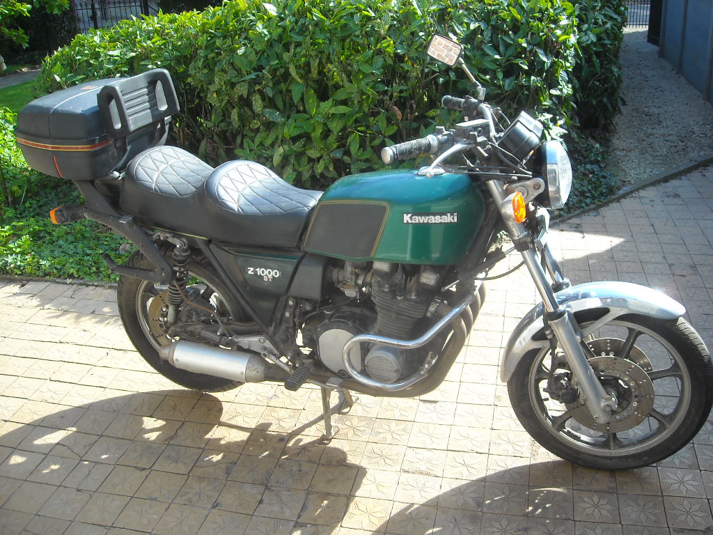

Last summer: the arrival
the other side
At first glance she doesn't look too bad but when you take a closer look...
A terrible exhaust, a frightening "King and Queen buddyseat", mud allover the frame and engine, an oversized crashbar and a top case coming right out of a horror movie. :D I exeggerate, the accessories are vintage, they come out of the eighties and nineties, they were normal then but now they have to go.

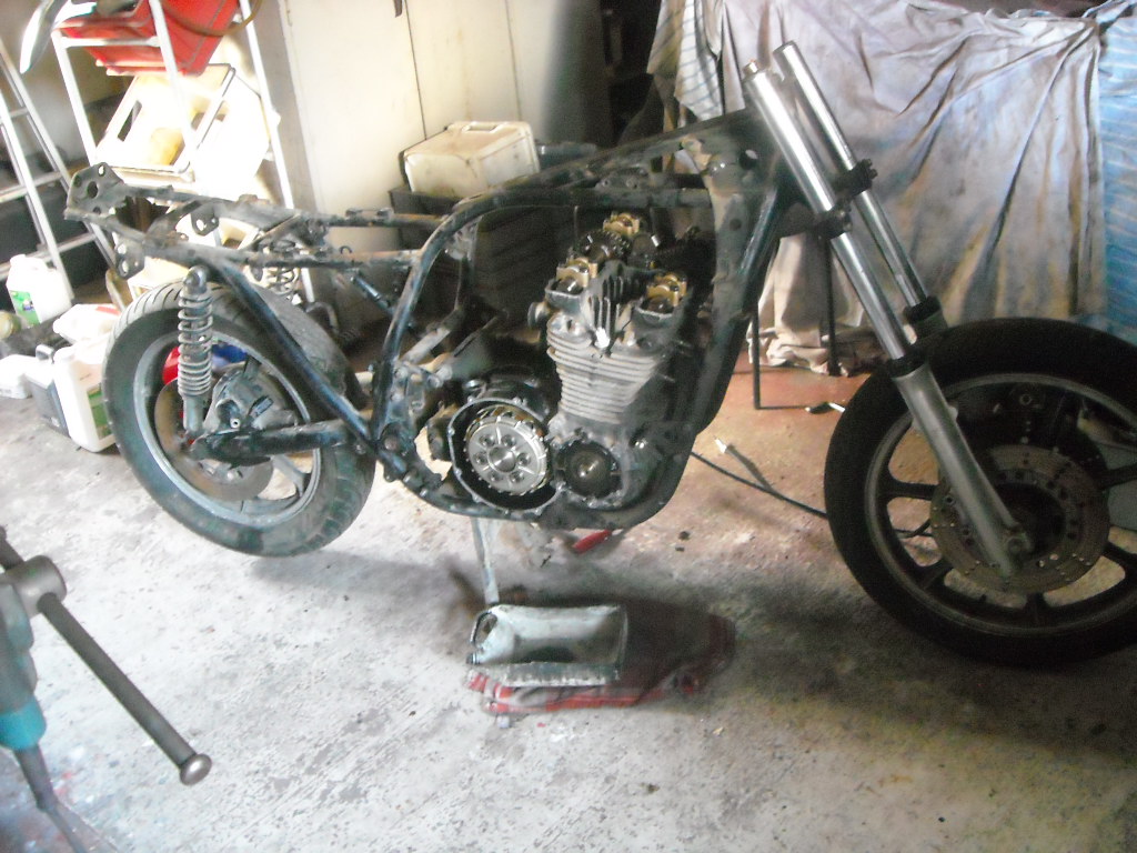

Just a few pictures during disassembly
a few weeks ago
taken apart...

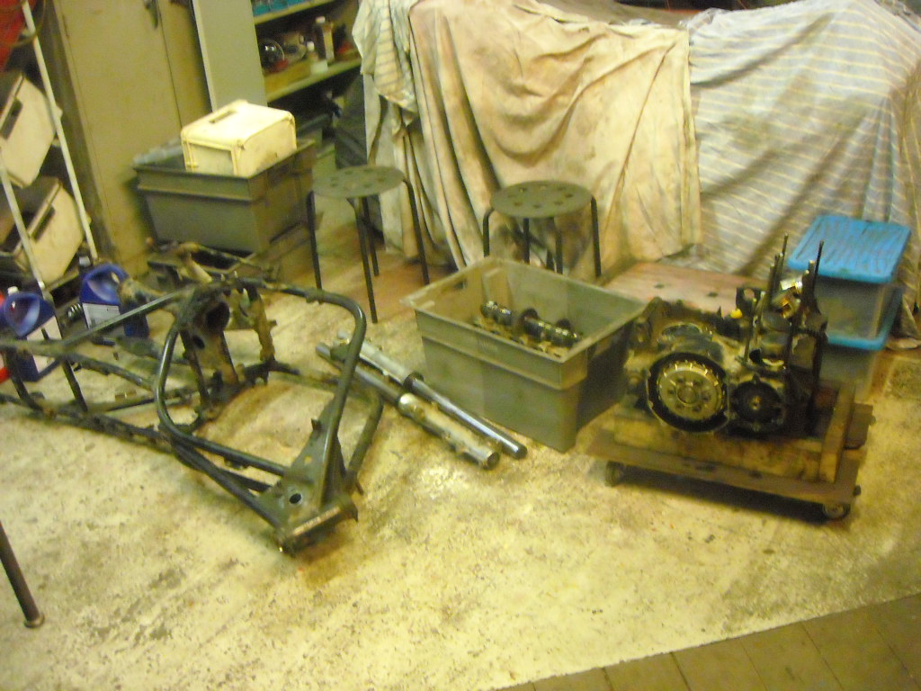

The bike is completely taken apart, the frame is repaired, the old paint and rust removed and I gave it a fresh coat of black paint today.

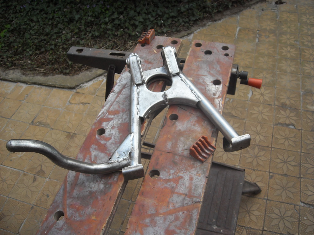

Have a look at the main stand:
we all know how dirty, greasy and rusty those can be, don't we?

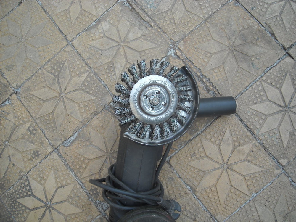

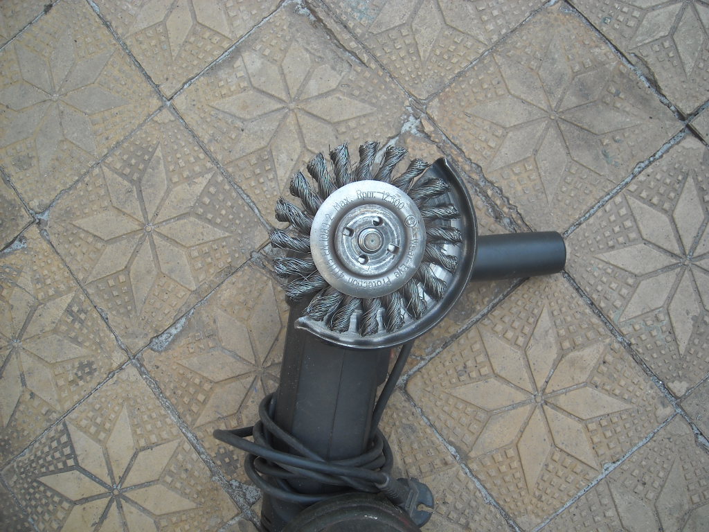

I start with degreasing the part, then I use the steel brush on the angular grinder to remove most of the rust and the old paint.
the grinder with the steel brush

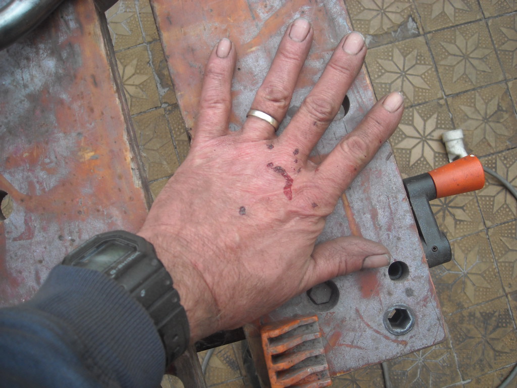

When using this device PLEASE use protective eye goggles.
Just look at my hand after I cleaned up the part, I can't work with gloves...but just imagine what a piece of hard steel wire can do with your eyes...
each little spot is a little wound caused by a little steel wire.
It only hurts a bit and it cures very fast, after all it's just a little wound.

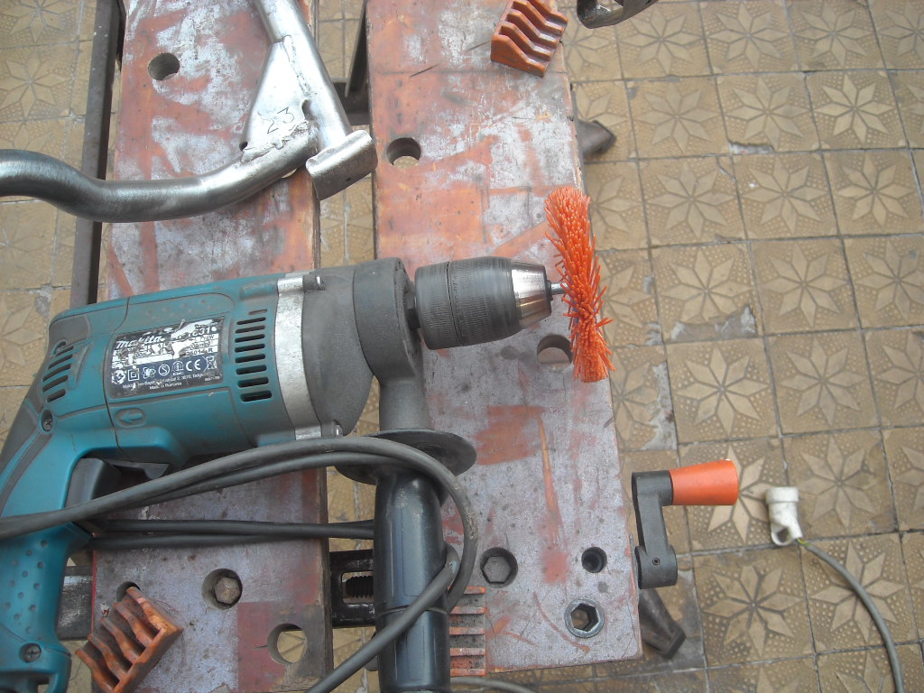

Then I use a red nylon brush on a drill
the red nylon brush
the main stand after cleaning
This is the result after 30 minutes, it's not completely clean but we're allmost there.

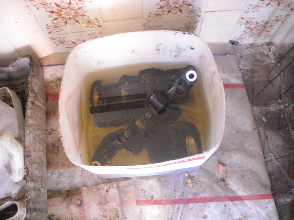

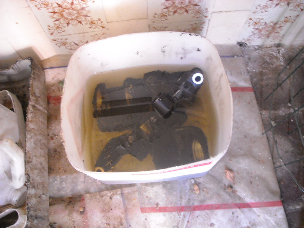

For smaller parts I use formic acid. Also a very dangerous product !!!!
Formic acid
some smaller parts
When using it wear protective gloves, they must be acidproof !!!
Wear protective goggles and do it outside, the vapours are harmfull. I place the parts in the old toilet...nobody uses it anymore so...
The formic acid doesn't affect metals, you can put aluminium, steel, copper in the acid to remove the old paint.
After one day I take the parts out and I clean them with hot water and a bit of soap.
The acid doesn't remove rust so the job is only partially done.

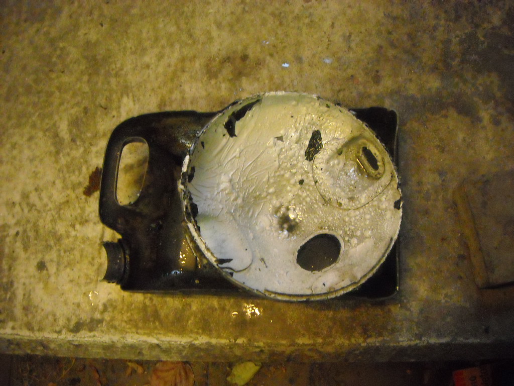

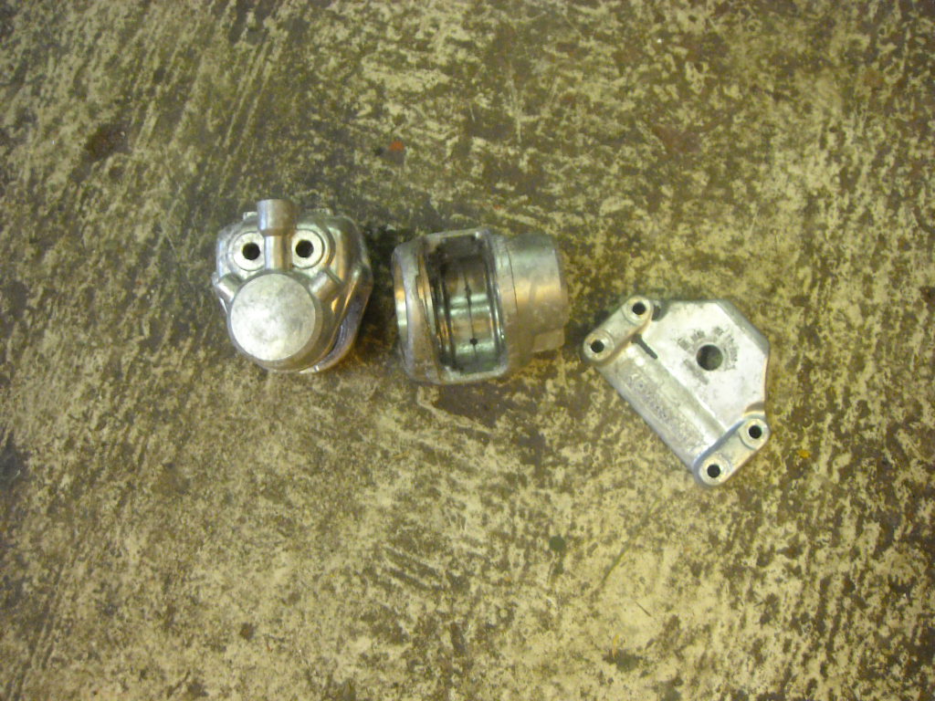

Remember the ant acid ? You know how hard it is to remve the paint from brake calipers?
Just have a look;
after the bath
and this is how they are after 10 minutes of treatment with a blue nylon brush
after the "brushing"
Now these are aluminium parts.

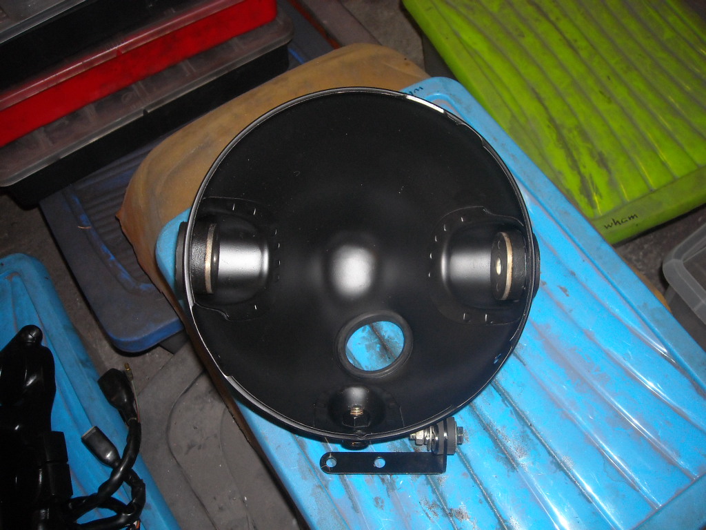

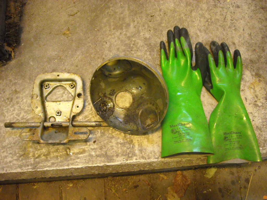

The steel parts come out allmost the same, have a look;
the headlamp shell
After the rinsement with water.
after the water
This is how the headlamp shell is now:
actual state
It's painted and ready for installation.

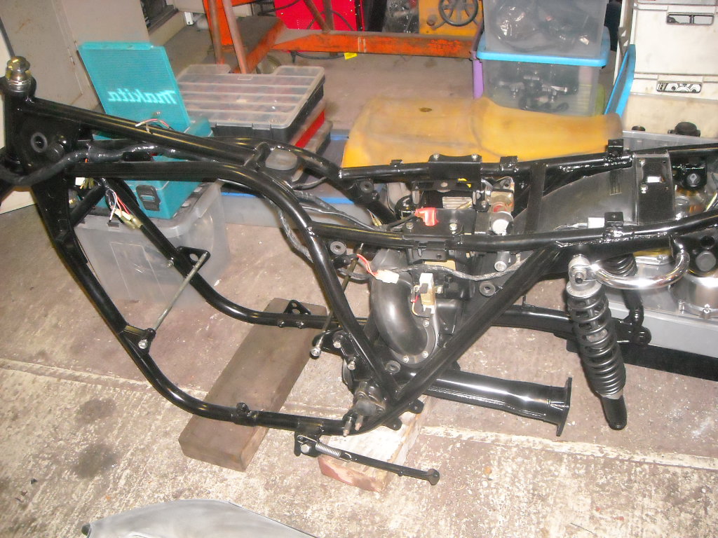

I managed to paint the frame and the main frameparts.
I couldn't resist to start the assembly, "boys and their toys" you know !
the frame

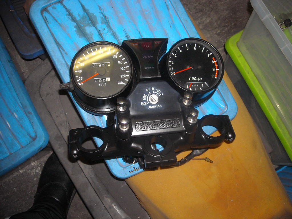

I assembled some more parts:
the "cockpit"

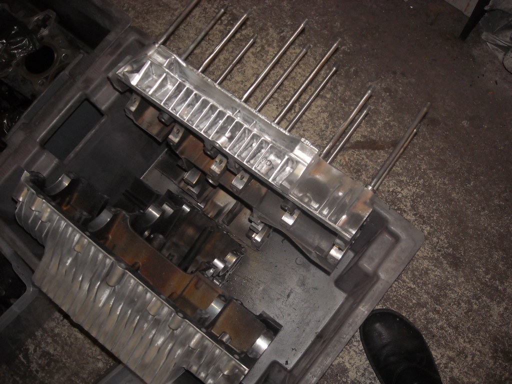

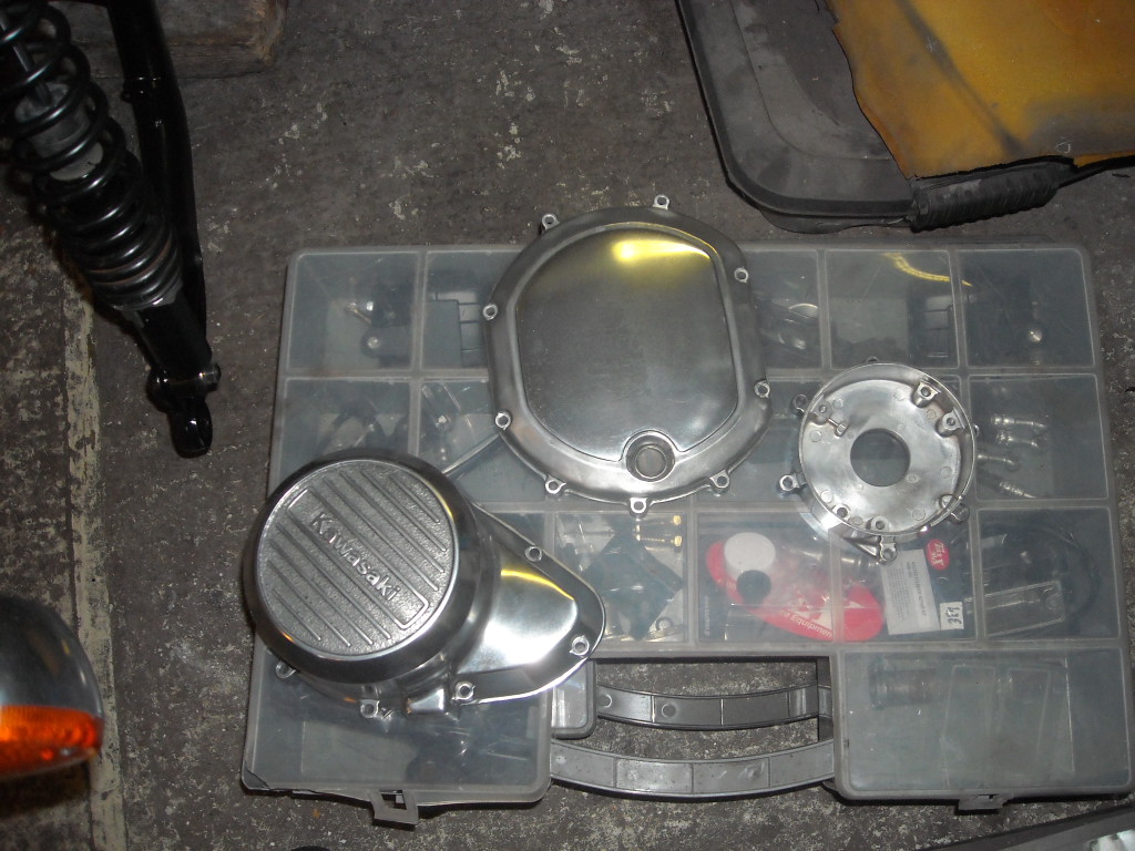

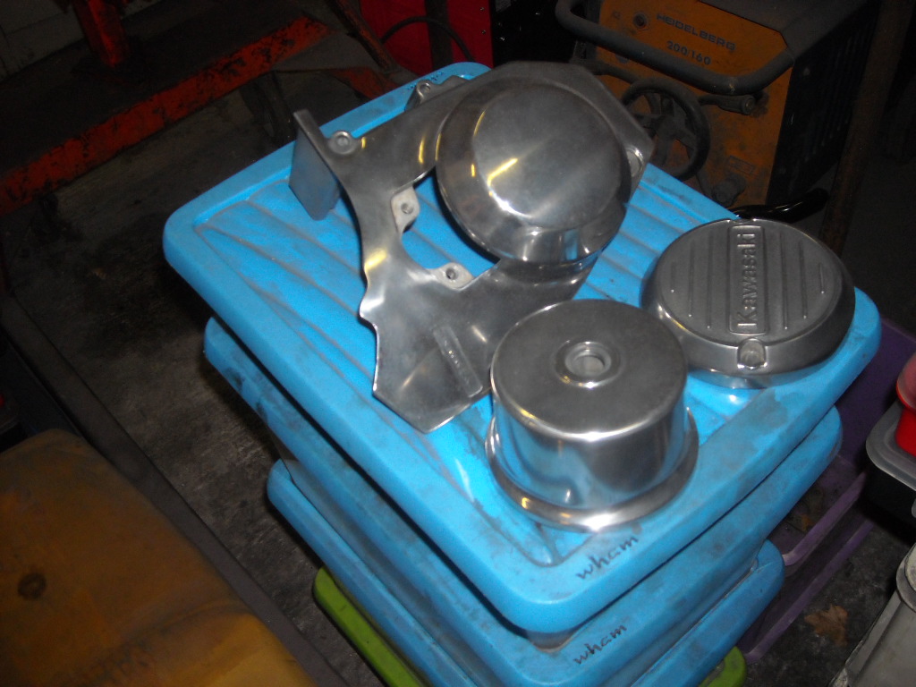

The engine is now having the "red nylon brush treatment" before painting.
the cranckcases

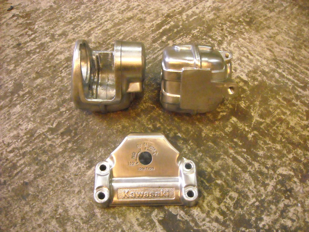

The alloy enginecovers are partially polished. Some need black paint and a clear coat, other only a clear coat.

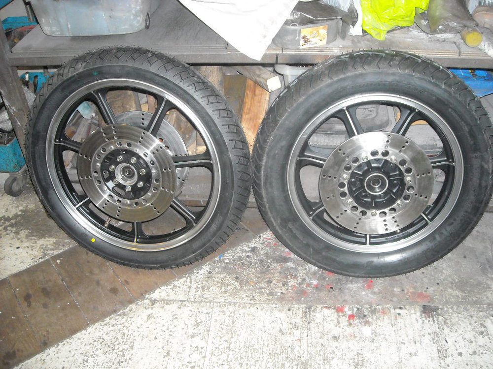

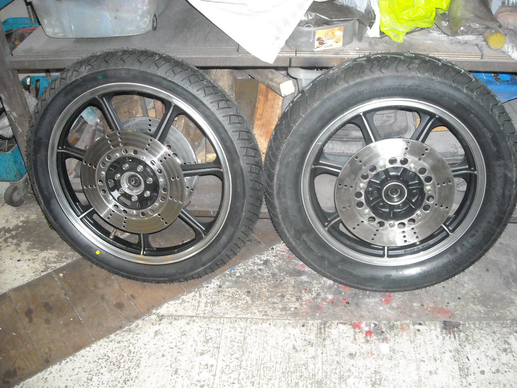

the tyres arrived yesterday: Bridgestone Battlax BT46 brand new .
I mounted them immediately, which went very good and then I mounted the disc rotors.
Both wheels are ready to be fitted, they received new ball bearings just after the new paint cured.
Here's the result:

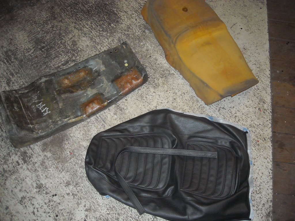

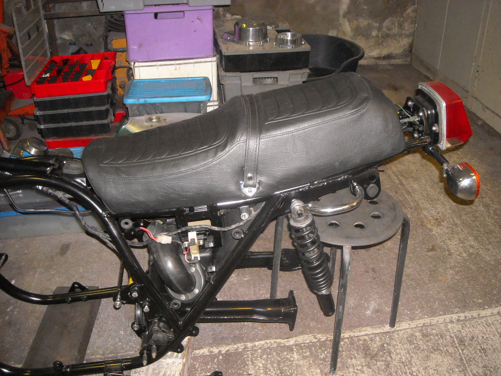

I didn't had a decent metal seat pan because they are often rotten but there was a King and Queen buddyseat on the bike when I bought it...
The glassfiber reinforced resin seat pan was OK so I removed the old foam and cover. I had decent foam from an old ST seat and with the new seat cover I was going to make a decent ST seat.
the parts

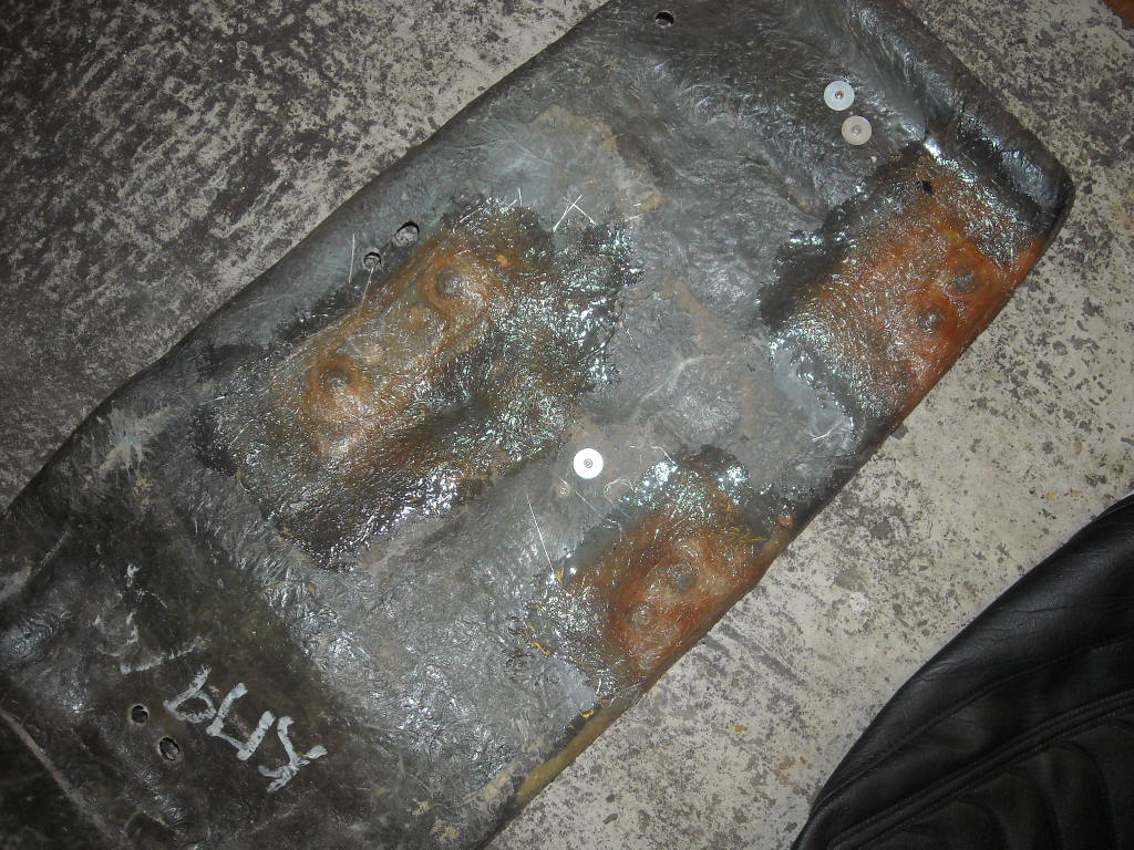

I cutted out the metal parts of an old seat pan and attached them to the polyester seat pan, some with rivets, other parts with resin and glass fiber cloth. The metal parts were derusted and treated with a zincprimer to prevent them rusting again.
This is how it looks
the metal parts attached with resin

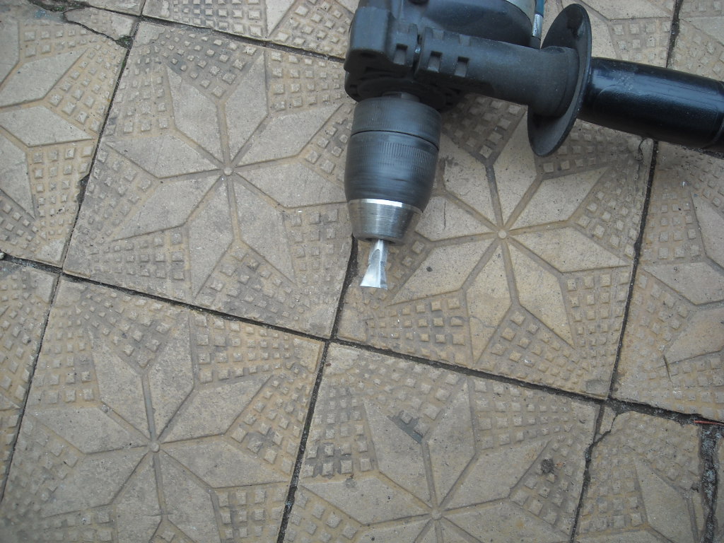

Because the resin seat base is thicker than the metal seat base I had to do some work before I could attach the seat rubbers.
It's important that these rubbers are in place because, together with the hinges, they support the seat once installed on the bike

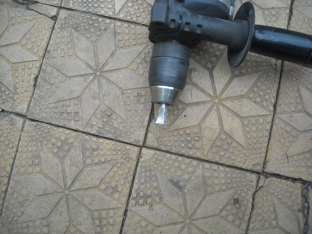

I used a chisel of a surface milling machine in a drill to thin the resin down.
this is the chisel

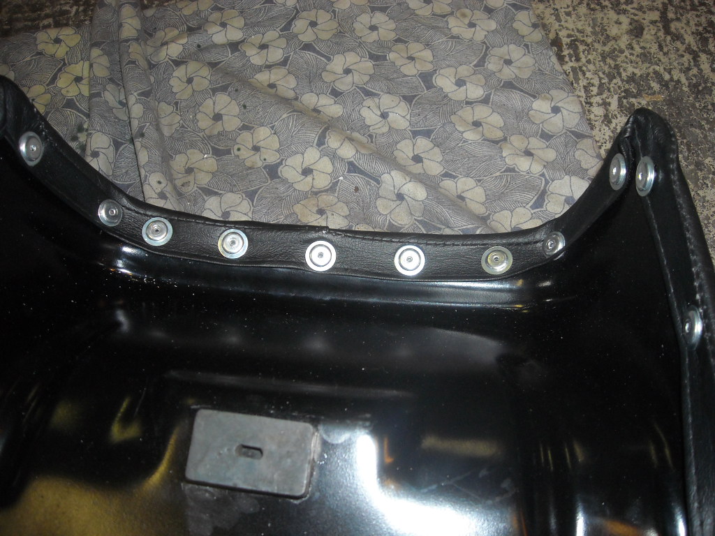

I was able to attach the rubbers and then it was time to drill a lot of holes in the seat pan in order to attach the set cover to the seat pan.
I used rivets to secure the cover, you could say I'm a official rivet counter now :D
This is how it looks on the underside of the seat
counting rivetts...
And this is the final result:
the result
A decent looking and usable ST seat.
