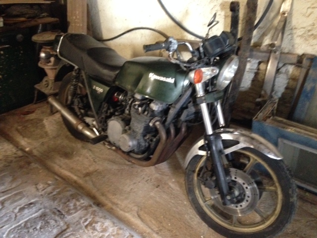

I've been away from bikes since moving to France in 2005 (I'm not counting my TY250 twin shock that's in the barn). I've had various bikes over the years, a couple of z250's, 350LC, a Zephyr 550 and an 11, the final one being a Bird. I've been looking for an older steel beast for a while and have just bought a Z100ST. It's not been started for 10 years so there is a bit of work to be done. Apparently it was in running condition when taken off the road. The chap stopped riding it because it was too heavy and held on to it hoping his grandson would like it. He showed no interest so it went up for sale.
Not knowing a lot about the Z1000 range I've no idea how original it is?
Good points are that it seems to be complete, bad points...
The tank has rust holes, the seat base is cracked and it has a Marving 4 into 1 exhaust. All the brakes are seized, fork seals gone and the wiring loom has been 'modified'. The brakes and forks are to be expected, so no real issue there.
I didn't turn over on the button, had no spark on the kick and the lights came on as soon as a battery was connected?
After cleaning the switch gear the starter works and after refitting the regulator (the 3 yellow alternator wires and a brown were connected directly to the positive???) and giving it an earth it sparked.
I put a bit of 2 stroke oil down each pot and turned it over a few times, then connected up a lawn mower fuel tank and.......the beast lives.
So the immediate jobs are:
Oil change, brakes, clean the carbs, fork seals, see if I can save the tank, and try and do something with the seat. I'm working off a downloaded wiring diagram, a Z650 manual and my limited knowledge at present but would like to source a Kwak workshop manual. If anyone knows of a PDF manual, that would help a lot.
