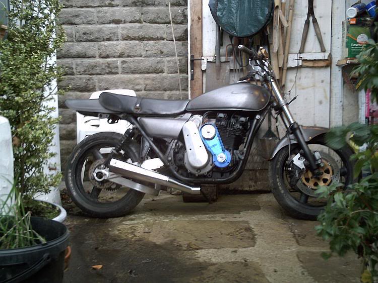

I was suprised to find this pic of the Drouin Zed today on the OSP site. This is as i bought it and the pic that was on evil bay. If you look close you can see the only thing holding it together is the shed door. A true abomination of which only the Blower and fuel tank remain.

I've gone through the previous posts, but can't find anything on it's history.
Can you shed any light? I'm sure there must a story there.
Posts: 4034
#95 PostAuthor: zed1015 » Fri Mar 06, 2009 12:22 am
Would like to know more myself. All i know is that the bike was a loosely cobbled together pile of bits with no log book and could never have turned a wheel like this. jmc arm had no adjusters, wheels were 18in magnesium marvics off a J gixer , forks were suzuki but just holding frame off the ground coz the stem wasn't long enough, v&h megaphone just hanging there, 'new' rear shock mounts were rusty bolts just bird sh*t welded on, engine was empty set of broken cases , no internals, scrap head, angle iron L/H engine mounts etc ,etc. A real mess . Do know the blue mallory magneto was off that MAD COW 1000J with the z1r tank that was featured in SF a few years ago which was built by BIG FOUR ENGINEERING. And their shop ( before they shut ) had not been too many miles from where i bought the bike in castleton. So i would think the guy had got hold of a load of stuff from Big Four when they shut and tried to do something with it (unsucessfully). I only bought it for the Drouin and would really like to find the history of this as it had the plenum fitted with four big old nitrous injectors + another in the intake,The manifold has been adapted to take a Mr Turbo keihin pumper (now fitted) or SS super b and had a massive metanol jet fitted you could put your arm down.

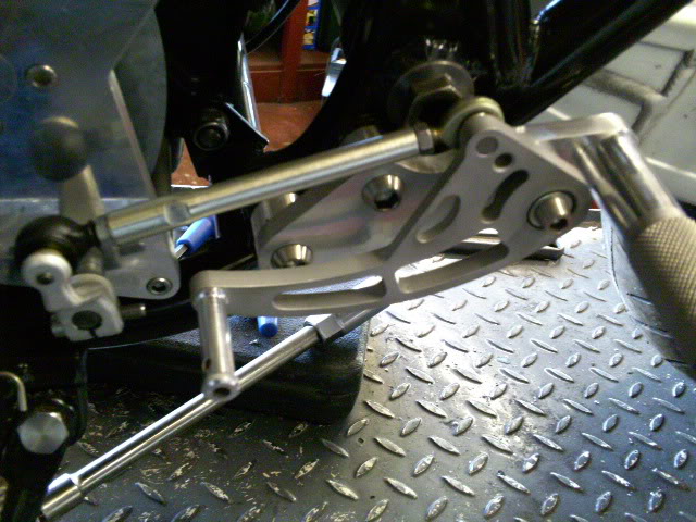

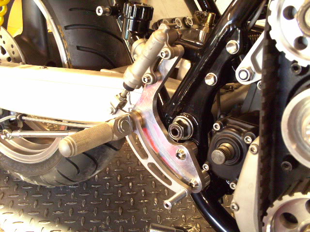

Bought these "yoshi" rearsets off Evil Bay a while back with the intention of keeping it simple and just making up some brackets and fitting them. When they arrived they were no more japanese than i am. They were anodised a lovely sh*t brown and the adjustable link rod had right hand threaded rose joints at each end and thats the best bits ,Should have expected it though for £40 delivered.
Ended up blasting the anodising off and used only the levers and knurled pegs and made new mounting plates and toe ends. On the r/h side i added a hinge and spring detent to hold the peg out of the way of the kickstart and replaced the cheapo pivot bearing with a bronze bush, i also flipped the lever upsidedown so i could get a straight run for the linkage to the brake master cylinder.
PICT0073 (1).jpg (133.29 KiB) Viewed 4932 times
On the l/h side i discovered that the lever was too short to get my size 10's under for changing up so i had to mount it forward on it's own pivot then extend the footpeg to match the other side.Luckily i had a nice ally Yam R1 or R6 gearlinkage that fitted the Zed's splines and had a l/h threaded rose joint on so all i had to do was cut the rod to length and re-tap the cut end to take the r/h joint. A lot of mucking about for what should have been a simple bolt on job.
PICT0068 (1).jpg (115.55 KiB) Viewed 4932 times
