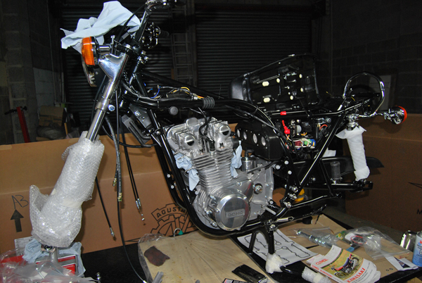

December week 2 update
A busy week of stocktaking at work didn't leave much Zed time.

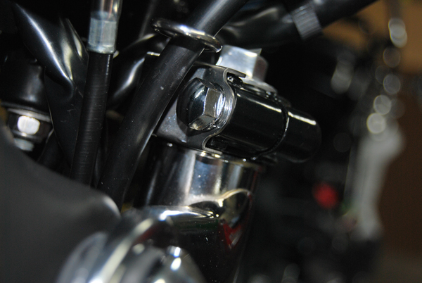

Received the new top yoke bolt from Z1 Enterprises so got that fitted, the lower yoke bolts and engine bolt kit arrived from Saisei and will be fitted next weekend.
Originals are being put away for re-chroming at a later date.

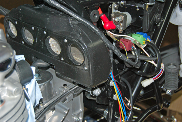

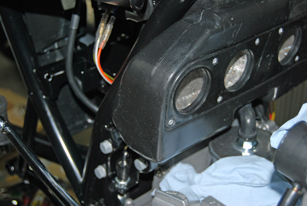

Tried the hot Linsead oil trick on the airbox - worked well.
Tried the hot air gun on the airbox - worked not so well!
The plastic reacted badly, gentle heat made no difference, a more aggressive heat made the box instantly distort - not all of which could be corrected after frantic re-shaping - the rest I had not f**ked was treated to hot Linsead oil!
Lesson learned!

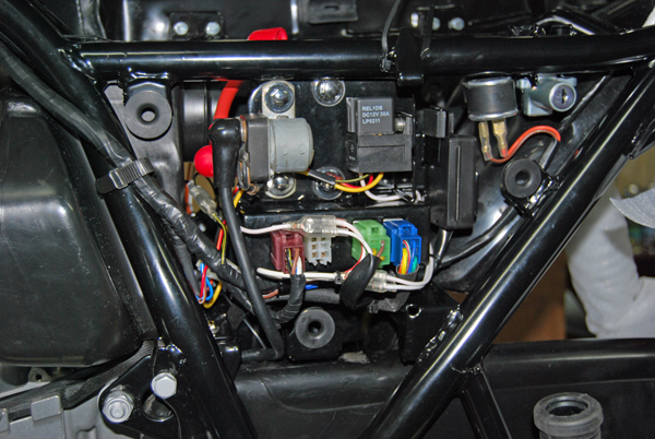

In the week I received the last of the electrical stuff from Z1 Enterprises.

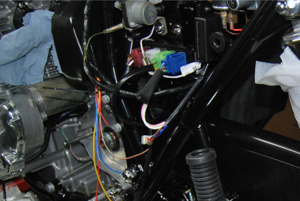

It was time to tackle the last of the loom mods.
Despite numerous interruptions in play - mods are finished.
George mod has been hard wired and the relay sits neatly in the elec panel - fused power has been taken from the battery via the fuse box, battery negative was added to the loom during build - the original coil feed from the stop switch feeds the trigger on the relay - live feed to the coils was again built into the loom during build.
Extra security has been tried and tested.
Good to go.

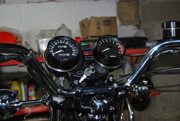

The stainless steel cable tidies looked a tad drab, I used some autosol and a buffing wheel on the bench grinder to polish them up a bit.
Much better.

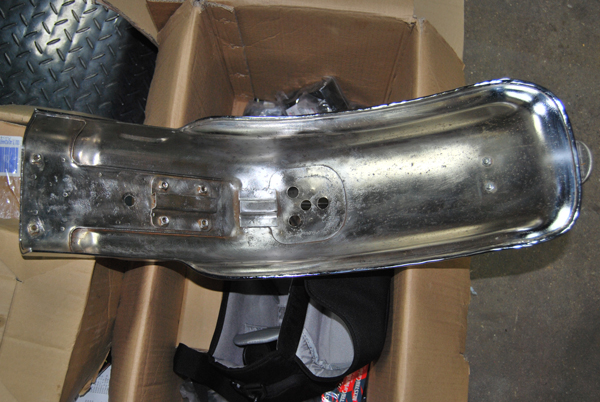

Rear mudguard was pretty rusty inside so I nailed it to the bench (not literally) and attacked it with various sorts of wire brush, it's hard to get into the nooks and crannies - heavy masking and a spell in the blaster me thinks...
Good to go.

December week 3 update.
At the start of week 3 things are looking good, lack of time has slowed progress, lack of parts and lack of parts coming back from chroming even more so.
Didn't manage to get round to tyres or getting the wheels checked either

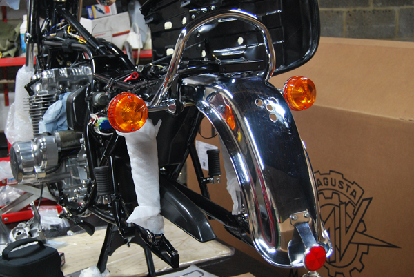

It was bloody freezing in the garage in the week but I still managed to get the mudguard on, stainless bolts and washers.
Had a few issues with the mounting rubbers - the part numbers on the parts list are American - they didn't fit!
Used the ones listed for the Z1 - fitted a treat!
The stone chip wouldn't stick to the zinc so Its gone on without it.

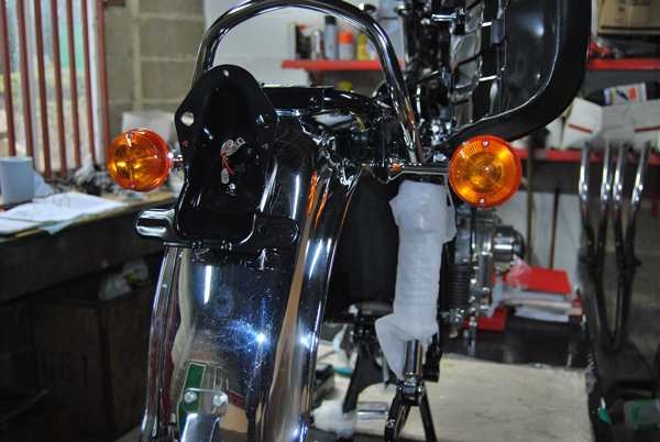

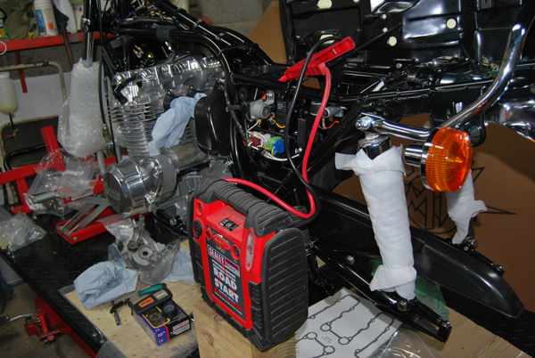

Scored a Lamp Holder on flea bay - a coat of paint and it was on - rear pattern wiring loom in - pattern indicators now with genuine shafts (flea bay again) got hooked up.
Was too much to resist hooking up a slave battery and turning on!
All went well - no issues - coil relay worked as expected - starter motor span the motor over strongly.

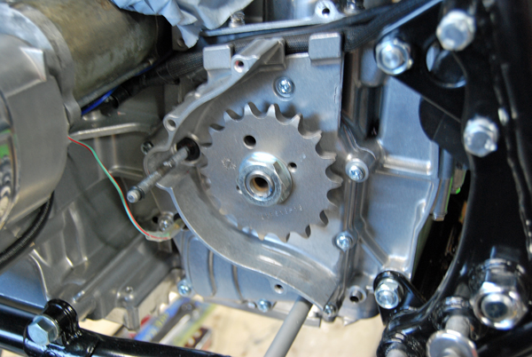

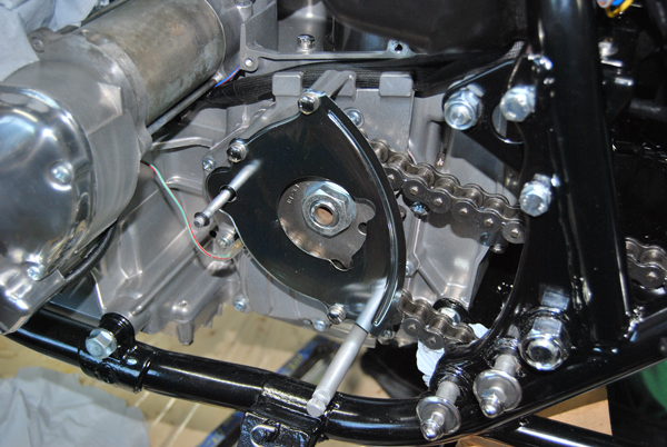

530 Chain + sprockets arrived from Dave, made a start on fitting.
I measured the inside edge of the front sprocket with the supplied 1.5mm spacer to the case - it measured the same as the standard 630 sprocket.
Shame the sprocket cover won't be seen, Mikeys zinc plating looks the business!
Stainless bolts replace the corroded standard cross head screws.

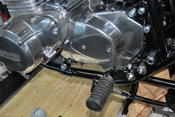

Cover on - clutch adjusted - Doremi engine bolt set fitted.

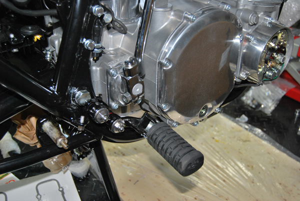

Temp fitted the pattern footrests, polished the stainless PMC footrest nuts and washers on the buffing wheel with autosol.
Polished the stainless side stand spring and bolt - looks better.
Test fitted the other side - can't wait for the brake pedal to come back from chroming.

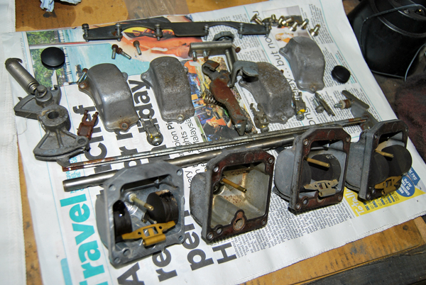

Made a start stripping the carbs - full of stale fuel residue!
Choke shaft has seen better days, managed to score a new one from CMS.
No 2 float shaft had seized - otherwize all else looks good.
Slides, needles, needle jets and choke plungers look good.
Going to make a soda blaster to do the carbs, not going to get them ceramic cleaned after last time!

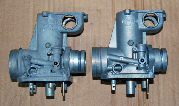

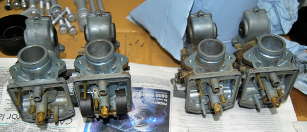

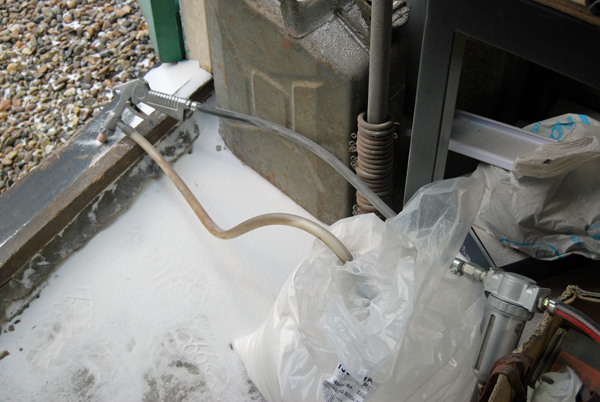

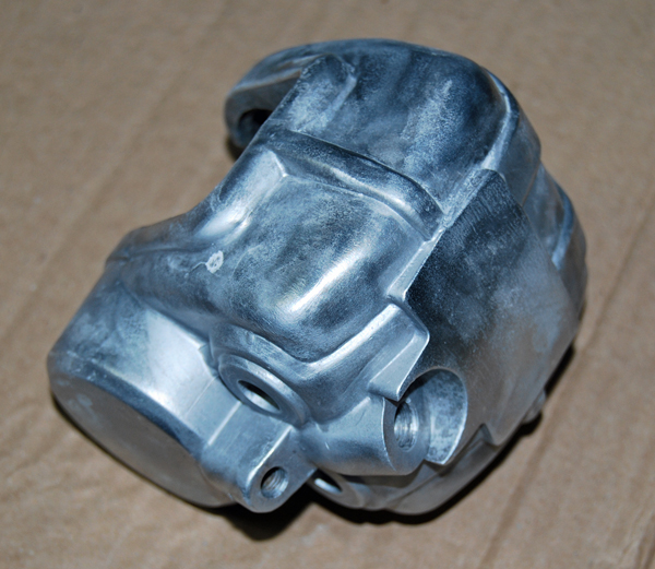

I decided not to send the carbs away for cleaning - instead I converted my blast cabinet gun for use with soda.
A 25kg bag of soda cost £38 plus Vat - not cheap but as it turns out - it goes a long way.
Just a tad messy though! most of the soda blew back on me and into the garage! longer air hose is on the list!
As the ultrasonic cleaners not arrived yet - I boiled the carbs in water for 20 mins, then rodded them out using bottle brushes, pipe cleaners and lock wire - the boiling removed lots of rubbish from the galleries, using carb cleaner and blowing them through with a blow gun removed more.
After soda blasting which took around 10 mins each I boiled them again, primarily to get any media out, good job too as more gunge was removed, again rodding them out, using carb cleaner and blowing through with the blow gun removed more.
Not a bad result.
The soda removed all the fuel scale with ease, I had to use a wire brush to remove the gasket residue as the soda wouldn't touch it.
The soda did not do so well on the carb tops, these were always going to Mikey with the bottoms for polishing but I gave them a go anyway.

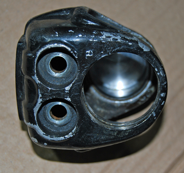

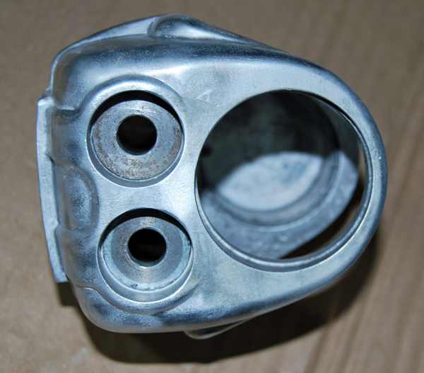

The one remaining original mine came with had a piston that was rusted solid - the casting broke trying to remove it.
After stripping them down I had tried to get the paint off with a wire wheel - they had been painted with many layers of different types of paint, the paint had reacted with each other and was as shown peeling off in places, even so the wire wheel only removed the loose flaky stuff, the paint that was still attached wouldn't budge.
I was toying with the Idea of using paint stripper - but as I'd only used just over half the bag of soda on the carbs - and as the soda was still set up - I decided to give it a try on the calipers.
It did use up the rest of the bag of soda but this way was so much easier - It took some time and made allot of mess - but it got the rest of paint off.
The soda cleaned the crystallised brake fluid from the inside and left a smooth surface, the soda doesn't remove any material or leave shards of media behind like the glass media.

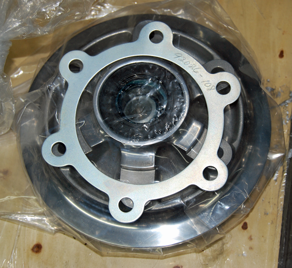

I've read many times fitting the 92026-108 spacer is not necessary.
I'd measured the front sprocket when I fitted the 530 conversion, with the spacer provided by Dave this was the same inner measurement as the 630 OE.
The 530 sprocket has the same inner measurement as the 630 OE one as they are bolted flush to the carrier in the same way.
With the rear assembled and torqued up I put a straight edge along the sprocket faces, using shim steel I found to make the chain run 100% parallel a 1.5mm spacer is required.
While it would probably be fine without the spacer - and I could have used washers - I found the correct spacer in the USA at sensible money.
Not a bad result.

Way too cold to play in the garage - Saturday saw the new pattern rear light going on - and that was it.
Chroming came back un chromed! - no explanation - #&%%# useless #%%^&&6~! going to give Castle Chroming a try.
Plenty of spares arrived from CMS and Cradley K for the Carb build.
Should keep me busy in the warm of the house for a few days....
Reckon I scored one of the last NOS choke bars available
The Carb Grommets #92071-102 I had were worn out and age cracked - and not available from Kawasaki.
Although I found them available in pattern form in Oz, something I remembered from the past was nagging me..
My next door neigbour has a Suzuk1 GS100E with the same Mikuni Carbs.
Looking on CMS web site at the Suzuk1 parts list I found them still available #13556-45010 - they are identical.
The return spring was very rusty, after cleaning I could have Zinc plated the original but again the Suzuk1 item was identical - and new!
Kawasaki #16040-020 - Suzuki #13573-45010.
(Kawasaki # item has become available again on CMS's web site since I ordered the Suzuk1 one)
It seems as the Suzuk1 GS100E uses the same Mikuni carbs - some parts cross with the A4.
A couple of other identical parts I found of use...
Kawasaki #16046-007 Pan head screws for the choke plunger levers Suzuk1 #13605-31210.
Kawasaki #16040-009 Choke bar locking screw spring Suzuk1 #13426-43010.
Another useful site for NOS parts is www.nwvintagecycleparts.com not cheap on postage - and none of the obvious parts every one looks for - but, its somewhere else worth a try - quick to ship too.

Chroming has yet again been sent off - fingers crossed it gets done this time.
Carbs are partially assembled, can't wait to get the polishing back from Mikey.
