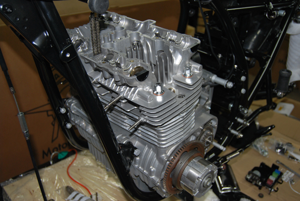

The no gasket dry build did have a purpose, the replacement APE studs measure approx 3mm shorter than the originals.
The left stud is installed to the original stud height.
The Right stud is fully installed - note the difference in height.

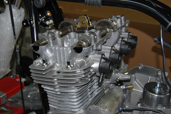

With the APE bolt drama behind me I pressed on with putting the head on.
All went well - genuine gaskets, studs, ZP nuts & washers - Liska cam chain idler wheels.
The replacement genuine camshafts I scored on USA ebay were installed with new genuine shells.
Starter motor installed.
Timed and triple checked - sorted.

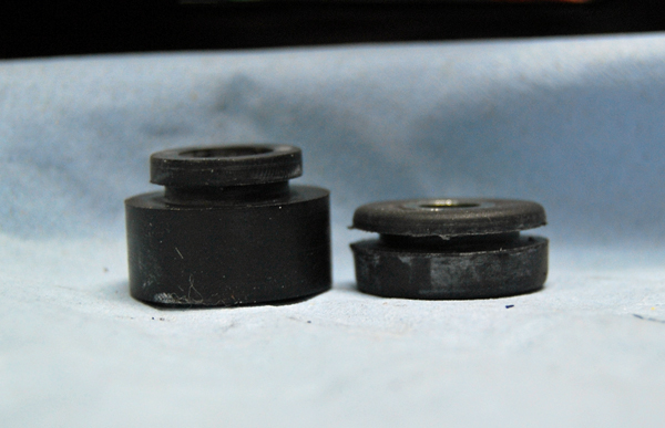

So - back to the battery box, the ZP fitting kit I'd used successfully on my Ltd build was no good for the A4.
Left in the pic is the ZP mounting - Right is the genuine set up - quite a difference!

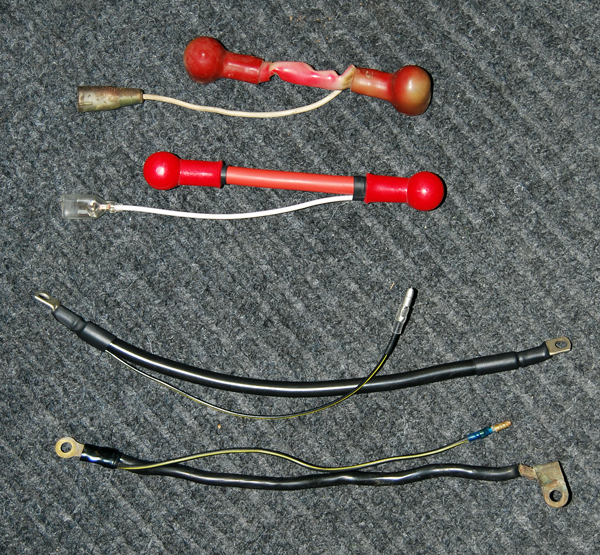

First on the agenda was to knock up the battery leads.
I thought the positive lead was a tad short so I made it a bit longer for ease of installation.
I added 15mm to the earth lead as I wasn't using the top flag connector.
FYI - Red covers were from Auto Electrical Supplies - double bullet female and cover Z1 Enterprises.

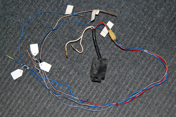

This is where spaghetti gets interesting....
I'm using the original Z1 Doremi replacement loom from Dave (saisei) as It's being modified anyway.
If you ever wanted to know the difference between an original Z1 loom and the A4 - this is the main difference.
Ok - so the brown connector is a tad further along the loom and the indicator relay wiring is a tad shorter - but thats not difficult to modify.
They added the extra wiring for the fuse box - and kept it separate!
The original A4 loom I've got had these wires taped up every so many inches with light grey tape!
The red/black wire from the fuse box was spliced into the brown/white - blue wires joint - a simple addition to get fuse protection!
I'm wiring in the 'George' mod before it's fitted to the bike, I've added the extra power supply to make it easier to add Dyna ignition in the future.
With the brown connector and indicator relay wiring moved to their correct positions the bottom half of the loom could be wrapped.
Moving the Brown connector meant shortening the cables, I got the terminals (and ordered replacement white block connectors) from Z1 Enterprises.
With the cables shortened the front of the loom could be wrapped.
I added the 'George' mod wiring and some extra security wiring and were ready to wrap.

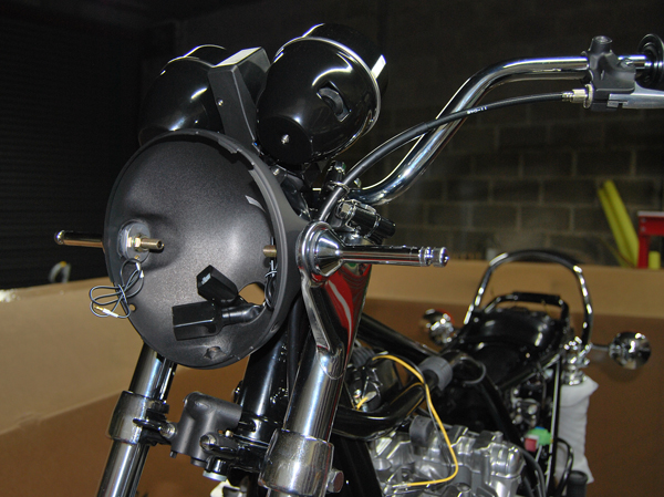

I'm using a H4 pattern headlamp as the original was too far gone, it was very rusty and bent - I'm going to keep the good bits in case I come across a decent used one.
The original indicators have been kept to refurbish at a later date, pattern for now.
The lower fork covers are the originals, the pattern Emgo and PMC don't fit the bottom yoke - I'm looking out for some more to get re-chromed.
Headlamp brackets are Doremi - a tad different to the originals - a bit of 'tweeking' to the offside extra support inside the 'ear' was needed to make it all line up.

Oh and remove the mounting rubbers this time!
