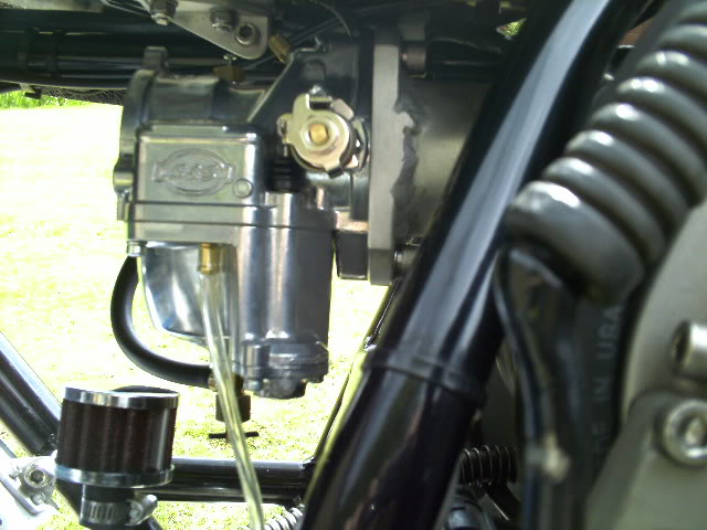

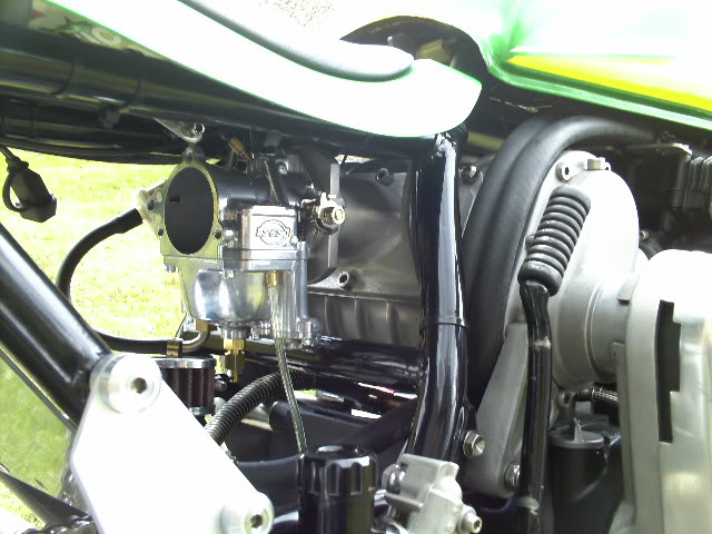

#318 PostAuthor: zed1015 » Fri Jul 01, 2011 3:04 pm
Finally fitted.
Made up a new throttle cable and installed an adjustable main jet and it fired first kick.
Everything misses (Just).
Now just got to wait for the rain to stop :( .

#319 PostAuthor: nanno » Fri Jul 01, 2011 3:50 pm
That is looking awful...
...ly good! :twisted:

#320 PostAuthor: firyembers » Mon Aug 01, 2011 12:10 am
Loooovely build,that's a work of art.Nice. :rocks
