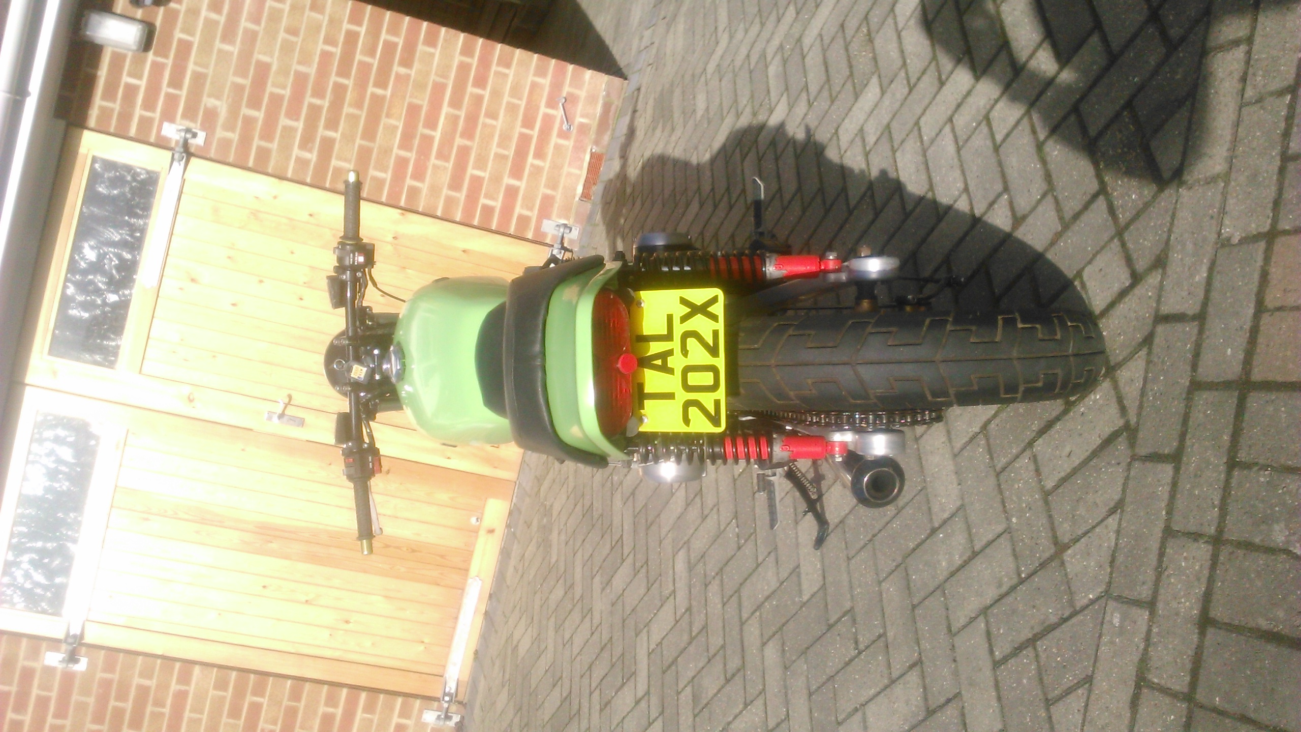

After a few delays, finally got new tyres on the wheels so at last the bike is a roller again. It was surprising hard work on your own, those old wheels are very heavy.
I found a weird problem with the bike that I've never seen before.. the RHS upper shock mount is 16mm in diameter, while the LHS is 14mm... I'll make a suitable spacer to make up the difference, but it is very odd.
I know the bike had been crashed at some point in the past, so maybe one top mount was damaged and another was used as a replacement.. the frame had been crudely painted before I got it, so couldn't tell if that area had been welded.
